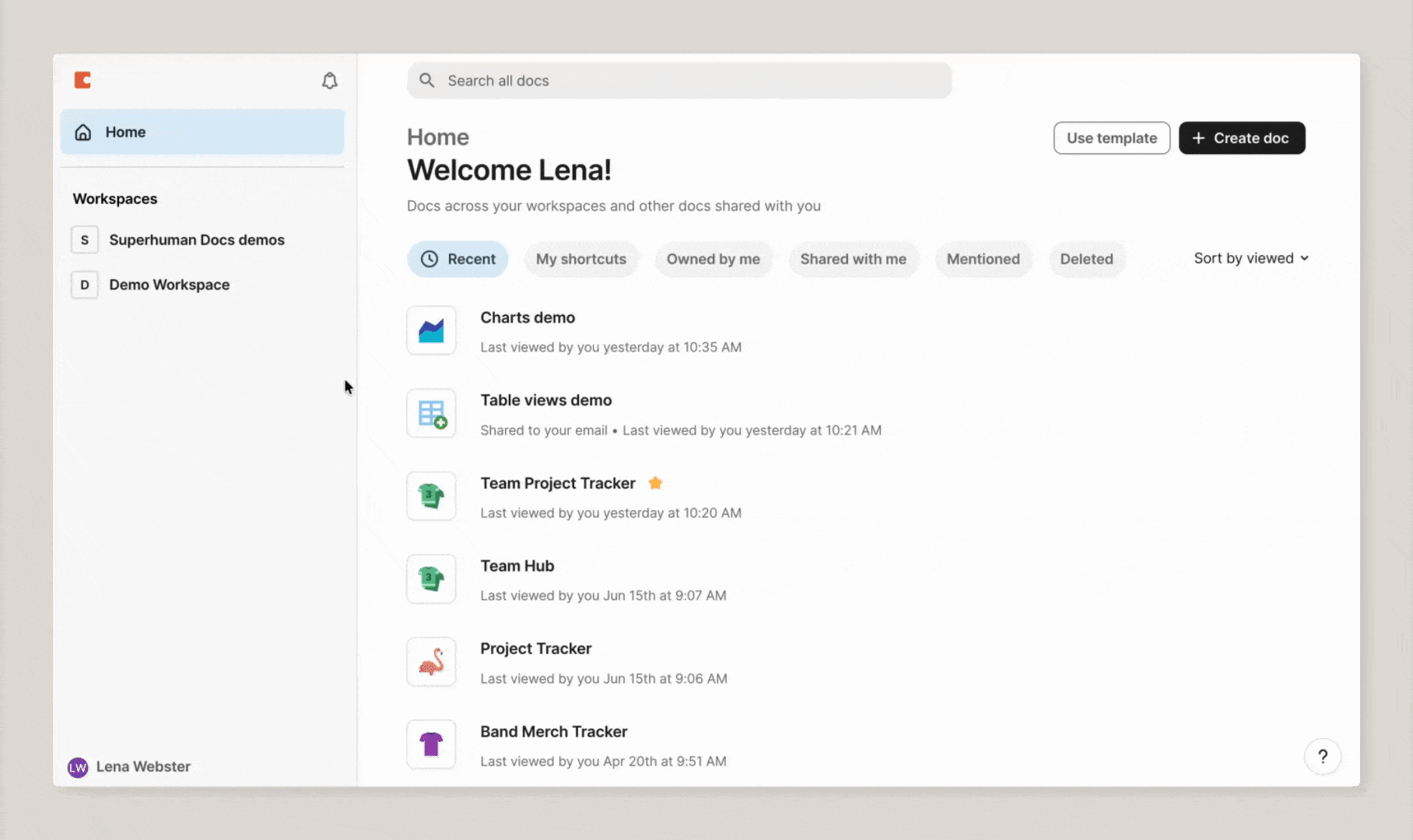

  1. Go to docs.superhuman.com
  2. In the left panel, click on the three-dot menu next to your workspace name, then select Admin settings

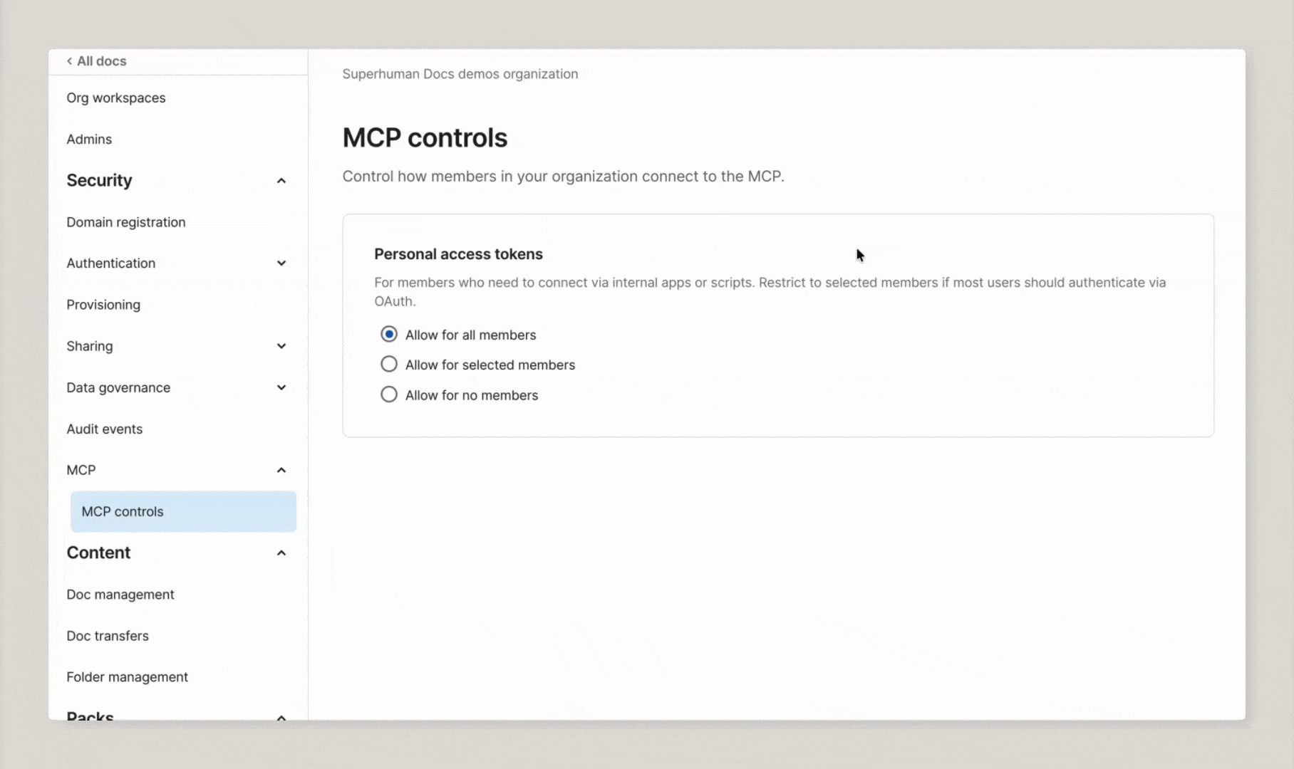

  3. Search for - or scroll to - AI and MCP (within the Security section), then select the AI and MCP controls page
  4. Locate either the MCP: Personal access token or MCP: OAuth settings, depending on which connection type you wish to modify.
  5. Select your preferred access level from the following options:
    • Allow for all members: Any member of your org can use this authentication method to connect to the MCP.
    • Allow for selected members: Only specific members you designate can use this authentication method. If you choose this option, you will be directed to a new PAT/OAuth member management page, where you can add and remove members as needed.
    • Allow for no members: This type of authentication is disabled for all members in your org.
  6. Click Confirm to confirm the change
