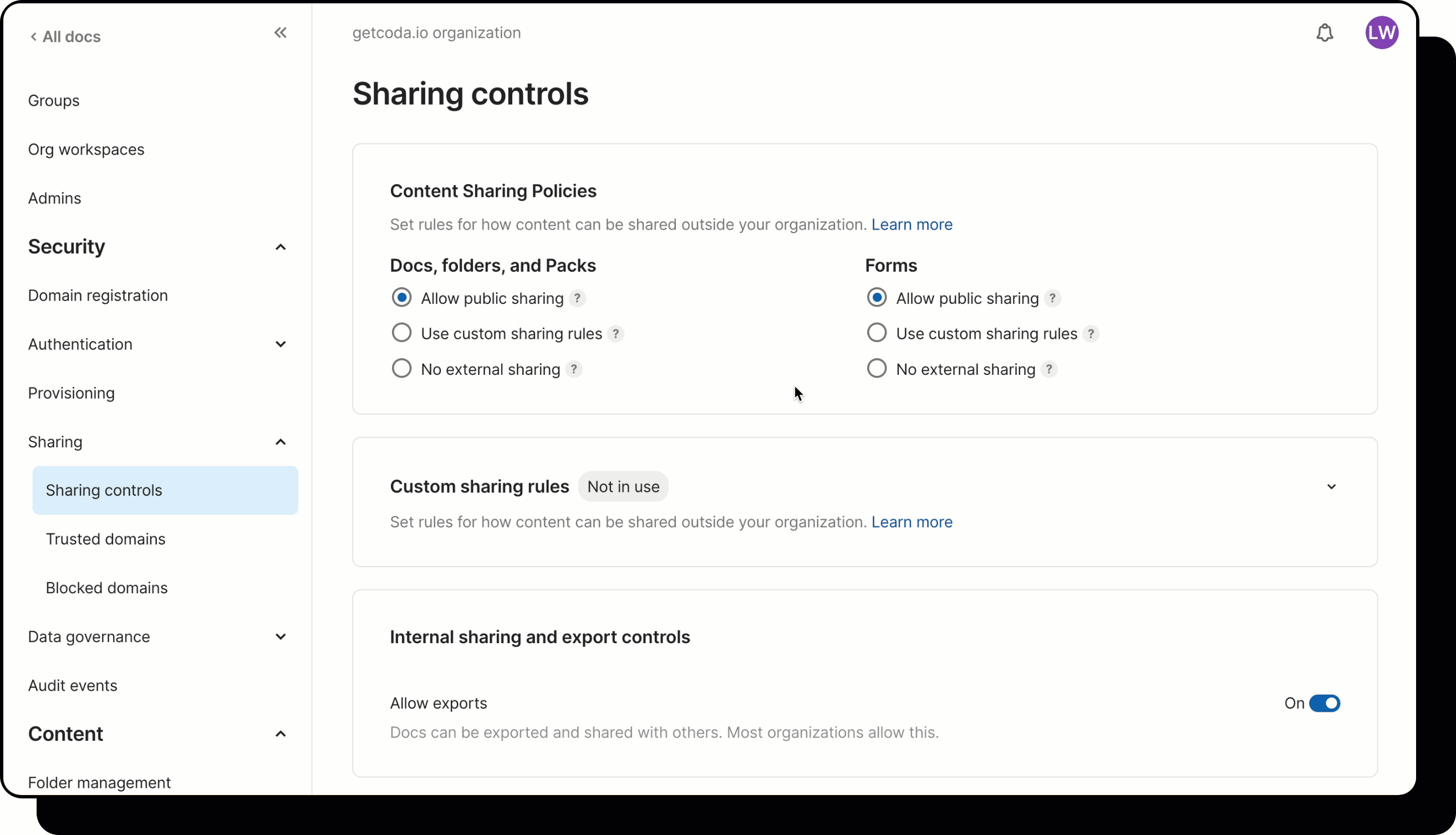

Adjust external sharing rules for your org
If you're an org admin, you can update your advanced sharing rules at any time from the admin settings console. Just follow these steps:
  1. Log into a Docs account with org admin access.
  2. Click on your account name in the lower-left corner of the screen, and select Admin settings from the menu.
  3. Scroll down to - or search for - the Sharing controls tab (within the Security section).
  4. At the top of this page, you'll see a Content sharing policies section. Here you can select the external sharing policies for docs, folders, and custom Packs, as well as the policy for forms. Adjust as needed (see more about the different access levels below).
Access rule options
There are three external sharing policies available for docs, folders, Packs, and forms:
  1. Allow public sharing: Docs, folders, and Packs can be shared outside the organization. Sharing settings are managed on a per-doc, per-folder, and per-Pack basis.
  2. Use custom sharing rules: Docs, folders, and Packs cannot be shared via “anyone with the link.” External collaborators can be invited directly, but only in accordance with the custom sharing rules (see below) that you select. This policy also disables doc publishing and doc embedding.
  3. No external sharing. Doc, folder, and Pack access is limited to users within the organization’s domain only. Content cannot be shared with external collaborators via doc publishing, doc embedding, or direct add.
Important note: Restricting access will not affect any docs, Packs, or forms that have previously been shared publicly. This restriction will solely apply to future doc and Pack shares, ensuring that they can not be shared with the public. To manage docs that have already been shared publicly, visit this article.

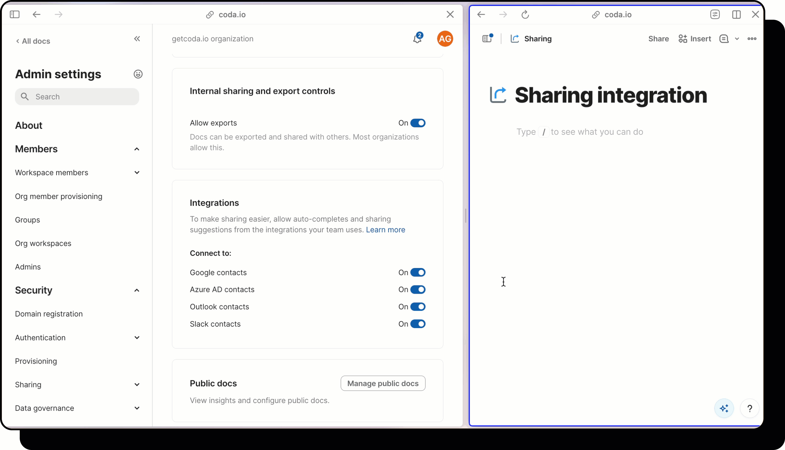

Modify sharing integrations
As an org admin, you can also control which sharing integrations are available to members of your org.
Sharing integrations are intended to make sharing easier for your team by integrating with your external contact sources like Google, Azure AD, Outlook, or Slack. When a user invites someone to their doc, they will see these integrations in the share dialog and can then select the correct contact from the integration.
However, depending on the tools your team uses, some of these integrations may not be necessary. Org admins can therefore control which sharing integrations are or aren’t shown to org members. To modify sharing integrations for your org, follow these steps:
  1. From your Docs homepage, click on your name in the lower-left corner, then select Admin settings
  2. Search for or scroll to the Sharing controls page
  3. Locate the Integrations section
  4. Toggle on or off any of these integration options as needed
That’s it - any changes made will be implemented immediately.
