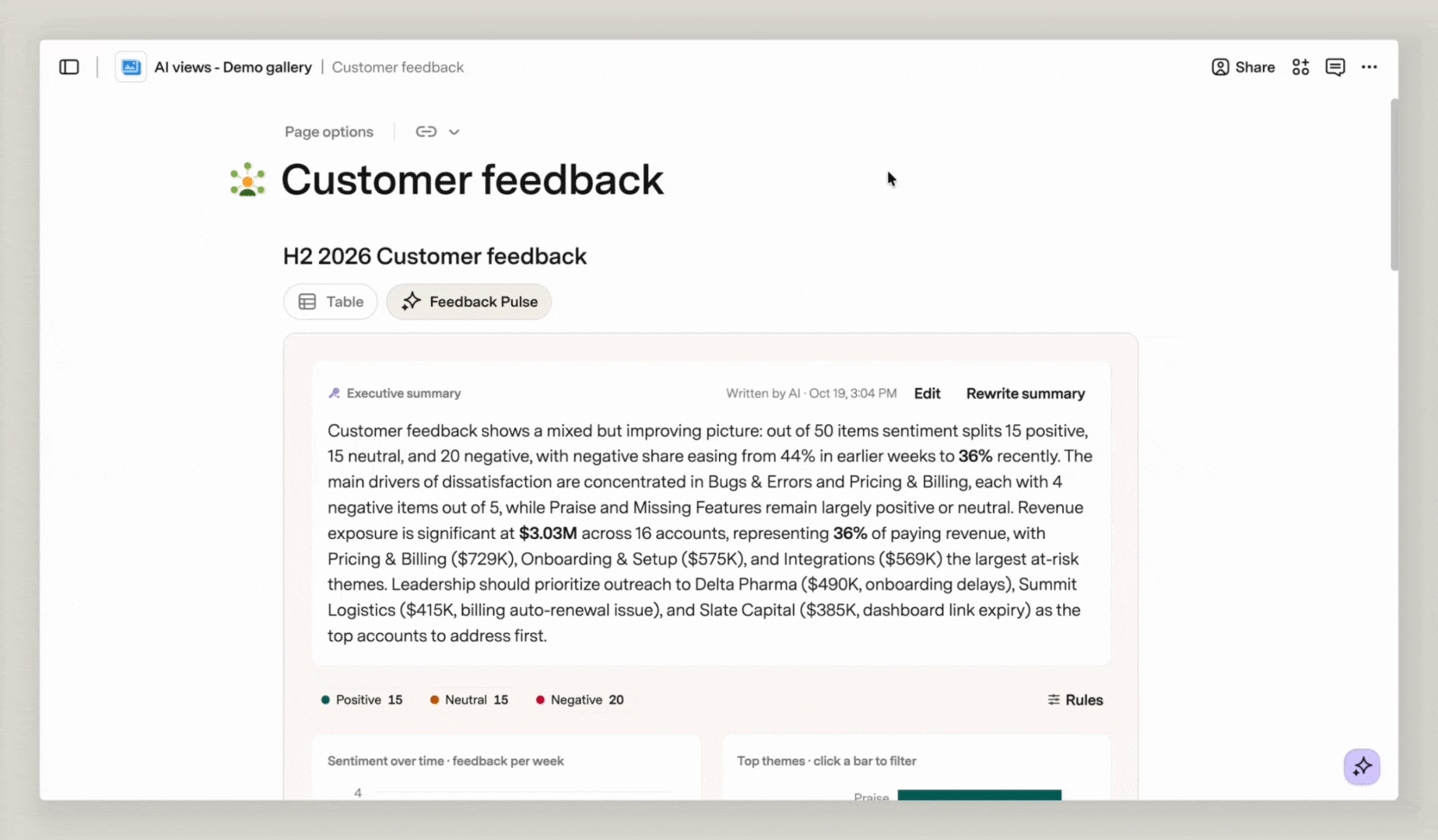

An AI view is a custom view of a table that AI builds for you from a written prompt. You describe the experience you want, and AI plans and generates it using the data in that table. For example, you could turn a table of customer feedback into a heat map that highlights the most common trends. You can then interact directly with the AI view to update the table data.
You don’t need to be a software engineer to create one. Behind the scenes, AI writes custom code for your view. If you’re curious, you can see the code files by going to Edit > clicking the three-dot menu > selecting Files.

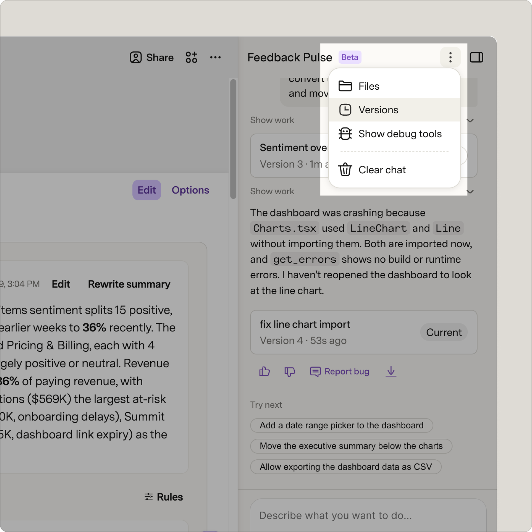

From this chat experience, click on the three-dot menu in the upper-right. Here you will find options for…
  • Files: This is where the underlying code of the AI view lives. You can copy this code directly if you need to make a copy of the AI view.
  • Versions: Here you will find the version history of the view. You can use the Restore button to restore the view to an older version.

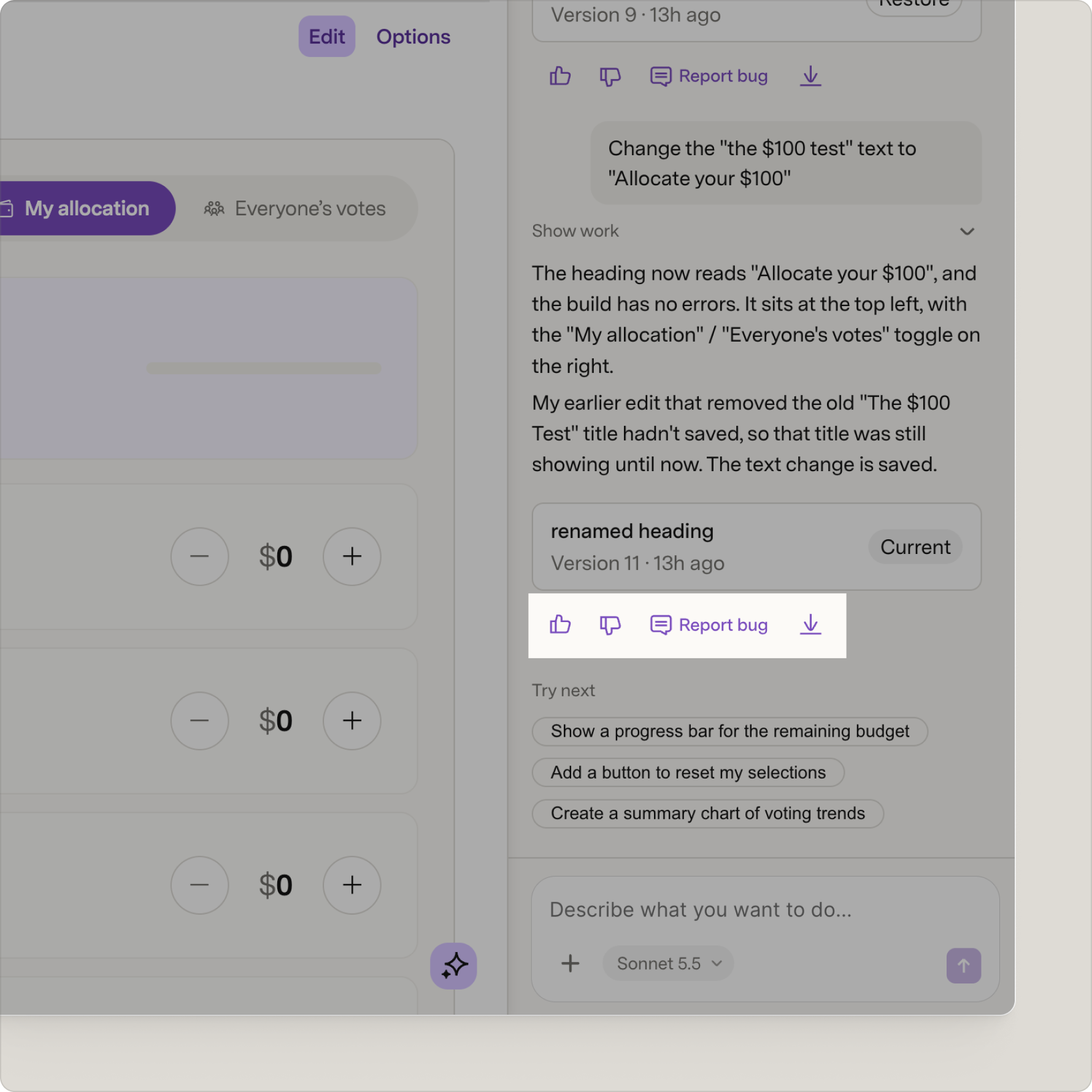

How do I leave feedback on the product?
Within the chat experience for the AI view, you will see options for thumbs up, thumbs down, and Report bug. When you click any of these options, a window will pop open where you can provide further details about your experience. Please include as much information as possible - then hit Submit to send it to our team.
