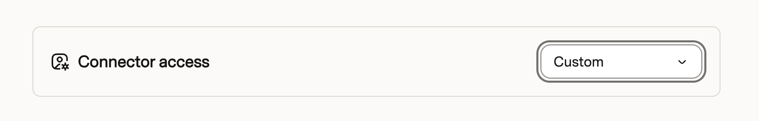

  3. On the page that opens, click on the menu next to Connector access and select Custom.
  4. In the window that appears, click Confirm.

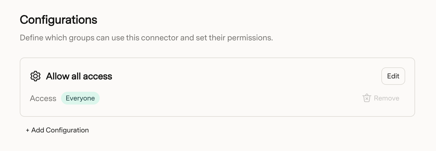

  5. In the Configurations section, click Edit to change the existing configuration, or click + Add Configuration below to create a new one.
  6. Enter or edit the configuration name, then under Groups with access, choose whether the configuration applies to everyone or to selected groups.
