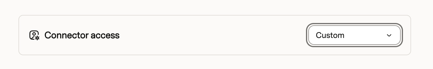

  3. On the page that opens, click on the menu next to Connector access and select Custom.
  4. In the window that appears, click Confirm.

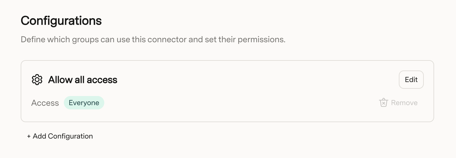

  5. In the Configurations section, click Edit to change the existing configuration, or click + Add Configuration below to create a new one.
  6. Enter or edit the configuration name, then under Groups with access, choose whether the configuration applies to everyone or to selected groups.
  7. In the Policy section, for the Connection endpoint URL, enter your Databricks workspace URL — the URL you use to access Databricks in the browser (for example, https://your-workspace.cloud.databricks.com//ai-gateway/mcp-services/system.ai.genie_one_mcp?o=<your-workspace-id>).
  8. Under Read permissions, select Allow, Always ask, or Deny.
  9. Under Write permissions, also select Allow, Always ask, or Deny.
  10. Optionally, check the box next to Allow only private connections to write to Databricks.
  11. Optionally, check the box next to Doc sharing to enforce configuration permissions.
  12. Next, in the OAuth app credentials section, enter your Client ID and Client secret copied from your Databricks workspace.
  13. For the Authorization URL, enter your URL in this format: https://{your-workspace-url}/oidc/v1/authorize
  14. For the Token URL, enter your URL in this format: https://{your-workspace-url}/oidc/v1/token
  15. Click Save configuration.

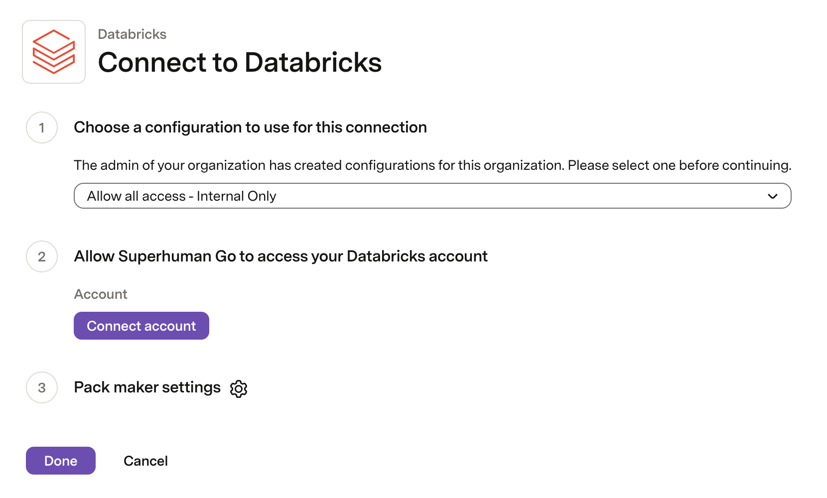

  1. Go to go.superhuman.com.
  2. In the lower-left corner, click Connectors.
  3. Under Browse connectors, enter Databricks in the search field, then click the connector.
  4. In the window that appears, click Sign in.
  5. On the next page, click Connect account.
  6. Sign in to Databricks and approve the requested access.
  7. Click Done.
