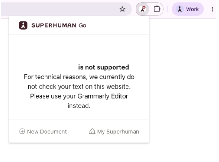

Note: If the Superhuman Go icon on your browser toolbar shows a red-barred circle, the extension has been deactivated on the website you’re on.
Confirm the website is supported
The Superhuman Go browser extension works on a wide range of websites. If writing suggestions don’t appear on a specific one, the website may not be supported. To check whether it is supported, type the website name in the search field on this page: Check if your favorite apps and websites work with Grammarly and Superhuman Go
If the website shows the Unsupported status, writing suggestions will not be available there.

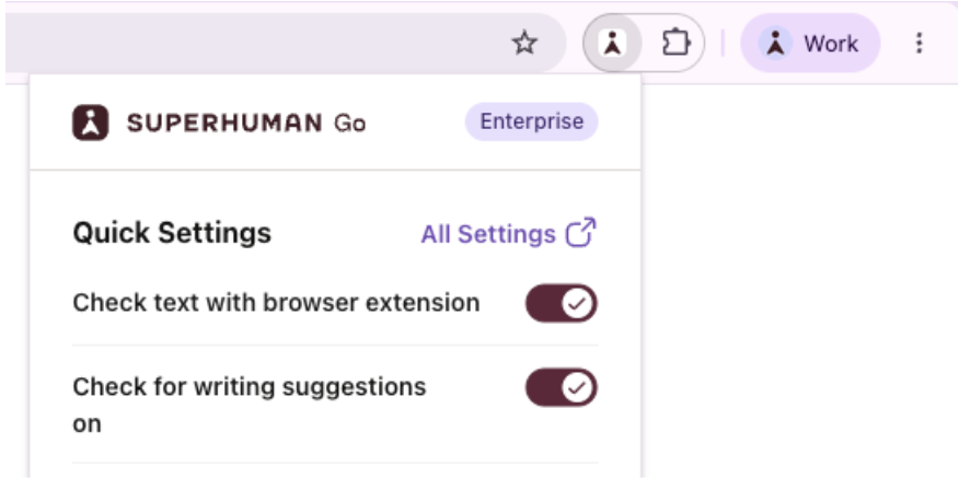

Confirm writing suggestions are switched on for the website
The Superhuman Go extension has two settings that control whether writing suggestions appear:
  • A global setting that turns writing suggestions on or off across all websites
  • A per-website setting that turns writing suggestions on or off for the website you’re currently on
To check these settings:
  1. Click the Superhuman Go icon on your browser toolbar.
  2. Confirm that Check text with browser extension is switched on.
  3. Confirm that Check for writing suggestions on… is switched on for the website you’re currently using.
If either setting is off, switch it back on, reload the page, and check whether writing suggestions appear.
Note: If the Superhuman Go icon shows a red-barred circle, the extension has been deactivated on this website, and clicking it displays a message confirming this.

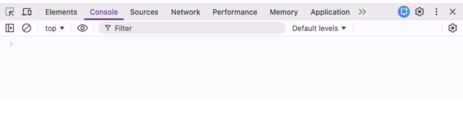

Check whether the text field has a compatible height
  1. Right-click on the text field where Superhuman Go isn’t working and click Inspect.
  2. Navigate to the Console tab.
  3. Copy the following string, paste it into the Console view, and press Enter:
    $0.clientHeight 38
If the result is false, the text field is too short to be compatible with Superhuman Go.
Check whether the website has disabled writing suggestions for this text field
    Boolean(document.querySelector('[data-gramm="false"]'))
If the result is true, the website has disabled writing suggestions for this text field. For more information or additional assistance, contact the website owner.
