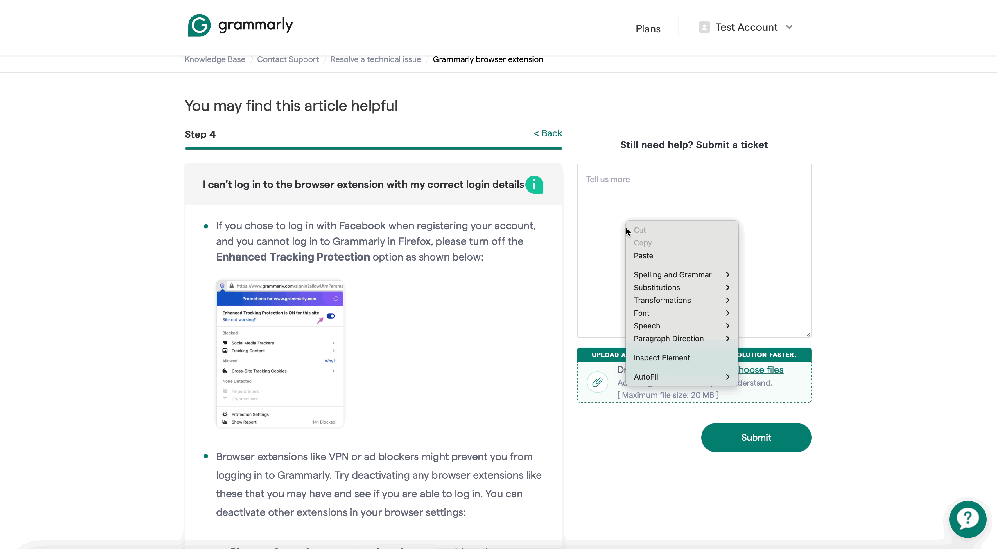

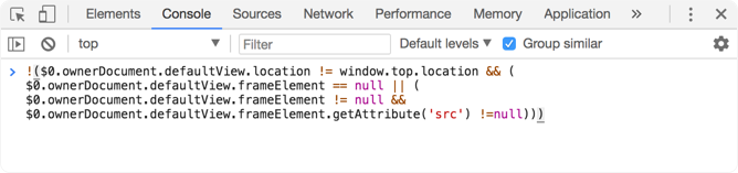

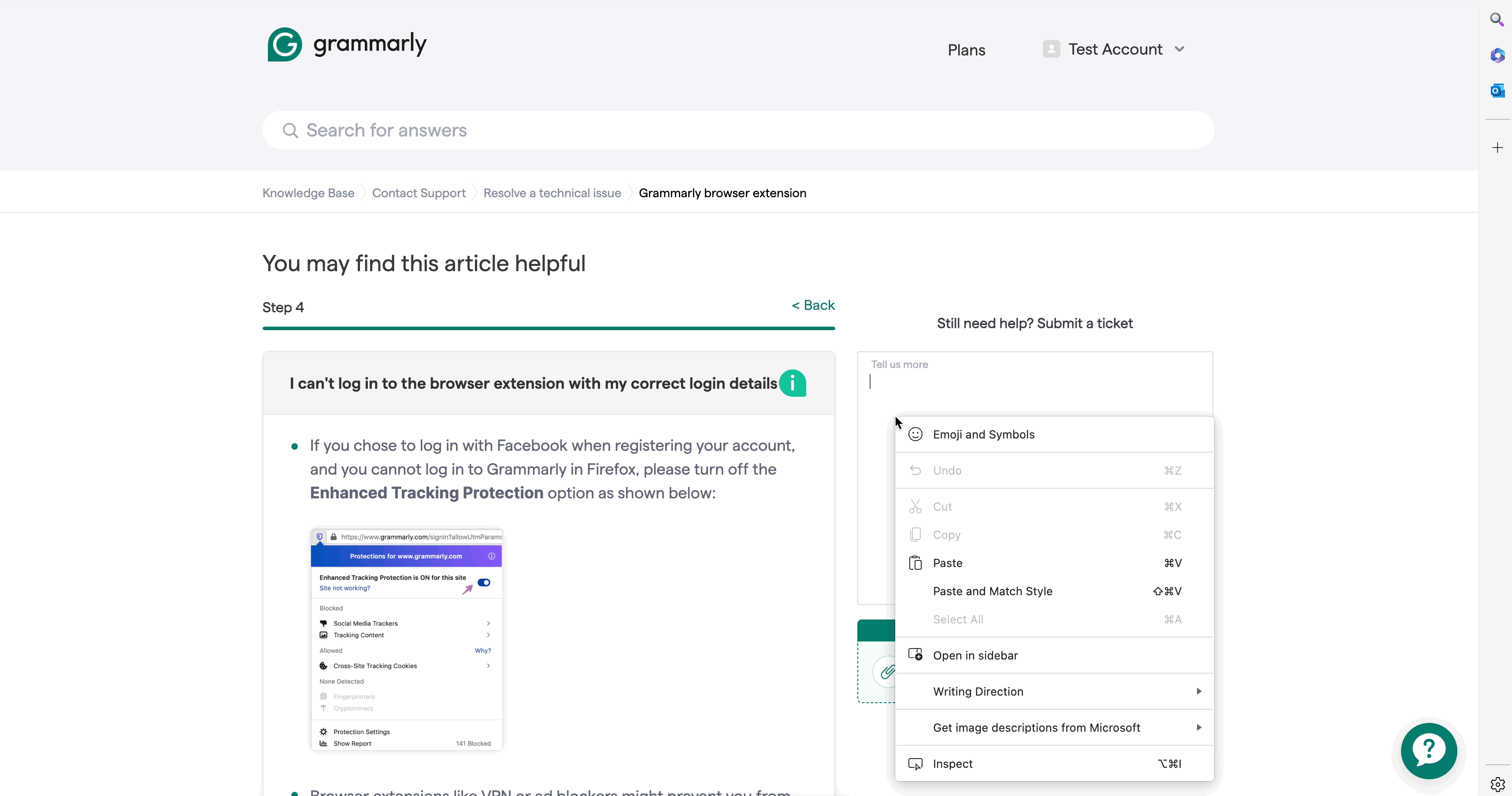

  1. Click on the extension’s icon on the extensions bar to make sure that the web page is supported and that checking is enabled on the site.
  2. Check whether a text box was built using iFrame:
    • Right-click on the text box where the extension isn’t working and click Inspect.
    • Navigate to the Console tab.
    • Copy the following string and paste it to the console view. Hit Enter:
      $0.ownerDocument.defaultView.parent !== $0.ownerDocument.defaultView
      If the result is “true,” please submit a support request and make sure to provide the name of the website so we can take a closer look.
      If you see “false” but Grammarly still doesn’t appear in the text field, the text field in question may not be compatible with Grammarly.
      If Grammarly has disappeared recently or intermittently appears on the website in question, please follow these troubleshooting steps.

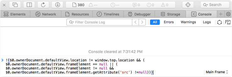

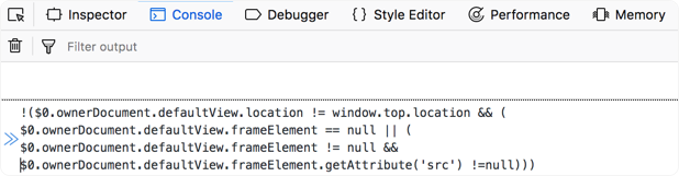

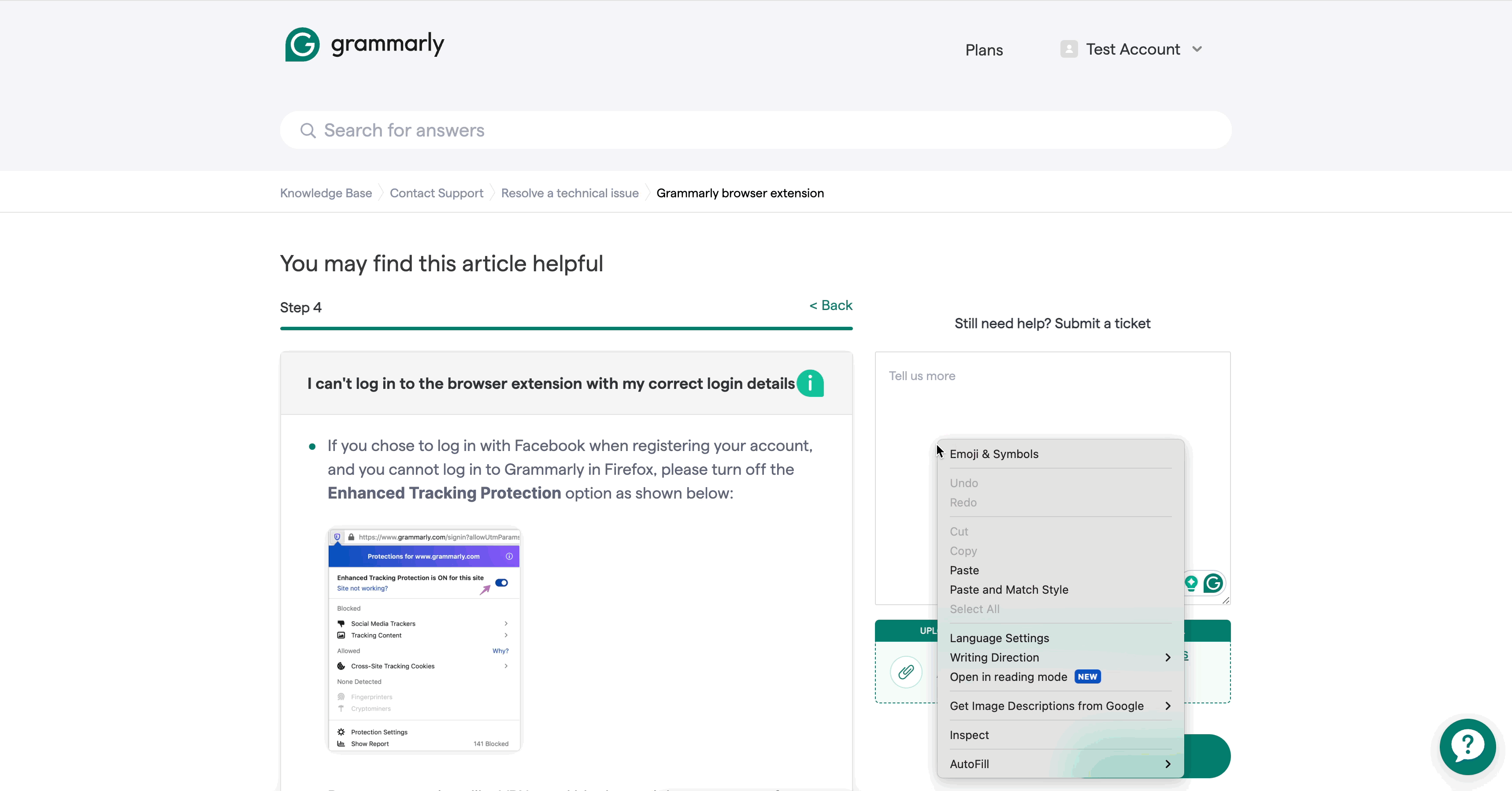

  2. Check whether a text box is compatible with the extension:
    • Right-click on the text box where the extension isn’t working and click Inspect Element.
    • Copy the following string and paste it to the console view and hit Enter:
