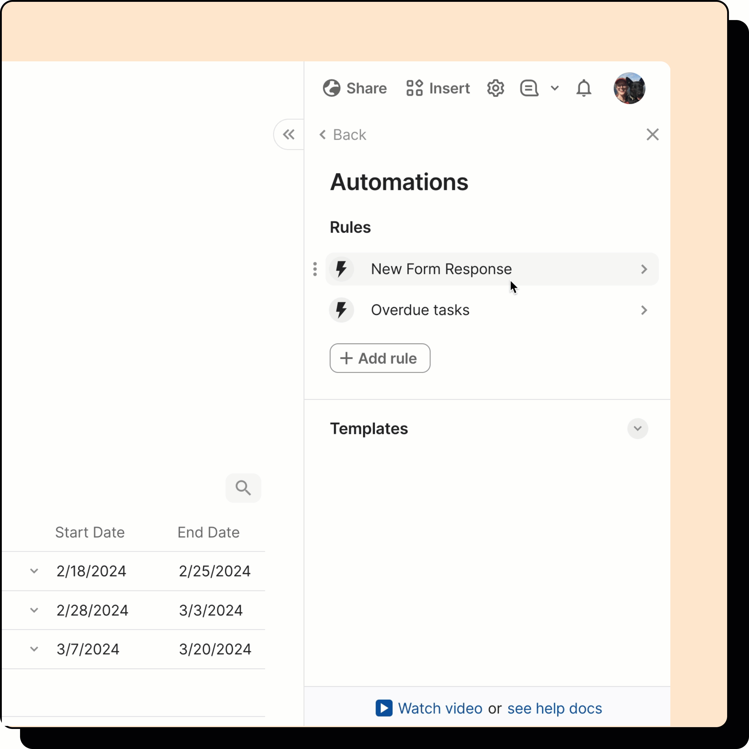

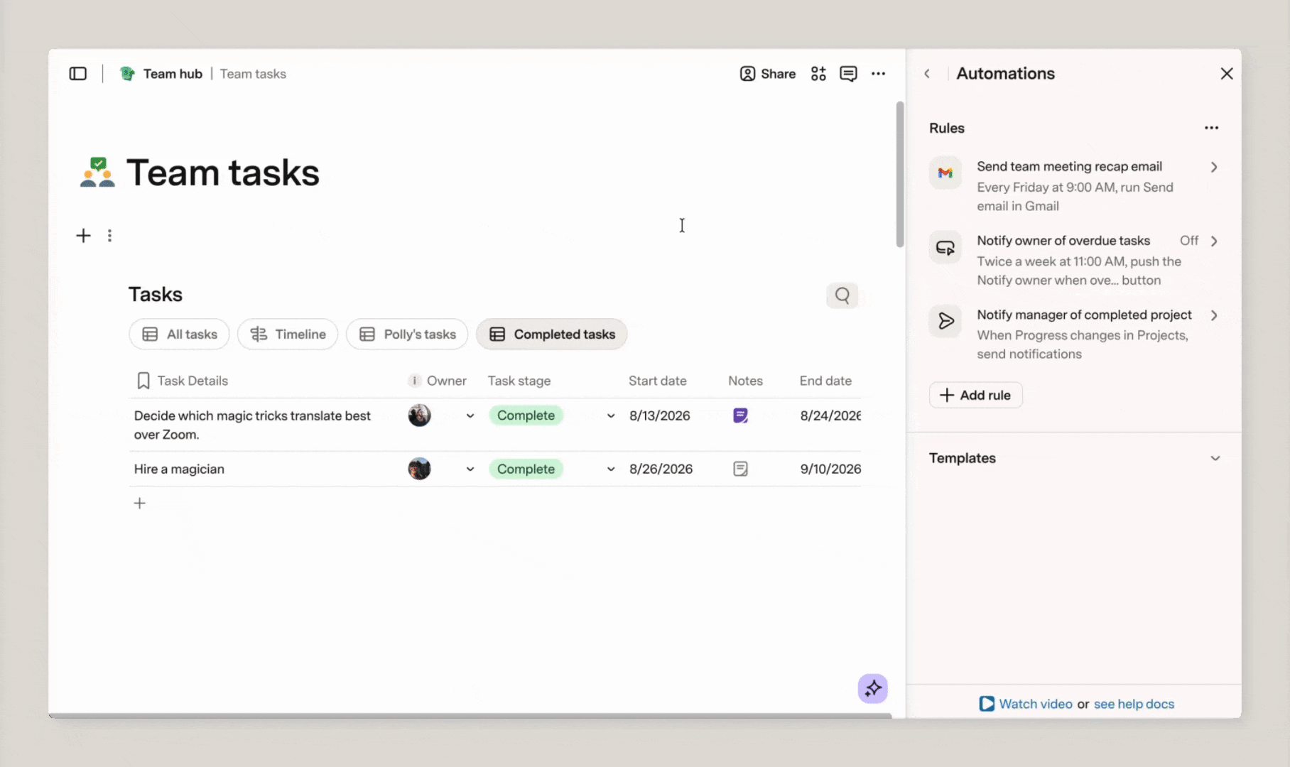

Add an automation to your doc
To add an automation to your doc, follow these steps:
  1. Click the three-dot menu in the upper-right corner of your doc
  2. Select Doc settings from the list
  3. Click into Automations
  4. Click Add Rule
  5. Build your automation rule! 🎉

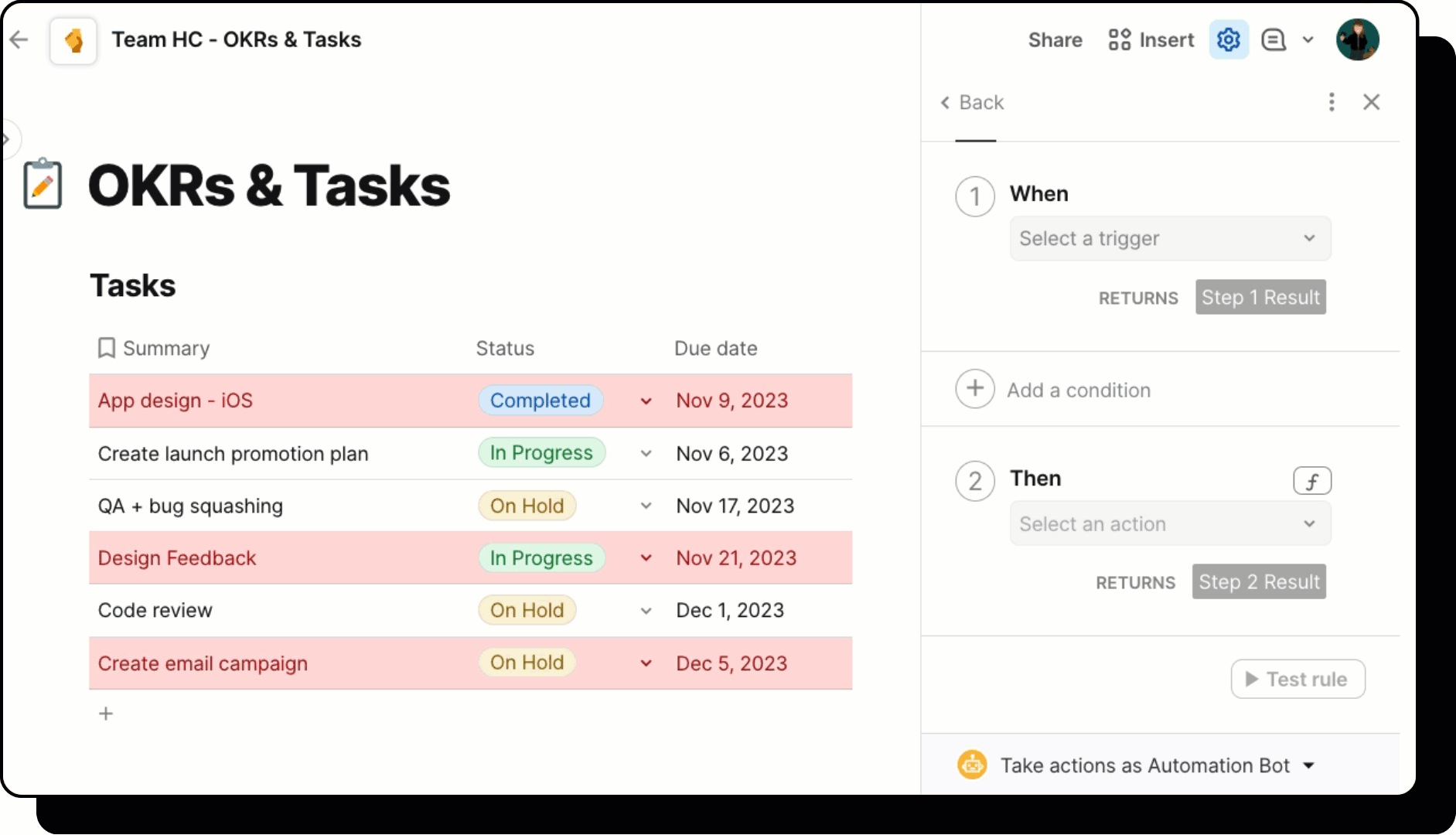

When and Then: automation basics
Automations have two required steps: When and Then.
Step 1: When
The first step in an automation is the When. This step informs Superhuman Docs when to trigger the automation. You can select from the following triggers:
  • Row changed: The automation will start when a row in a specified table changes. With this option, you can specify any editable column. Columns that contain formulas cannot trigger automations.
    • Formula changes, edits to canvas columns, and comments will not trigger automations with this type of trigger.

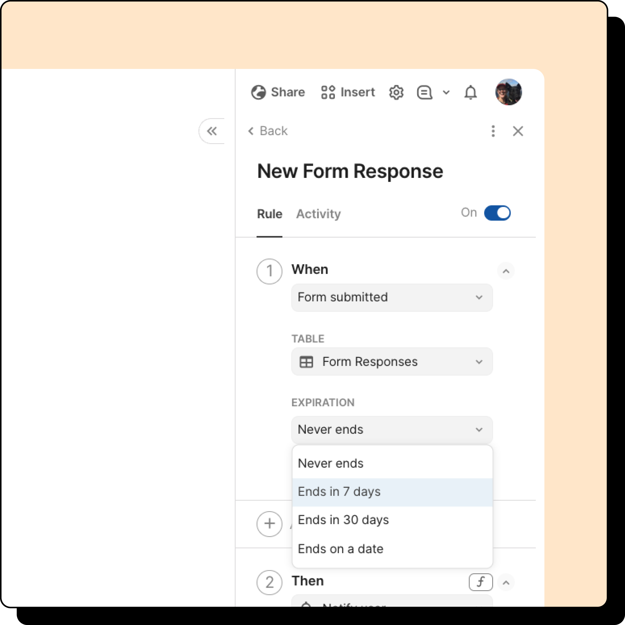

  • Time-based: The automation will run on a specified cadence. You can select from the following options for your automation cadence:
    • Hourly (run the automation every 1, 2, 4, 6, 8, or 12 hours)
    • Daily (run the automation every day at a specific time)
    • Weekly (run the automation every week on a specific day, at a specific time)
    • Monthly (run the automation on the X day of the month, at a specific time)
      • Monthly automations won’t run on the 29th, 30th, or 31st in months without those days.

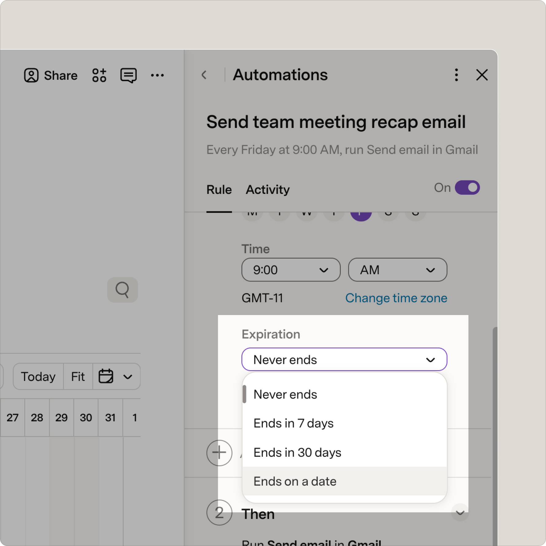

💡 You also have the option to choose when your automation will expire. By default, automations never expire. But you can choose to change this via the Expiration dropdown in the When step of the automation.
Once expired, the rule will automatically disable itself. In other words, the automation will still be visible in your list of automations, but it will be toggled to off.
Step 2: Then
Then is the action you want Superhuman Docs to take when the automation is triggered.
In this step, you can write a formula to tell Docs specifically what you want it to do, or you can select from the dropdown menu of options:

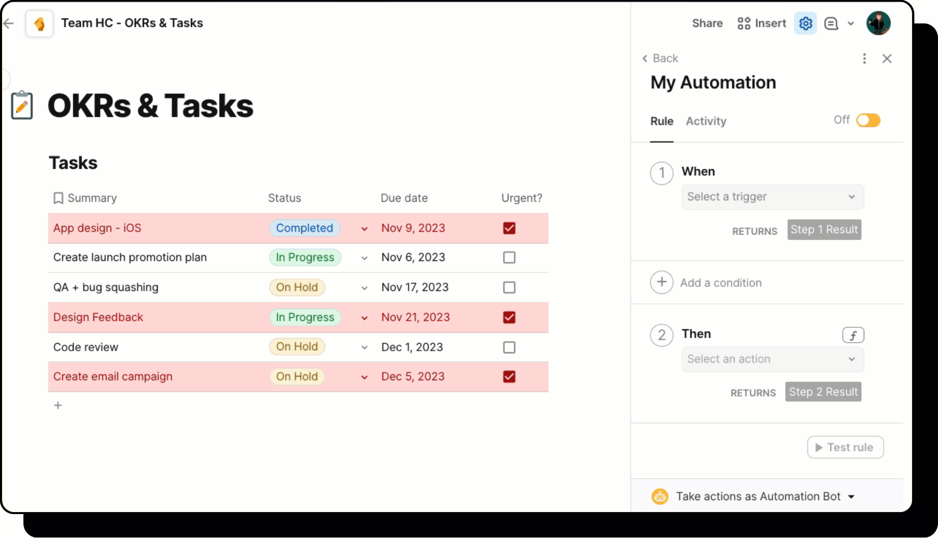

There are two other optional steps that can make up your automation: If and And Then.
If: the conditional step
The If step is where you can specify a condition that determines whether or not the automation continues once triggered.
To add an If condition to your automation, click Add a condition between your When and Then steps.

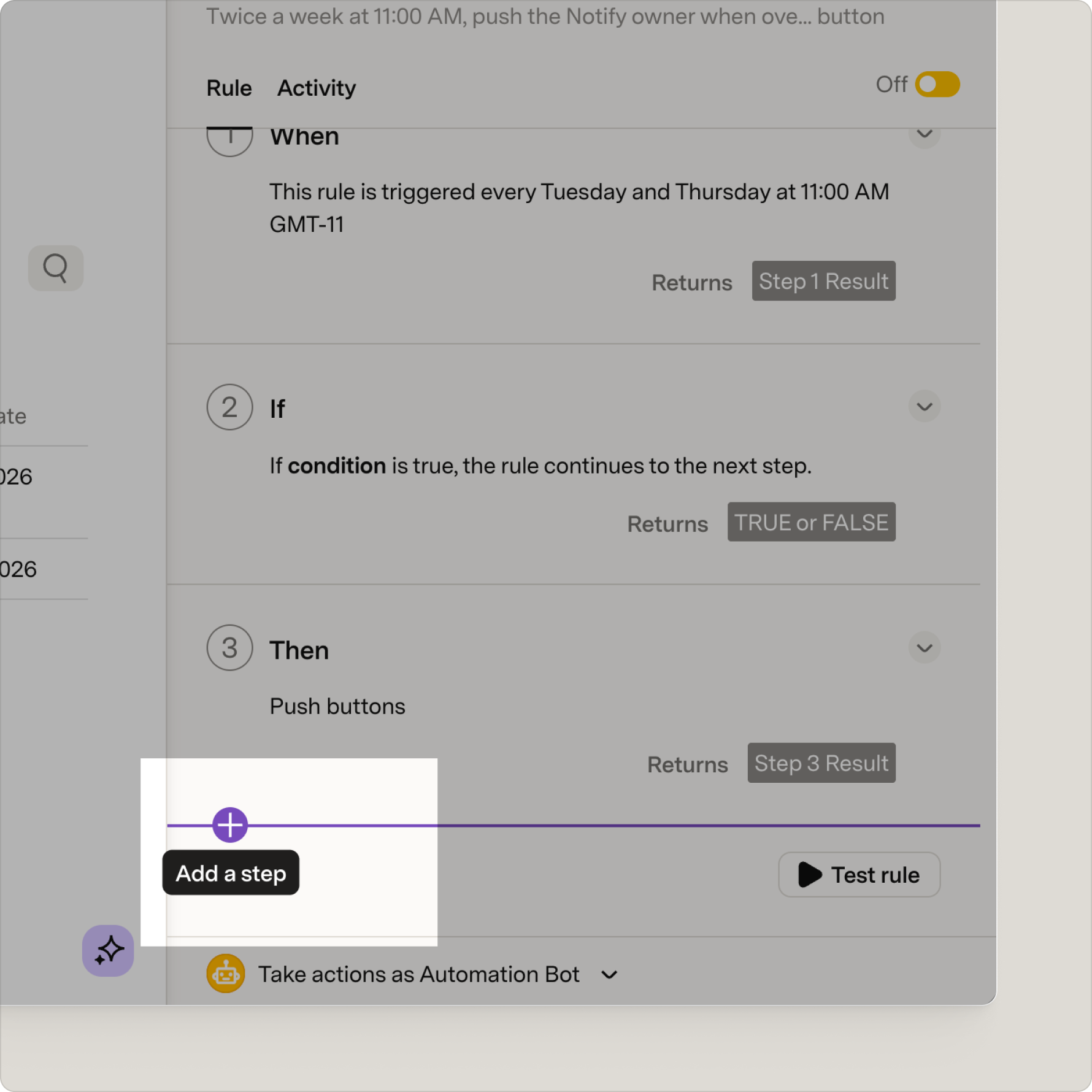

And Then: add more actions
Automations in docs can include multiple results in sequence after an automation is triggered. If you want to add multiple steps to your automation, add an And Then step:
  1. In your automation, hover your mouse on the line between your Then step and the Test rule button. This line will then highlight blue and display a + button.
  2. Click the + button that appears on hover. You can add as many And Then’s to your automation as you like!
  3. Configure your And Then step! 🎉
When you add this step to your automation, you have access to the same actions as the standard Then step menu.

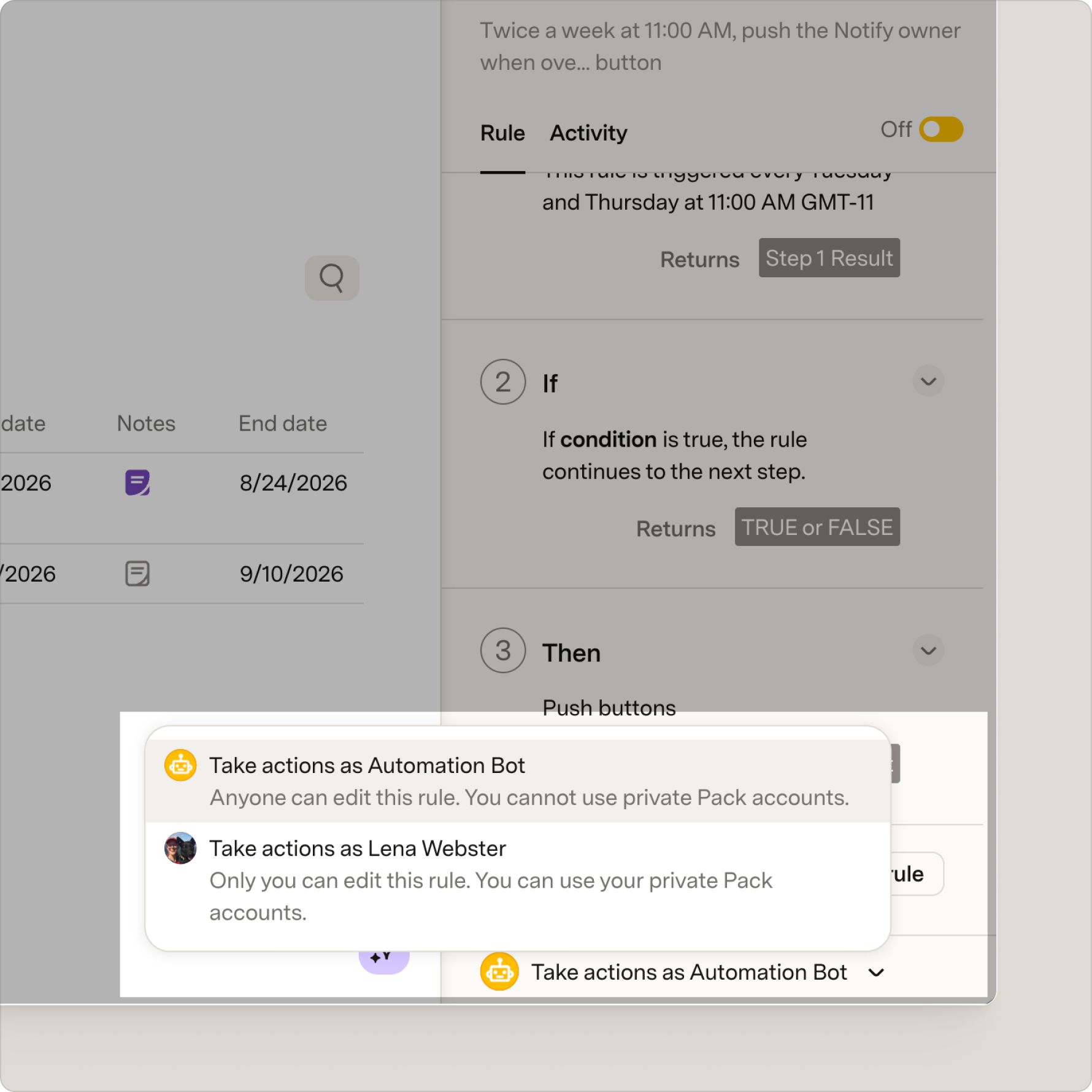

Take actions as...
The final step to configure in your automation is who the automation should take actions as. At the very bottom of the Automation side panel, you’ll see a dropdown menu containing two options:
  • Take actions as Automation Bot: Automations that are set to take actions as Automation Bot can be edited by anyone with edit access in your doc. You cannot use private Pack accounts with this configuration, only shared Pack accounts. Learn more about private and shared Pack accounts here.
  • Take actions as yourself: If you choose this, you become the automation "owner." This automation cannot be edited by anyone else but you. If you want to take actions with a private Pack account, you’ll need to select this setting as part of your automation configuration. Learn more about private and shared Pack accounts here.
ℹ️ As noted above, automations can be set to take actions either as Automation Bot, or as the automation "owner." By default, the owner of the automation is the person who creates the automation. So what if someone else created the automation in the first place, but you now want the automation to take actions as you rather than as that original person. In that case, you can claim ownership of the automation by clicking on the Take actions as section of the automation, and choosing Claim rule ownership.
