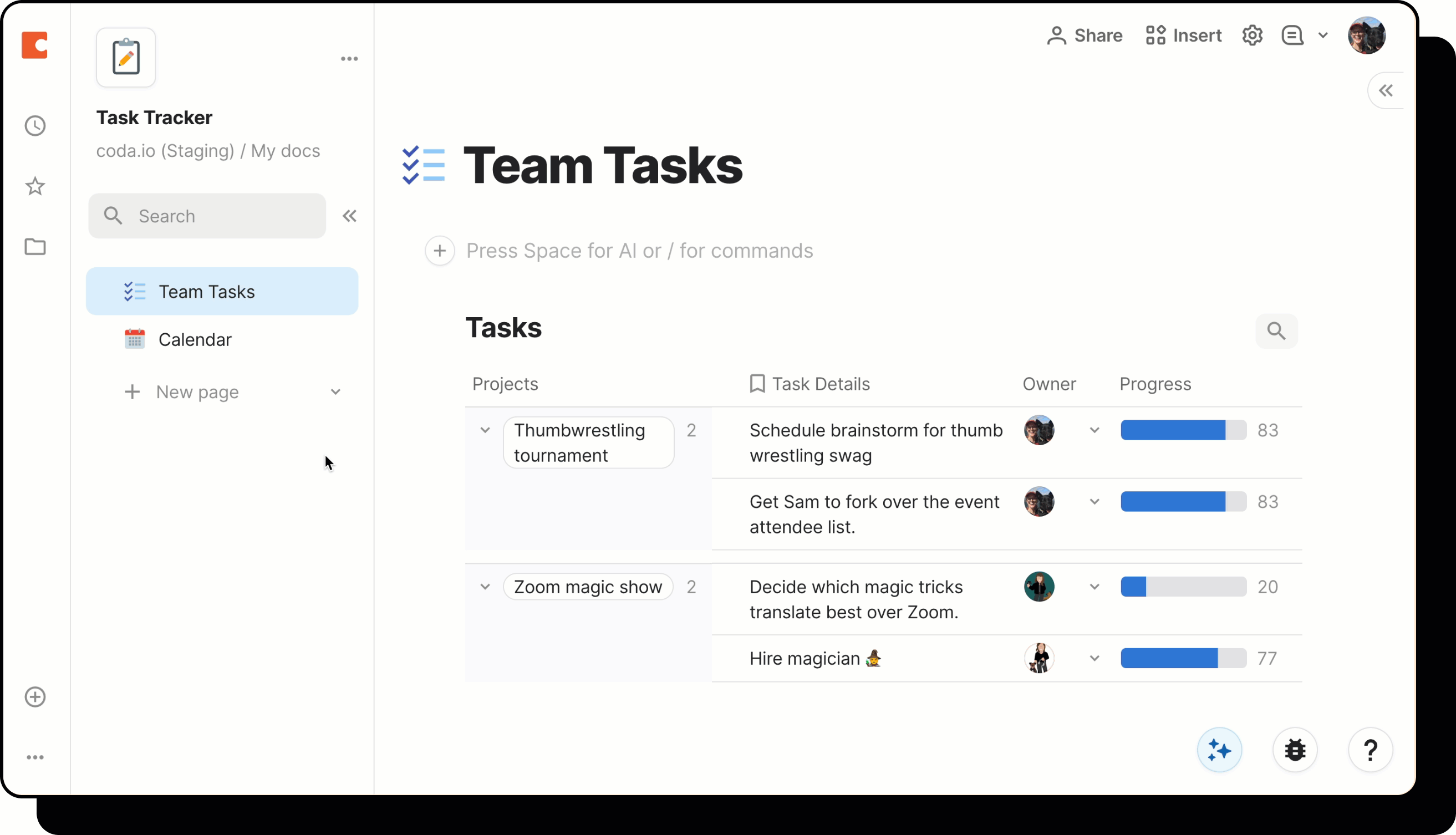

  1. Open the doc that you want to add a sync page to.
  2. At the bottom of your page list (left side of your doc), click on the dropdown (v icon) next to New page. If your page list is collapsed, hover your mouse in the bottom left corner and wait for this to appear. Select New sync page from the options.
    1. Alternatively, you can click the three horizontal dot menu ( ... ) next to the name of an existing page, then choose Add page > New sync page.
  3. You can then either paste the link to the page you want to sync in. Or you can click the Browse docs option to find the doc in question and choose the desired page from that doc.
    1. Note that table pages cannot be used for sync pages.
  4. If the page you’ve chosen includes subpages, you’ll see an Include subpages toggle. Toggle this setting on to also sync in the subpages.
  5. Finally, click Create.
A gif demonstrating a user adding a synced page to a doc, and toggling on the option to sync subpages.

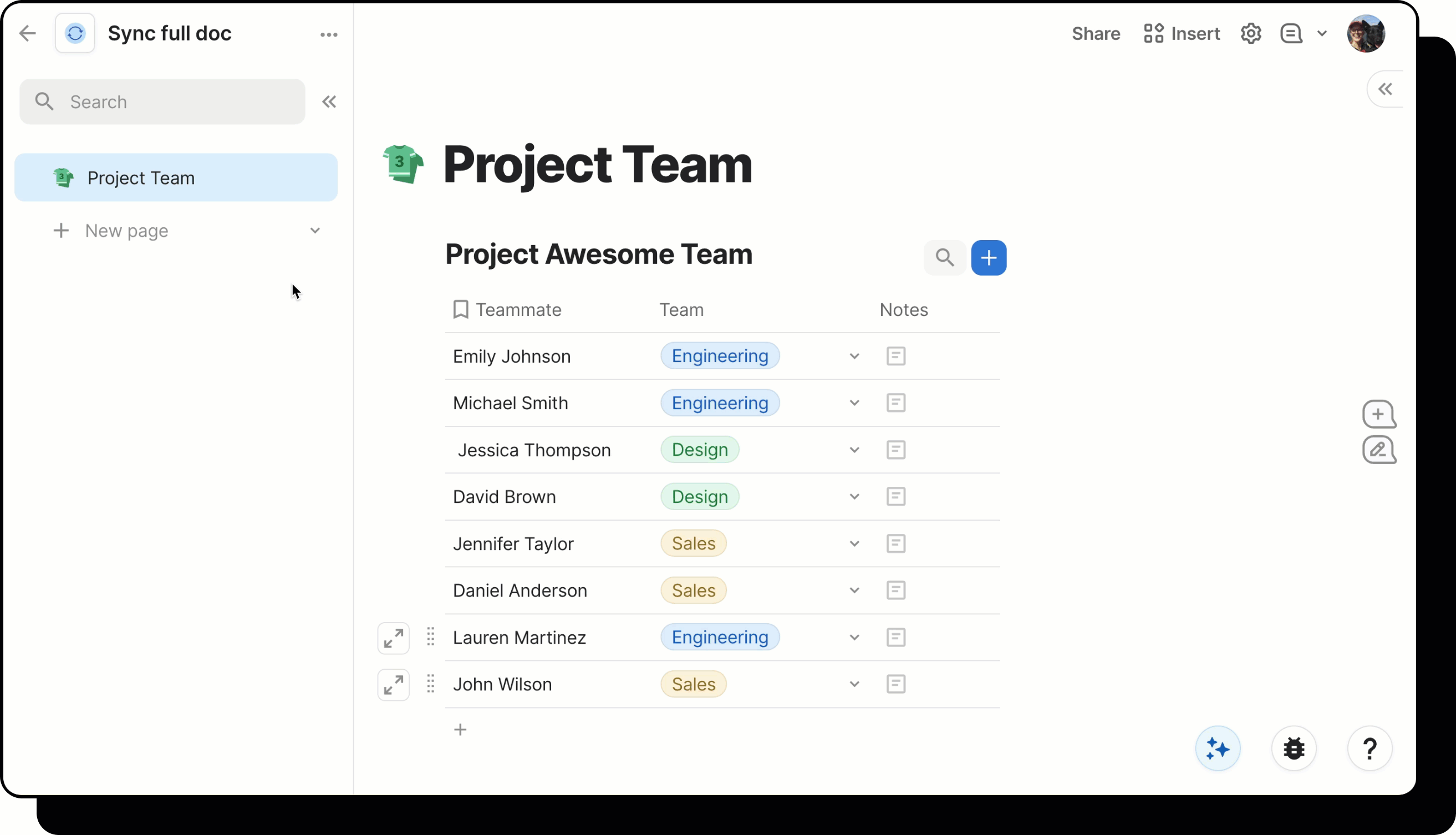

Sync full docs
In addition to syncing single pages or pages with subpages, you can also use this feature to sync entire docs.
To sync full docs, follow the steps in the section above through step #3. Once you've browsed for and selected the doc you'd like to sync in, you should see an Entire doc toggle near the title of your selected doc. Toggle this option on, then hit Create.
A gif demonstrating a user adding a sync page to a doc, and toggling on the option to sync the entire doc.
Now that entire doc will be synced into your current doc. The doc will appear as a top-level page in your page list, with all of its pages nested underneath.

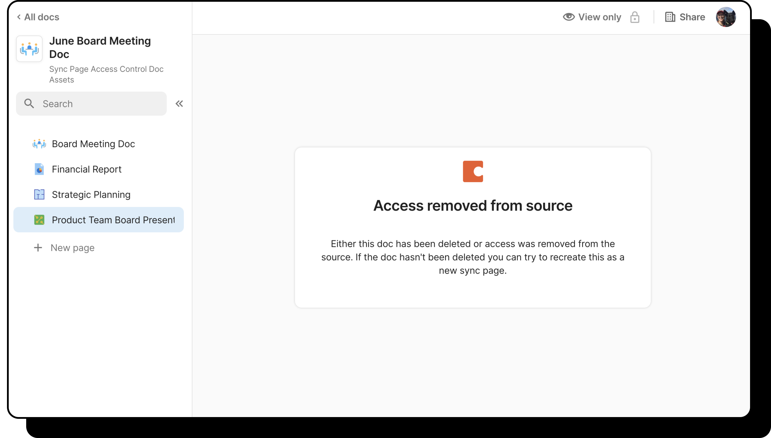

Why am I seeing an error message on my sync page that says “access removed from source”?
Source doc users have the option to remove access to sync pages via the source doc, as explained in the section above. When someone removes sync page access via the source doc, you will see this error message. To resolve this, we recommend re-creating the sync page.
An image of a message that says

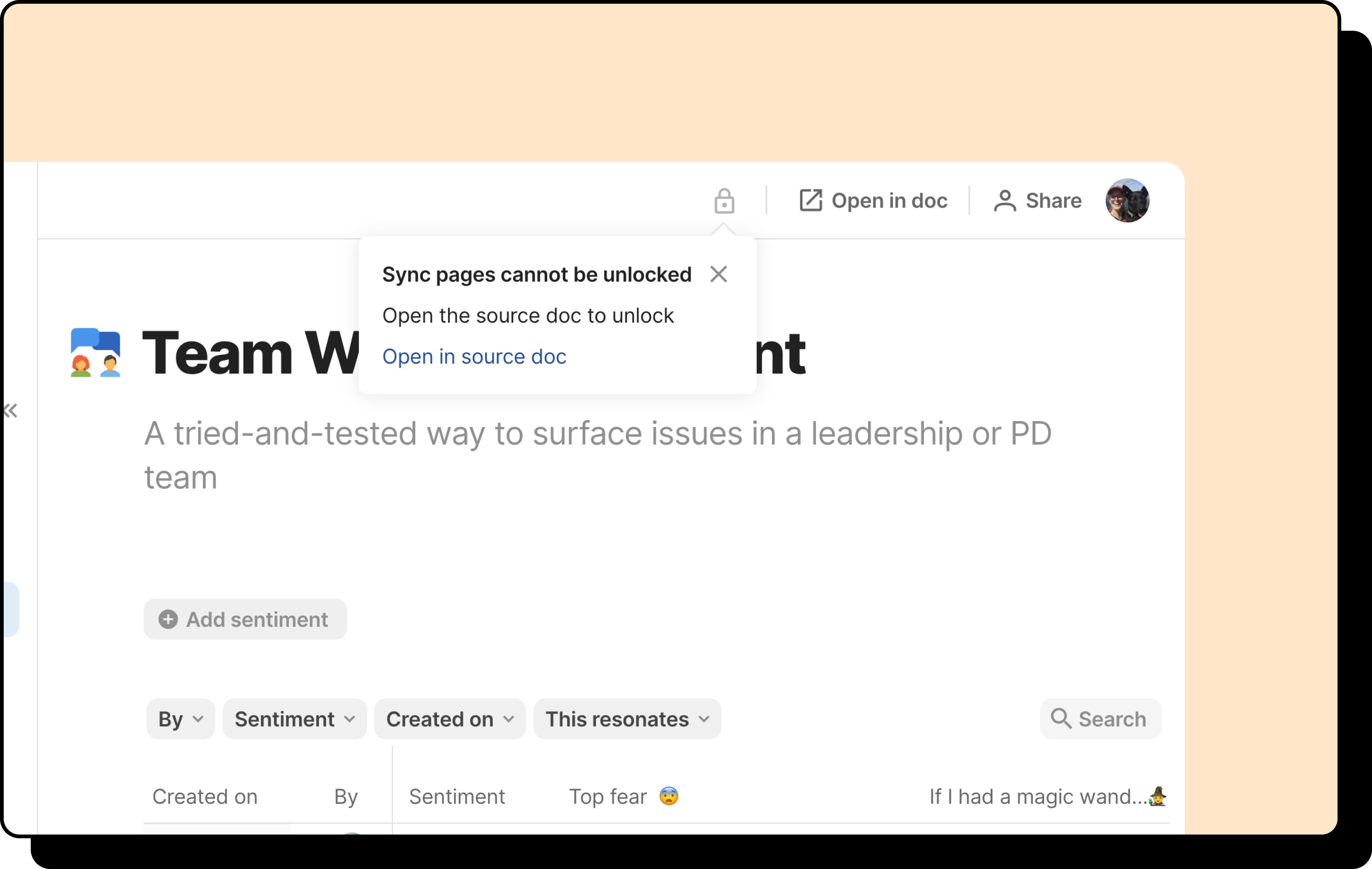

Do sync pages preserve locking settings from the source doc?
Yes. If your source doc or page has locking applied, this locking will be preserved when you add the sync page to another doc. When viewing the sync page, you'll see a locking icon that indicates the page is locked. In order to unlock the page, you'll need to open up the source doc and adjust the locking settings there. You will not be able to unlock or change locking settings from the container doc.
An image of a lock icon with a popup that says
