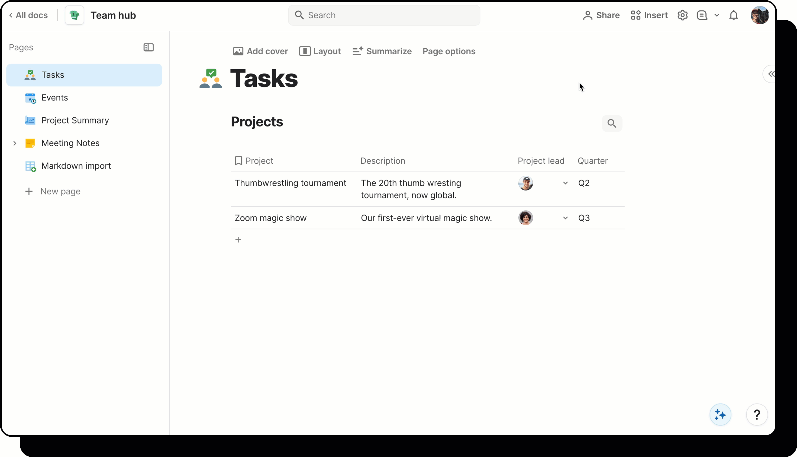

  1. Inside your doc, click on the three-dot menu in the upper right
  2. Select Doc settings from the bottom of the list
  3. Click into the Automations panel
  4. Click + Add rule
  5. For the When step, select Webhook invoked from the dropdown menu. In the URL section, a URL will be generated by Docs that you can use to make POST requests to.
  6. To successfully trigger this automation via an external source, you will need to provide the external source with an API token with write access to the doc using Bearer Authentication. You can create a new API token by clicking Create API token, or use an existing API token. You can also reuse the same API token to trigger multiple rules in the same doc.
    1. Note: You can view and remove API tokens from your account page under Docs API tokens.
  7. Continue setting up the rest of your automation rule based on your preferences. Read more about setting up automations here.
A gif showing how to set up a webhook-based automation from the doc's settings.

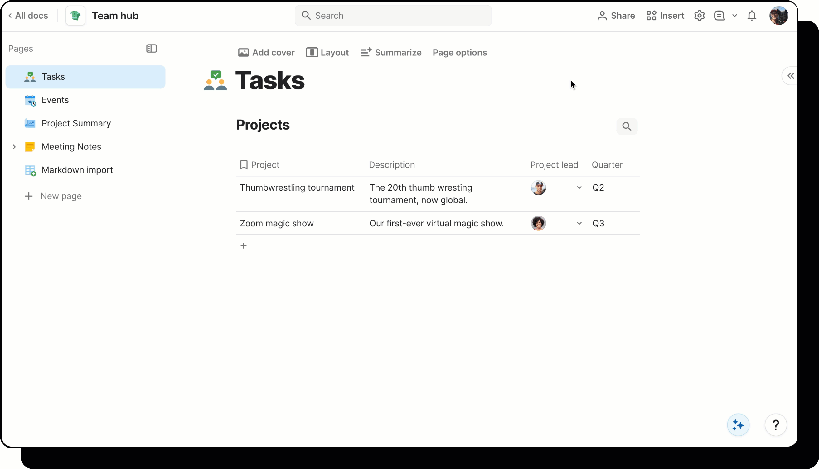

To use the API endpoint, you’ll need to find your automation rule ID.
First, turn on developer mode on your account page. You can find this setting under Labs > Enable Developer Mode.
Once you’ve toggled that on, you can find the automation rule ID by clicking on the three-dots menu for a given rule.
A gif showing how to copy a rule ID from the automation.
