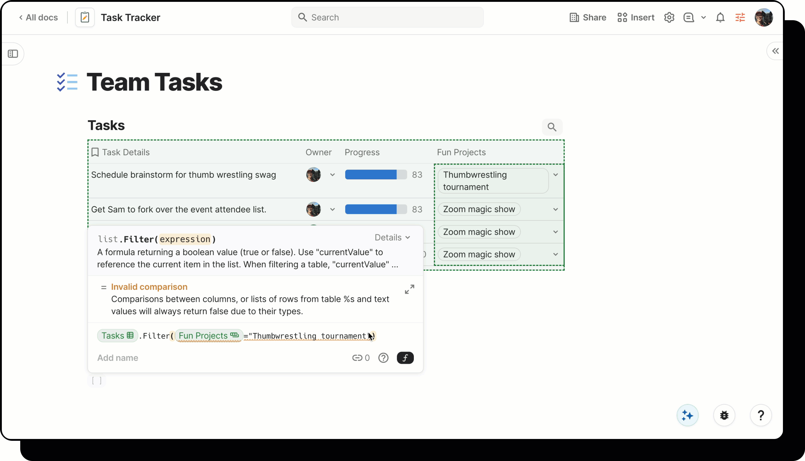

In the example shown below, we get an Invalid comparison warning because we are trying to compare a reference (row reference from a relation column) with a string. When we change the formula to instead compare with a reference instead of a simple string, we get the correct result.

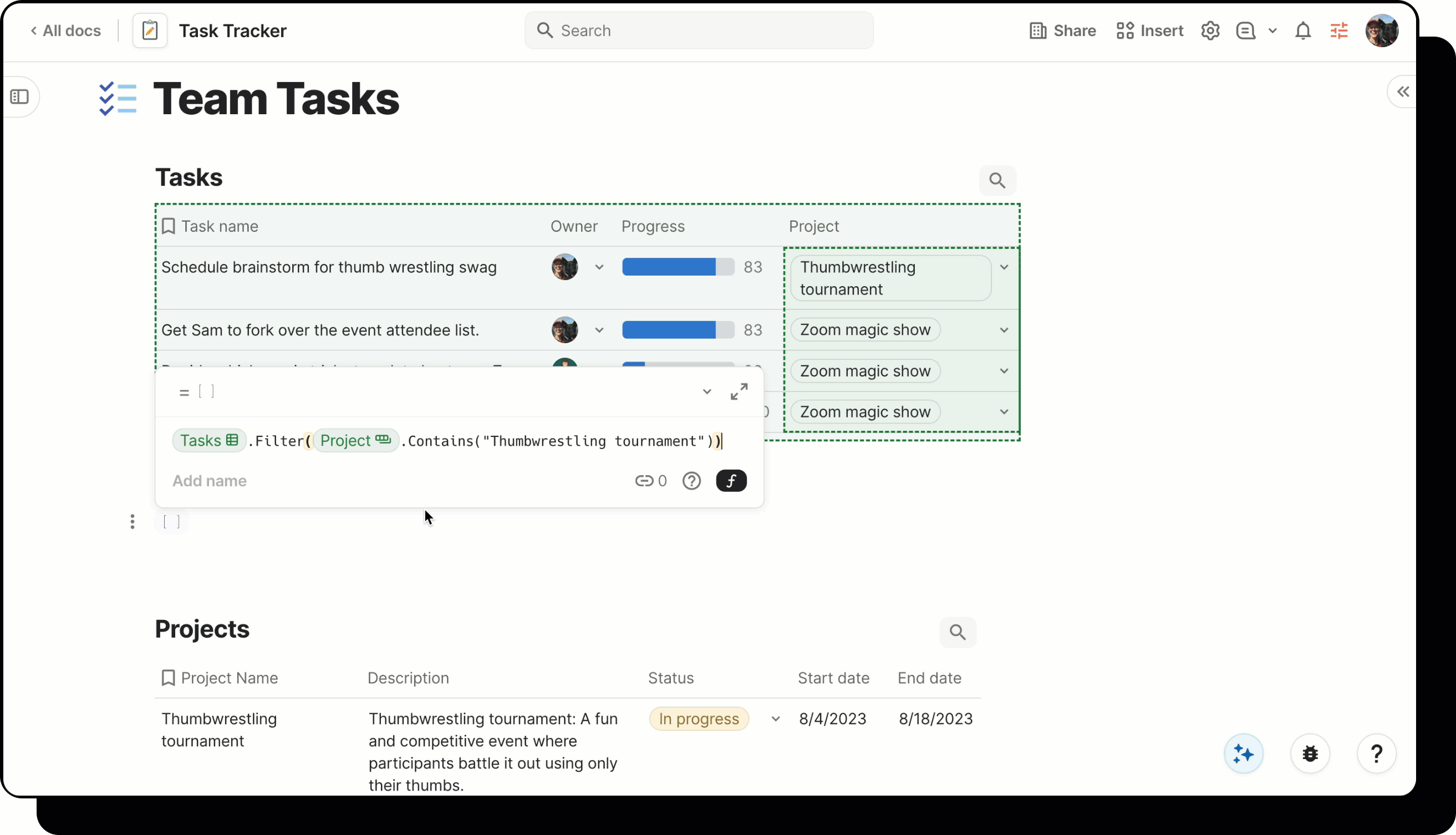

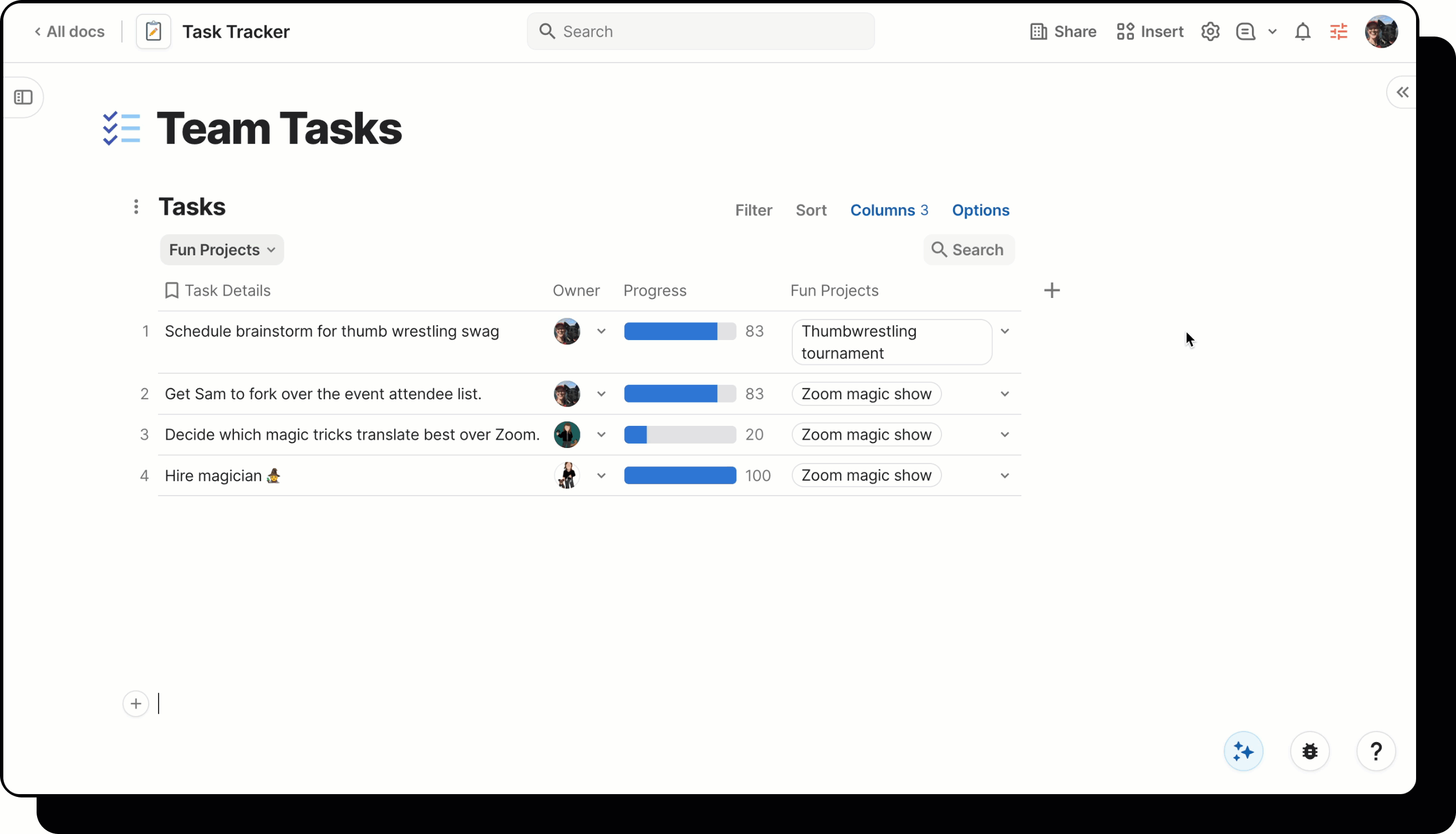

Similarly, in the example shown in the following gif, we start by comparing row references (in the Project relation column) with a string (”Thumbwrestling tournament”) but get no results - because you can’t compare these different data types. Instead, you can use dot notation to go a level deeper within the row reference, pulling out a specific text column (Project name) to compare against the text string. Then we get the result we expect.

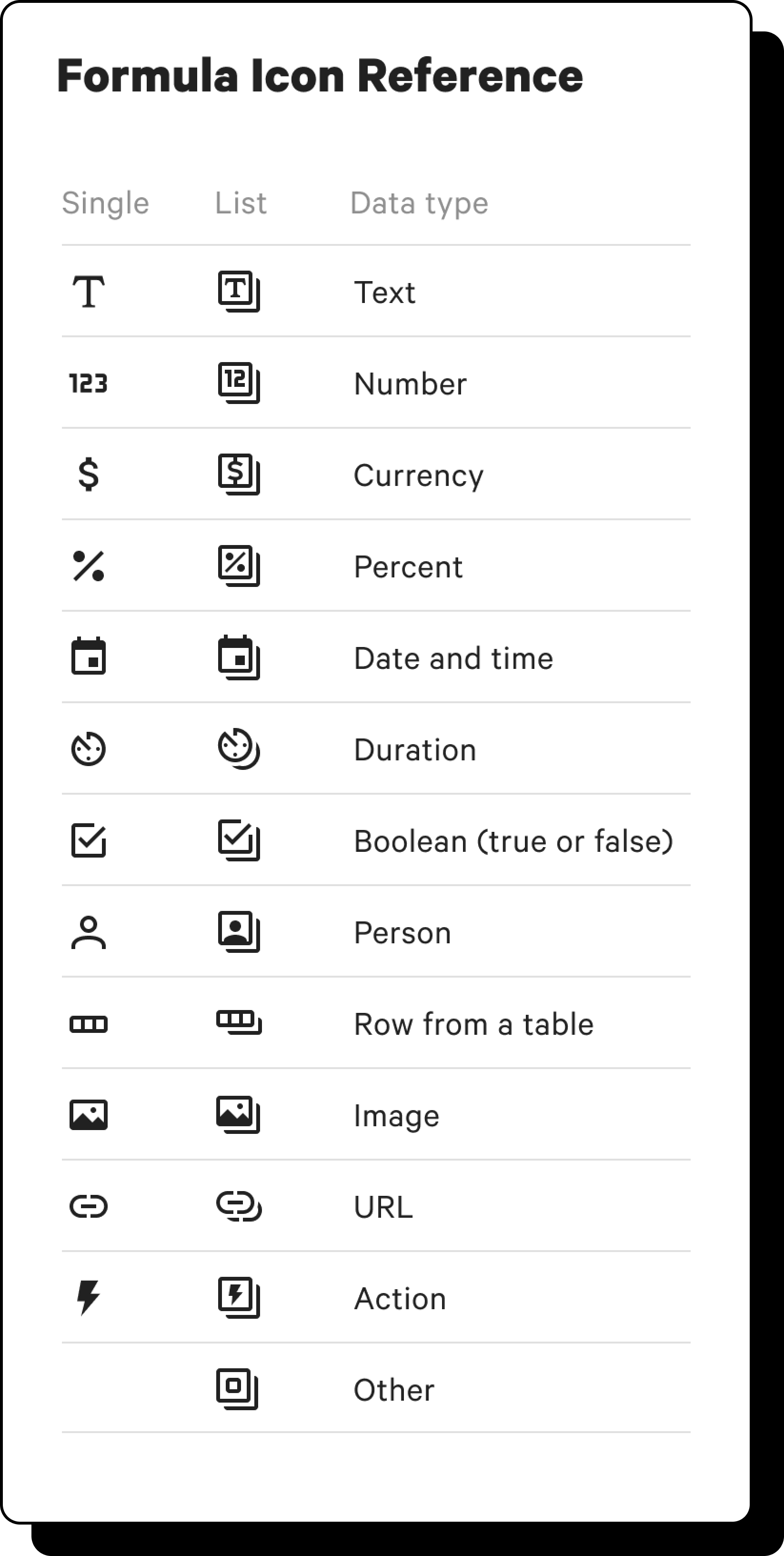

Check the chip icons
Issues often arise when comparing one data type, like text, against another data type, like a number. Similarly, you might encounter problems comparing a list against a single value, regardless of the data type.
Each formula input will have an icon letting you know what data type you're working with. You can use these icons to ensure that you're pulling the correct element (e.g., column, table, row, etc.) and the correct type of data (text, number, row, etc.). Notice in the reference below that if there's only one of those objects, the icon will look different than if there are multiples of that item.
You can find these icons in the headers for each column and within the various components of a formula. You can also click on any chip in a formula to see what that component consists of.​

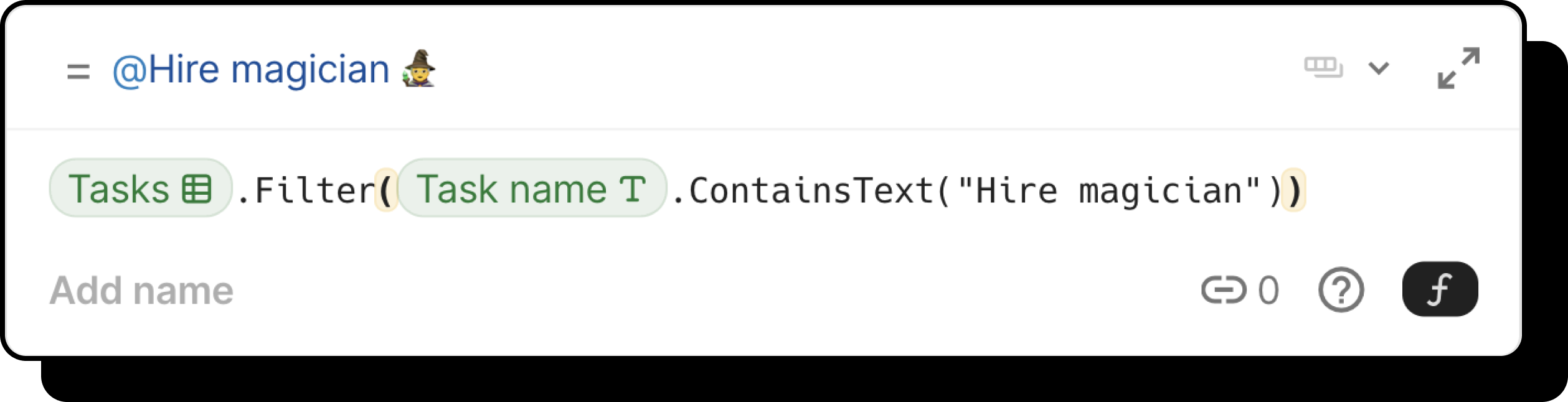

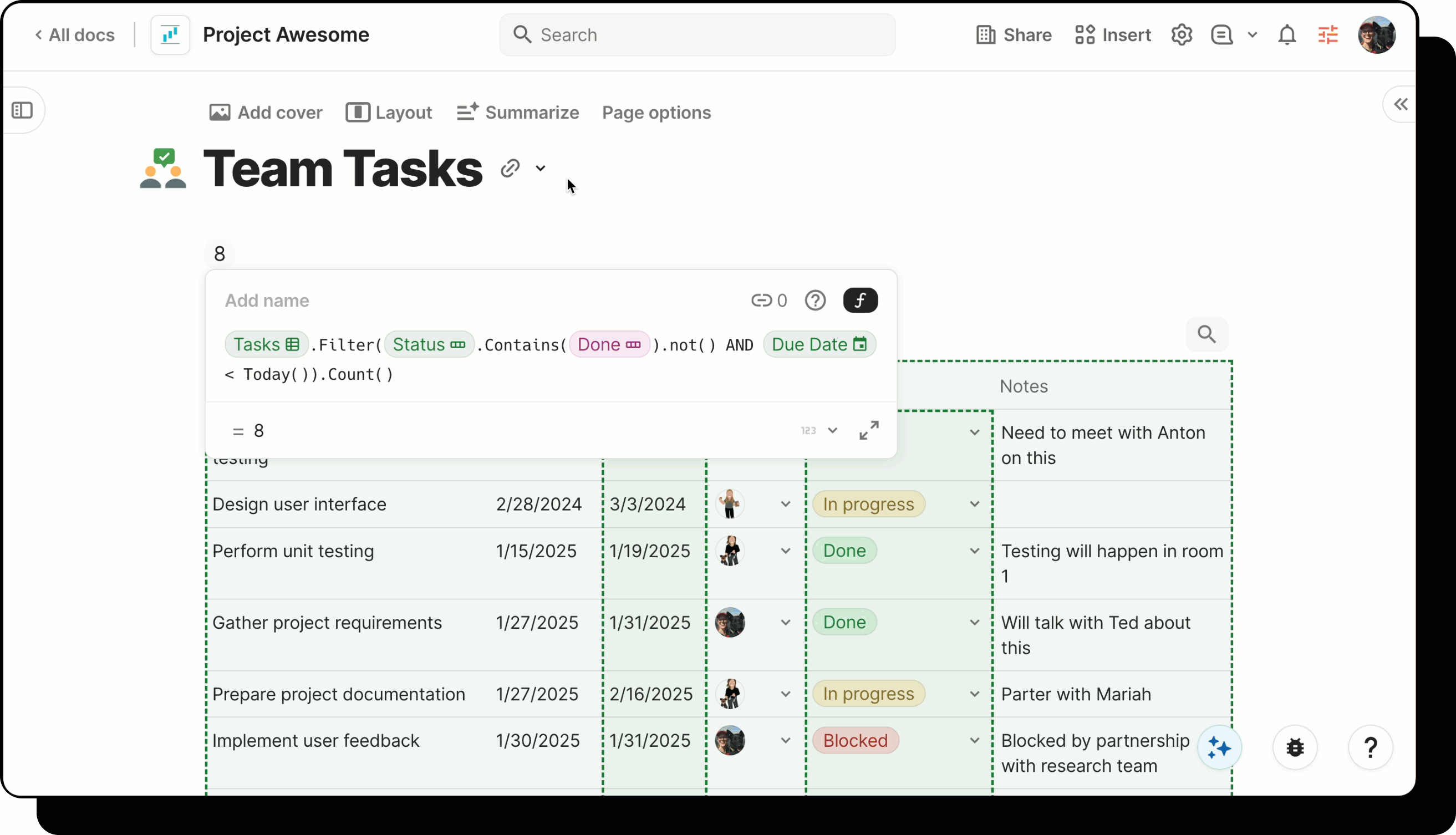

Find hints in the formula builder
When you start troubleshooting your formulas, it's a great idea to check out the hints the formula builder provides. They can really guide you along the way!
  • Chips vs. text - Columns, tables, canvas controls, and canvas formulas appear as “chips” (or colored bubbles) in Docs' formula language. This makes it easy to see at a glance if you're referencing a variable or if you should be seeing a string in quotation marks.
  • Chip colors - Docs color-codes chips to show where values are coming from. Chips with the same color mean those variables are from the same table.
  • Chip icons - Icons show the data type and whether the data being returned for that chip is singular or multiple. Refer to the Check the chip icon section above to learn more.
  • Highlighted parentheses - When you place your cursor next to parentheses in the formula builder, its closing or opening pair will be highlighted in yellow. This is particularly helpful in tracking down the cause of a "missing parentheses" error.
  • Cursor placement to prompt help text - Placing your cursor in or next to a formula in the formula builder will prompt help info to pop up just under the builder. You can use your arrow keys to move through the formula. As you do, parameters will be highlighted to let you know what the formula is expecting to see.
  • Check the result - As you write your formula, the formula builder will populate the result so you can check your work before committing.
In the example above, the details in the formula builder tell us that...
  • Tasks refers to the green highlighted table. We also see the table’s location, the number of rows, and the number of columns.
  • Status refers to a column, also in the green highlighted table. This column contains rows from the Status table.
  • Done refers to one of the rows within the Status table. This is a separate table, hence the different color of this chip.
  • Due date is also a column in the green highlighted table, and it contains datetime values.

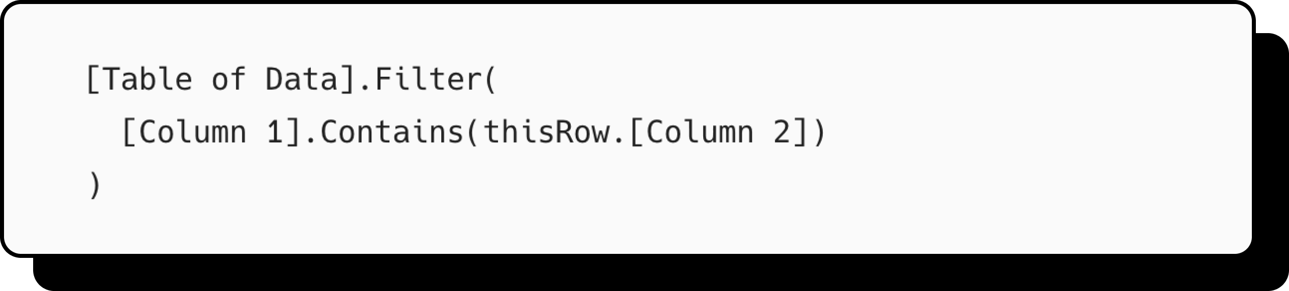

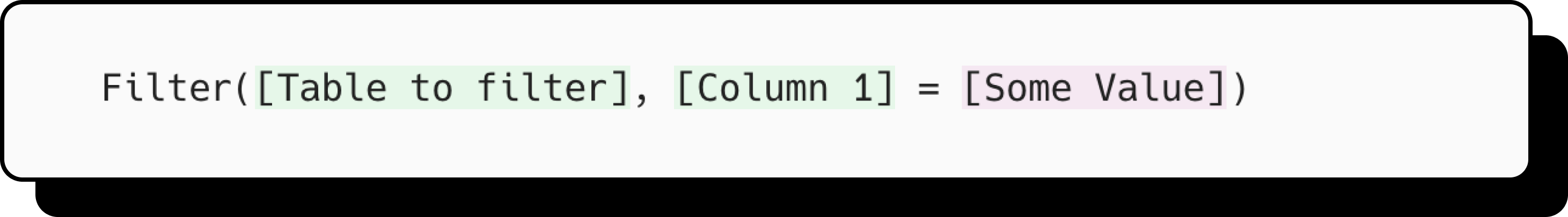

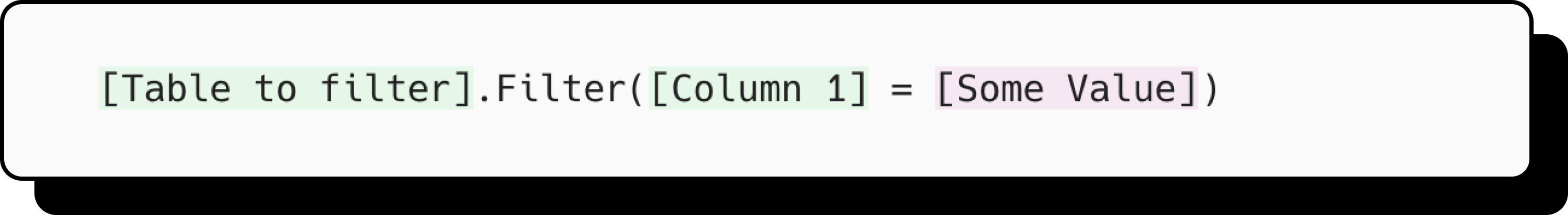

Use dot notation instead of parentheses when possible
Using dot notation, or the chaining method of writing formulas, makes it easier to see what table or list is referenced and the expression being assessed. The more separation between the two, the easier it is to spot discrepancies.
When both the table to be filtered and the filter expression are inside the parentheses, it can be more difficult to visually tell where one stops and the other starts.
Separating the two with dot notation makes it easier to separate and focus on either one individually.

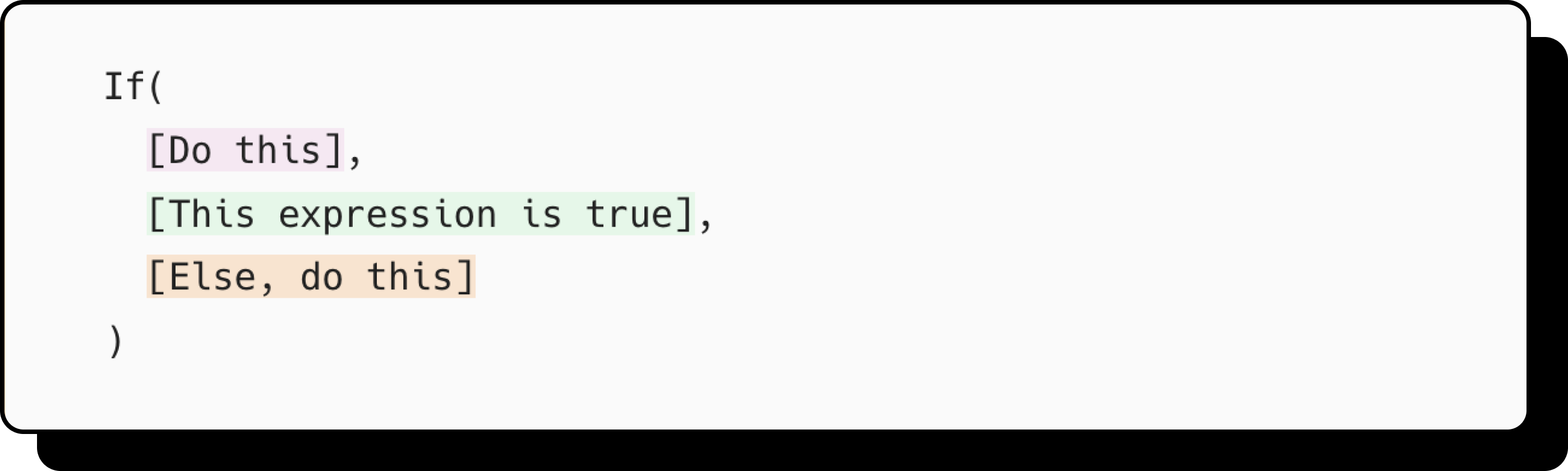

Indent nested formulas
For instance, an If() statement might contain formulas for each expression. Moving these to a new line and indenting them helps highlight where the If() starts and finishes.
New lines also help to separate where each expression in the If() statement starts and ends. This is also true for any formula containing nested formulas, which is quite a few!

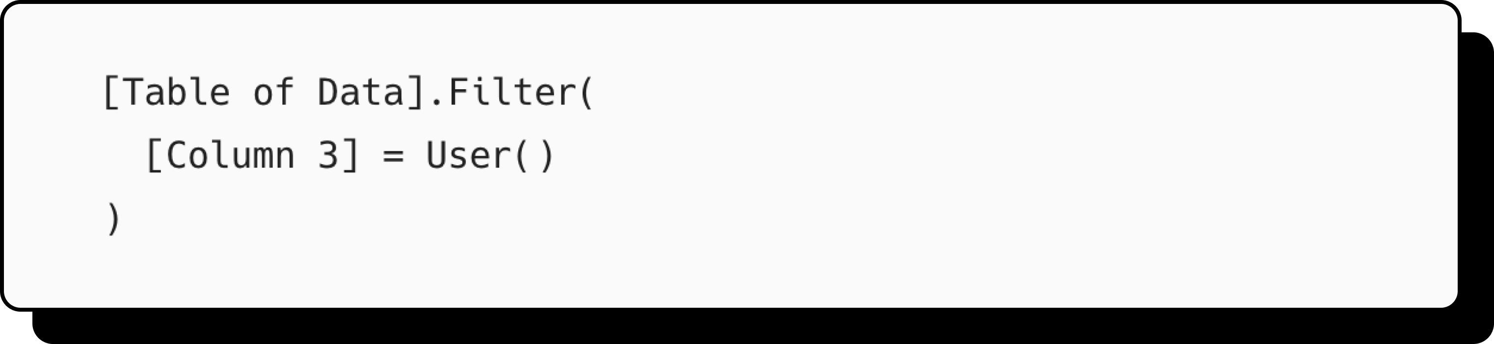

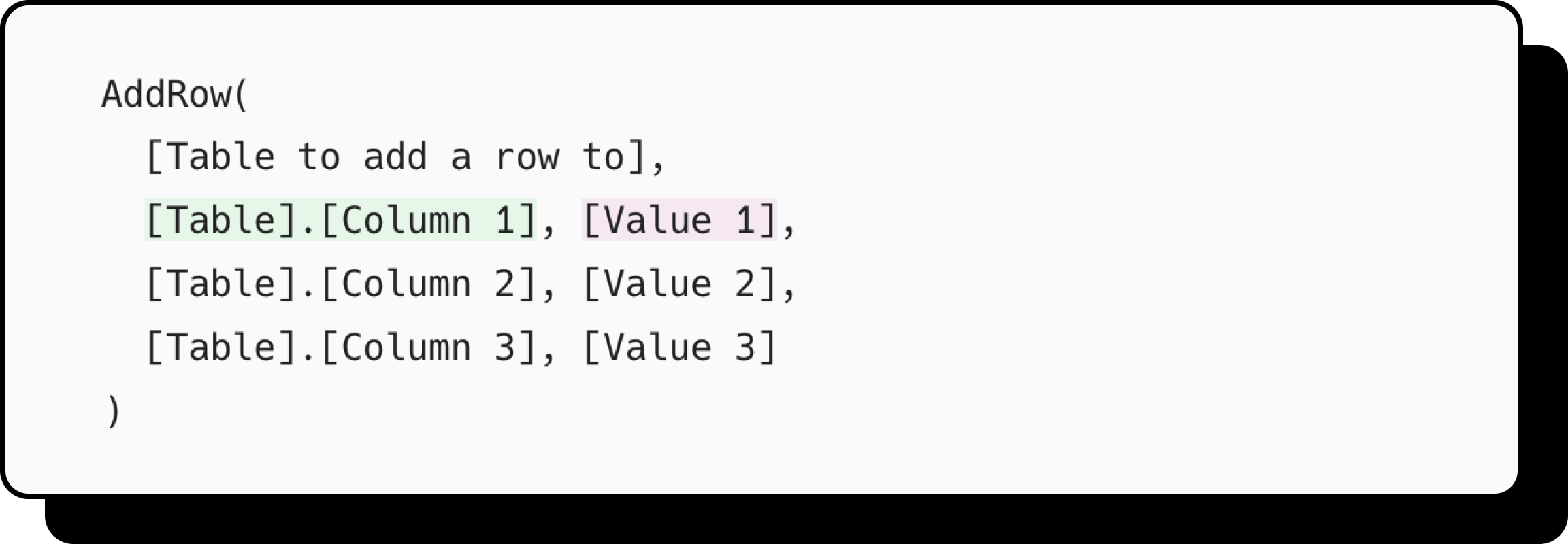

Match pairs
Some formulas have parameters that can be repeated in pairs. For these, keep them on the same line to better spot what column you're targeting and what value you're placing in it.
Not only is it easier to read, it's easier to continue to build out the formula because the pattern stands out.

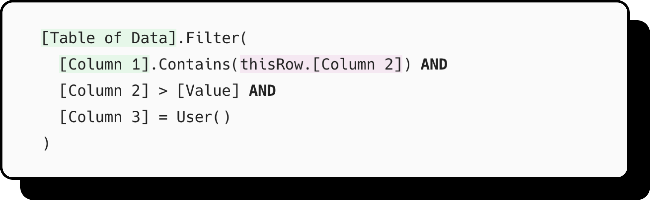

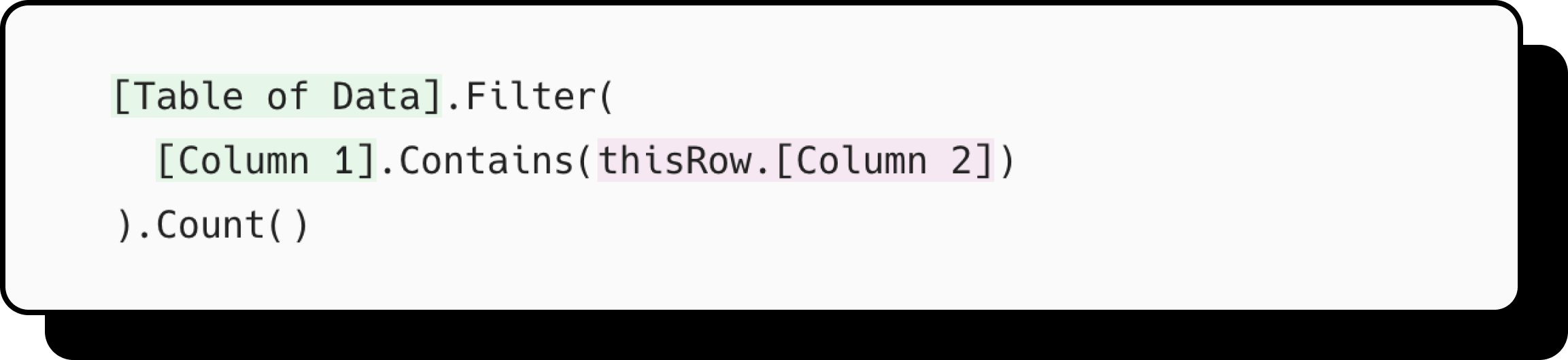

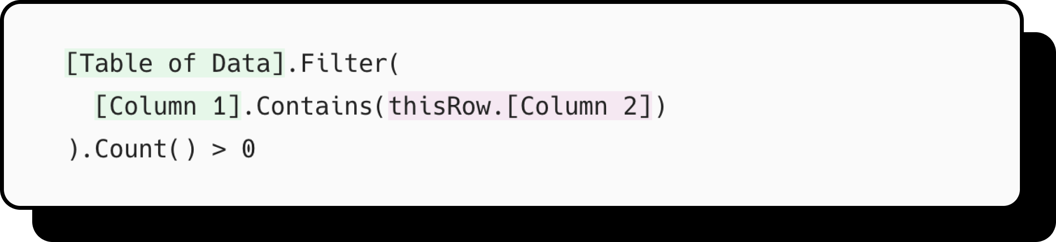

Move your closing parentheses to a new line
Dot notation allows us to continue tacking on more functions. If we move the closing parentheses of a formula to a new line, we can more clearly see the next formula.
In this example, we can clearly see that the objective is to count the items returned. If the intent is to find if that count is <, >, or = to some value, that will stand out clearly, too.

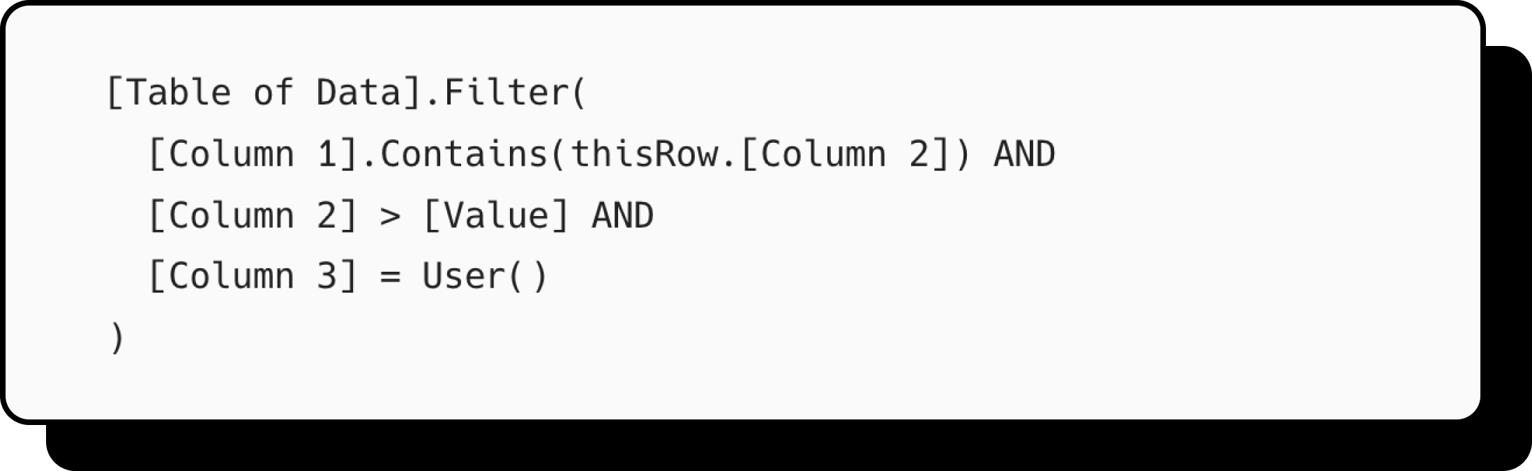

AND & OR logical operators use new lines
Logical operators sit in between expressions. Using new lines for each expression can help you focus on each one individually and the relationship between them.
