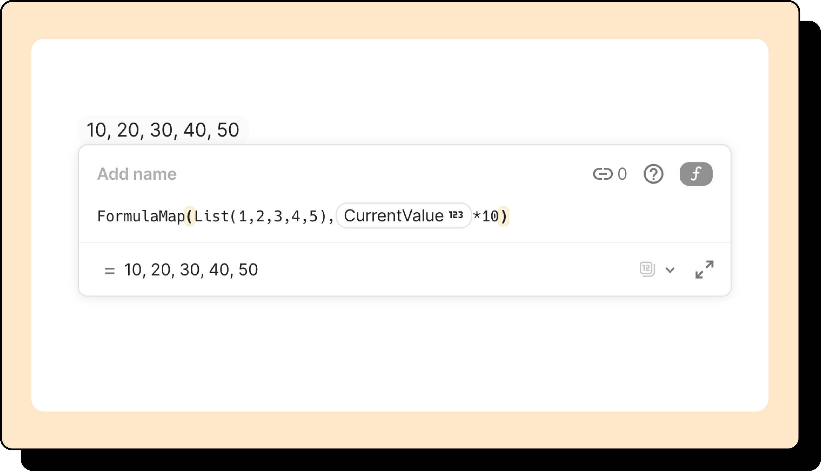

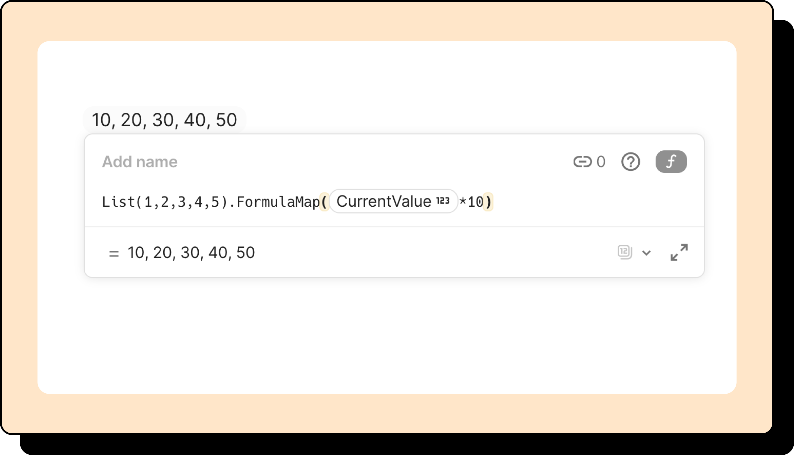

Imagine you have a list of numbers and you'd like to perform the same operation on each one. For example, you might want to multiply every number by 10. You could accomplish that with FormulaMap(), where the specified action is CurrentValue * 10. Check out the two different ways to write this formula below. The first example uses dot notation for easy comprehension, but the second example works as well.

In the example above, FormulaMap() is looking at the given list of numbers, starting at the first value, 1, and then multiplying by 10. Once it takes that action, it moves to the second value, 2, and multiplies that value by 10.
This cycle continues until FormulaMap() has taken that action for every value in the given list.
