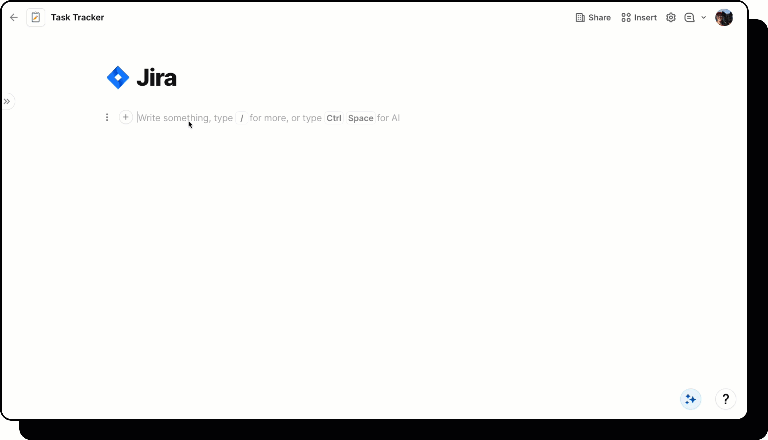

Once you’ve installed and connected to the Jira Pack, just follow these steps to create the Issues table:
  1. On a new line in the canvas of your doc, type /issues. From the list of options, choose Issues (under the Table header).
    1. Alternatively, you can click Insert in the upper corner of your doc, search the Pack name (Jira or Jira Data Center), find the Issues table, and click and drag it into your doc.
  2. Note that if you haven’t yet connected the Pack to your Jira account, you’ll be prompted to do so. Follow the instructions here to get connected.

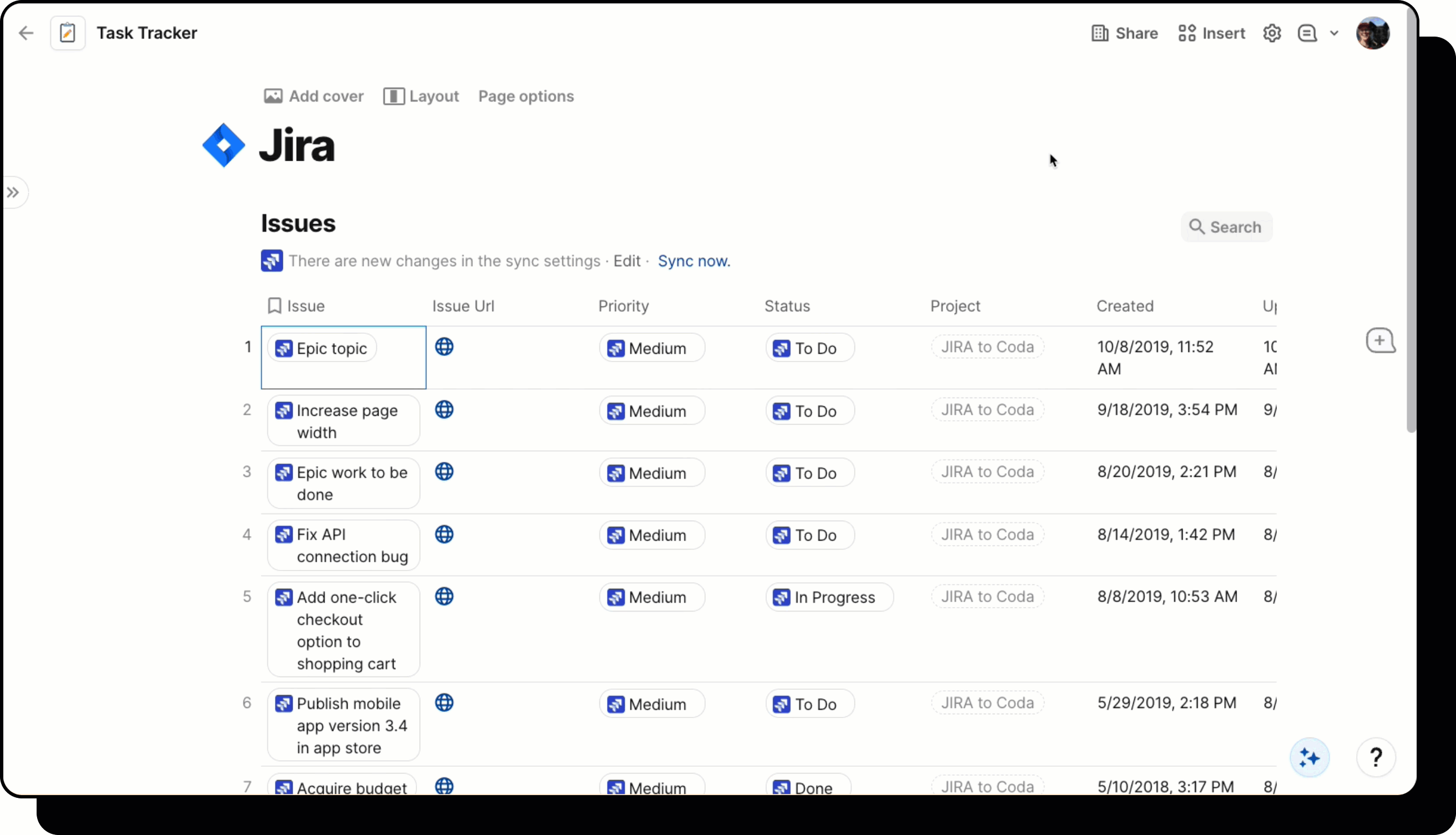

  3. The Set up your table dialog box will pop up and you can select the columns you wish to sync. Then click Create issues table.
  4. Customize your sync as needed, by adding criteria to selectively filter issues into your table (more on this below). It’s common to select a specific project, under the Project dropdown, before syncing. If you leave the criteria blank, it will sync in all issues. Click Sync now.
That’s it - you should now see a table of Jira issues with your selected columns. Read on to learn about customizing your sync.

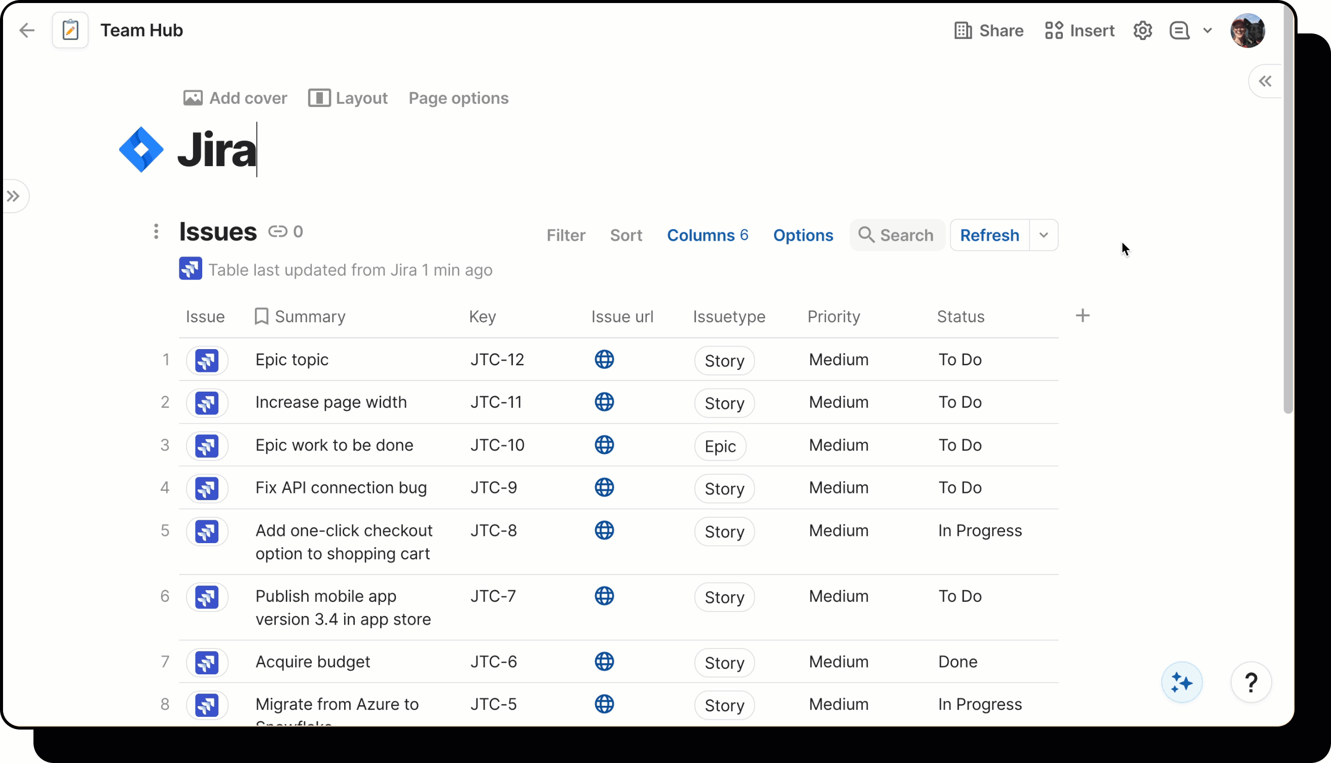

Customize your sync table
You can customize your issues table via the sync options at any time. For instance, maybe you want to filter out some of the Jira data and just keep a subset of the relevant issues in your table.
To open these options, hover over the table and click on the down arrow (v icon) in the upper right corner, then select Settings. Here you’ll see some standard Pack settings:
  • Refresh rate: Choose whether you want the data in your table to be refreshed manually, daily, or hourly
  • Two-way sync: Enable two-way sync to make edits directly in Coda and push those edits back to Jira. Read more below.
You’ll also see Jira-specific fields that you can use to filter which issues you sync into your table. You can use any of the visible criteria, or explore other criteria options by clicking the Add Criteria button. Each option should have more info available when you hover over the ? next to it. Here are some commonly used criteria:
  • Project: Use this drop-down list to choose up to one project per Jira sync. When you do, only issues associated with this project will be synced into your table.
  • JQL query: Use the Jira Query Language (JQL) to filter down your table. Read more here.
  • Fields: Rather than filtering the issues you sync in, use this criteria to specify which fields you want to see for each issue. Any fields you add here - plus the standard set of Jira issue fields - will be synced in for each issue in your table.
Once you’ve added the new criteria, click Sync now to resync your table accordingly.
