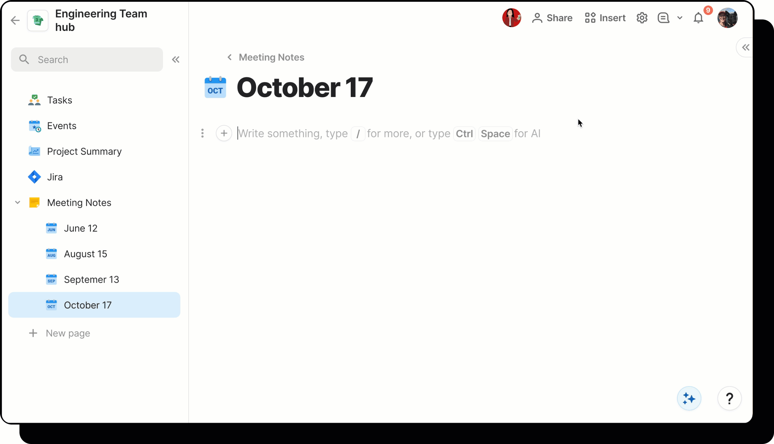

In-doc notifications live in your notification center. This can be found while in any Coda doc, by clicking on the bell icon 🔔 in the upper-left corner of the doc.
Whenever you have unread notifications, you’ll see a badge next to this bell, indicating that you have unread notifications.
When you open your notification center, you’ll see a feed of in-doc notifications, starting with the most recent. You can use the toggle at the top of the list to choose between All (all notifications across all docs), and This doc (only notifications pertaining to the current doc).
Clicking on a notification will take you to the location where that notification was triggered. So for instance, if the notification was caused by a comment on a row, you’ll be taken to that specific row in the doc. If the notification stems from another doc, a new tab will open and lead you to that location. If the notification stems from the current doc, you will simply jump to that location while remaining in the same tab.

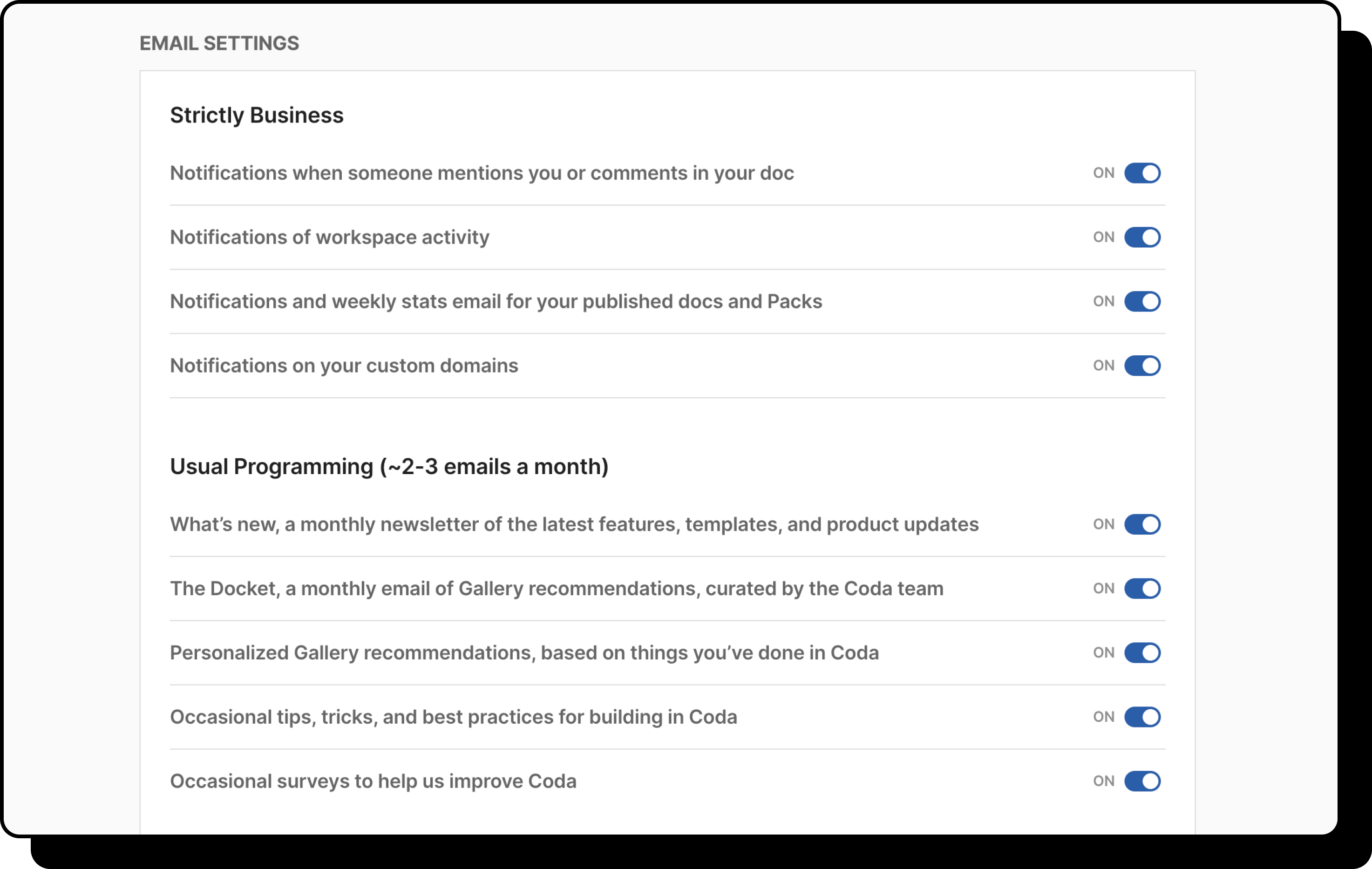

Adjust email notification preferences
You can adjust your email notification preferences in your account settings. Just follow these steps:
  1. Click on your avatar in the lower-left corner of a doc, and select Account settings
    1. Alternatively, go to coda.io/account
  2. Scroll down to the Email settings section
  3. Under the Strictly business category, you can toggle on or off as needed. If you don’t want to receive email notifications for in-doc mentions or comments, toggle off the first option.
That’s it. The changes will take effect going forward.
