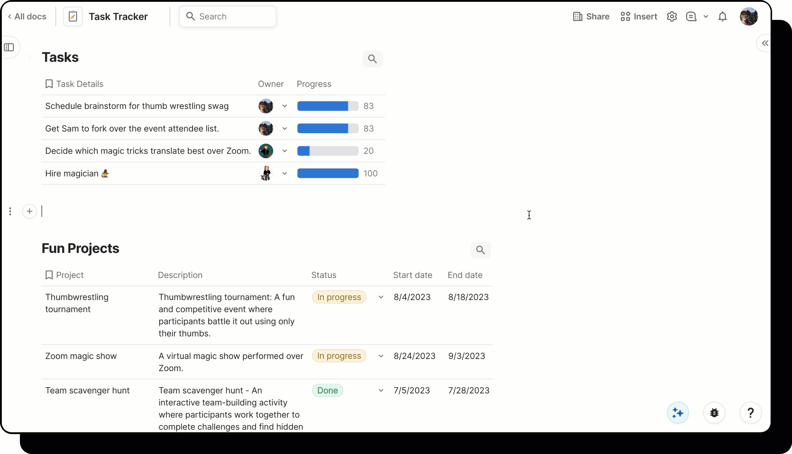

Create a linked relation
Let’s say you have two tables: a Tasks table and a Projects table. You’ve added a relation column to your Tasks table, which references the Projects table. For each row in the Tasks table, you use that relation column to indicate which Project goes with each task.
But now, you want to know which tasks are associated with each Project. In other words, you want to add a linked relation column to your Projects table. No problem! Creating a linked relation is easy.
💡 If you haven't yet created the relation column, you can set up both the linked relation and the relation in just a few simple clicks. Just create a new column in the table where the linked relation will live, and select Table from the list of column types - which will show you a list of tables in your doc. Choose the table you want to connect to. When you do so, a relation column will be added to that selected table, and a linked relation column will be set up in the current table.
Gif showing user adding relation column.
If you have already created the relation column, you can simply follow the steps below to set up the linked relation. If you haven't yet created the relation column, check out the callout above.

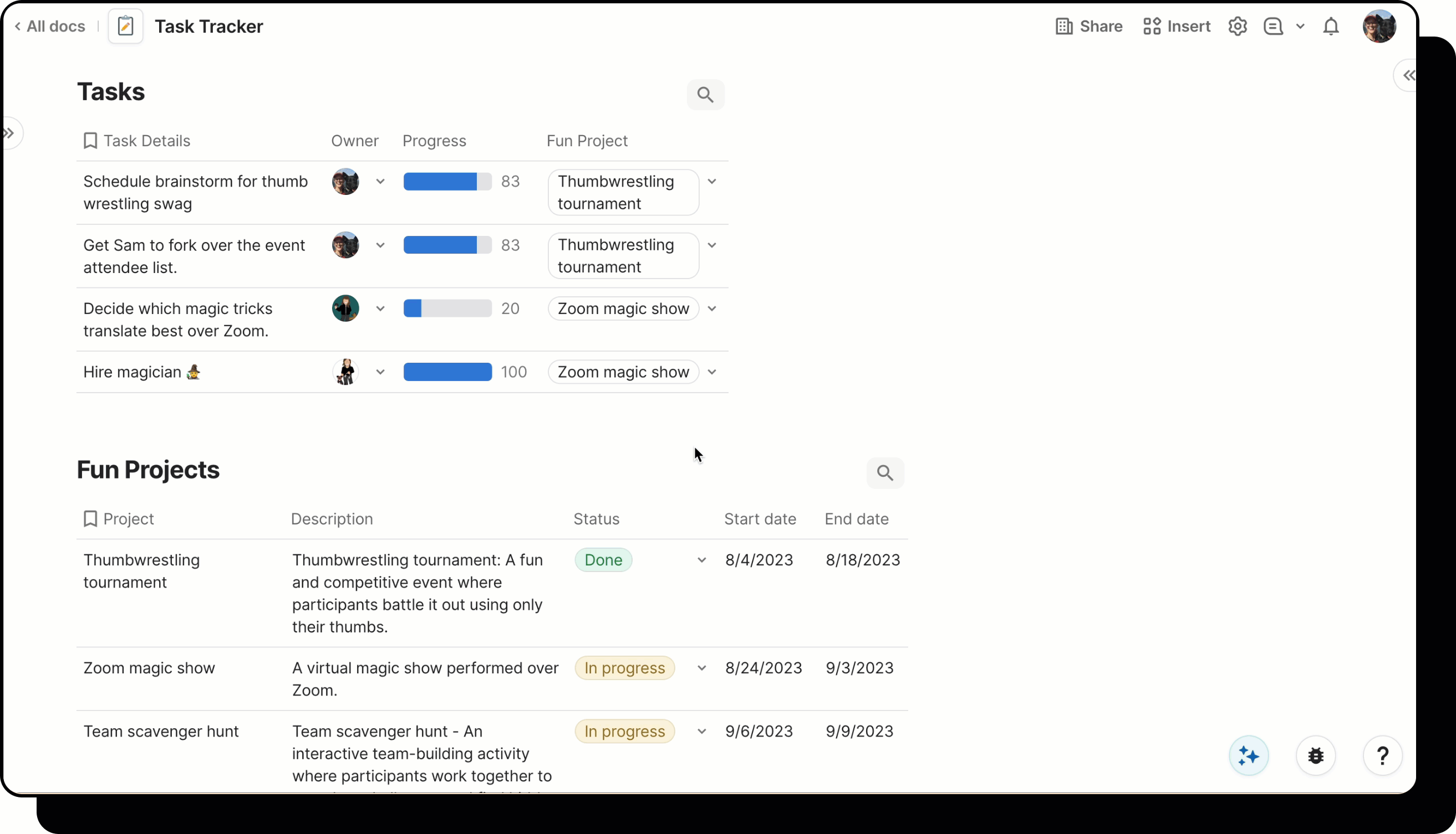

  1. Click on the + icon in the upper right corner of your table to add a column.
    1. In our example, you’ll be adding this column to the Projects table.
  2. From the list of column types, choose Linked relations.
  3. You’ll then see a list of all other tables (and columns) that reference this current table. Select which relation column you want to utilize from the list.
    1. In our example, you’ll want to look for the Tasks (Project column) option.

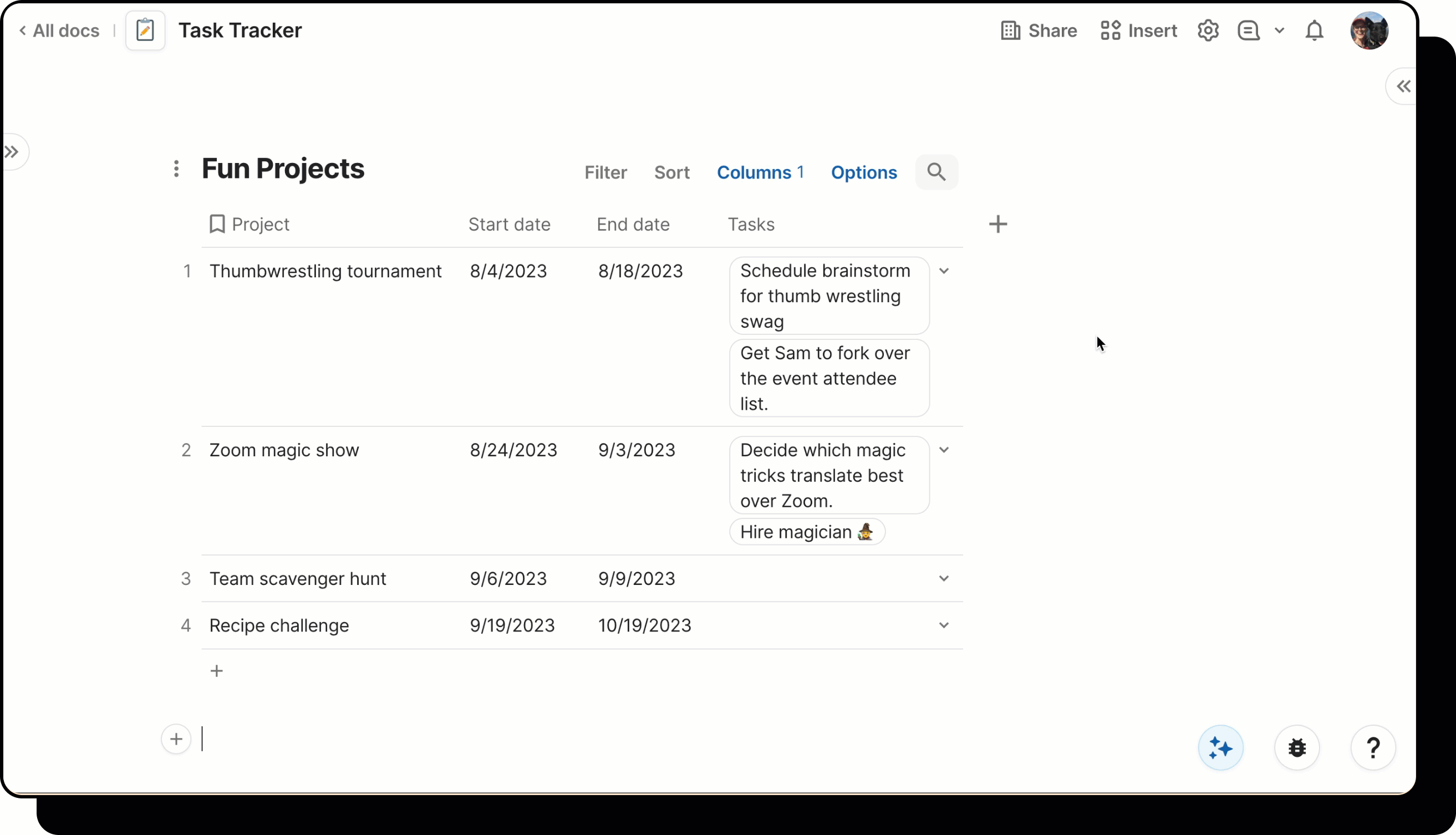

  4. That’s it! Your linked relation column has been added.
Gif showing user add linked relation column.
You’ll see that this newly created linked relation column automatically contains the data you’d expect to see - based on what you’ve added to the original relation column.

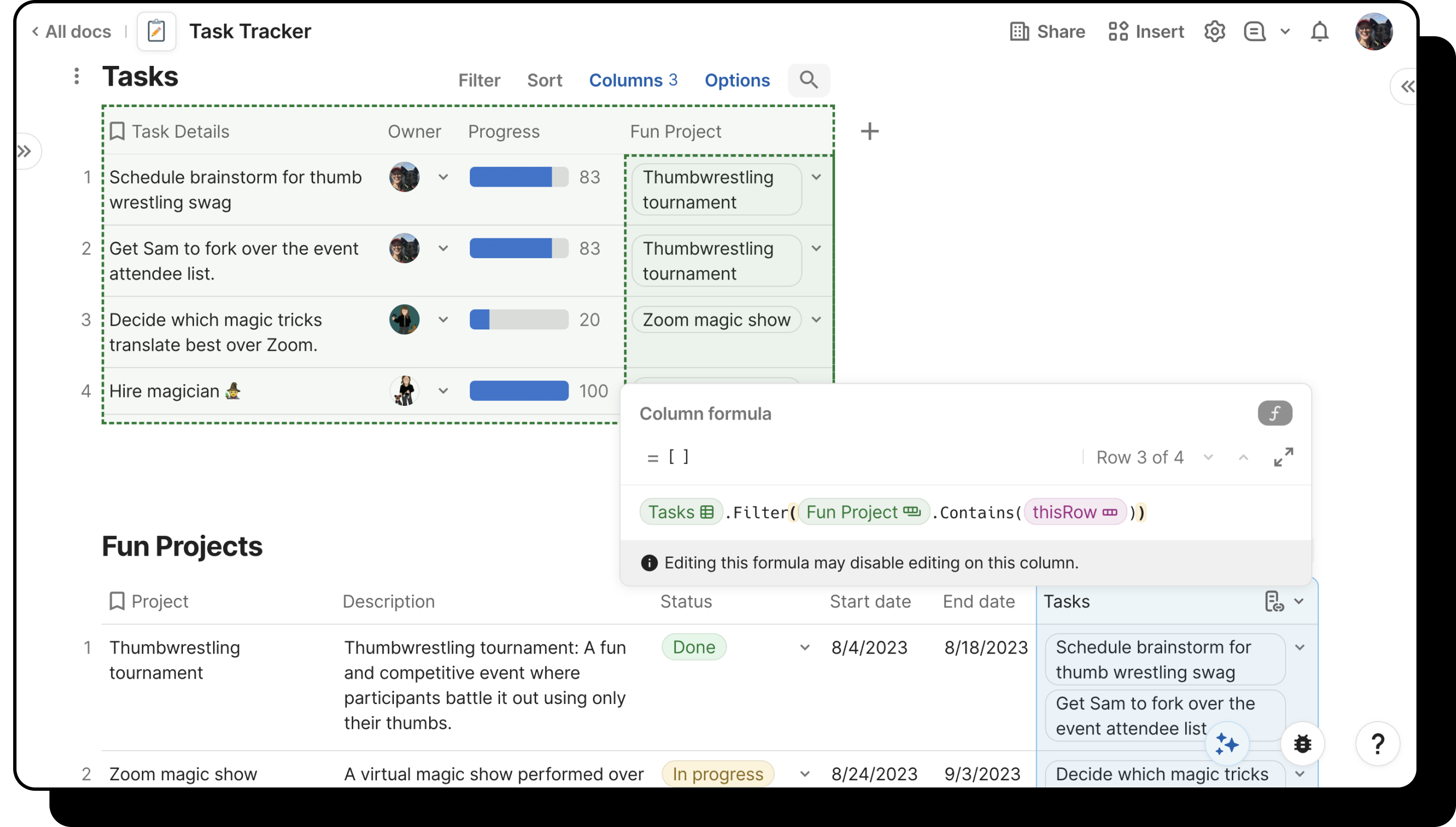

Explore the linked relation formula
Behind each linked relation column is a formula. This formula is automatically built when you create a linked relation column, so there’s no need to write or edit yourself. But if you’re curious, you can explore the formula by right-clicking on the column header, then selecting Edit formula.
You’ll see there that linked relation columns are really just filter formulas. The formula takes the referenced table, and filters it to only show rows that contain references to the current row in your table. You can even click around on the various components of the formula, and the formula builder will provide some info to help you understand each piece. If you’re curious about Superhuman Docs formulas, check out this article.
Image of formula in linked relation column.

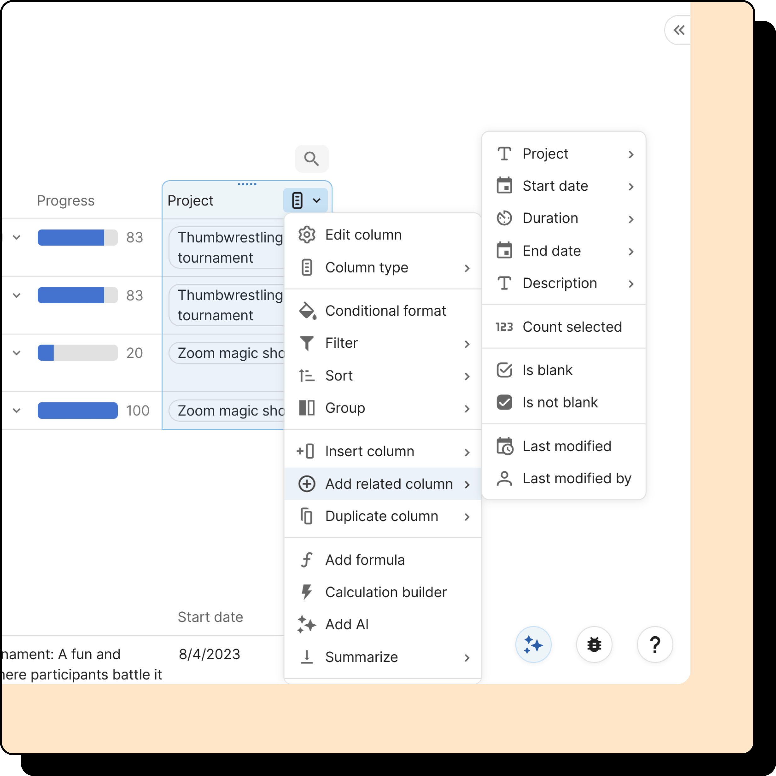

Add related columns
Linked relation columns contain row references. The value of the display column is what’s shown. But when you hover over an item in a linked relation column you’ll see the full contents of the row, including the other columns. So what if you want to pull in one of these specific columns - something other than the display column - and show that in your table? No problem!
To do this, just follow these steps:
  1. Right-click on the header of your linked relation columns
  2. From the drop-down menu, select Add related column
  3. You’ll then see a list of all the columns in that other table. Choose which column you’d like to add.
That’s it! That new column will now automatically populate based on which items are contained in the linked relation column for each row.
