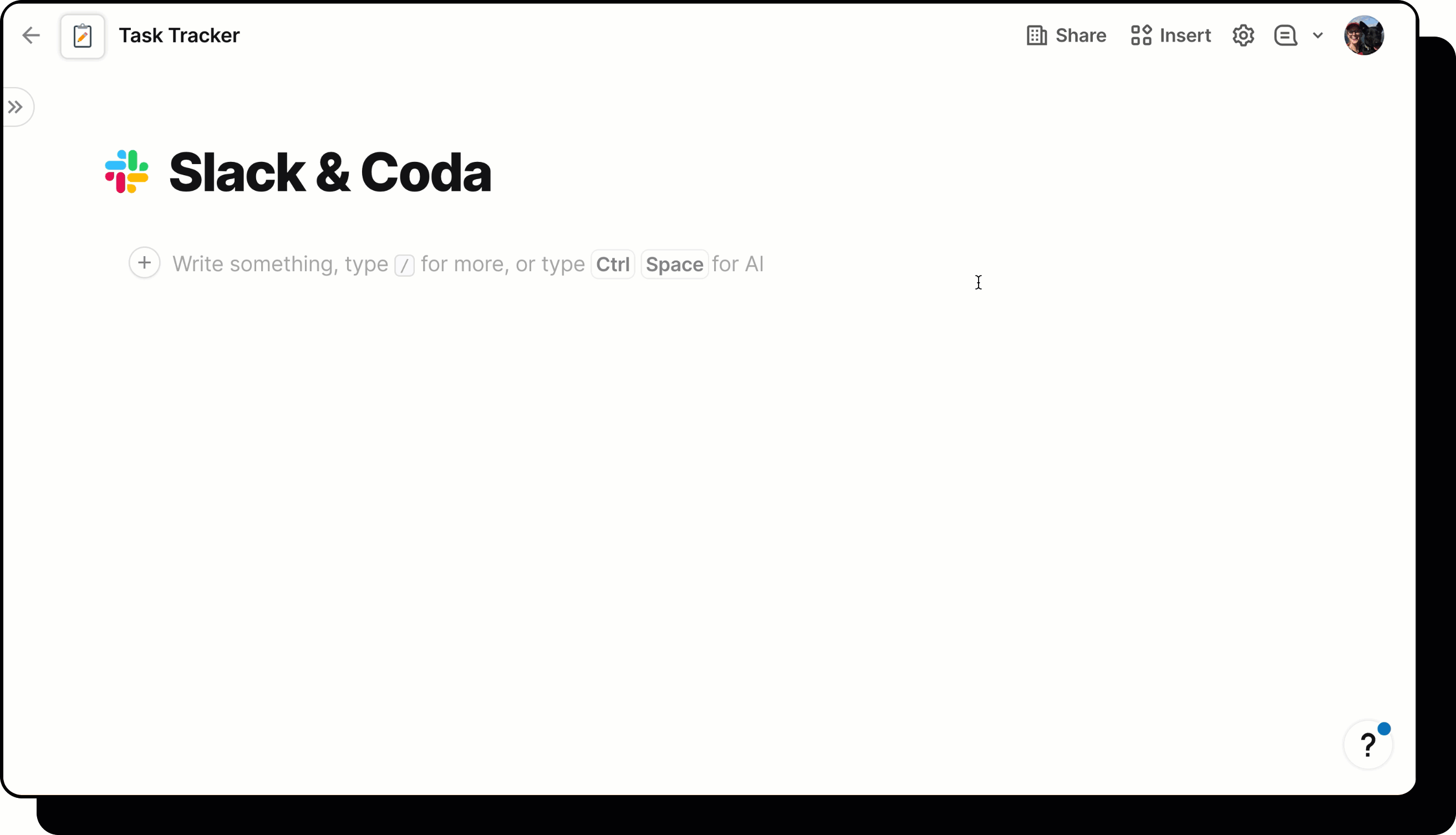

To use the Slack Pack, you’ll first have to add it to your doc. Just follow the steps below to do so:
  1. Click Insert in the upper right of Coda and choose Packs
  2. Type "Slack" in the search bar
  3. Choose Slack and click Add to doc
That's it - the Slack Pack is now installed. To start putting it to use, check out the following section.

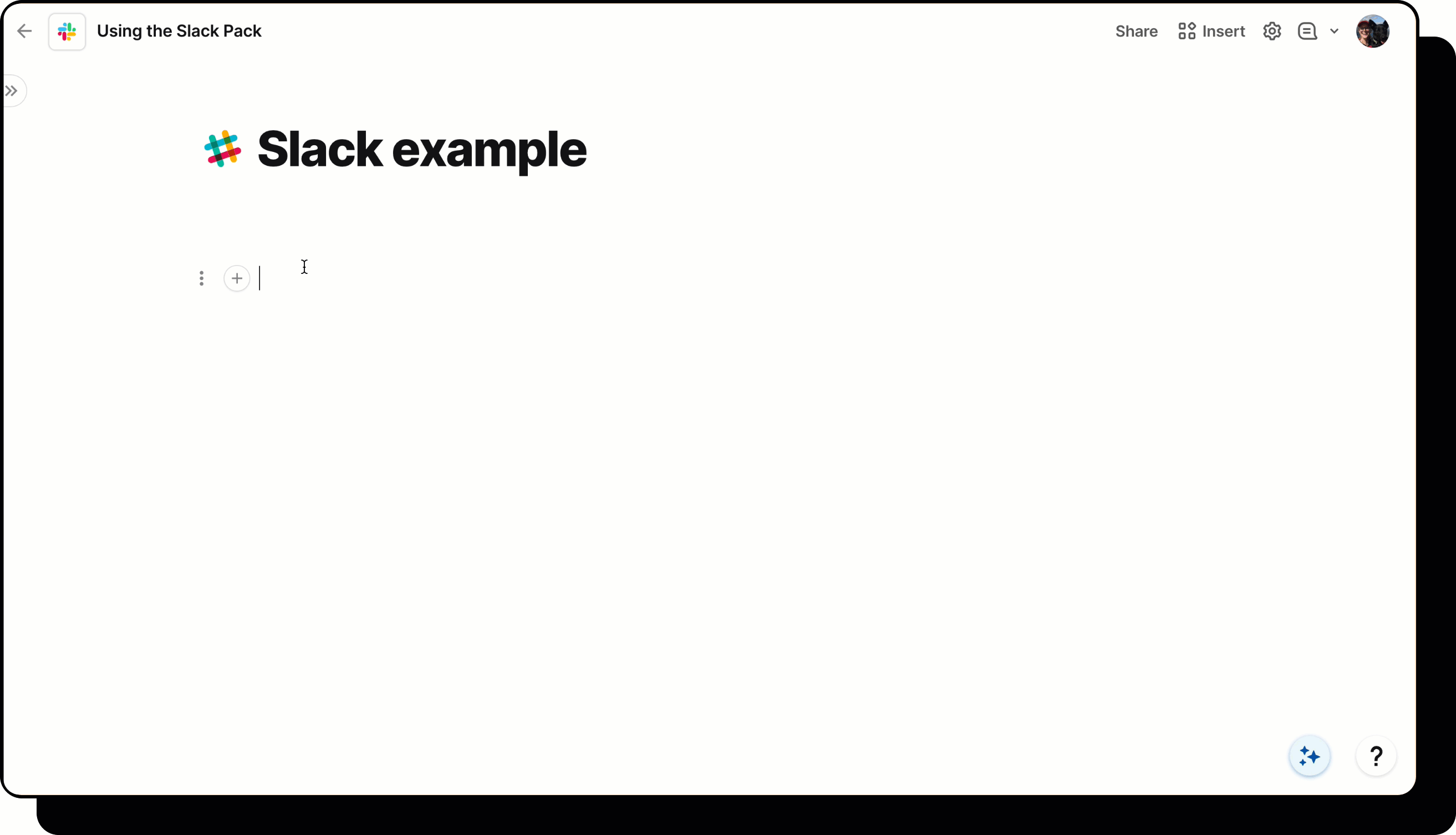

Once you’ve installed the Slack Pack, you’re ready to start using any of its many building blocks. To see what this Pack has to offer, head to the Pack page by following these steps:
  2. Select Packs
  3. Under Installed Packs, select Slack
  4. Scroll through the Building blocks tab to see all the ways you can start using the Pack
You’ll see templates, tables, buttons, formulas, and more. You can click and drag any of these building blocks into your doc. You will then be prompted to connect to your Slack account in order to access that data. Follow the prompts to connect your account. If this is your first time connecting to the Slack Pack, you'll be prompted to sign in to your Slack account. And if you need a refresher on connecting to Pack accounts, check out this article.

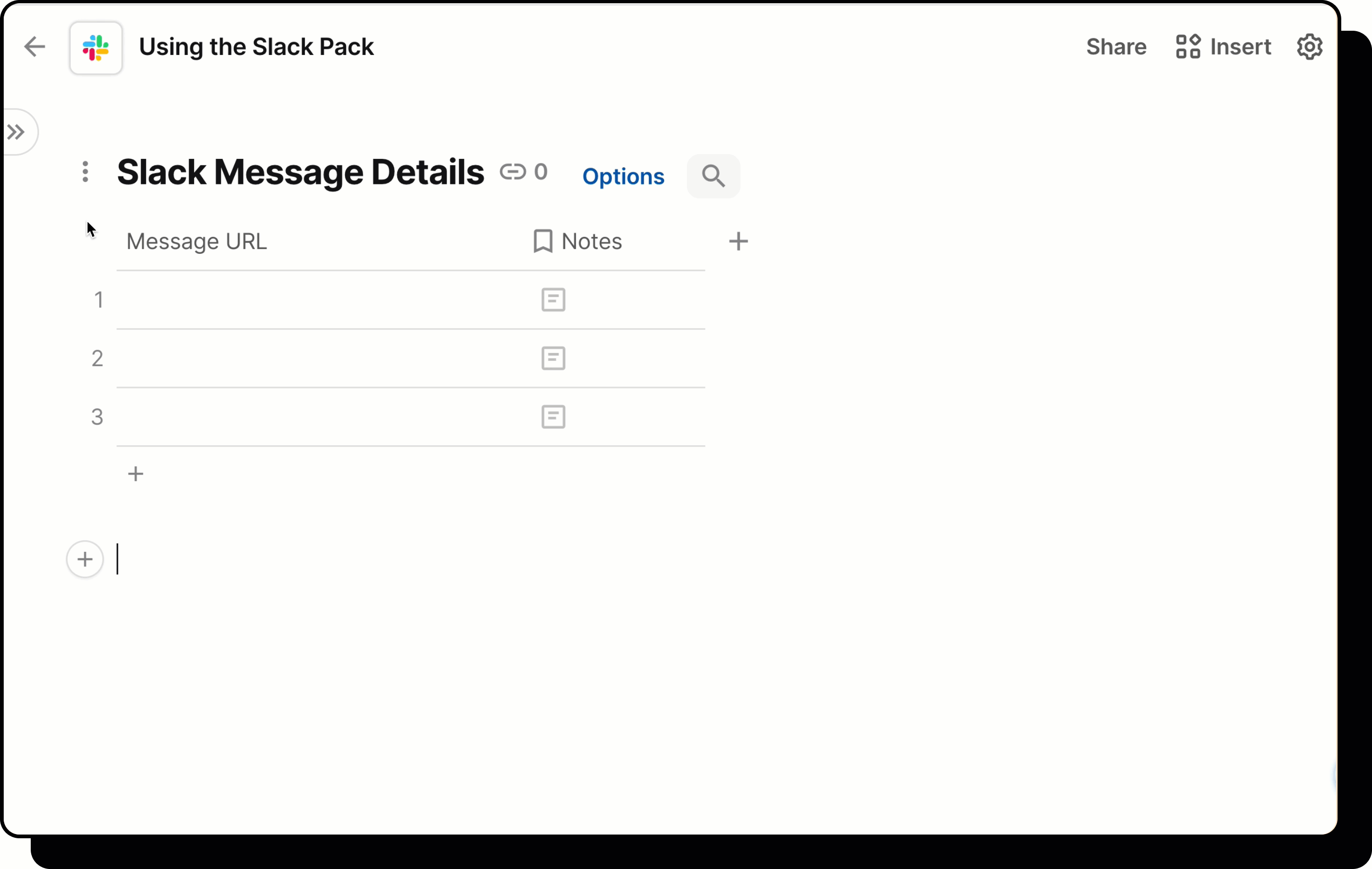

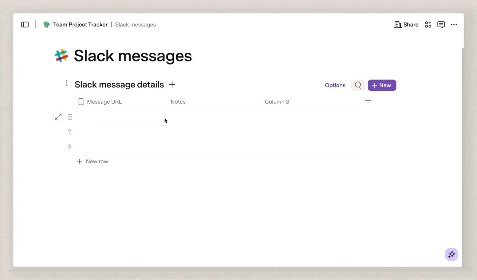

Pull a Slack message into a table in Coda
With the Message column building block, you can get all the important info about a given Slack message with only the URL. You can even create a table with whichever message attributes you need.
  1. Change the column type to a Slack Message column.
  2. Copy the URL from a Slack message by clicking the the three dot menu on any channel.
  3. Paste the link into the column. It will automatically convert to a more detailed reference.
  4. Once you have your message in a table, you can extract any of its information by hovering over the message, then clicking the Add button next to the information you want to create a column for.
Alternatively, you can paste the link into the canvas of a Coda doc to get a clickable card that visualizes the message.

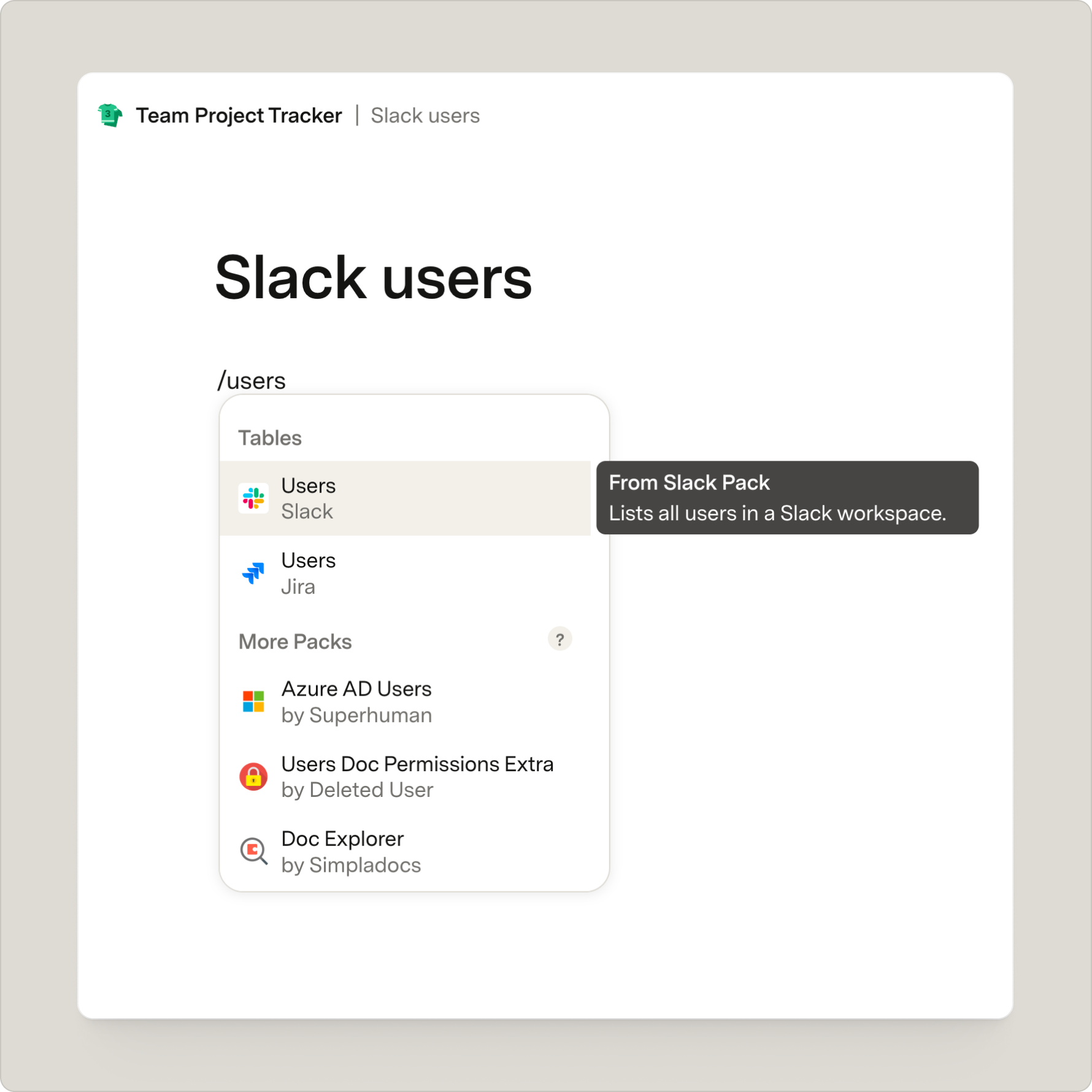

See all users in your Slack workspace
Maybe you’re in IT and want to see a table of all users in your Slack workspace. No problem - you can easily pull this into your Coda doc. Just type /users into a blank line of your doc, and select the Users table from the dropdown. You can then choose which Slack account to use to pull this data, as well as make other adjustments to the sync table. Then hit Sync now to fill your table.
