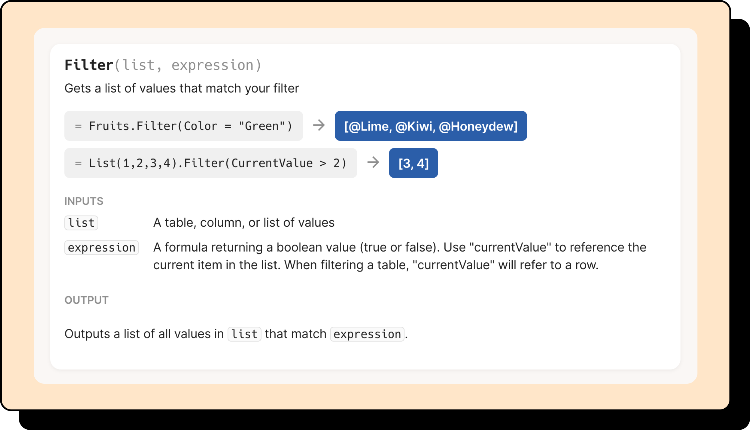

The Filter formula allows you to take a list of values (typically a table or a column) and then filter that down to a subset of values based on your specified criteria.
Here’s how our Formula Library breaks down the Filter formula:
A Filter formula takes two inputs:
  1. A list of values (typically a table or view, column values, or a list from another formula output)
  2. An expression, or a series of arguments, used to evaluate that list
The formula then outputs a list of all values (from the original list) that match the expression.

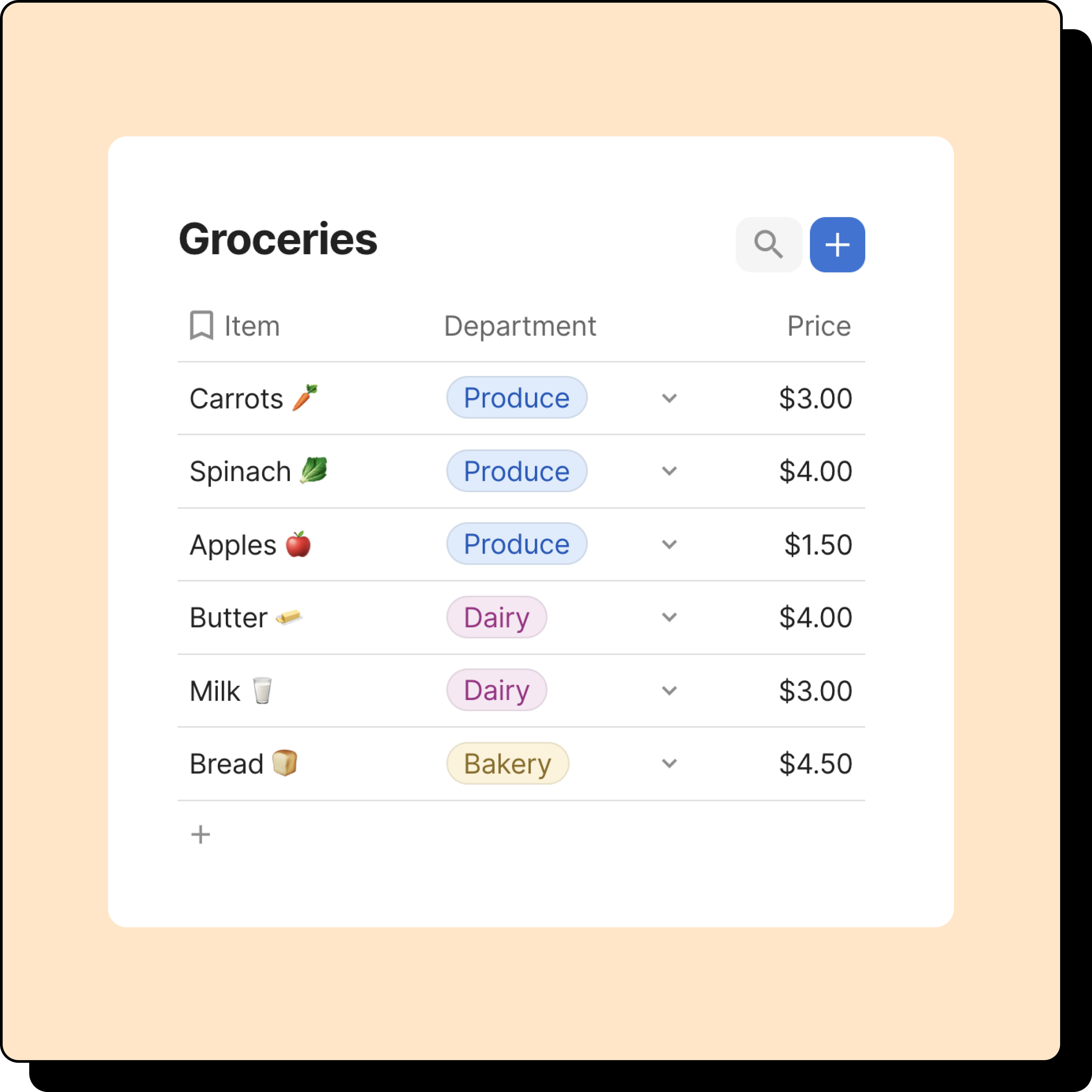

Here’s an example of the Filter formula in action. Let’s say you have a table full of groceries. We’ll call this table Groceries.

Let’s say we want to count how many of these items are produce items. To do so, we’ll combine the Filter formula with the Count formula. And for simplicity, we’ll do this in a canvas formula:
[Groceries].Filter(Department.Contains("Produce")).Count()
In this example, the list we're processing is the list of rows from the Groceries table and the expression we're evaluating is whether the Department column contains the word "Produce". The Count formula then counts the number of items in the resulting sublist. Therefore the formula would output the value 3, since 3 rows match this criteria.

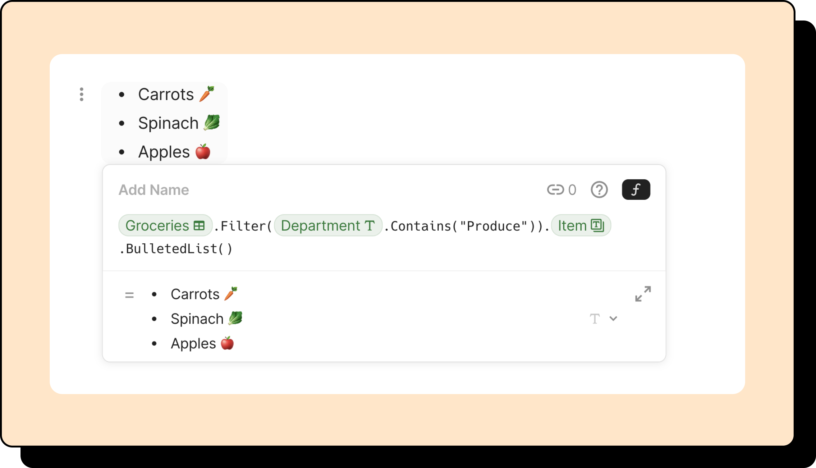

What if instead of a simple count of the matching rows, we want a list of those items? In this case, we’re wanting to pull out specific column info (the Item column) rather than the entire row. Therefore, we need to add .Item after our filter to specify which data to include in the list. Then we can simply replace the Count() part of our formula with a BulletedList() instead.
[Groceries].Filter(Department.Contains("Produce")).Item.BulletedList()
This will output a list of all three rows that match the stated criteria. It will look something like the image below:
