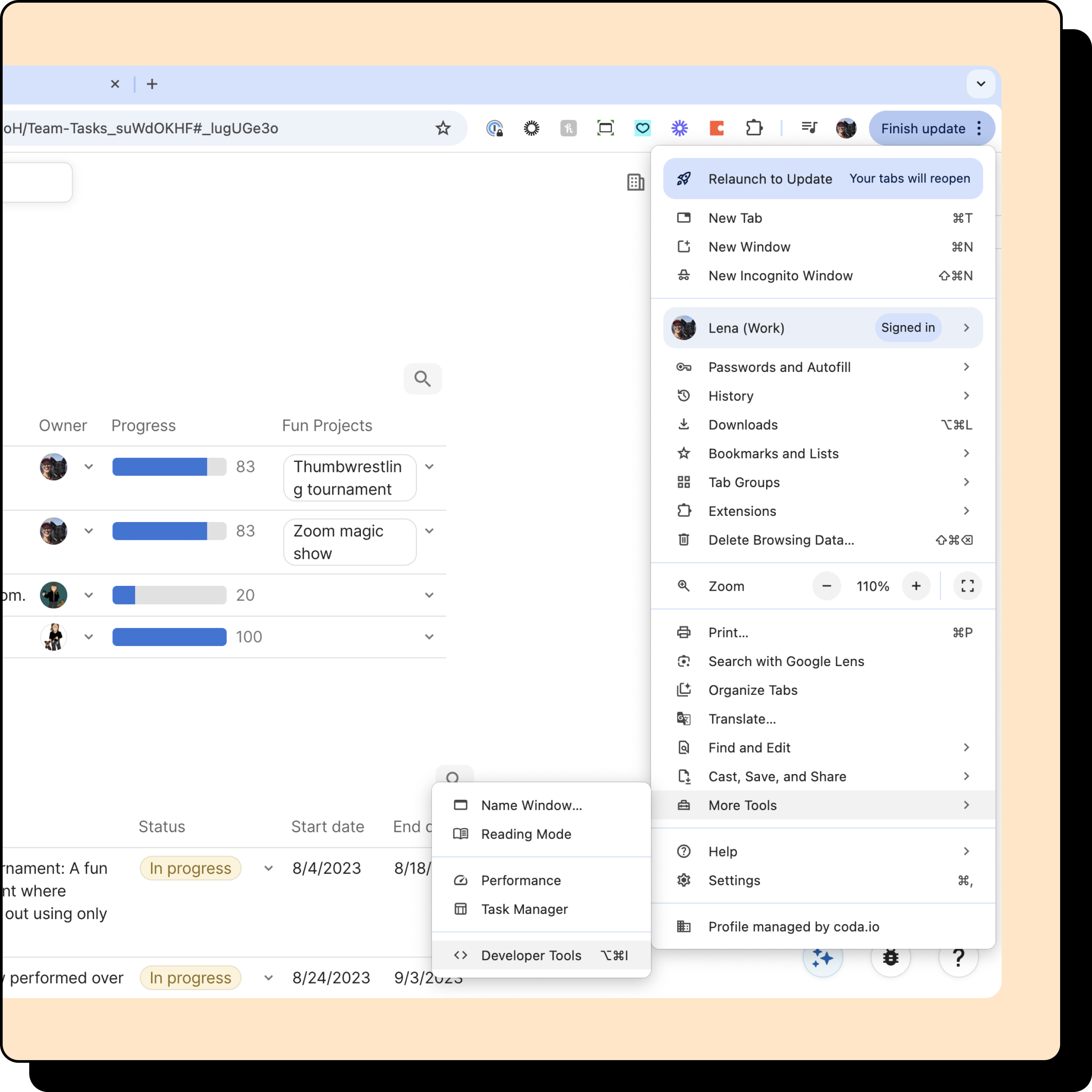

  1. In the Chrome browser, open the Coda doc that is experiencing performance issues.
  2. Click on the vertical three-dot menu in the upper right corner of your Chrome browser.
  3. Hover over More tools, then select Developer tools.
    An image of Chrome's settings menu, with Developer Tools highlighted.

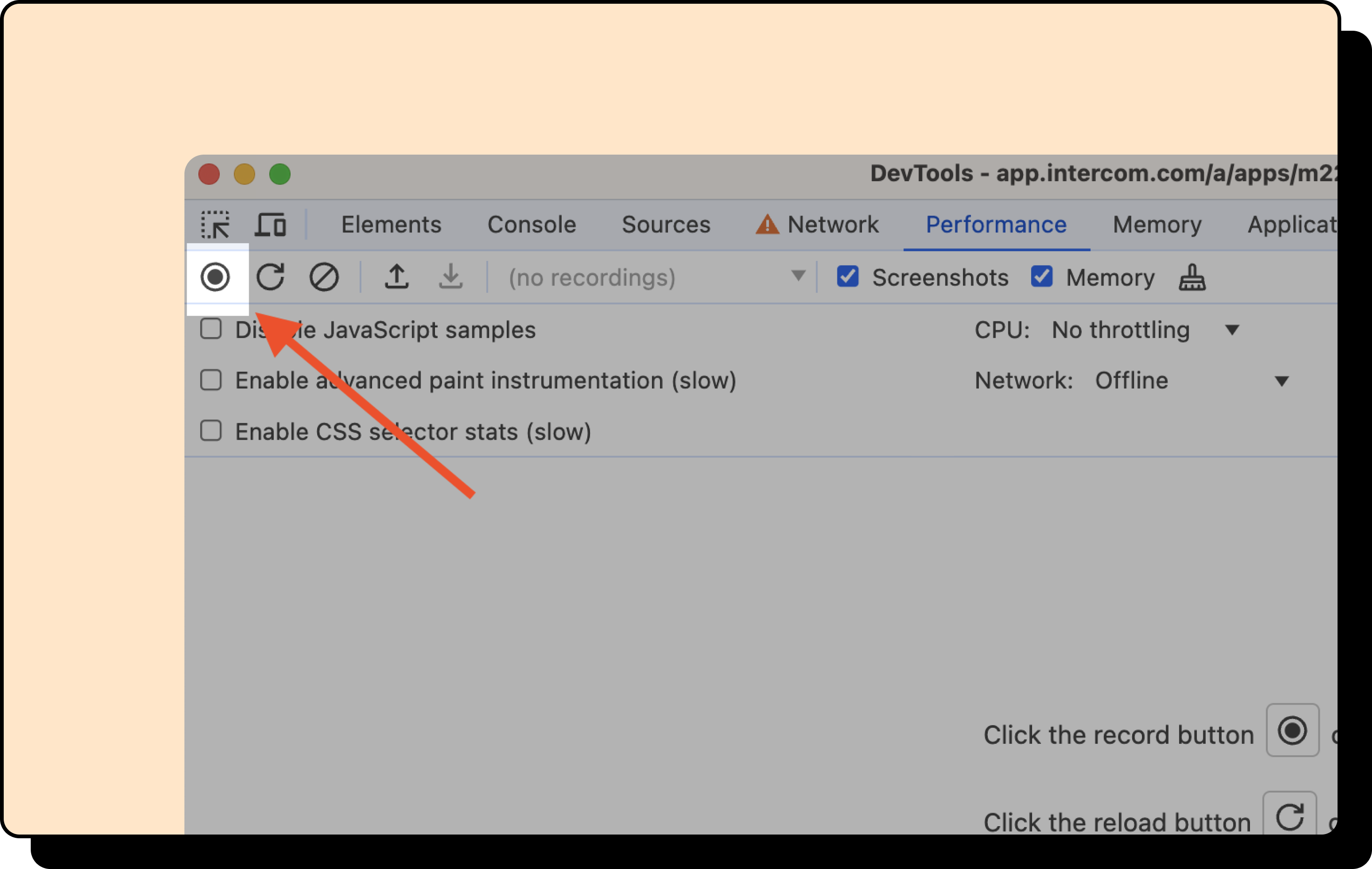

  4. Click into the Performance tab of the developer tools.
  5. Click the round Record button (this can be found in the center of the page or in the upper left corner) to begin the recording.
    An image of the developer tools' Record button.

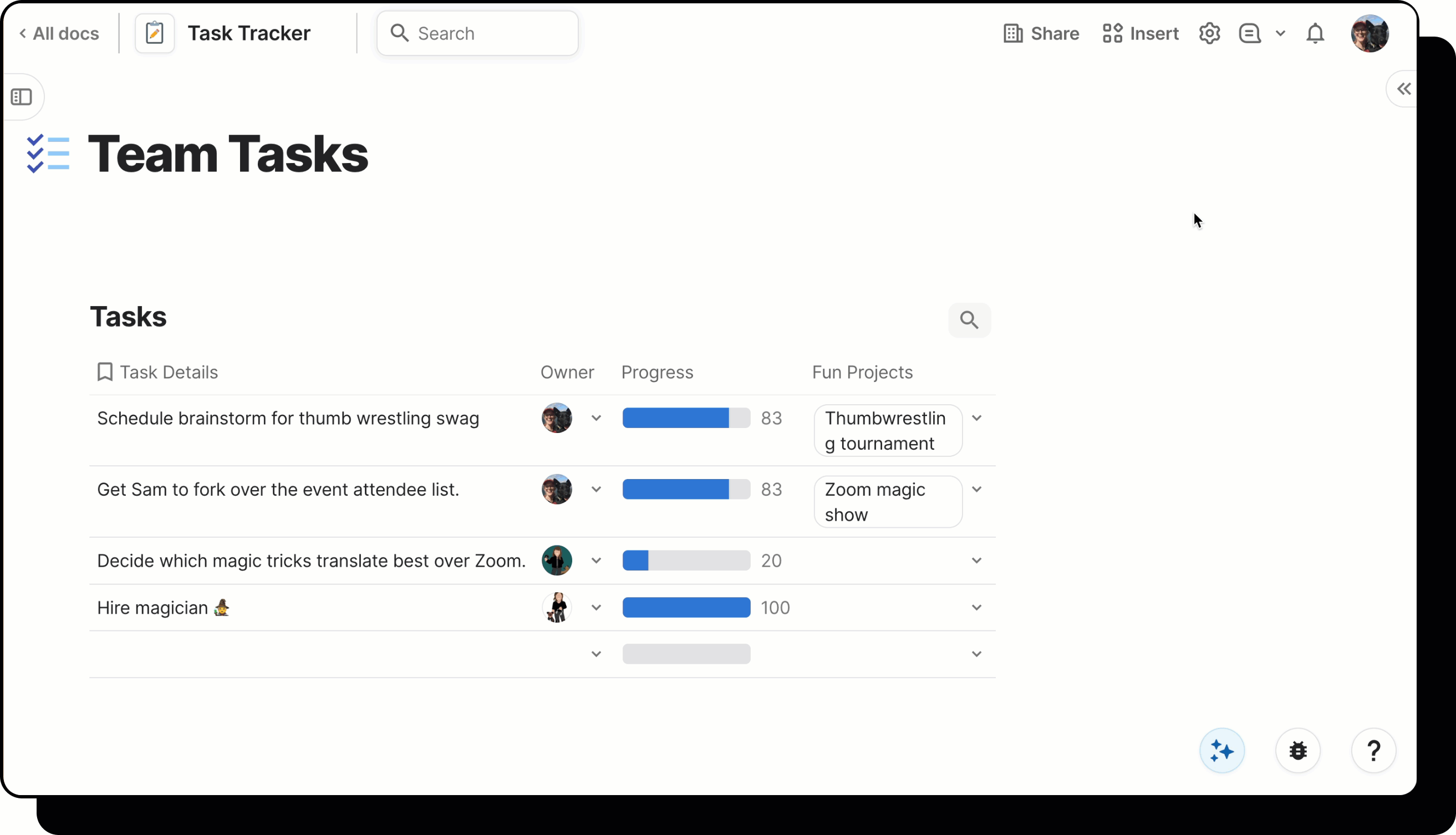

  6. While the recording continues to run, hop back into your Coda doc, and select the gear icon in the upper right corner.
  7. Select Doc map from the options.
  8. Click on the vertical three-dot menu in the upper right corner of the doc map page, then select Debug calculations.
  9. This will open the calculation analyzer. Click the Start button to begin measuring.
    A gif showing how to run the calculations analyzer in Coda.
  10. Reproduce the performance issue that you've been noticing while the calculation analyzer runs.
  11. Once the issue has been reproduced, click Stop in the calculation analyzer.
  12. Take screenshots of the data shown in Coda's calculation analyzer, and save somewhere you can easily find them later.
