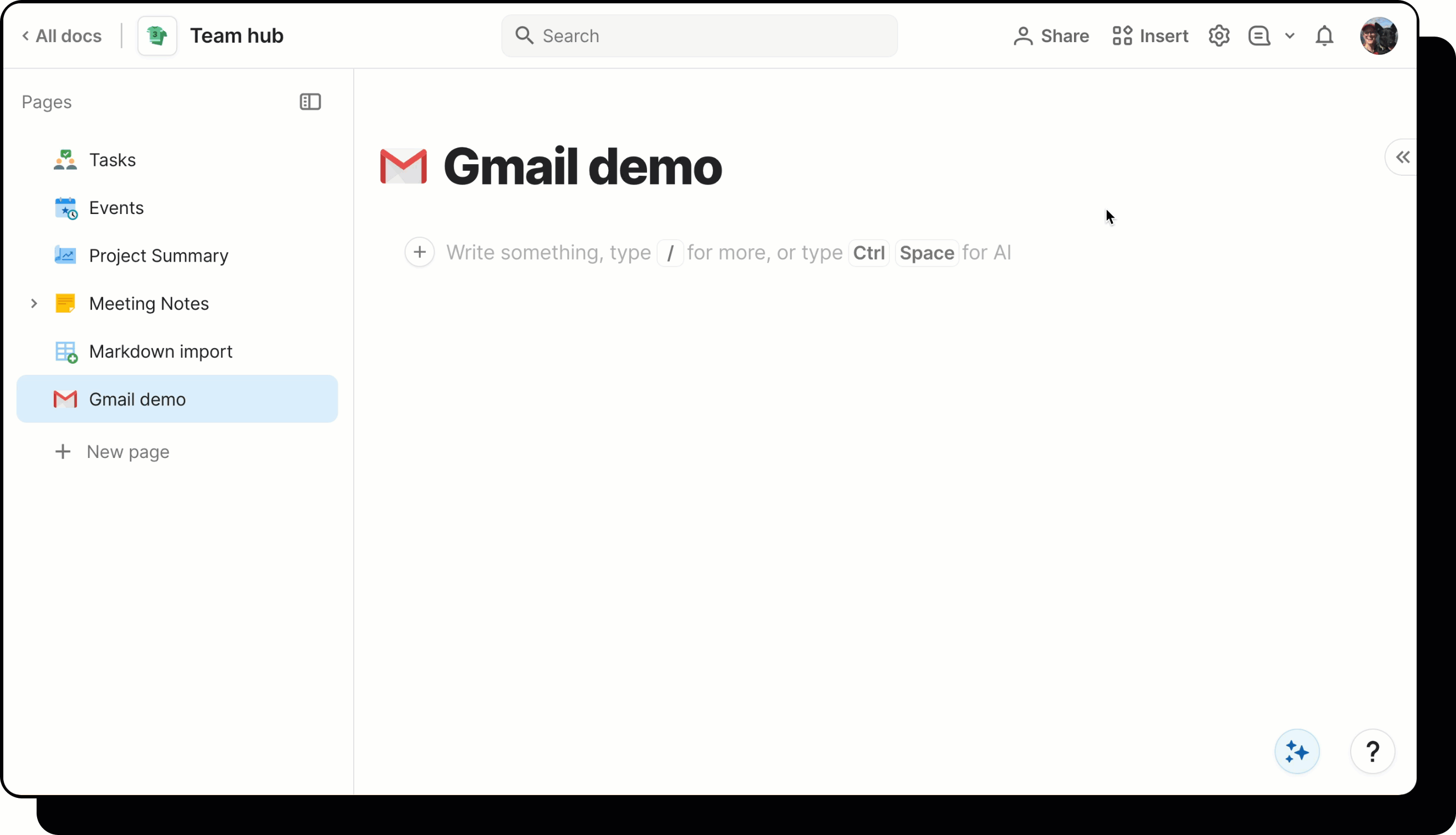

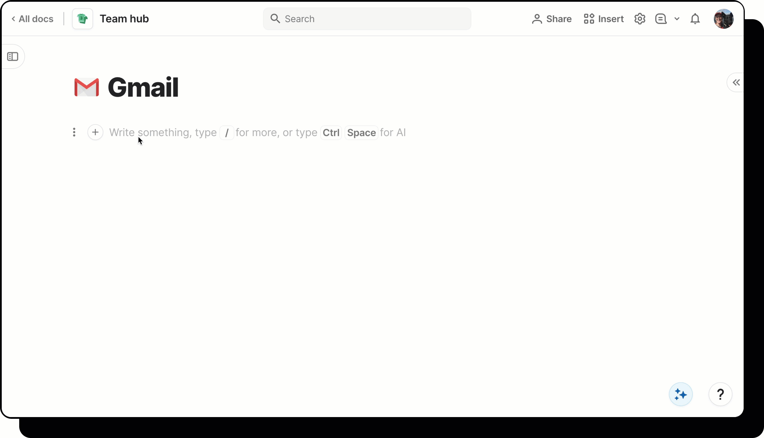

  1. On any blank line in your doc’s canvas, type a forward slash, followed by “Gmail” (e.g. /Gmail )
  2. From the drop-down menu, select Gmail (under the More Packs header)
  3. Then click the Add to doc button in the upper right.
That's it - the Gmail Pack is now installed. To start putting it to use, check out the following section.

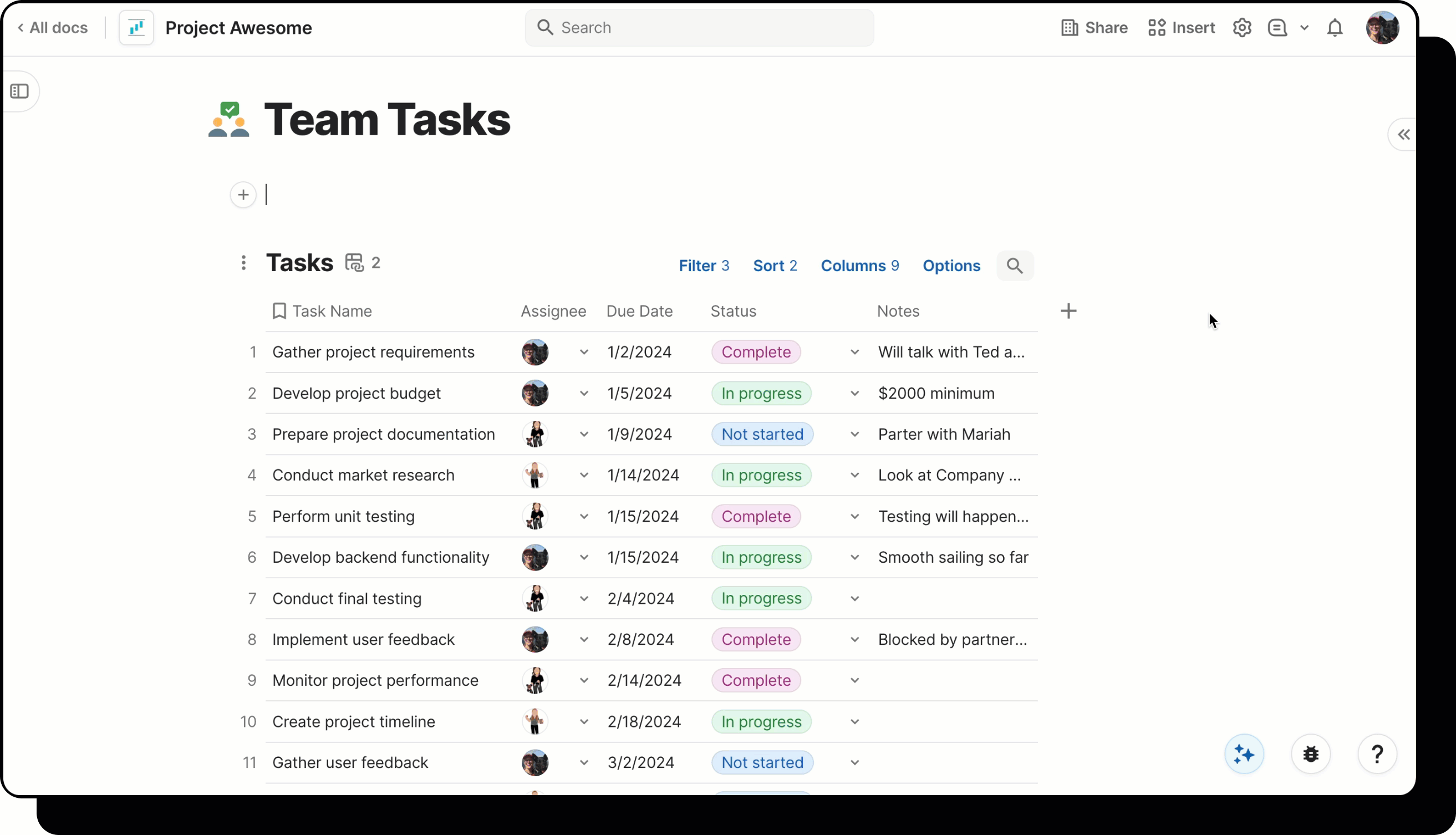

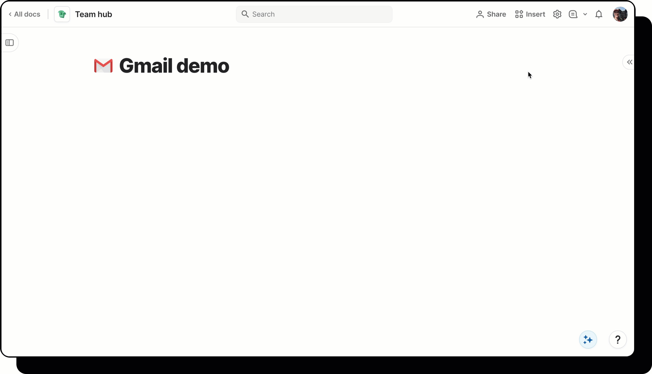

Once you’ve installed the Pack, you’re ready to start using any of its many building blocks. To see what this Pack has to offer, head to the Pack page by following these steps:
  2. Select Packs
  3. Under Installed Packs, select Gmail
  4. Scroll through the Building blocks tab to see all the ways you can start using the Pack. You’ll see templates, tables, buttons, columns, formulas, and more.
To add any of these building blocks to your doc, simply click and drag onto the page. You will then be prompted to connect to your Gmail account in order to access that data. Follow the prompts to connect your account. If this is your first time connecting to the Gmail Pack, you'll be prompted to sign in to your Gmail account. And if you need a refresher on connecting to Pack accounts, check out this article.

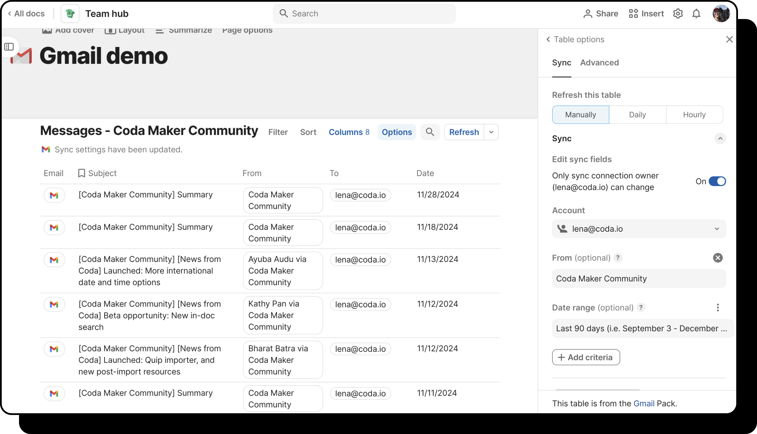

Sync in Messages and Threads
A common use of the Gmail Pack is bringing in a table of all your messages or threads associated with a given Gmail account. This can help you and your team stay organized, save time, and get more done.
Once you’ve added the Gmail Pack to your doc and logged in, you can follow the steps below to bring in either your Messages table, Threads table, or both!
  1. Open the Gmail Pack
  2. In scroll to the the Tables section of the building blocks
  3. You’ll see two options: Messages and Threads. To start, drag and drop one of these options into your doc.
  4. In the side-panel, you can configure the sync table settings. Be sure to check out the additional criteria available here with the + Add Criteria button.
  5. Once you’ve configured your settings, click the Sync Now button in your table!
Once it loads, you’ll have a table containing all the messages or threads that meet your sync criteria.

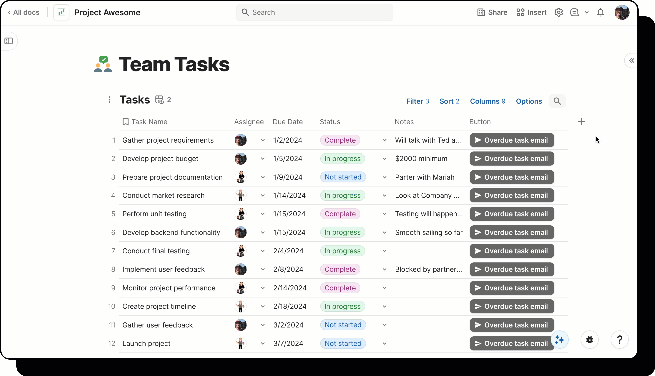

To set up a Send Email button:
  1. Either in your table or on the canvas, create your button column or singular button.
  2. In the On Click section of the button settings, select Packs > Gmail > Send Email
  3. Configure the rest of the button settings as described in the next section.
Required inputs
  • Account: The Gmail account used to take this action.
  • To: The email address you are sending the message to. For example, "name@example.com".
  • Subject: The subject line of the email.
  • Content: The text of the email.
Optional inputs
  • Cc: An email address to CC.
  • Bcc: An email address to BCC.
  • From: The email address to send the email from.
  • Reply to: The email's reply-to address. This is where replies to the email should be sent.
  • Hide Signature: Should the email include the document link, yes or no?
  • Thread Id: The thread to send the email reply to.
  • Results: Select a column to record the result of the button action (ie: did the button action succeed or fail)
To set up a Create Draft button, you can follow the above instructions, but select Create Draft in step 2 instead!
