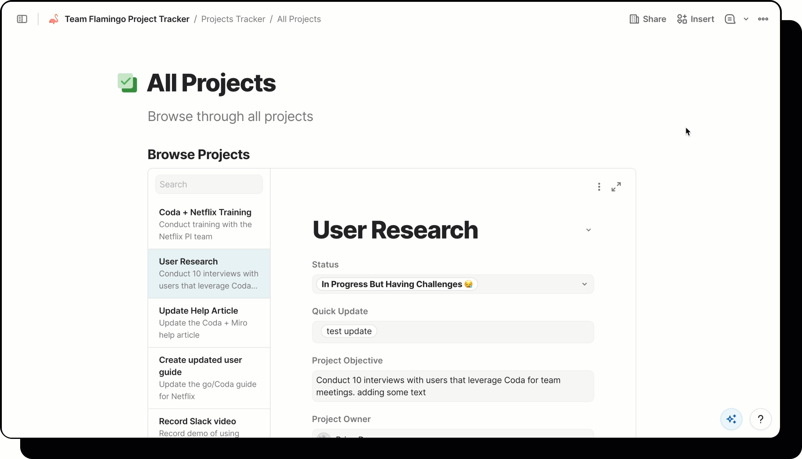

Identify source of calculation issues
We’ve built a nifty tool to give you a peek behind the scenes of what’s cooking in your doc: the Calculation Performance Analyzer. With this tool, you can measure how long certain interactions take, and pinpoint where the hold-up is happening.
Keep in mind that this tool focuses on calculation issues. If your doc is dragging but you’re not seeing that Calculating... indicator at the top for more than a couple seconds, check out our other performance improvement article.
Open the Calc Performance Analyzer
If your doc is currently calculating, you can bring up the tool by clicking the Calculating... indicator to jump into the tool.
You can also open the tool by opening the Doc map, then clicking the 3 dots on the top right and then clicking Debug calculations.
