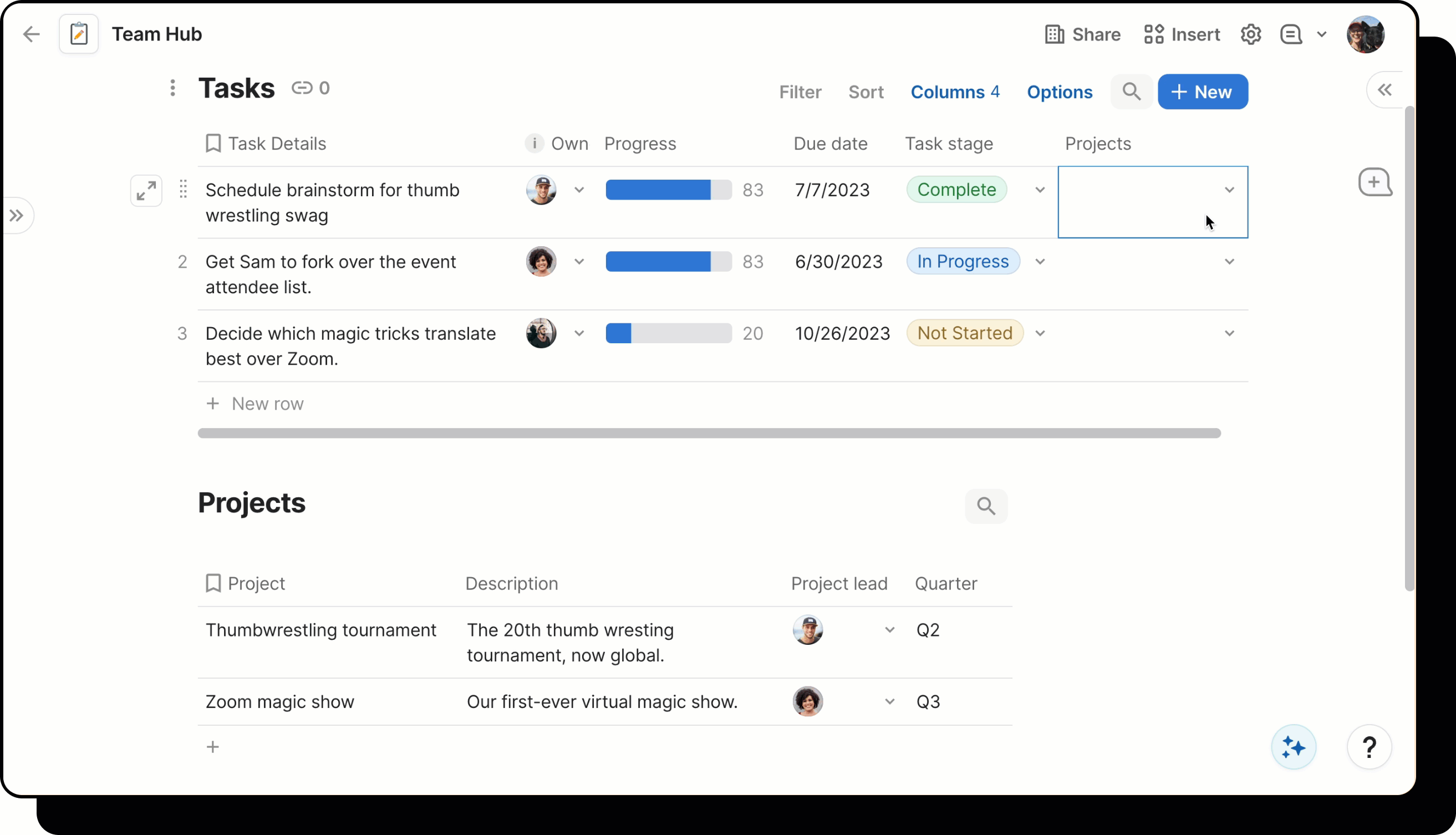

Relation columns are required for setting up dependencies in your project tracker. So what is a relation column?
Sometimes we have the same values shared by tables in a doc. Rather than having to retype these, or worry about keeping them up to date, Superhuman Docs allows you to create relation column - a column that references other tables.
The relation column format creates a linked select list of the display column of the table of your choice.

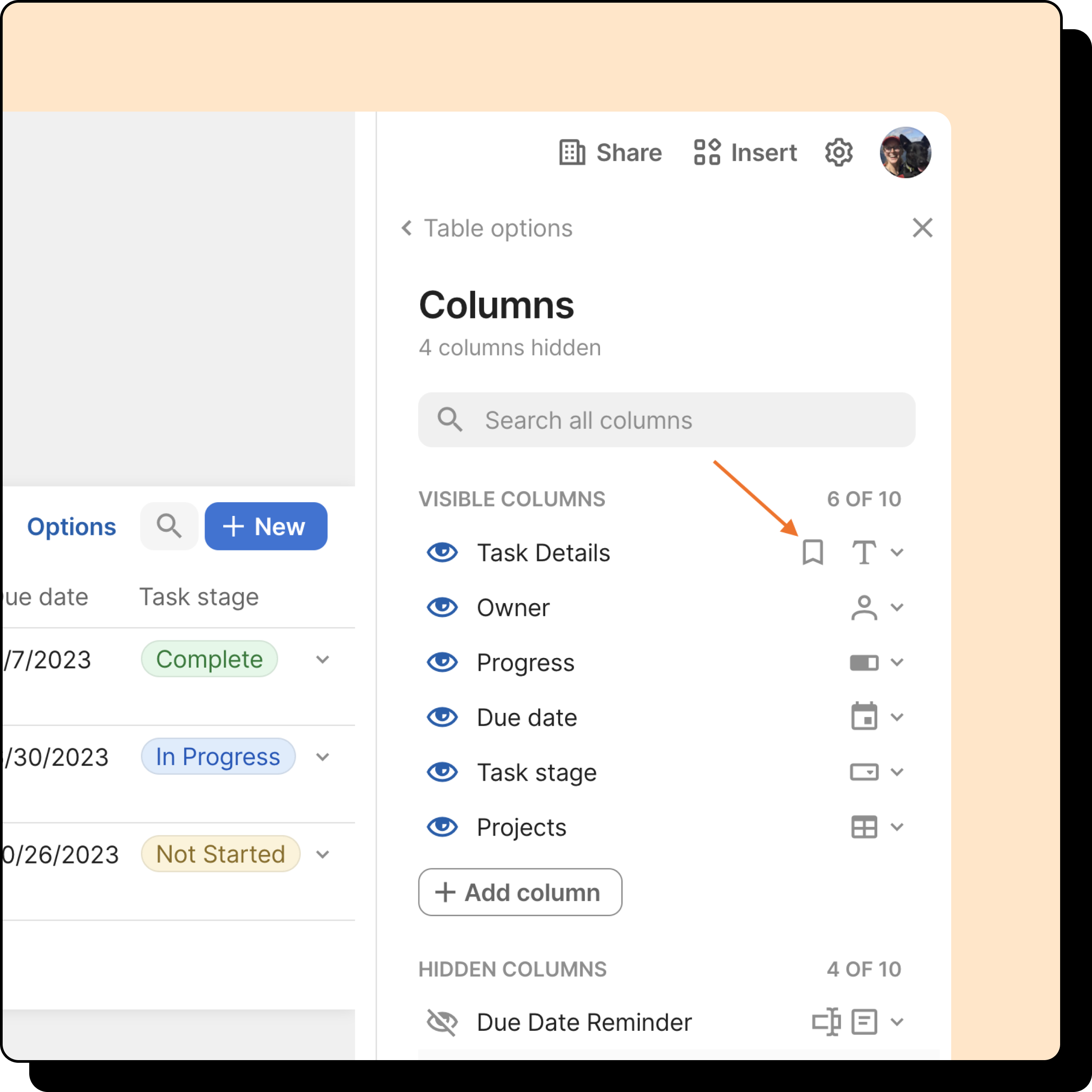

How do you know which column is the display column? Simply look for the bookmark symbol in the list of columns.
An image of a table's column list, with the display column's bookmark icon being pointed to.
If you ever want to change your display column, click the dropdown menu next to the column of your choice and select Set as display column. Learn more about the display column here.

  1. Create your base task table (let’s call this Tasks) with task name as your display column
  2. Add a column and name it Dependencies
  3. Right-click on the header of your new column, select Change column type, then select Relation from the options (Tip: you can use the search bar to quickly find this column type)
  4. You’ll be ask to choose which table this relation column should pull from. Choose your base tasks table (the one we’re calling Tasks).
Now that your relation column is set up, you can use it to start assigning dependencies. Any changes made to the selected task will automatically be reflected in the relation column. And, what's more, you'll be able to see all of the underlying data from the dependent task in the row in question so you have the complete picture of your work and how it's put together.

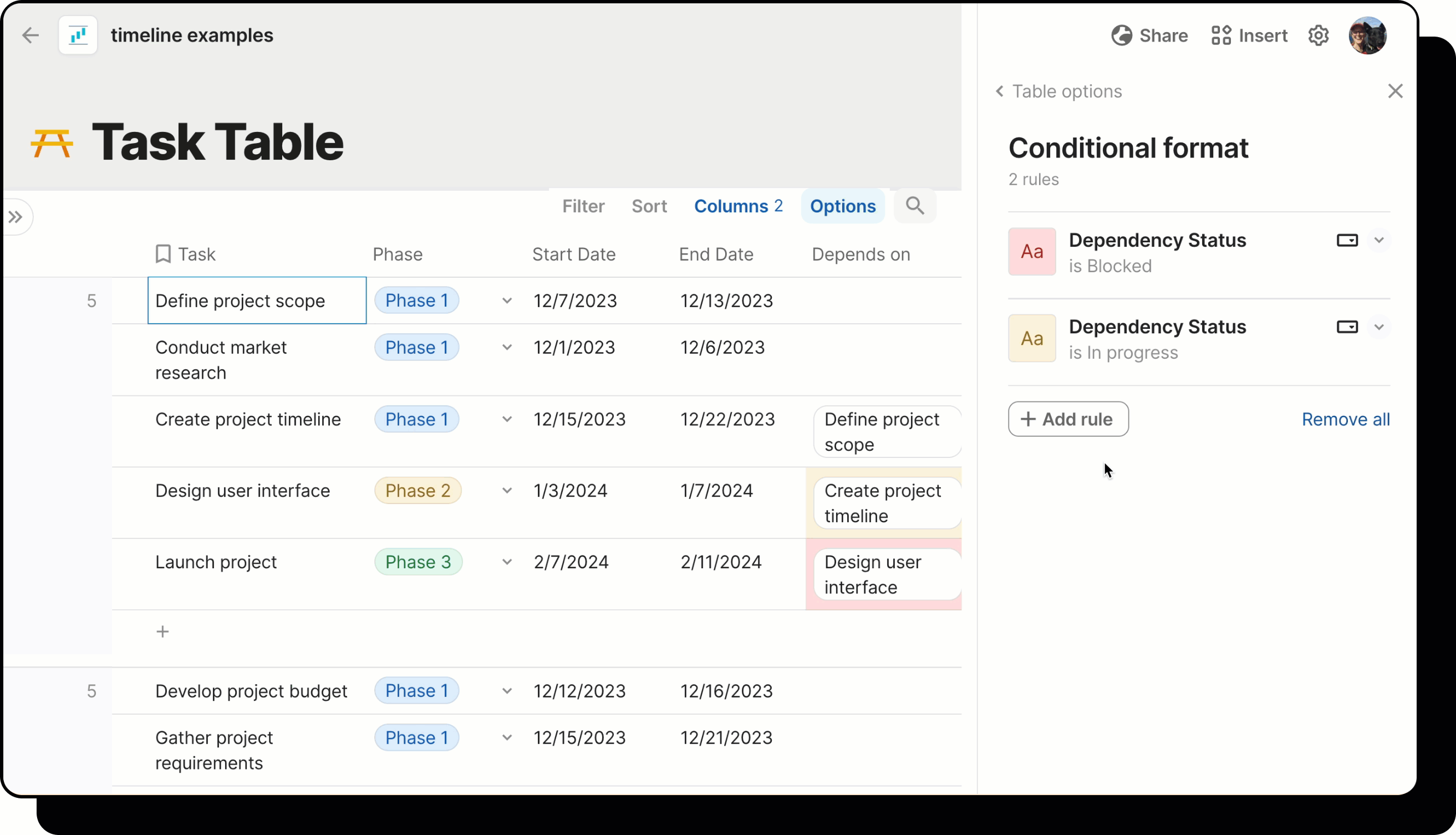

Format based on status
It can be helpful to have a quick and easy way of understanding the status of your dependencies. We recommend creating a Dependency status column that automatically pulls the status of the dependent task, and displays it in the row of the main task.
To set this up, just follow these steps:
  1. Right click on the header of your dependency relation column
  2. Select Add related column, then choose the status column from the options. A new column will be created (let’s call this Dependency status) which will automatically reflect the status of the dependency for that row.
  3. To add formatting, hover over the table and click Options in the upper right
  4. Click into Conditional format. Then create a conditional format rule - or rules - based on your Dependency status column. You can read more about creating these rules here.
