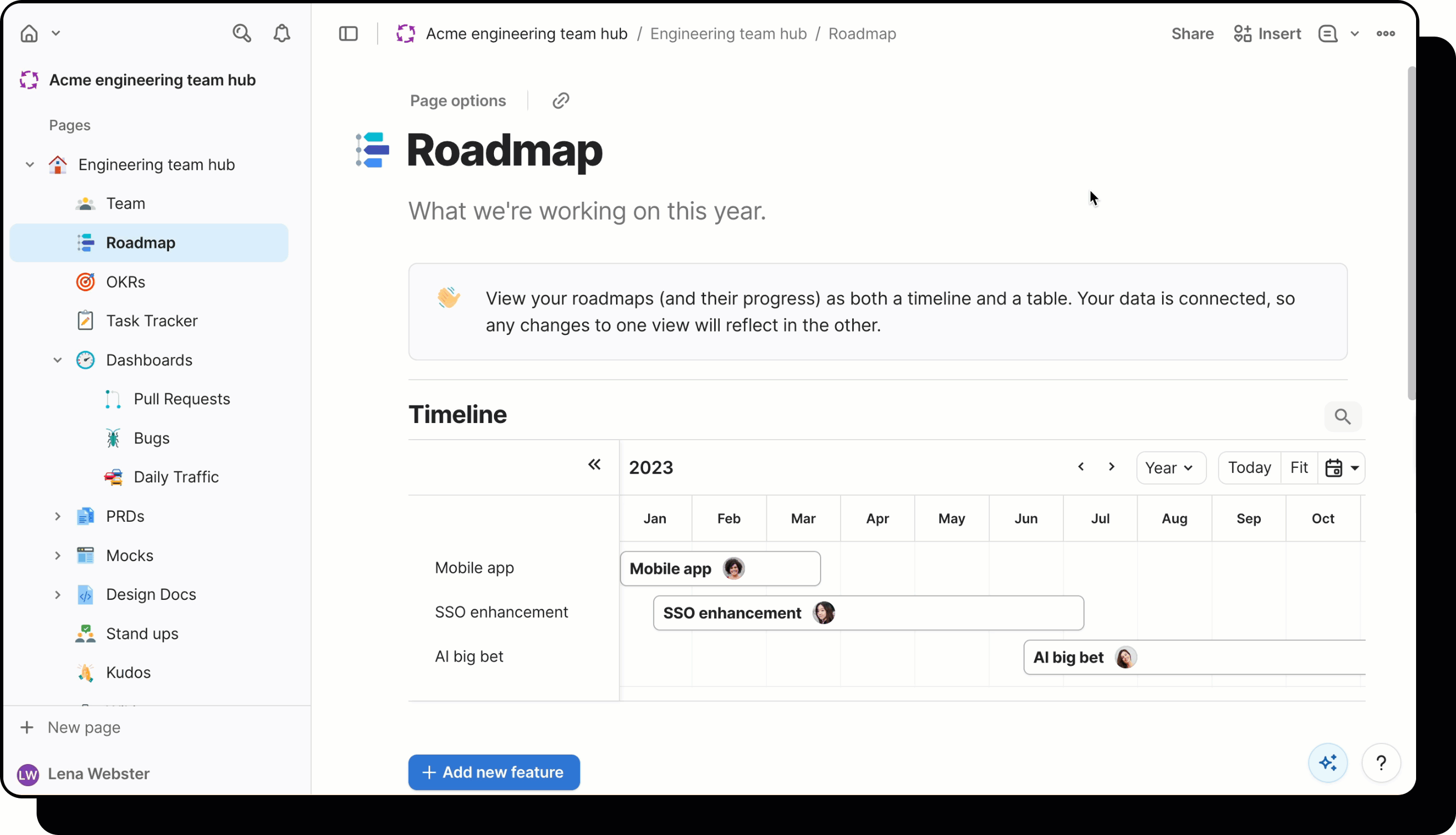

First, check the in-doc statistics to find hot spots
Follow the steps below to start narrowing things down.
  • Click on the three-dot menu in the upper-right corner of your doc, select Doc settings, then select Statistics
  • Check the Rows, Pages, Tables & views, Buttons & controls and Formula stats.
    • Rows: If your row count is 10,000 or more, then it’s possible rows are the primary contributor to doc size. In this case, we recommend deleting unnecessary rows or archiving less critical rows to another doc. Refer to the section below on diving into each of your large tables to learn more.
    • Pages: If your page count is over 500, then it’s possible that pages are a primary contributor to doc size. In this case, we recommend deleting unnecessary pages or moving less critical pages to another doc. Refer to the section below on page management to learn more.
    • Tables & views: If your table and view count is over 100, then you may have more tables or views than your doc can handle. Jump to the section below to learn about different methods for reducing table and view count.
    • Buttons & controls, and Formulas: If the combined count of all these is 1000 or more, these objects may be the primary contributor to doc size. In this case, we recommend deleting the unnecessary objects, simplifying or commenting out formulas not needed, etc.
  • If none of these apply, then proceed to the next section to continue tracking down the issue.
