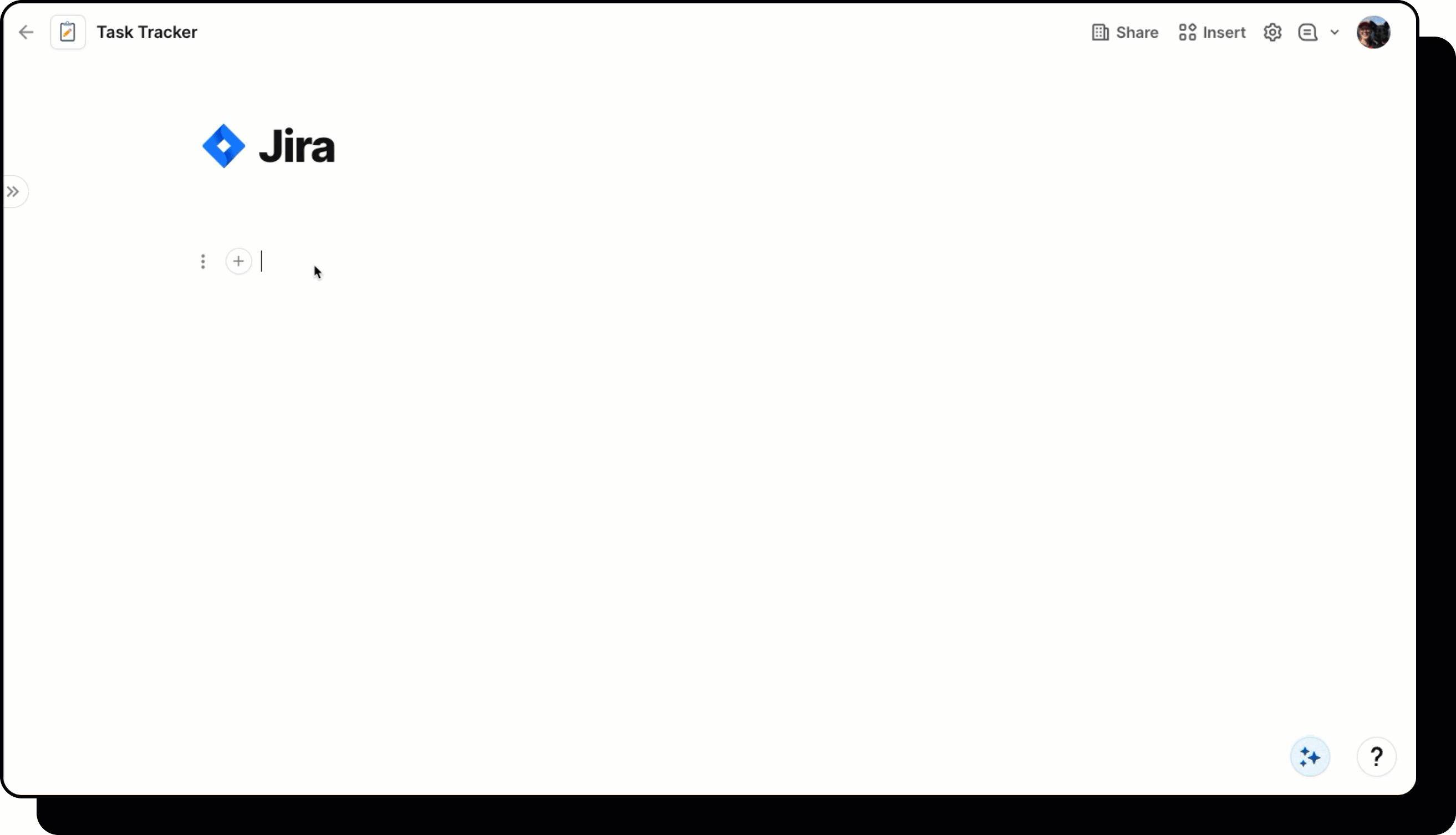

First, you need to install the Jira Pack in your doc:
  1. On any blank line in your doc’s canvas, type a forward slash, followed by Jira (e.g. /Jira )
  2. From the drop-down menu, select Jira (under the More Packs header)
  3. You’ll then see a preview with all kinds of helpful info on the Pack. Click Add to doc in the upper right.
💡Tip: As an alternative to the slash command, you can browse and search Packs by clicking on Insert (upper right corner of your doc), and then type in “Jira” in the search box. You can also streamline the search by selecting Packs first and then type in “Jira” in the search box.
