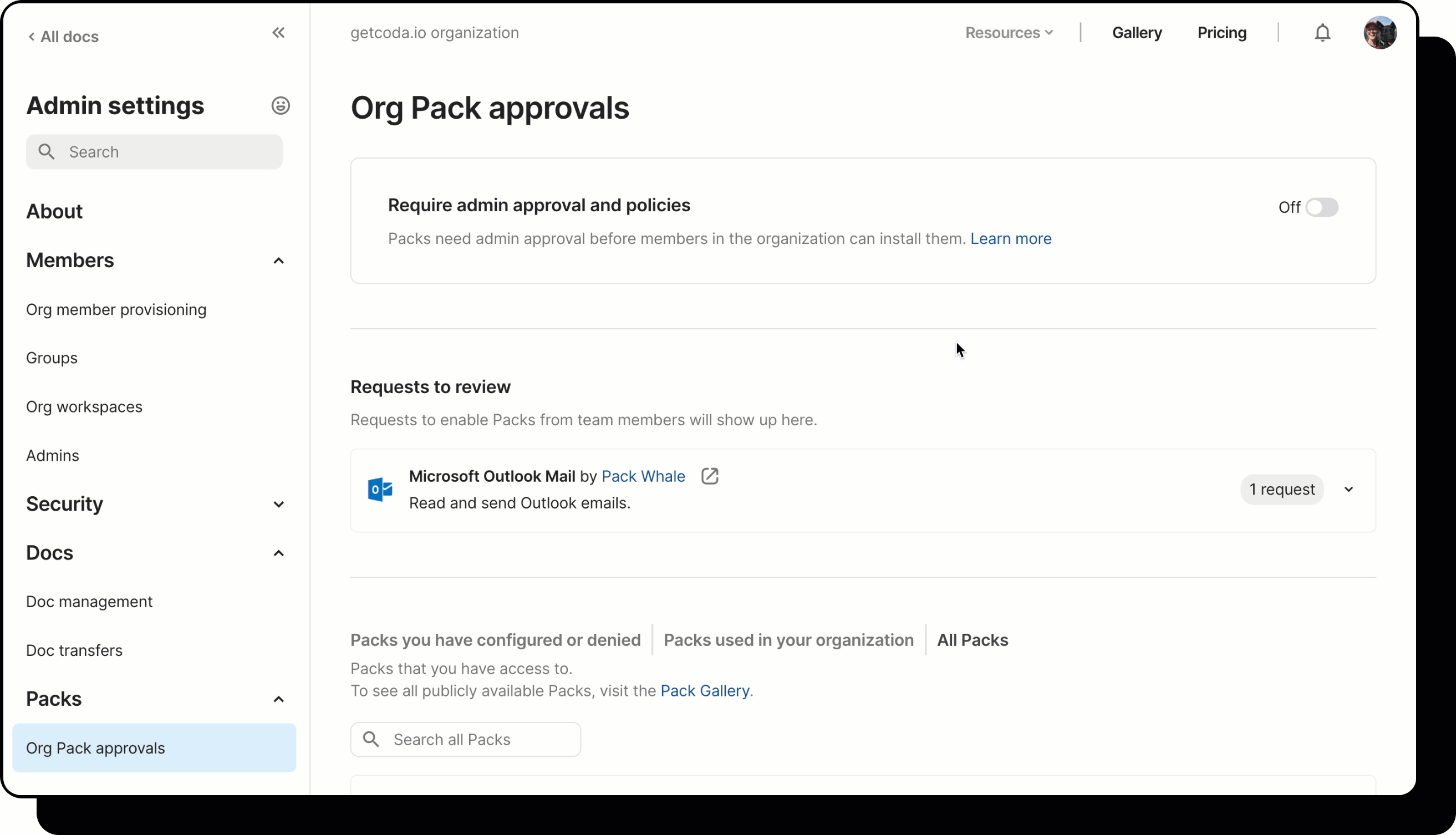

  1. Navigate to your Coda workspace home at coda.io/docs
  2. Click on Admin settings in the upper left
  3. Navigate to - or search for - the Org Pack approvals tab
  4. Scroll down to the list of Packs, and enter Workday into the search bar
  5. Click into the Workday Pack option, and select + Add new configuration
Next, you’ll need to head over to Workday to collect some necessary info. Continue to Part 2 to learn more.

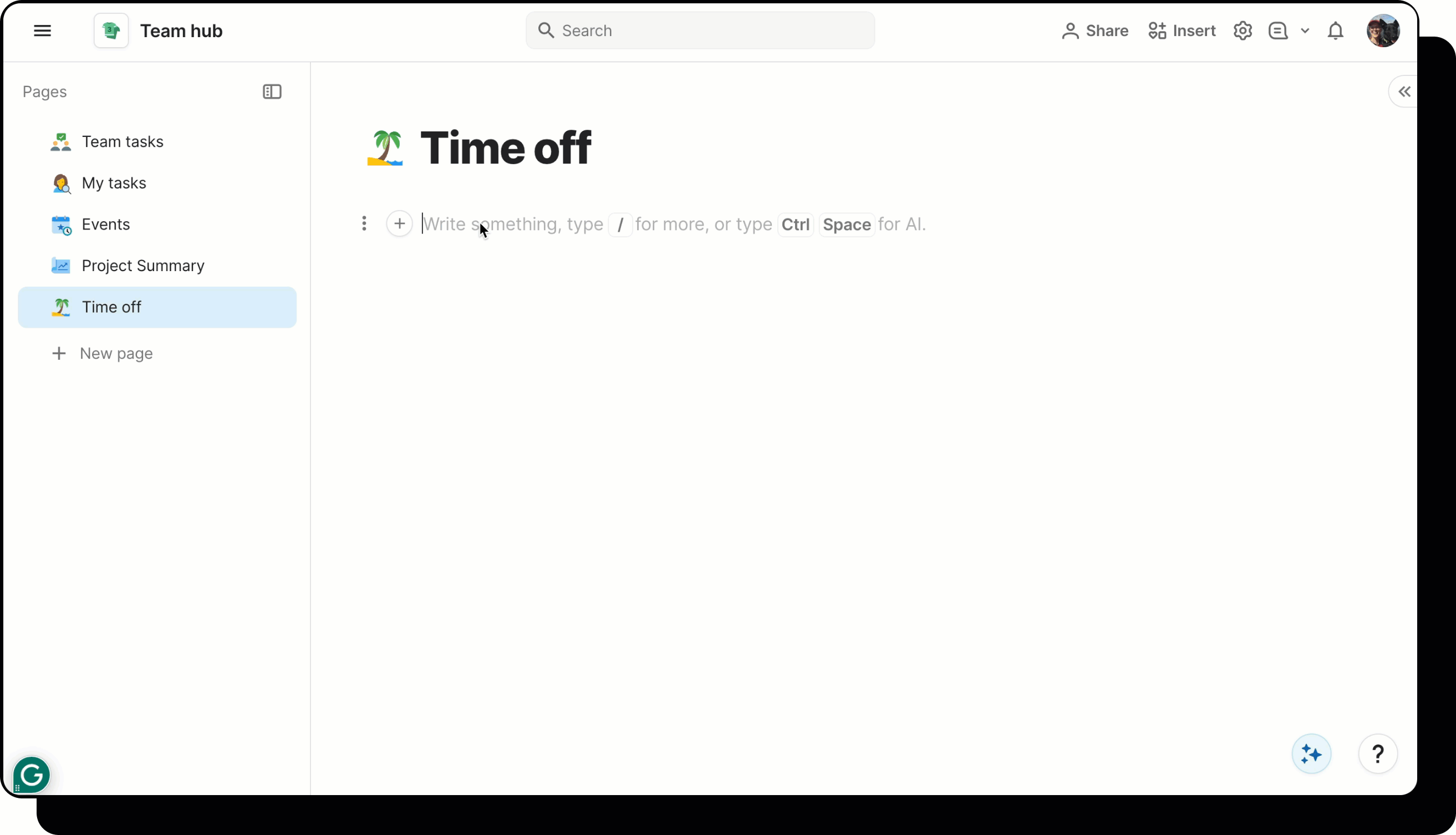

Start using the Workday Pack in your doc
Once an org admin has created the configuration for the Workday Pack, workspace members can begin using the Pack in their doc.
To get started, simply type /Workday on any blank line in your doc. Select the Workday Pack from the options, and click Add to doc.
