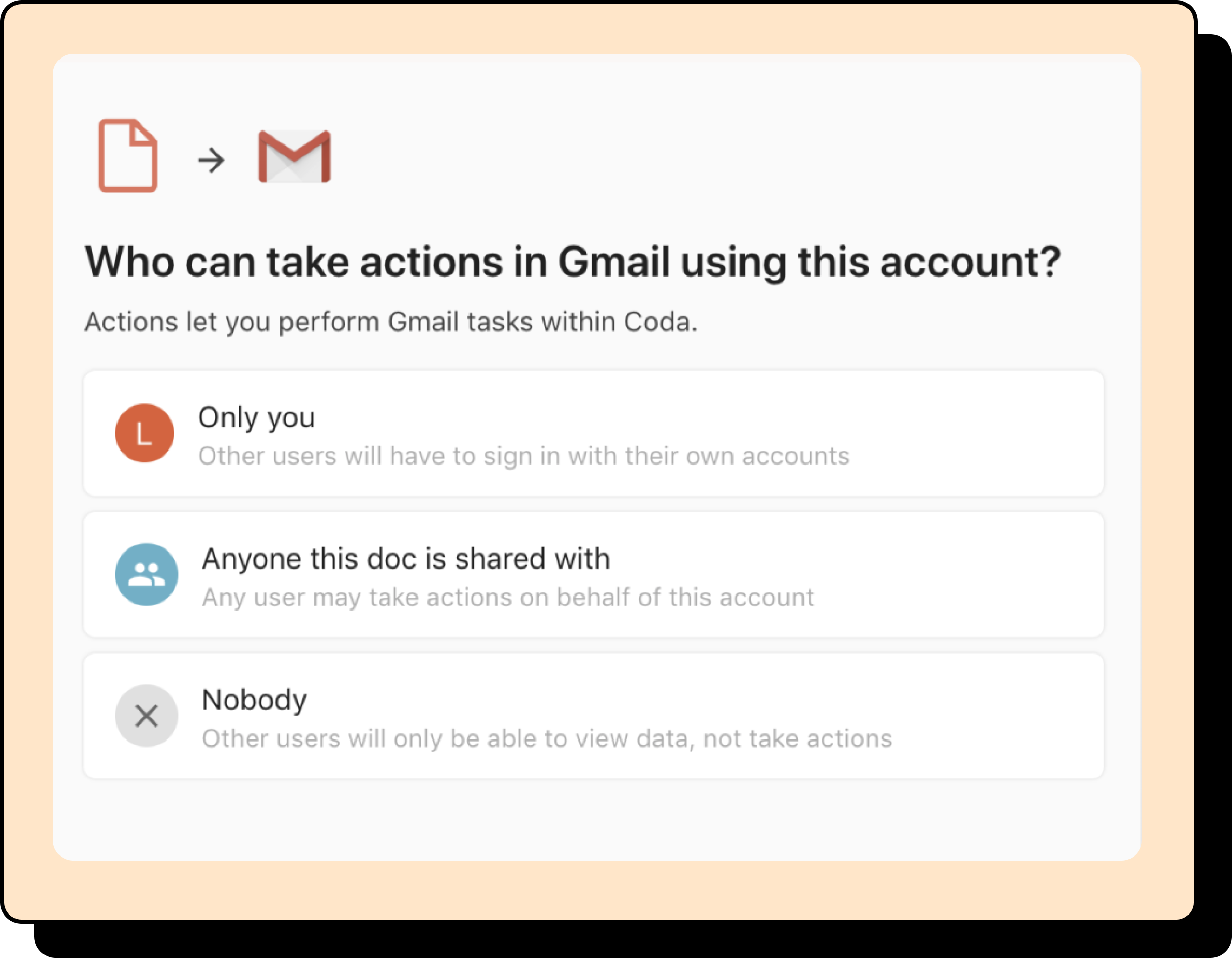

Pushing doc data to a third-party app
Packs can pull data in and can also push data out. Depending on how the Pack account is connected, you have three options to choose from to ensure your data is always secure:
  1. Only you ー you are the only one who can push out any actions or data from the Superhuman doc to the third-party app, other users will have to sign in with their own accounts to take actions with the pack. While users can access the pack tables, they will not be able to take actions with buttons.
    For example, you may have the Slack Pack enabled for your doc and you’ll be the only one who can push messages from your doc to Slack. Each user can set up their own Slack Pack so they can all push out messages from their own account.
  2. Anyone this doc is shared with ー any user who can access the doc can push out data. Setting this access for an account will set up a shared account and any user may take actions on behalf of this account.
    If we continue the Slack example, this means that everyone in the doc can push out messages from your doc to Slack from your Slack account ー without having to set up their own accounts.
  3. Nobody ー this setting restricts any action being taken and only allows users to view data.
    You might want to choose this option if you intend your doc to be strictly informational and connect data, rather than pushing data out.
After you have signed in to an account you can make changes to the permissions in the Pack’s settings. Expand the account details using the down arrow to the right of that account, and check or uncheck the boxes next to the permissions options as desired. Check out this article for more information on the differences between the options.

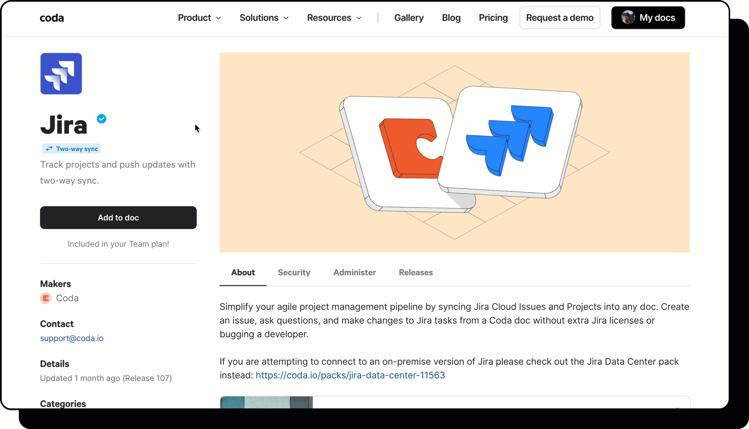

In the Gallery listing for each Pack, you’ll see a Security tab. This page details everything you need to know about an individual Pack’s security. Here’s an example using the Jira Pack:
  1. Pack certifications. Packs that have a blue check mark next to their name are Superhuman Docs certified. This means that the Pack has passed Superhuman Docs' quality review check, and the Pack’s maker has a support agreement in place with Docs. Our team has human reviewed certified Packs and their accompanying published docs to ensure they meet our standard of excellence. Maker’s of certified Packs have agreed to respond to support tickets within 48 hours of inquiry, Monday through Friday.
  2. Restricted networks. Packs are only able to interact and share data with the websites that the Pack maker has declared. Here, you’re able to see which domains the Pack can connect to, meaning the Pack can’t siphon data to another domain or access anything it’s not supposed to.
  3. Authentication types. Pack makers, Pack code, and other doc users never have access to your usernames and passwords. Superhuman Docs encrypts your login information and runs them on behalf of the Pack, so you never have to worry about your credentials being compromised. Here, you’re able to see what authorization protocol is used to securely log in to the respective service, and you can see what URL the Pack uses to pass this information.
  4. Limited data access. Packs are restricted to the data categories that are declared by the Pack maker, meaning Packs cannot access data from the respective service or your doc without permission. In this section, you’re able to see a full list of the Pack’s scopes in the drop down.

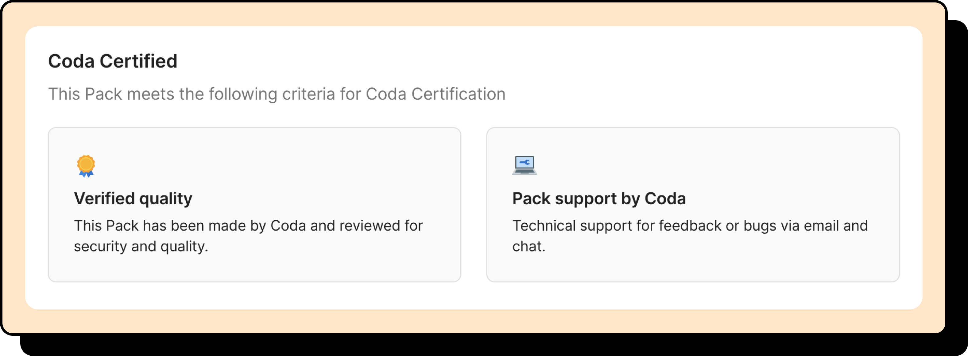

Superhuman Docs certified Packs
Superhuman Docs certified Packs have passed our standard of excellence for quality and support. Docs certified Packs are recognized by the blue checkmark next to their name. Here’s the standard that these Packs have adhered to:
  • Quality. Our team has human reviewed each individual Pack and its accompanying documentation to ensure that makers will have an excellent experience. We not only test to ensure the Pack fulfills essential use cases but we thoroughly test the Pack and its published docs for bugs and vulnerabilities.
  • Support. To be Superhuman Docs certified, Pack makers must agree to a 48 hour response time to support inquiries, five days a week (Monday - Friday). You can reach makers through the support email provided on the Pack listing page.
