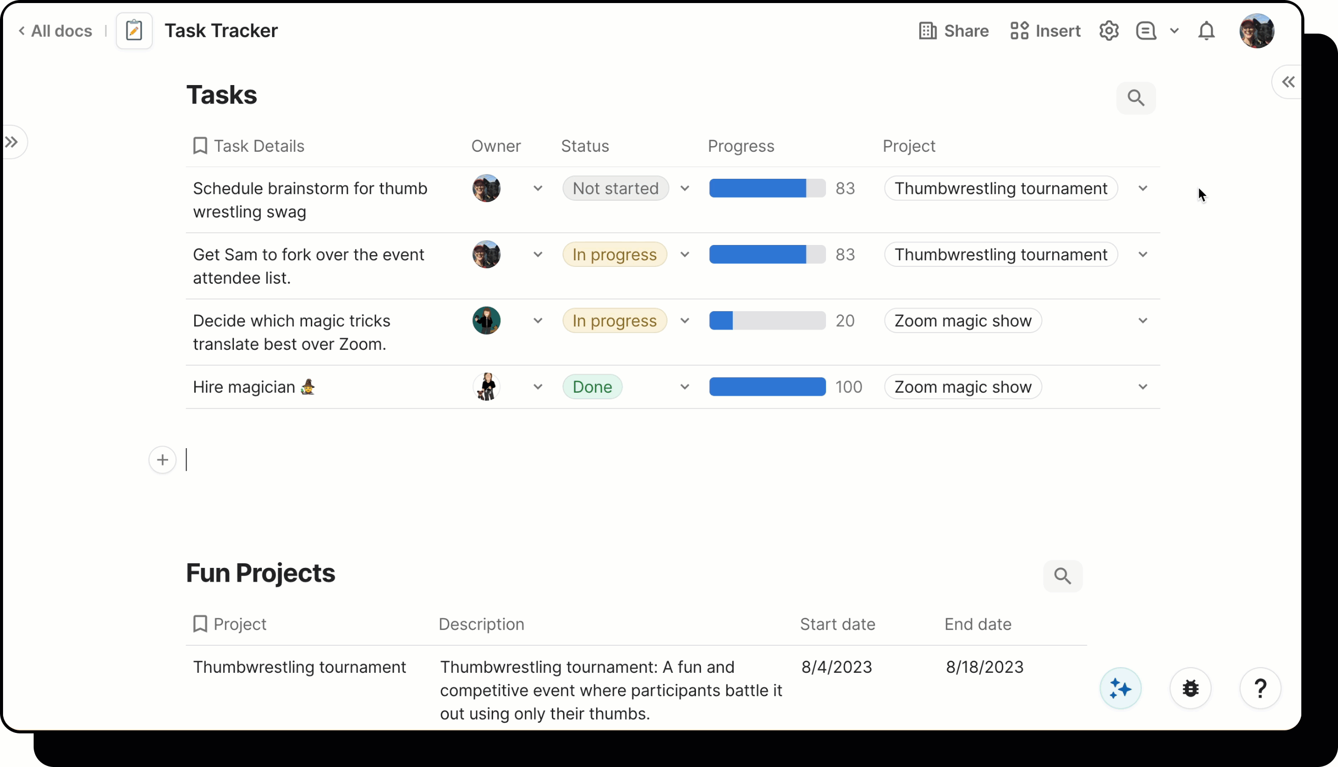

Relation columns - formerly known as Lookup columns - allow you to reference a table from within another table. For instance, let’s say you have a table for your projects and a table for your tasks. For each task in your tasks table, you may want to indicate the associated project. Or maybe you have a recipe table and an ingredients table - and you want to link the two together. With relation columns, you can easily reference another table directly from within a row. This allows you to connect your data in powerful ways, maintain consistency, and so much more.

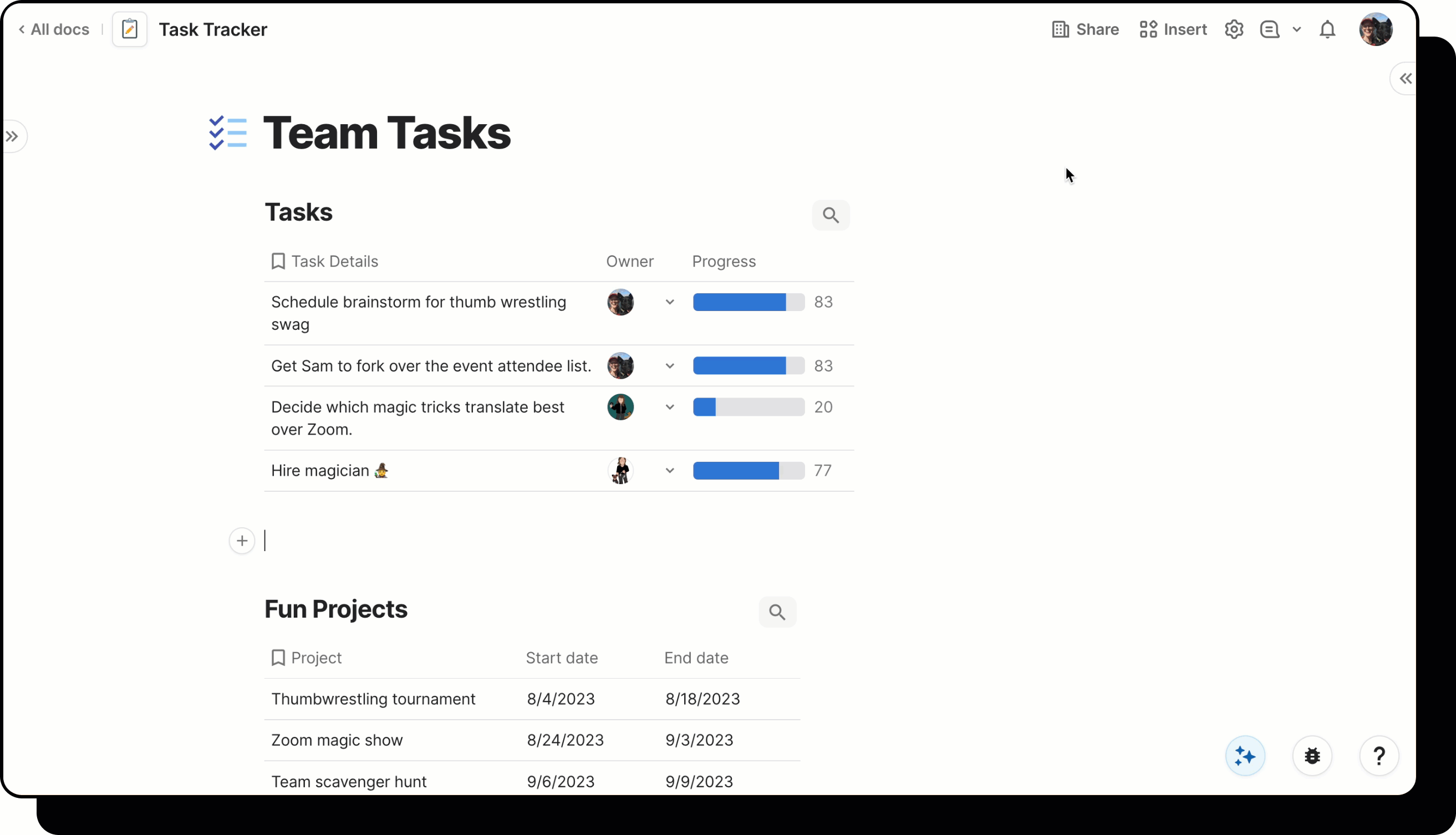

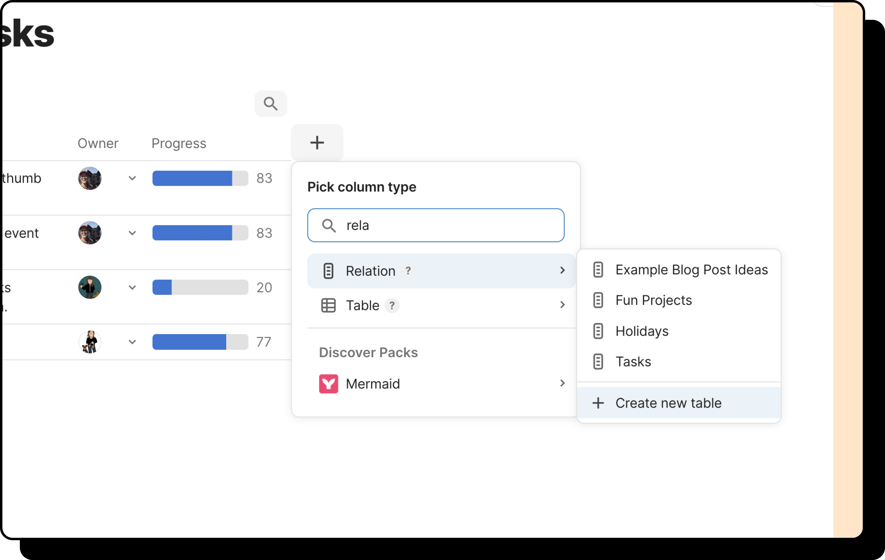

Create a relation column
You can add a relation column to any table. To get started:
  1. Click the + symbol in the upper right corner of your table to add a column
  2. Type relation, or select relation from the options
  3. Select which table you want to pull from
You can also convert an existing column to a relation column by right clicking on the column header, click Column type, then find relation in the options.
Gif showing user add relation column.
💡Tip: When converting an existing column to a relation, you can choose to create a new table with the existing column data. To do so, follow the steps above but instead of choosing which table to connect to, click the +create new table option.

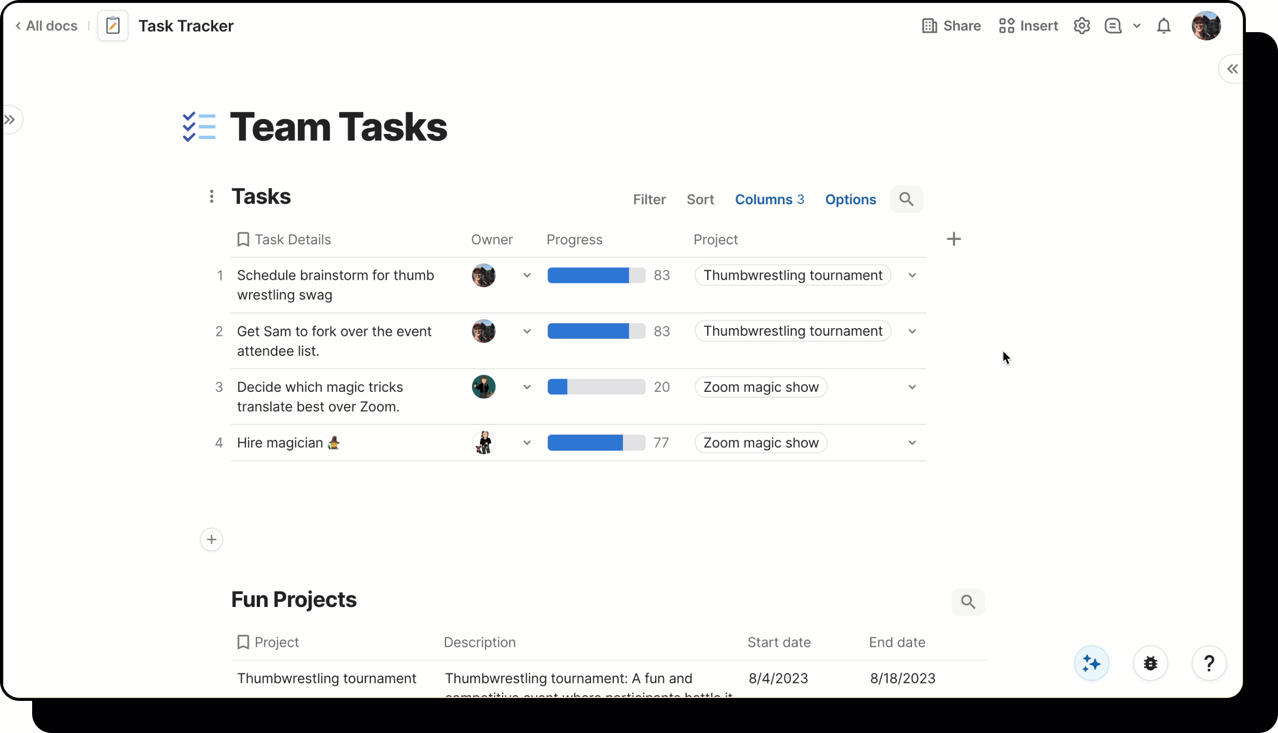

Now that column will be a dropdown list with all the options from the table you selected. You can click into any cell in that column to see the list and start selecting values.
If you don't see the values you expect when you click the dropdown, head to the table you're pulling from and make sure that the display column is set to the column you want. You'll know something is a display column when it has a bookmark option next to the header. To set a new display column, click the column dropdown and choose Set as display column from the options. Learn more about the display column here.
Explore row references
Once you’ve created a relation column and added values to it, you may notice that the data looks a bit different than other columns. Specifically, you should see bubbles that you can hover over to reveal even more information. These bubbles are row references from the referenced table. When you hover over them, you should be able to see data from the other columns of that referenced table - not just the display column. You can even click the arrows icon in the upper right corner to expand that row and explore the data it contains.
Gif showing user expand row references from relation column.

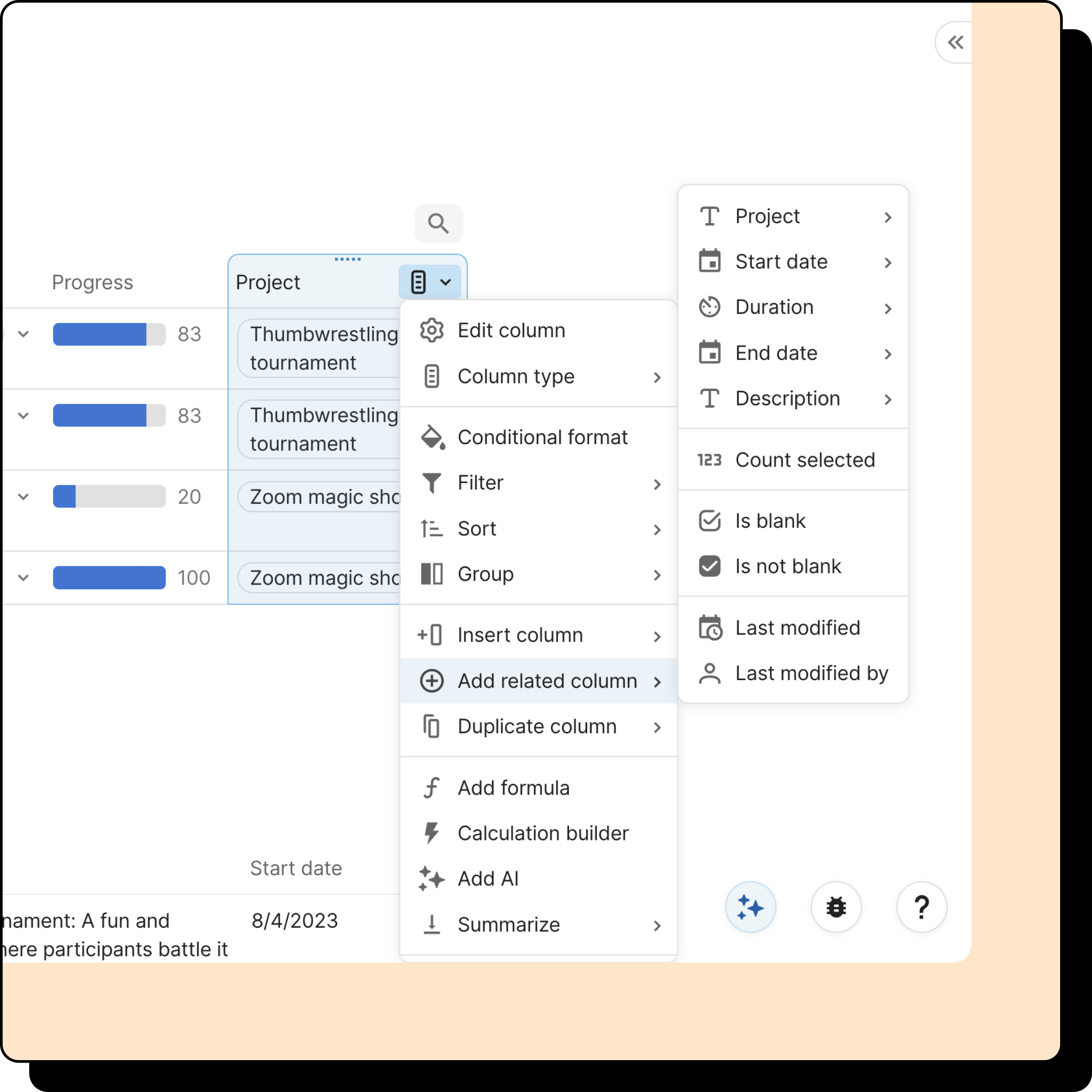

Add related columns
Once you’ve added a relation column, you can quickly add other columns from the referenced table. For instance, you have a Tasks table and are displaying related Projects via a relation column. But you also want to pull the quarter for each project into your tasks table. Easy!
Just right-click on the header of your relation column, hover over the Insert column option, and check out the Add related column section. Click on whichever related column you'd like to add.
Image of relation column options, with
Note that these added columns will be formulaic columns, and they’ll default to whatever column type the original column is. If you’re curious, you can click into the formula to explore.

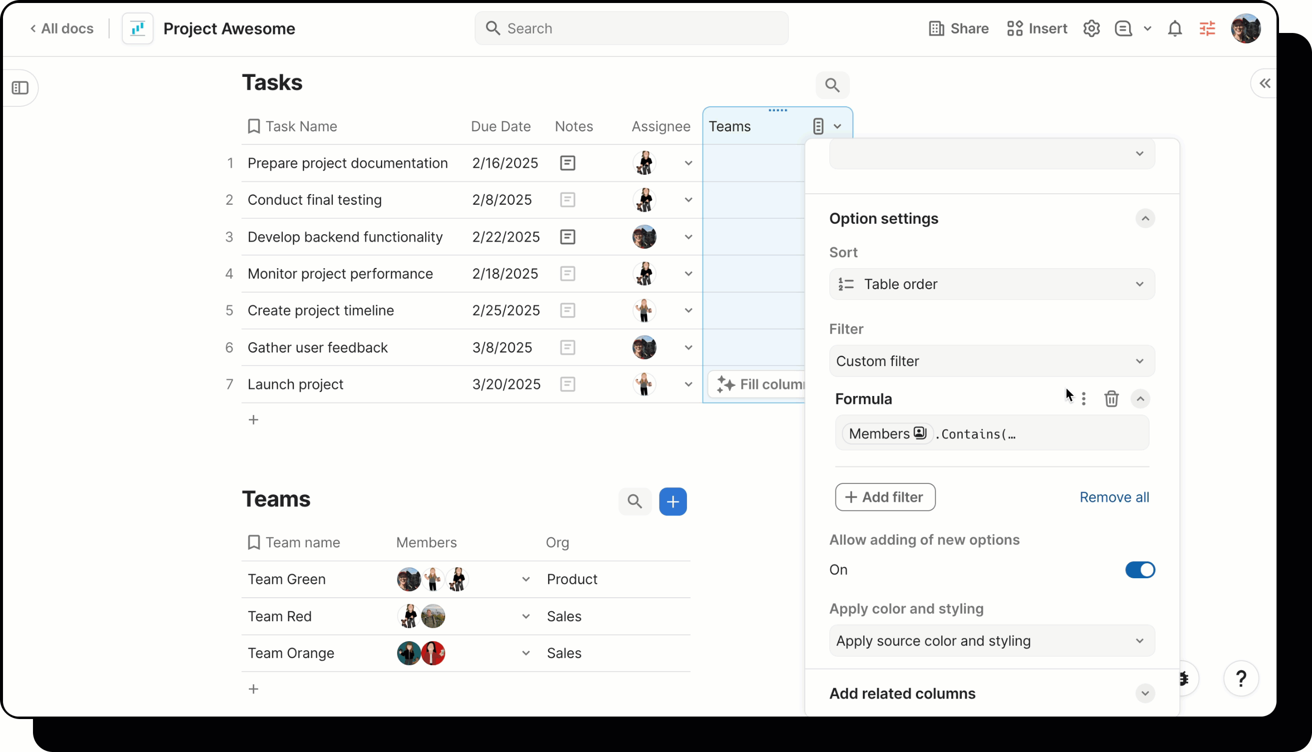

Filter relation column options
In some cases, you may prefer that not all row options appear in the dropdown of your relation column. For certain rows in your table, you may only want to show a subset of options in the relation column dropdown.
To filter which options show up in the dropdown for a relation, follow these steps:
  1. Right-click on the header of the relation column
  2. Select Edit column
  3. Scroll down to and expand Option settings
  4. Click into the Filter option, then either select one of the suggested filters or click Custom filter
  5. If you select Custom filter, click on Add filter to start building the filter rules. You can either select one of the columns from the relation table, and build a filter rule based on that column. Or you can click Formula to write your own custom formula.
Gif showing user apply filter to relation column.
Once you've added the filter, you should see the dropdown options in the relation column filter according to your rules.

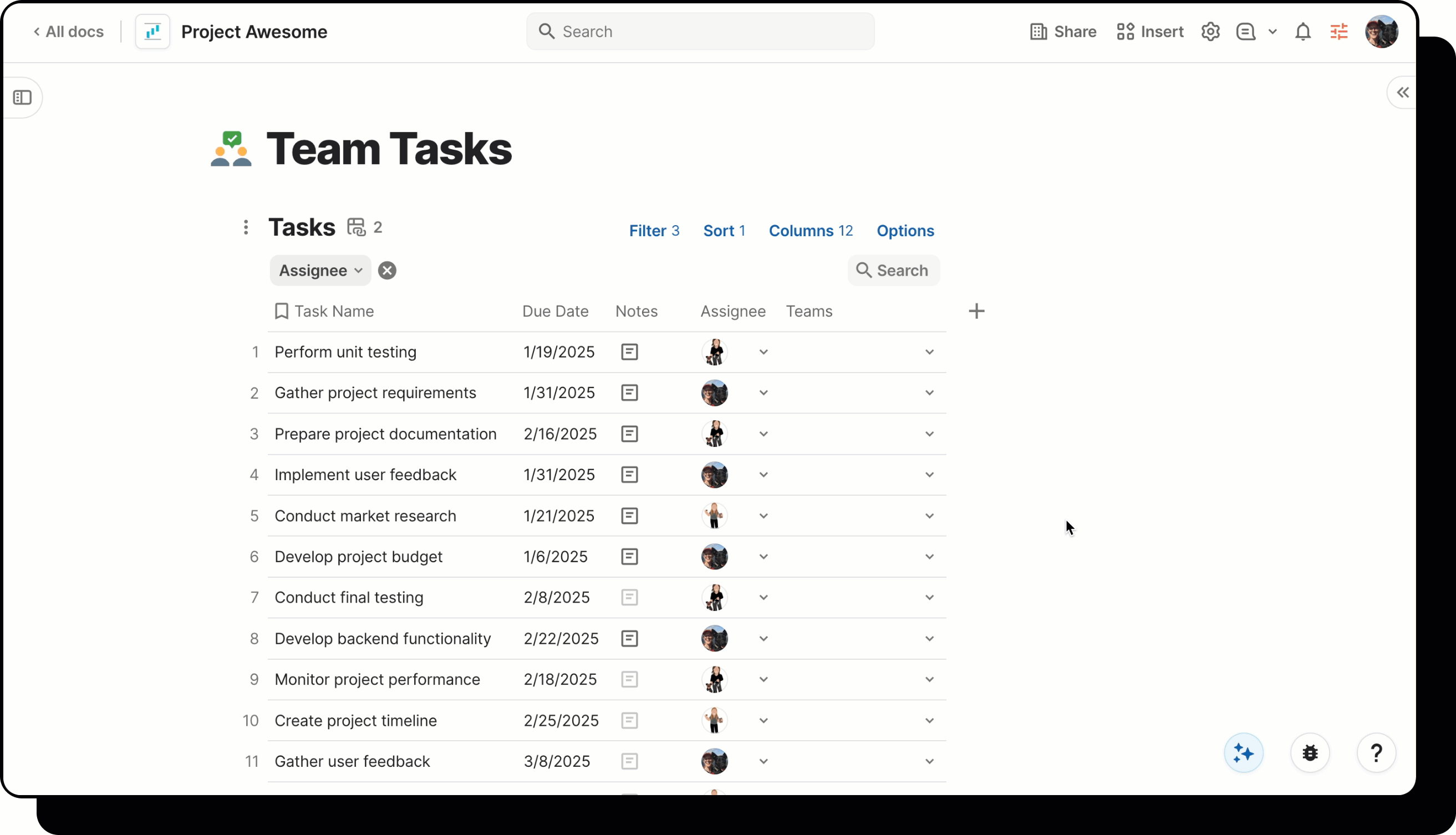

💡 Need an example?
Let's say you have a table of tasks (Tasks). Each task is assigned to a specific person and belongs to a particular team. The Tasks table has a people column (Assignee) and a relation column (Team) that references the Teams table. When people add a task, they will assign a person and then a team. But each person only belongs to one or two specific teams, as laid out in the Teams table. Therefore, you want the options shown in the Team column dropdown to be limited based on who was selected as the Assignee for that row. You can set this up via option filtering, as shown in the image below.
Gif showing user selecting column values with filtering affecting the selectable options.
