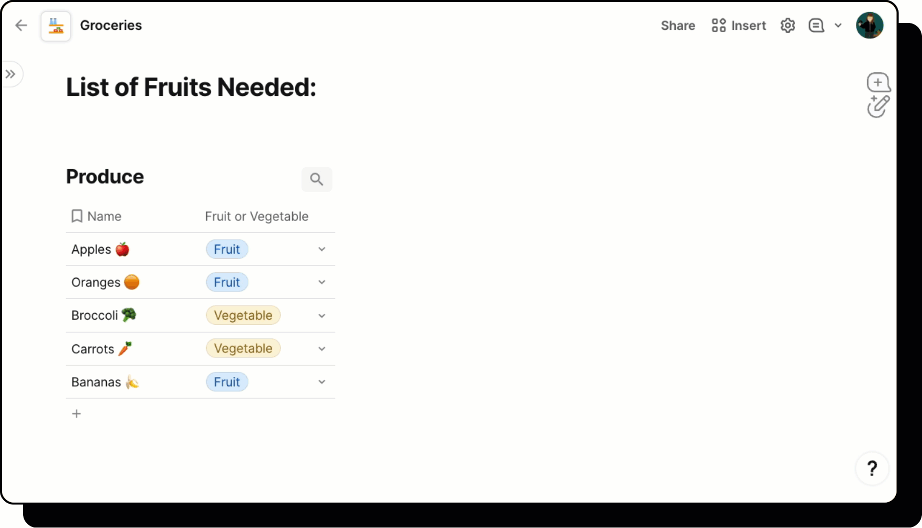

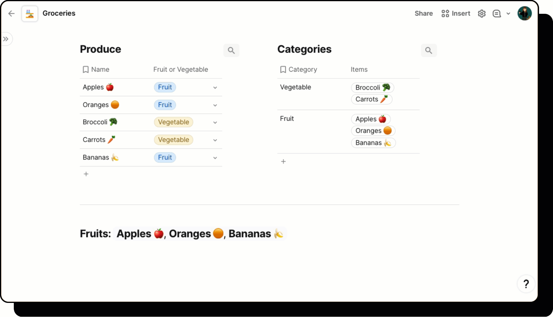

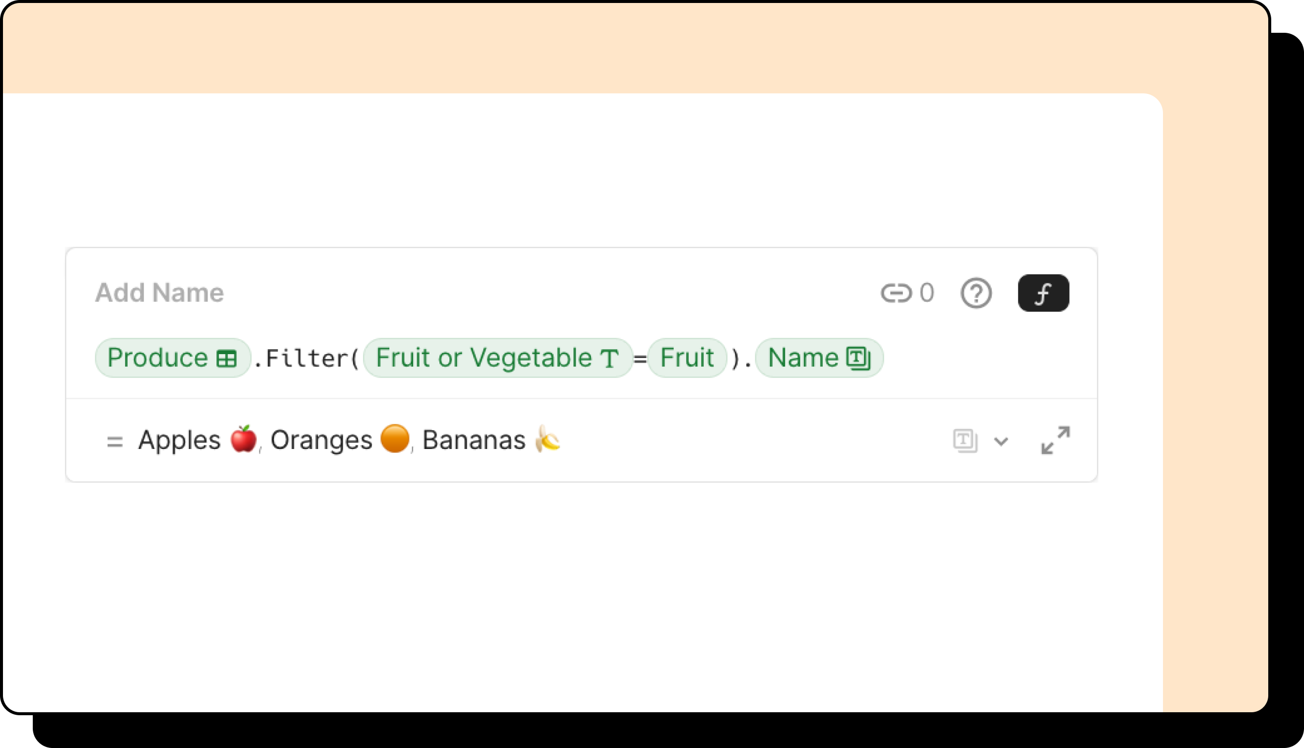

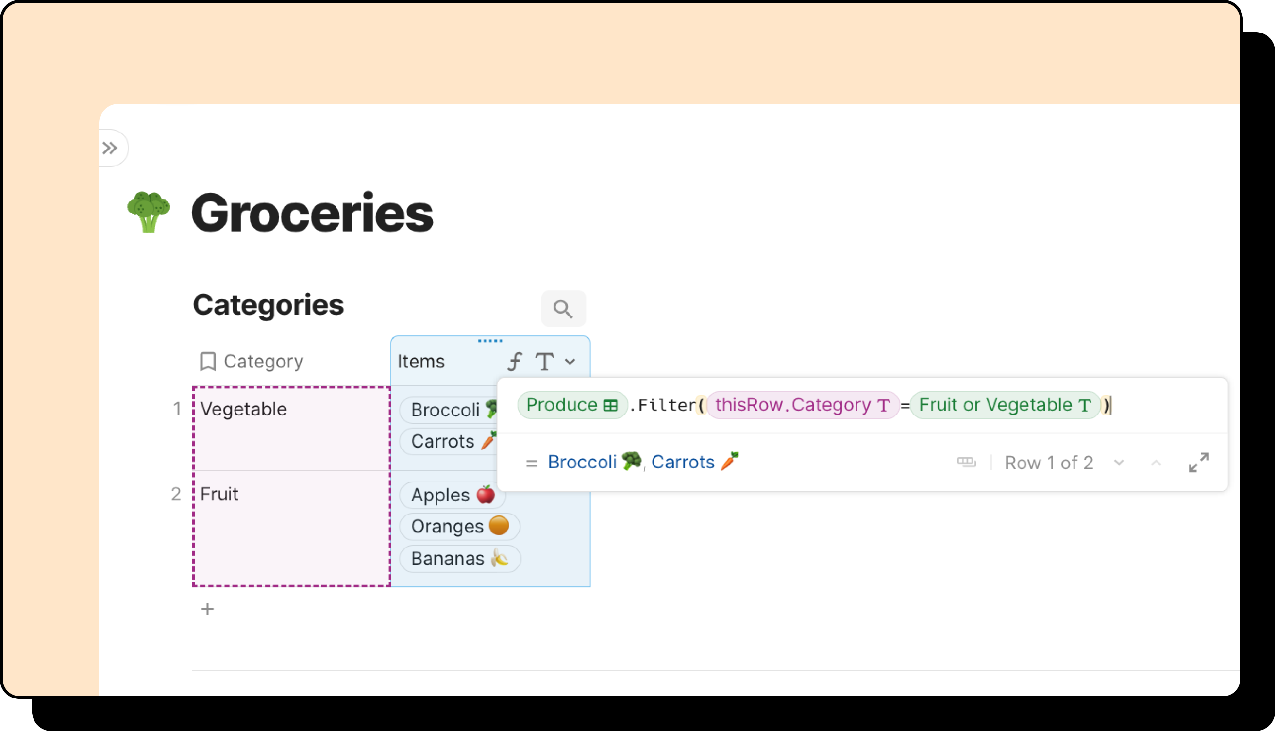

Formula chips
Chips are your Nouns, aka, Objects. When you click on a chip, you can learn more about that specific Object:
When we click on Fruit chip in this formula example above, we can see that this is an option in the Fruit or Vegetable column in the Produce table.
Color coding tells you the location
Formula chips of the same color mean that those objects are located in the same table:
Take a look at the example above. Based on the color of the chips, you can see that Produce and Fruit or Vegetable are part of the same table, and thisRow.Category is part of the Categories table.

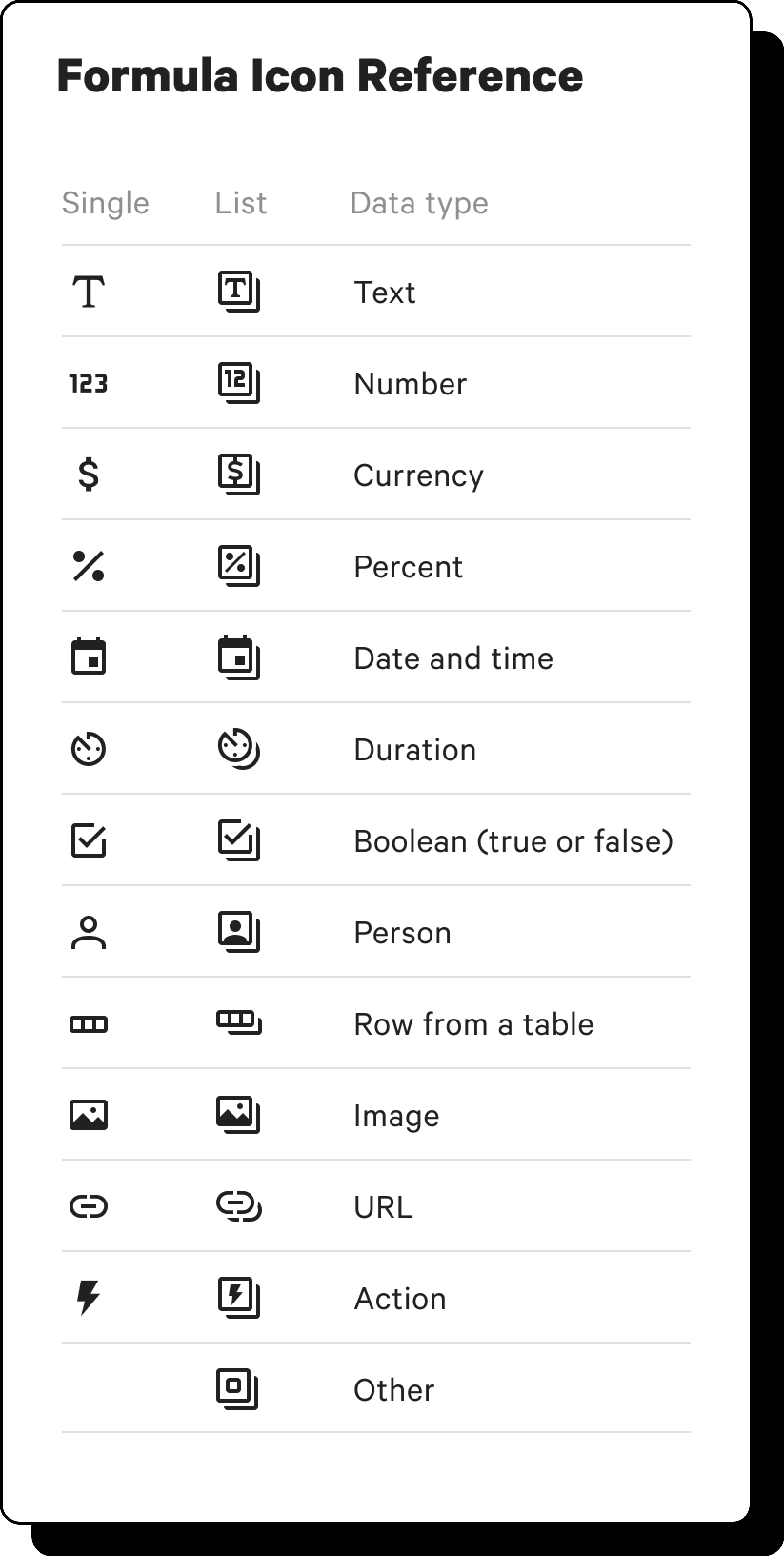

Icons tell you the type of data, and how many
Take a look at the reference below. These icons will be at the far-right of each chip in your formulas, and will note what type of data you are working with.
The icon will also tell you whether you are referencing a singular value vs a list of values, or an array of values — a list or array is more than one value. Notice the “stacked” icons for lists:

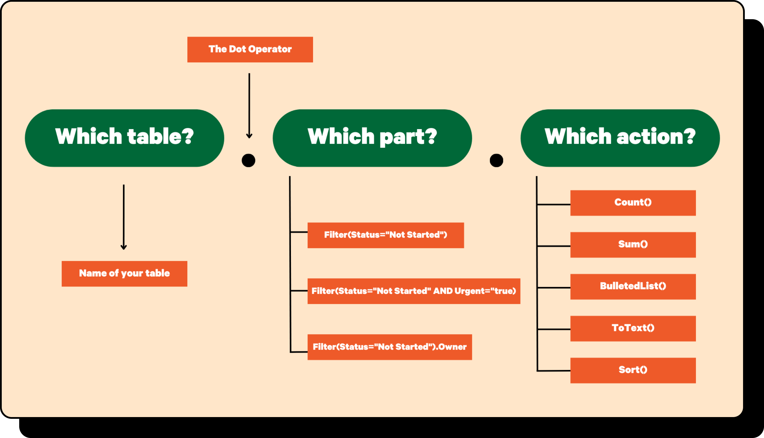

The Dot Operator
With the help of the Dot Operator, you can using the chaining method to write formulas for better readability.
Chaining separates steps in your formula by using a dot operator which is just a fancy descriptor for a .
At its most basic level, chaining looks like this:

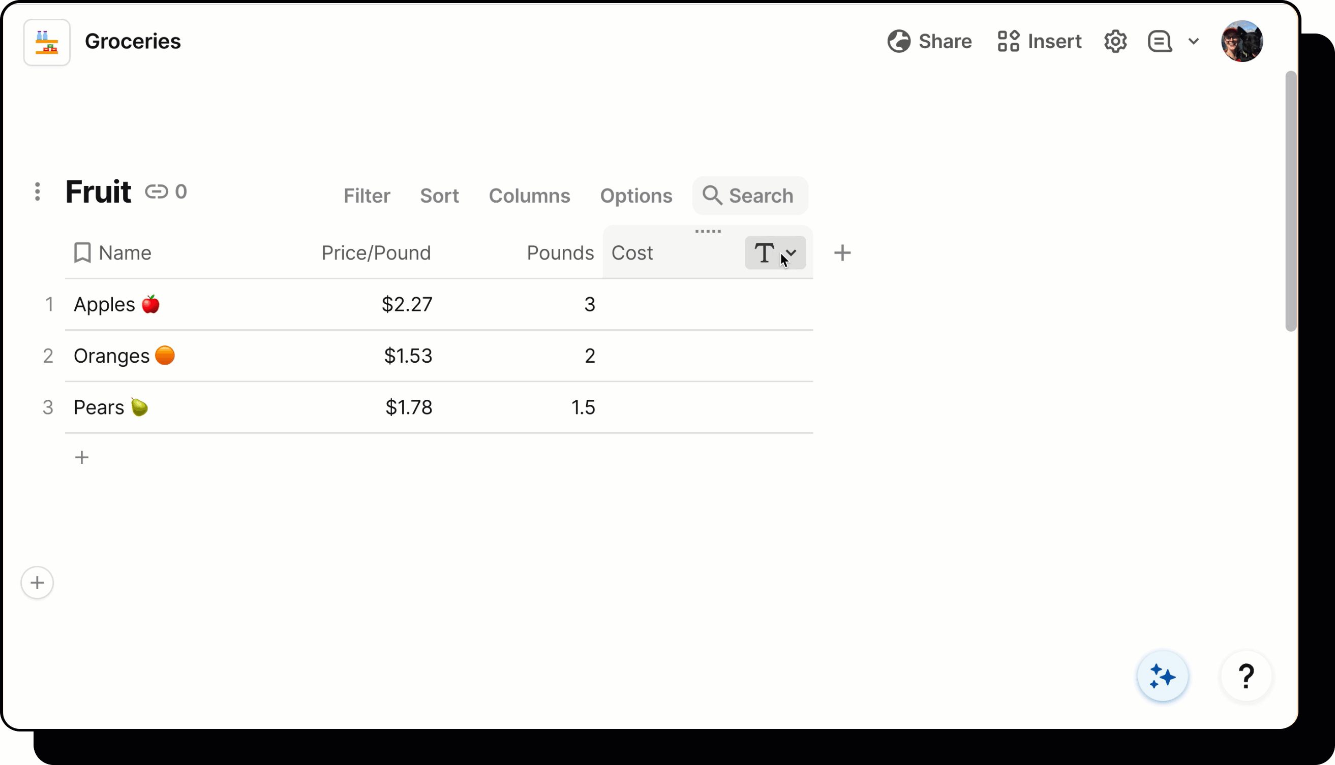

Can I add formulas to the canvas, or can I only use them in tables?
You can use formulas in both the canvas and in table columns💥
Column formulas are formulas in a table that perform calculations on the table data. Canvas formulas are formulas embedded in the canvas. They can be freestanding and independent or tied to data from anywhere else in the document to help summarize or aggregate key data or metrics.
In the example shown below, we have a table for your shopping list of fruit, with a column that calculates the cost of each fruit type. But we also want to know the total cost of all fruit in the table, and we want this value displayed on the canvas. That's where a canvas formula could come in handy. All we need to do is hit = while typing in the canvas to open up the formula builder.
