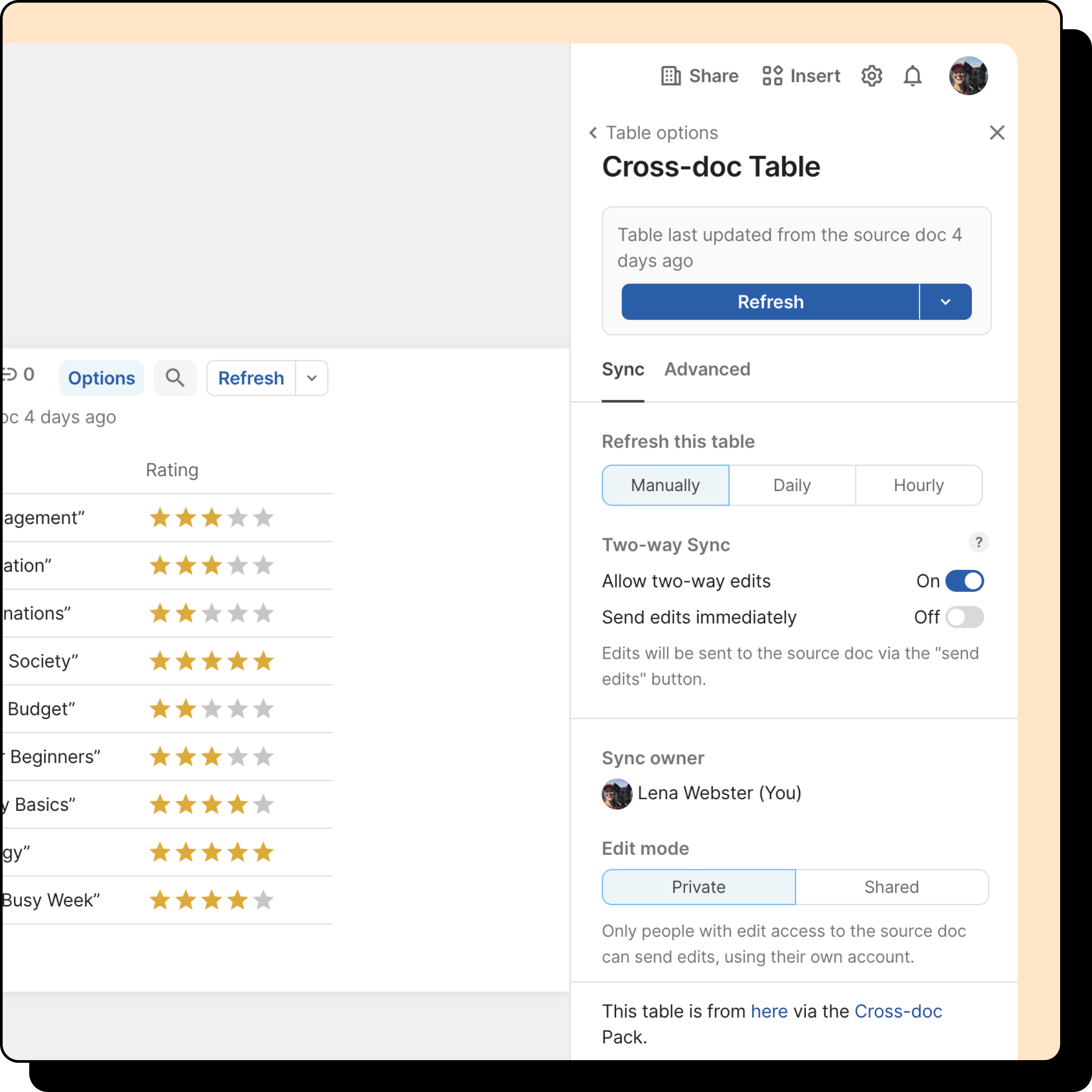

To enable two-way sync, follow these steps:
  1. In the upper right hand corner of your table, click on the down arrow (v icon) next to Refresh. Select Settings.
  2. Switch on the two-way sync toggle.
  3. The sync will automatically set your account as the account for making edits to the source table. You can choose whether this account is in private mode (usable by only you) or in shared mode (usable by everyone). Private is the default edit mode. Check out the section below to learn more about this.
  4. Choose how you want updates to be sent, via the Send edits immediately option.
    1. If this setting is toggled off, then edits in the sync table will only be pushed to the source table when someone clicks the Send edits button or at the next table refresh. If this setting is toggled on, edits made in the sync table will be reflected in the source data as soon as you’re done editing. This setting does not apply to adding or deleting rows - see note below.
Image of cross-doc pack settings, showing
ℹ️ Note that this Send edits immediately setting only applies to edits to existing rows; it does not apply to adding new rows or deleting entire rows. If you add or delete rows from your sync table, you will always have to push the Send edits button or wait until the next table refresh - regardless of what you've selected for this setting.
Now your two-way sync is all set. Check out the section below to learn about getting started.
Choose your edit mode
When you look in the settings of your two-way sync table, you’ll see a edit mode section. In this section, you (the sync owner) can choose to between private and shared. What does this setting mean?
First, a bit of background info: When you create a new Cross-doc table, your account is automatically used as the sync owner for that table. This means that your account is used to pull the data from the source doc into the sync doc. Everyone with access to the sync doc can see this data, without connecting their own accounts.
When you enable two-way sync, your account will also be used to make edits to the source doc. Your account can have one of two edit modes:
  • Private: By default, the edit mode is set as a private. This means that only you - the account holder - can make edits to the source table via this two-way sync. Anyone else who wants to make two-way edits will have to use there own account. Note that you must have edit access to the source table in order for these edits to succeed.
  • Shared: If you change the edit mode to shared, then anyone with edit access to the sync table can make changes to the source table via your shared account. They will not need to connect their own account. They also don’t need to have access to the source table, since the edits will be made via sync owner’s shared account. Note that the sync owner’s account must have edit access to the source table in order for these edits to succeed.
For optimal security, we recommend leaving the write account in private mode. This ensures that only people with access to the source table can make edits.

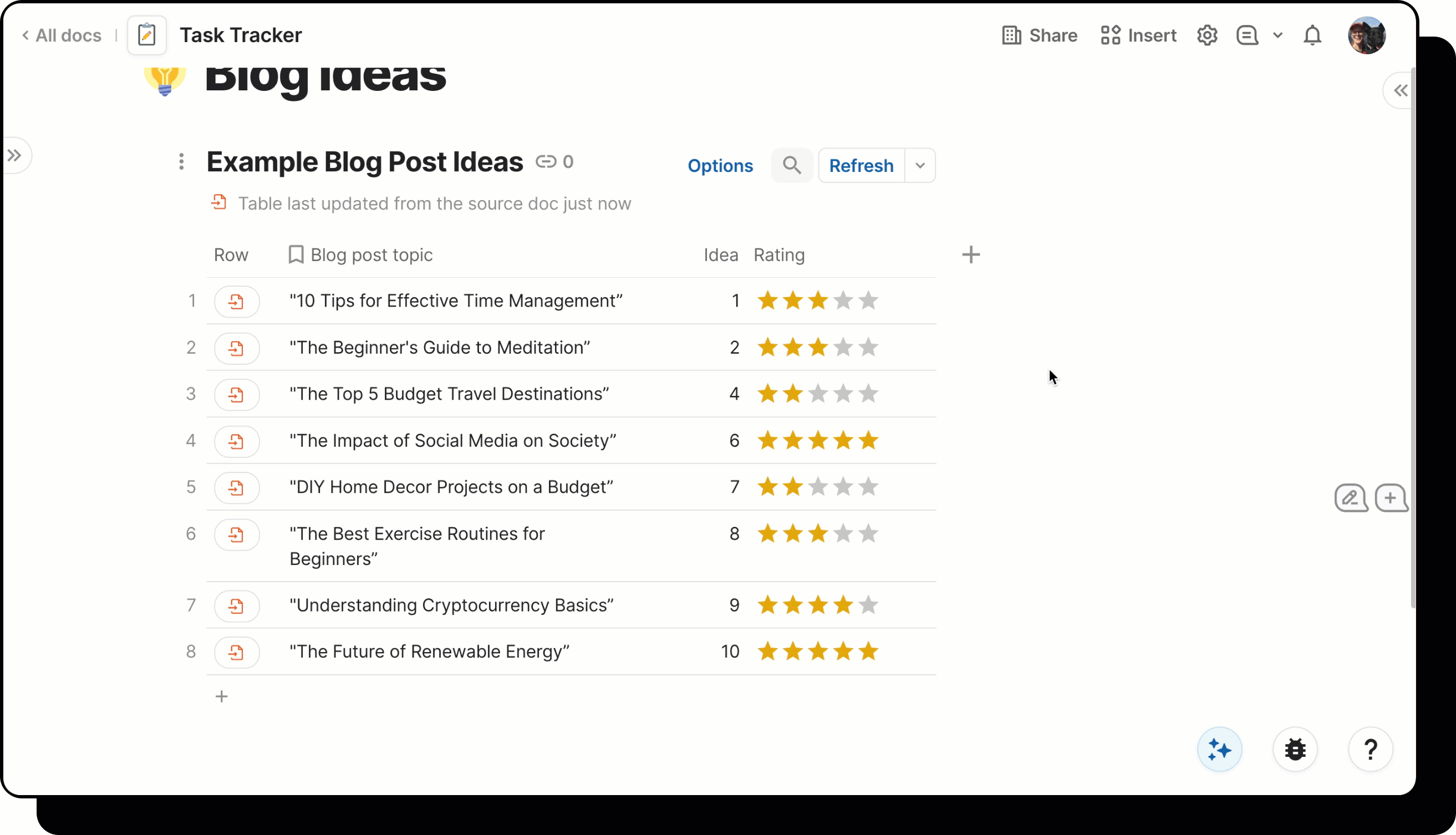

Make edits via two-way sync
Once you’ve enabled two-way sync for your Cross-doc table, you can start editing your sync table. Edits include...
  • Make edits to existing rows: To make edits to an existing row in your sync table, just click into a cell and start typing. If you’ve selected automatic updates in the settings, any edits you make to existing rows will be pushed to the source table as soon as you click out of a cell. If you’ve opted to have updates sent manually, you’ll need to push the Send edits button in the upper right corner of your table (or wait until the next table refresh) to push these edits back to the source table.
  • Delete a row: To delete a row, simply select the row and hit the delete key on your keyboard. The row will immediately disappear from the sync table. In order for this update to be reflected in the source table, you will need to push the Send edits button in the upper right corner of the sync table (or wait until the next scheduled table sync)
  • Add new row: To add a new row, click on the +New row button at the bottom of the table (or use any of the other methods available to add rows), then edit the new row as desired. Once the new row has been filled in, click on the Send edits button to send this new row to the source table. Note that you must always push the Send edits button (or wait until the next scheduled table sync) for this update to be reflected in the source table.
Gif showing a user adding rows to a table and clicking button to send edits.
