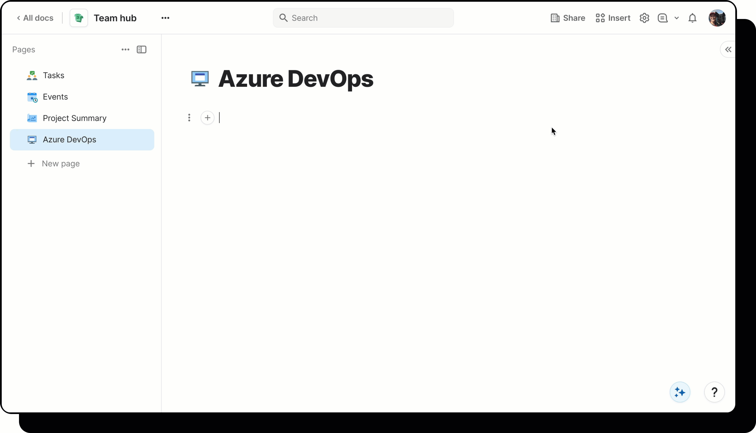

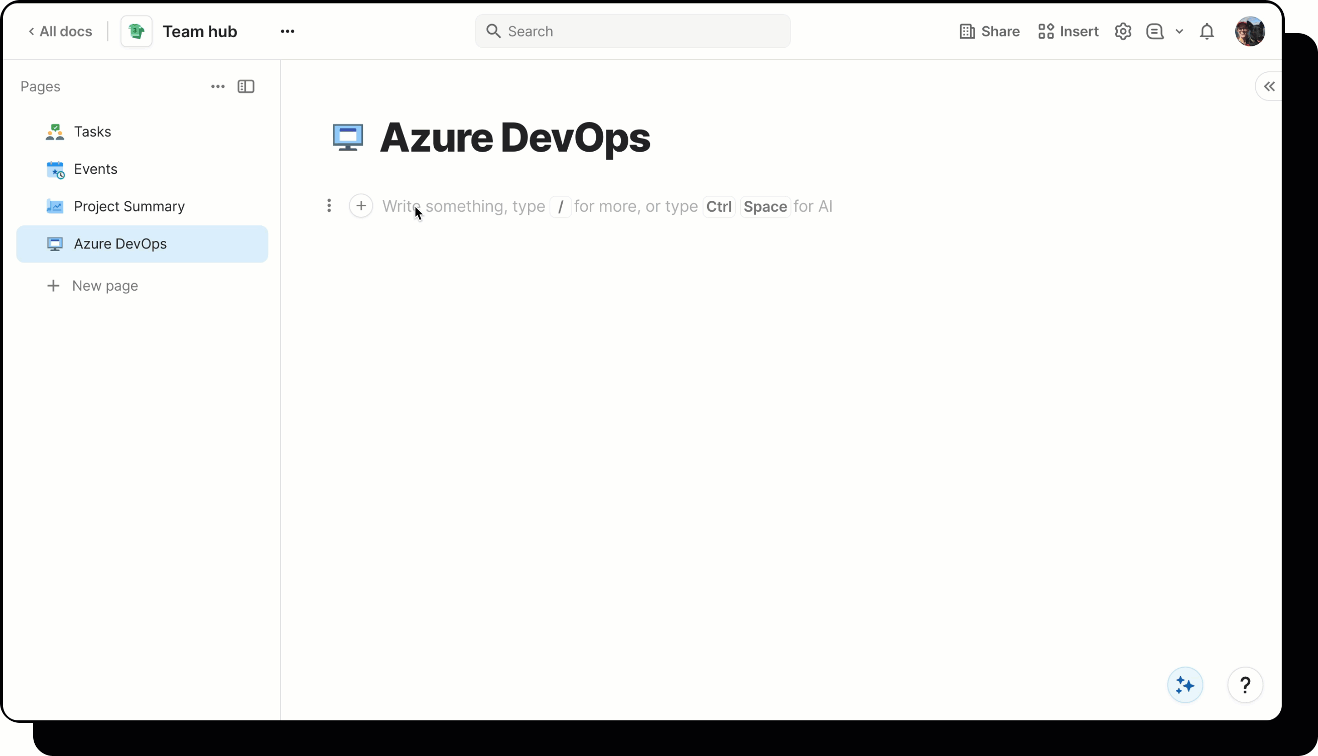

  1. On any blank line in your doc’s canvas, type a forward slash, followed by “Azure” (e.g. /Azure )
  2. From the drop-down menu, select Azure DevOps (under the More Packs header)
  3. Then click the Add to doc for free button in the upper right.

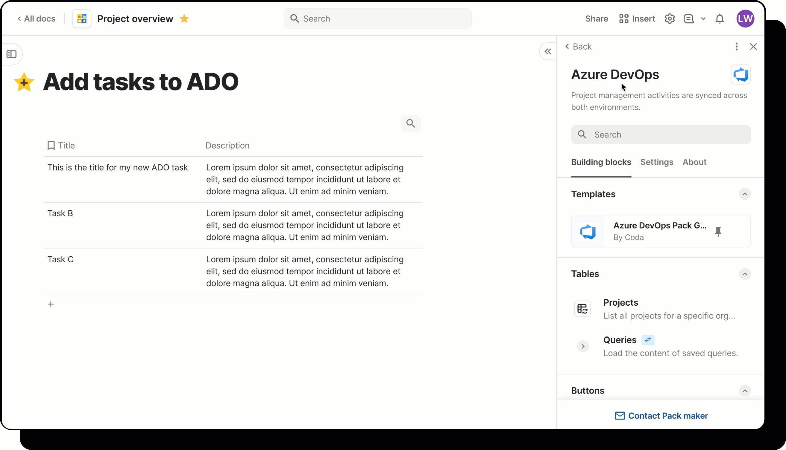

Once you’ve installed the Pack, you’re ready to start using any of its many building blocks. To see what this Pack has to offer, head to the Pack page by following these steps:
  2. Select Packs
  3. Under Installed Packs, select Azure DevOps
  4. Scroll through the Building blocks tab to see all the ways you can start using the Pack. You’ll see templates, tables, buttons, columns, formulas, and more.

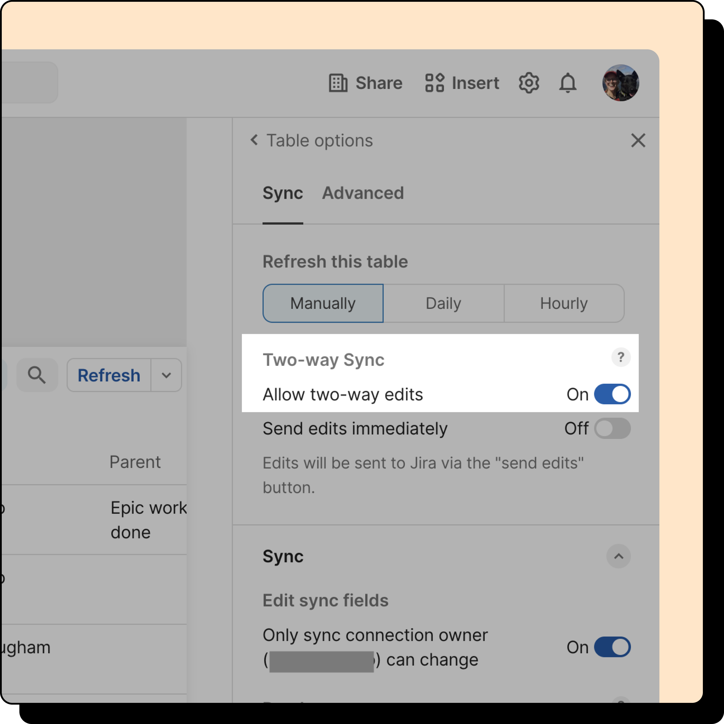

  8. Once loaded, head to the table settings in the right-hand panel. To turn on two-way sync, toggle on the Allow two-way edits option.
    1. If you prefer for edits in Docs to be sent immediately to Azure DevOps, also toggle on the Send edits immediately option. Otherwise, edits in Docs will only be pushed to Azure DevOps when someone clicks the Send edits button or when the next table refresh occurs. Learn more about two-way sync settings here.
  9. Make any other necessary adjustments to the table settings, such as changing the refresh rate (manual, daily, or hourly).
