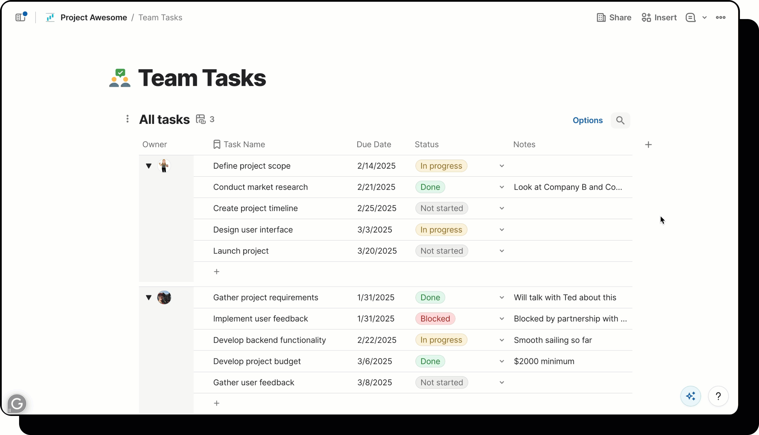

  1. Locate the table or view you want to filter. Choose the column that you want to filter based on, and right-click on the header.
  2. From the list of options, hover over the Filter, then choose the Canvas control option.
  3. Click on + Create control to create a new control filter
    1. If you want to use an existing control instead, choose it from the options shown.
Gif showing user create control from column options.
A control will appear directly above the table and will automatically be connected to the table or view. The control is ready to use! If needed, you can customize the control via the steps below.

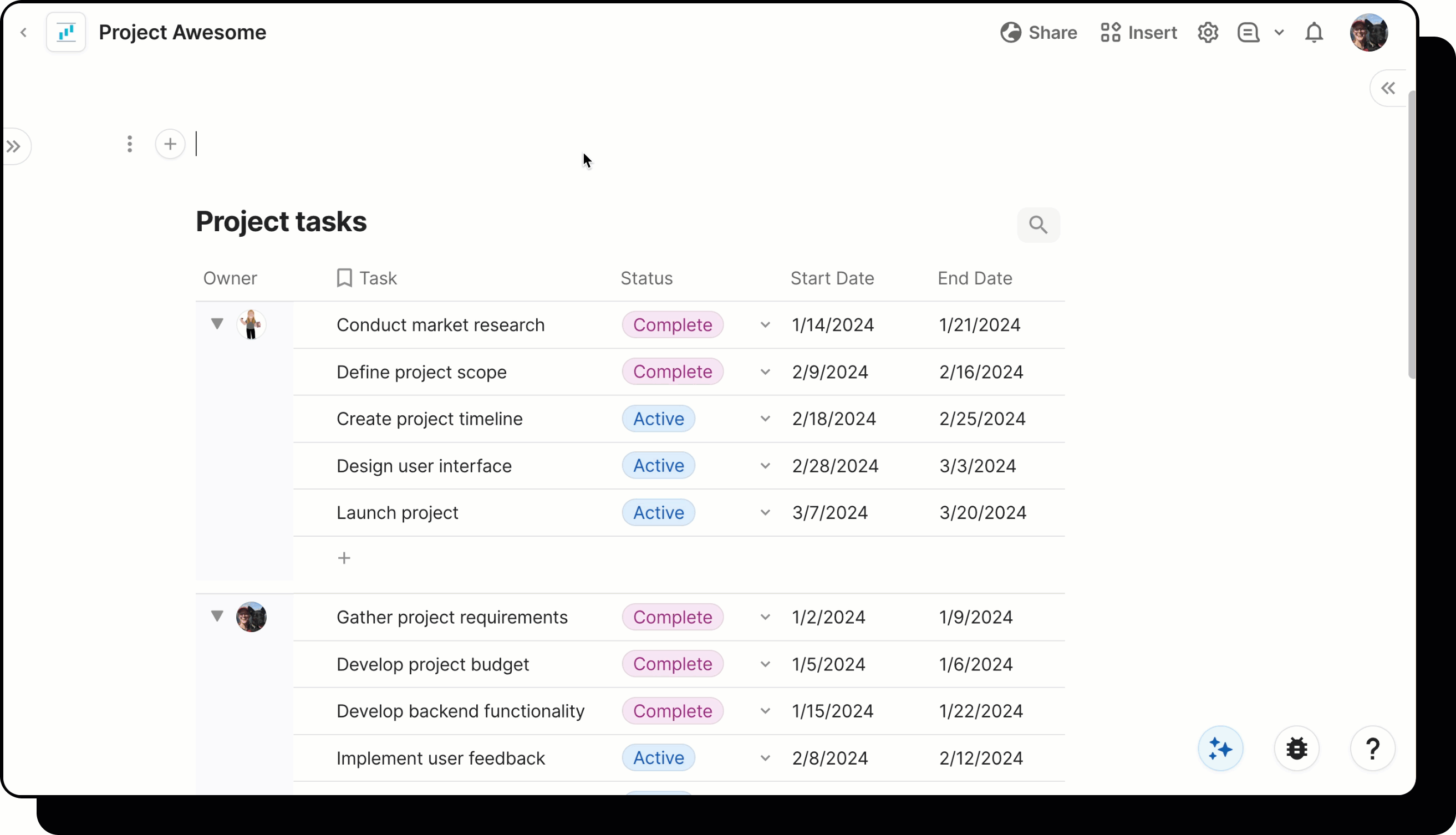

  1. Locate the table or view you want to filter. Hover over the table, click Options in the upper right corner, then select Filter from the list. This will open the filter builder.
  2. Click on +Add filter
  3. From the list of columns, choose the column that you want to filter by
  4. A new filter rule will be generated. Click on the text directly under the column name, and choose the uses canvas control option.
  5. If no controls exist for this table, you’ll only see a Create control option. Click this to automatically add a new control to the canvas above your table.
    1. If your doc already contains a control that matches this column type, you’ll have the option to either use that existing control or to create a new control (via the + Create control option).
That’s it! A control will be created directly above the table or view. The control type will match the selected column type. This control is automatically connected to the table as a filter, so you can start using it to filter. Just click on the control to modify the value, and watch the table or view filter accordingly. If needed, you can customize the control via the steps in the section below.

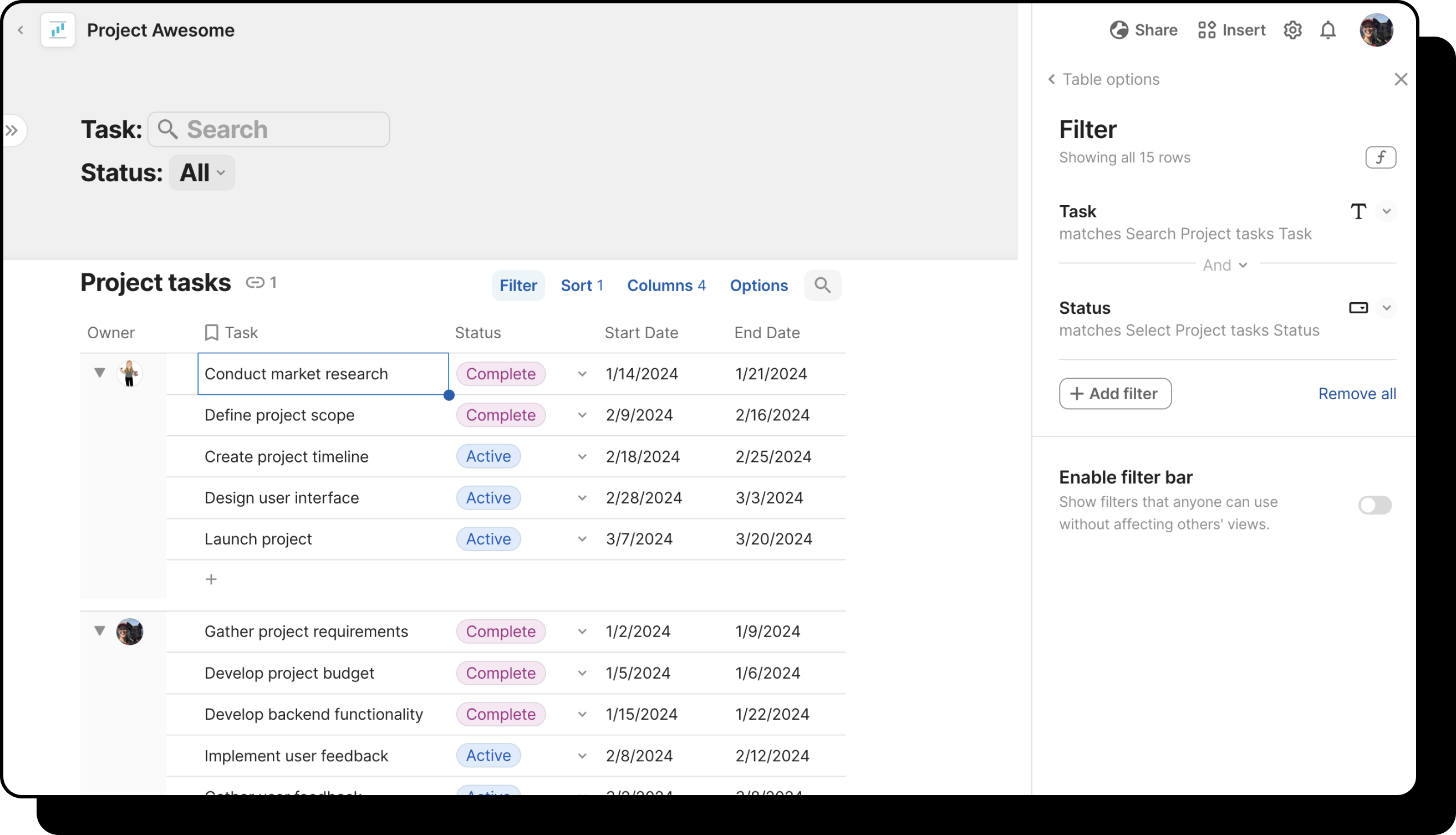

You’ll see in the filter builder for the table that multiple filter rules now exist, one for each control. By default, these filters will be additive (notice the AND between the filter rules in the screenshot below). So the table will show results that are the overlap of the multiple filter criteria. If you instead want to see results that match either one control or the other, you can change this AND to an OR in the filter builder.
Image of table's filter settings.

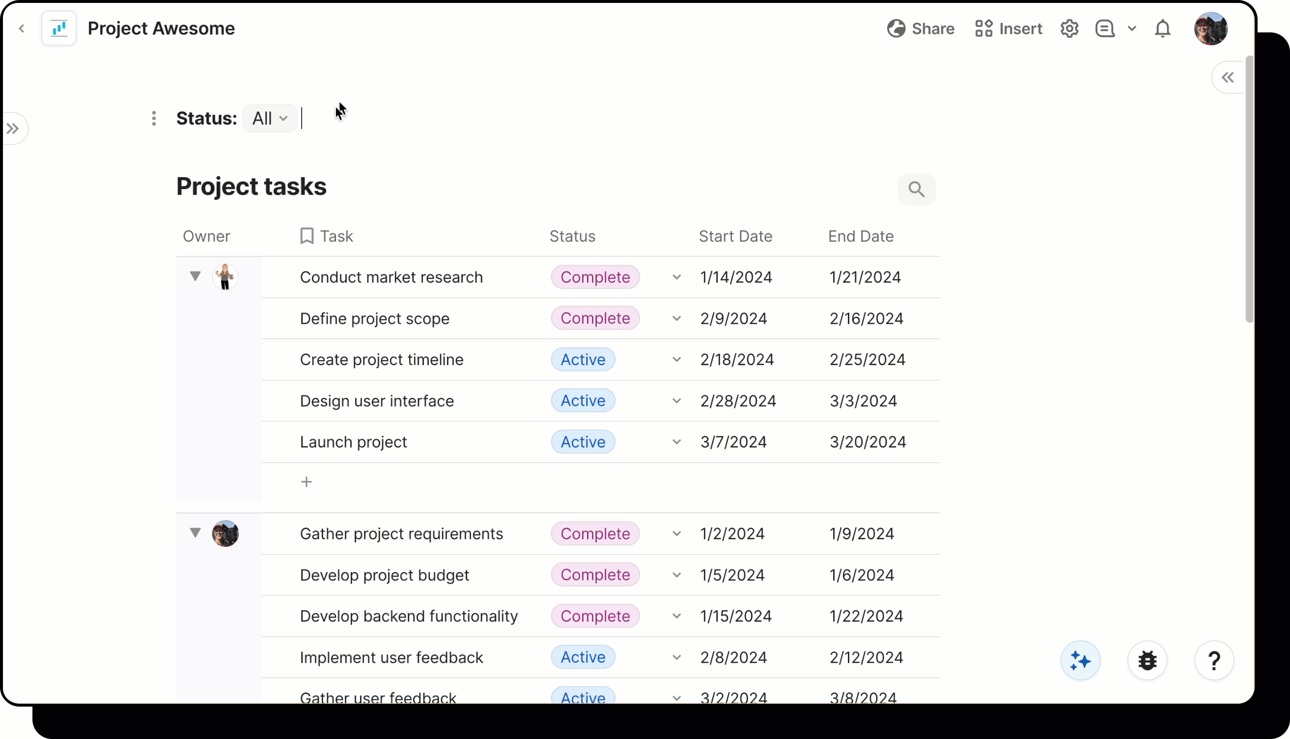

Set starting value
At the bottom of your control settings, you have the option to set a Starting value. This field allows you to specify the initial value that is populated until you choose to modify it. Note that this field is only available for personal controls.
For example, in the example control below, “Active” is the value that you will see if you haven’t modified the control value. Also, any buttons with the Reset control value action will revert the control back to “Active.”
Gif showing user set starting value for control.
