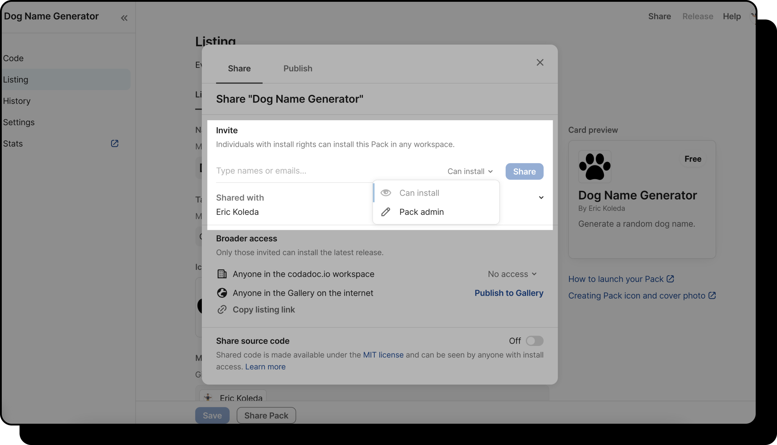

To invite people to collaborate, follow these steps:
  1. Open your Pack in the Pack Studio
  2. Click Share in the upper-right corner
  3. In the Invite field, type the email address of the person you’d like to share your Pack with
  4. Click into the dropdown on the right to choose their permission level: Can install, Can test, or Pack admin. See the section above on collaborator permissions for more info on these options.
  5. Finally, click the Share button to officially invite this person to your Pack.

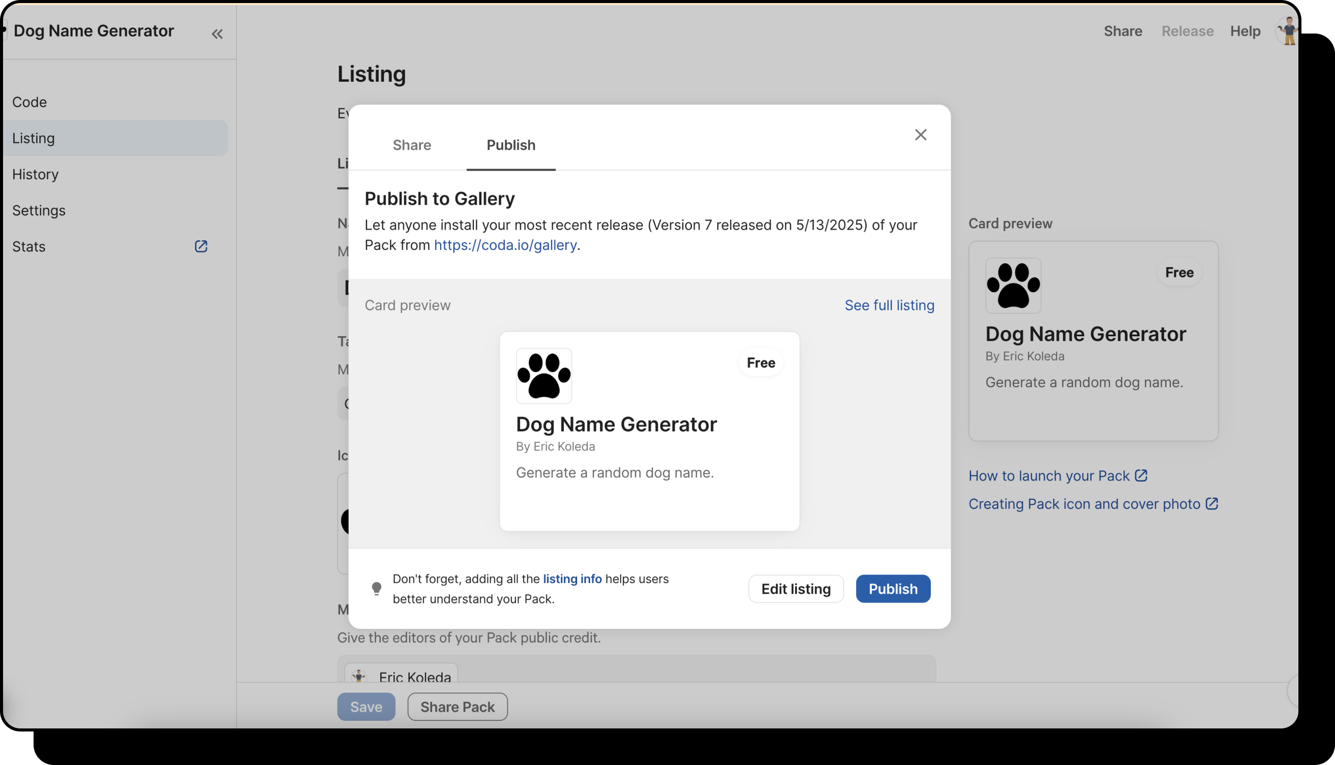

Publish your Pack to the Gallery
Now that your Pack is ready to publish, you’re only a few clicks away:
  1. While on your Pack page in the Pack Studio, click Share in the upper-right corner
  2. Click into the Publish tab
  3. If you’d like to see a preview of your Pack in the Gallery, click the See full listing button
  4. Once ready, click the Publish button
Congratulations! You have just published your Pack to the Gallery. You can share your hard work with others by sharing your Pack listing page URL, which is auto-generated for you on the confirmation screen.

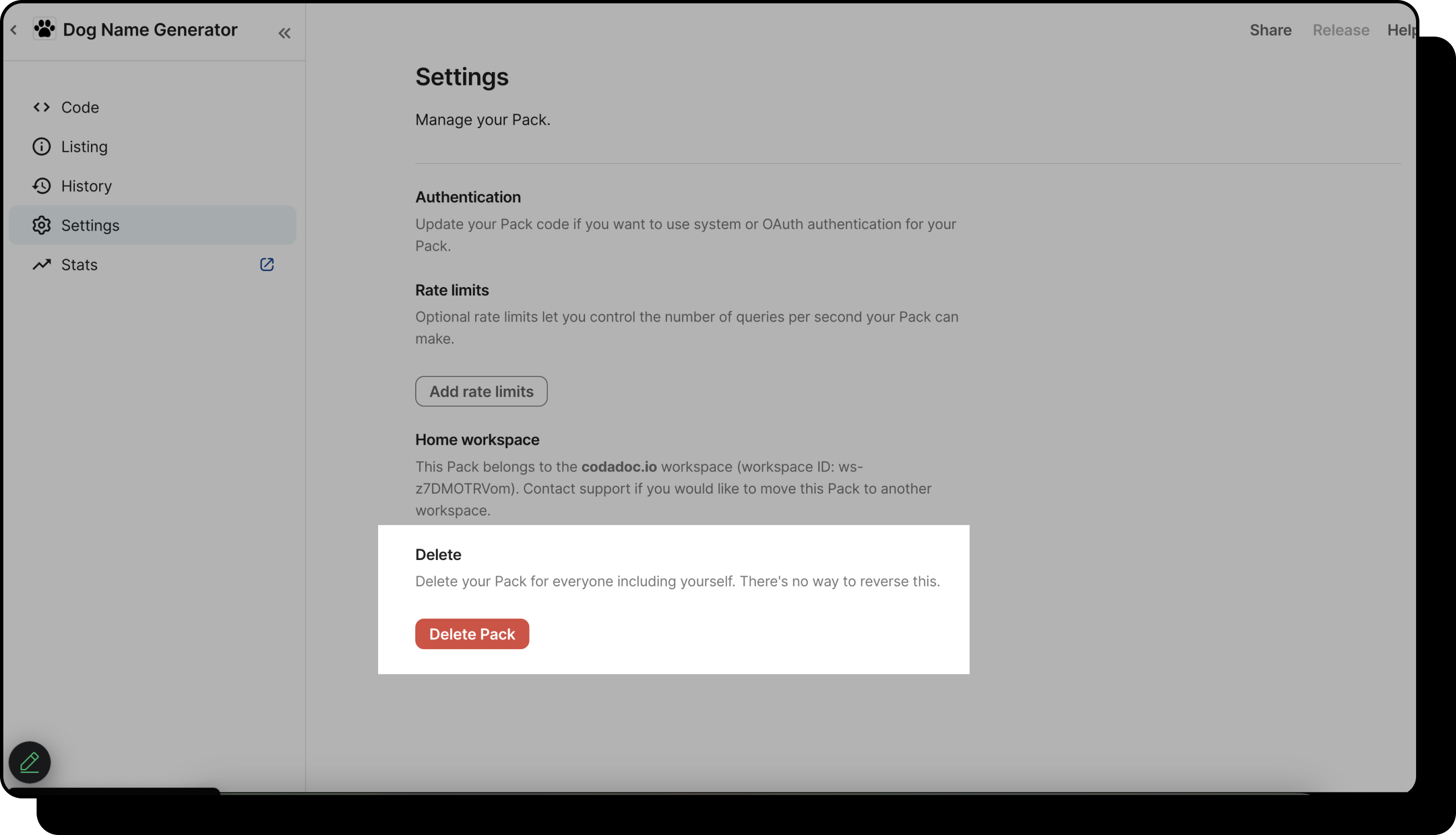

How do I delete a Pack that I built?
You can delete a Pack by going into the Pack editor, navigating to the Settings tab, and clicking the Delete Pack button.
This action is irreversible and immediate. Similar to unsharing and unpublishing, it will immediately disable the Pack in all the docs it’s been installed in, and those docs may no longer function correctly.
For Packs that are shared with others (either directly or through publishing), we strongly recommend not deleting your Pack, as it will immediately cause issues in the docs where this Pack was previously installed. Additionally, there is no way to recover your source code once a Pack is deleted. Instead, we recommend posting in the Coda Community to see if you can hand off your Pack to someone else.
