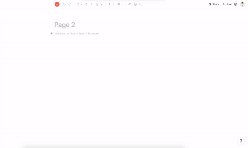

  1. Click Insert on the top-right corner of your doc
  2. Click into the Packs tab
  3. Then search for and select the Cross-doc Pack
  4. This will open some options for the Pack in the right panel. Select the Settings tab.
  5. Under Shared accounts, you should see something labeled "Read-write access to <table name>". Click on this option.
  6. Change the drop-down from View data to Take actions and view data.
