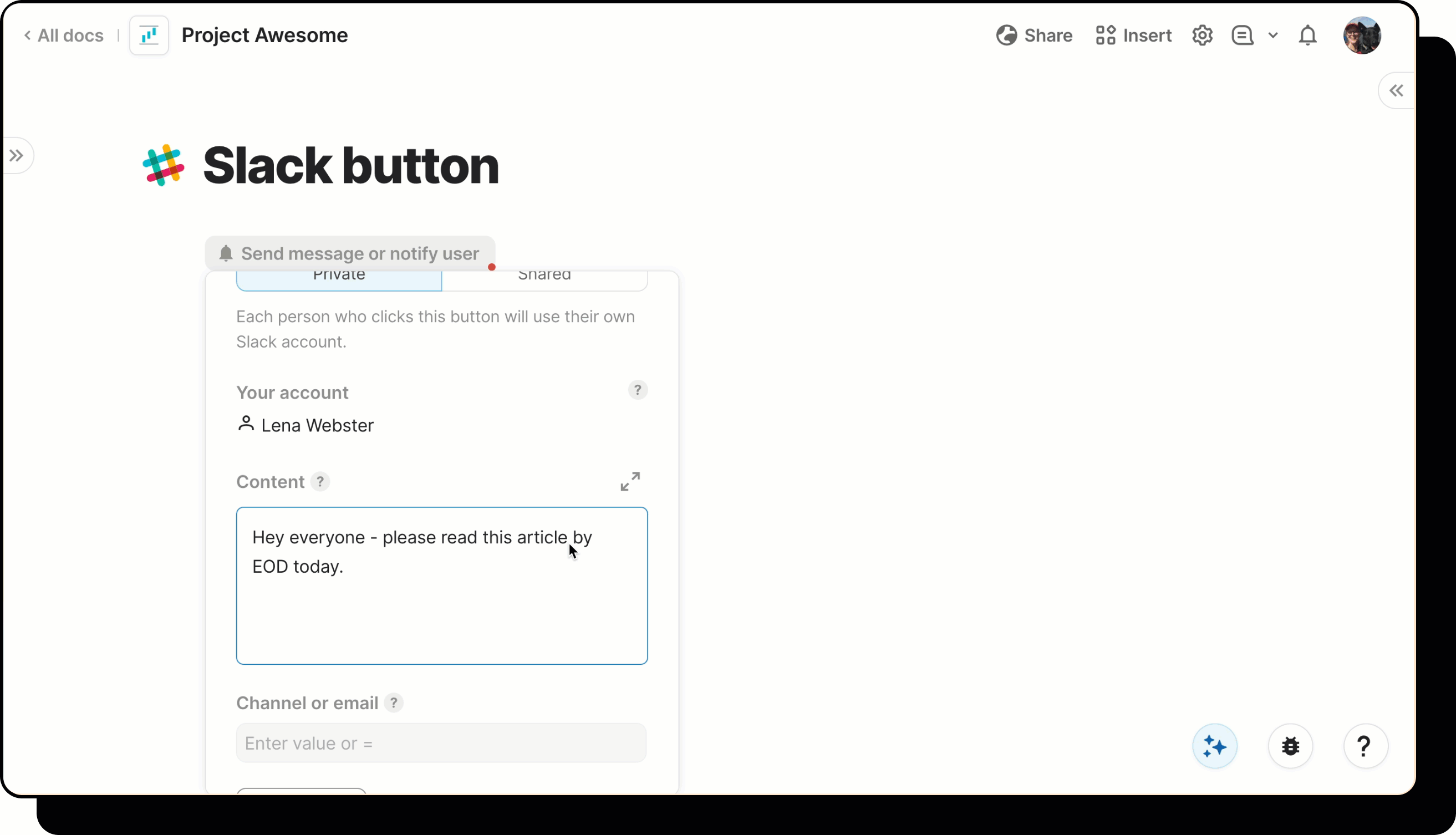

In the settings of your button or automation, you can write out the content of your message (in the Content field). You can use the @ symbol to reference people, pages, tables, and more.
You can even create dynamic text using the formula builder. Just type = into the Content field, and the formula builder will open. If your button is part of a button column, you can use the formula builder to dynamically pull text from that row of your table. Check out the example below to see this in practice.
Additionally, you can add formatting to your text in this Content field. If you bold, italicize, and underline text, this formatting will carry through to Slack. Hyperlinks will also be preserved.
💡Tip: Next to the Content field, you can click on the icon with the arrows to expand. You will also see previews of what the message will look like for each row in the table (if your button is in a table).

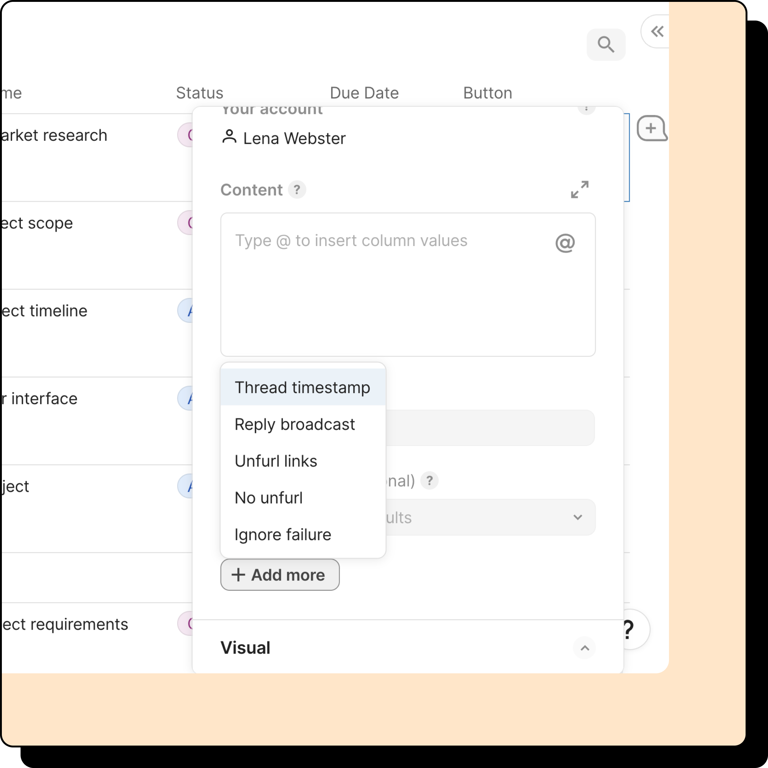

There are several optional fields you can also use in your Slack message button setup. Each of these fields should show a small ? near the field name, which reveals more info about the field when hovered over. Below are some of the more commonly used fields:
  • Results column: Pick a column in your Coda table, and this results column will be populated with a code whenever the Slack button successfully sends a message for that row. This is a way to confirm that the Slack message was sent.
  • Thread timestamp: Use this field if you want your button to send Slack messages as a reply to an existing thread. Put the timestamp of said thread into this field, so Coda knows which thread to send to.
  • No unfurl: This checkbox tells Slack whether or not to unfurl any links that may be included in the message.

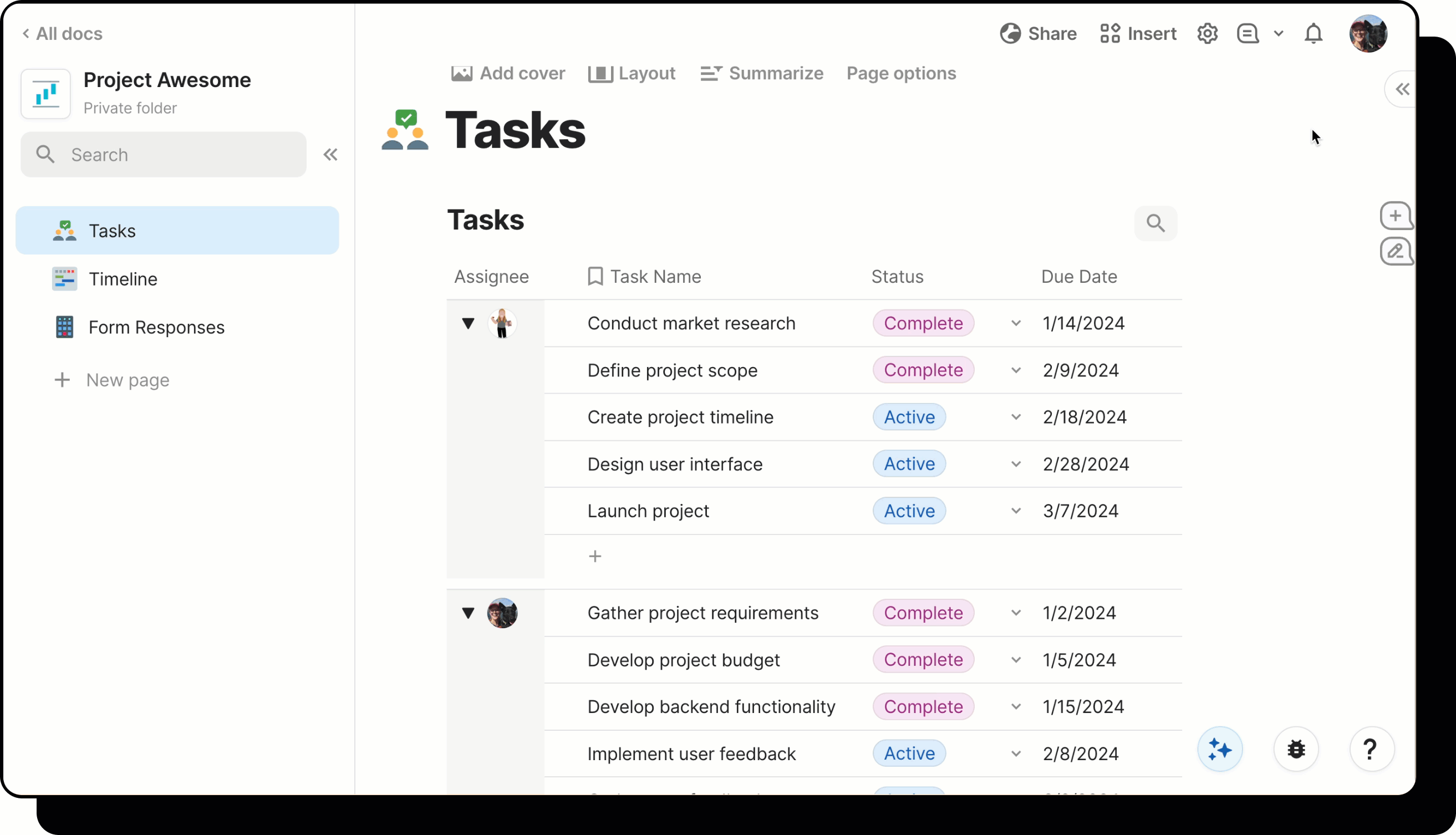

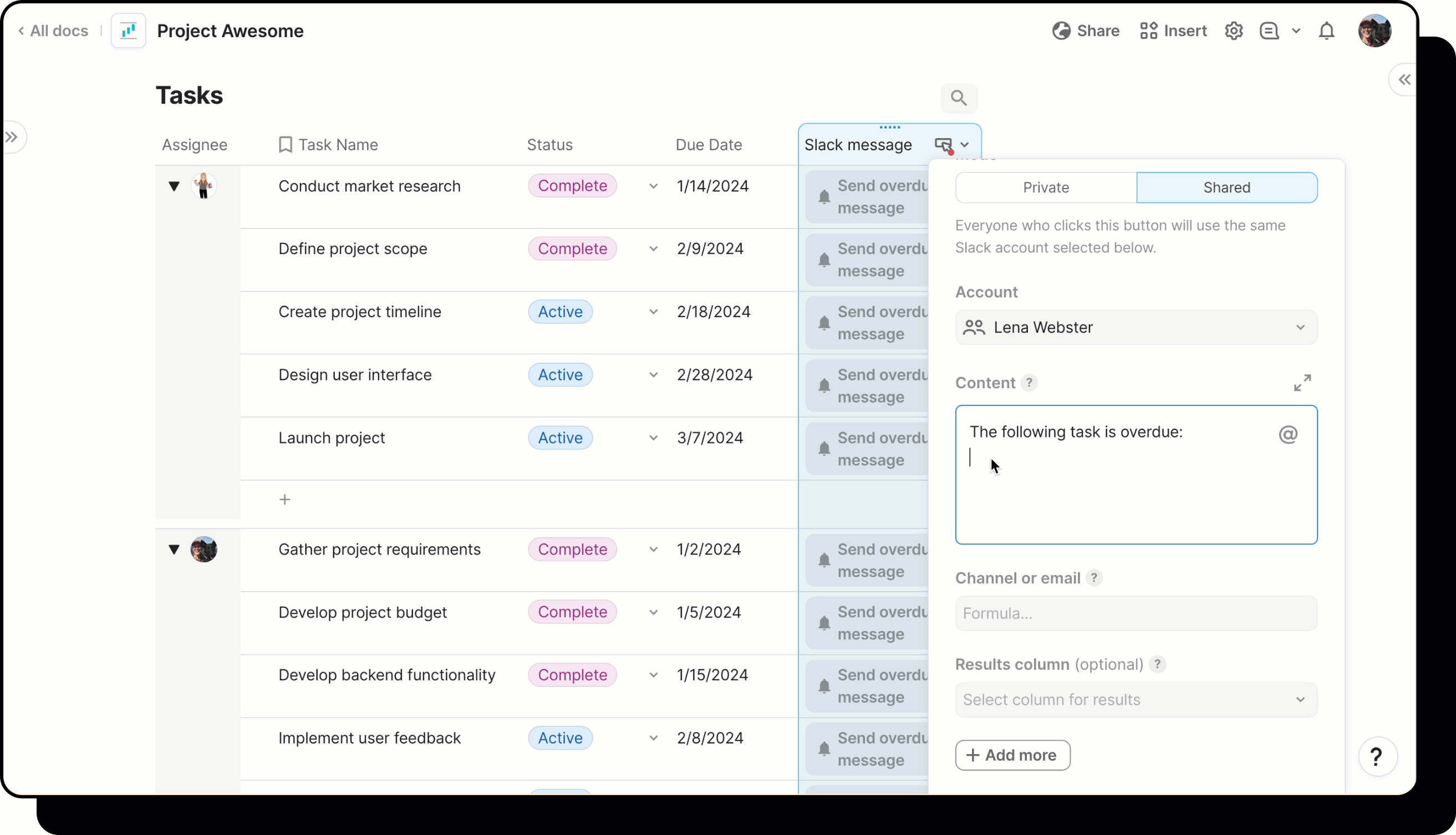

Let’s say you have a table of tasks, called Tasks. This table has columns for Task Name, Assignee, Due Date, and Status. You want to be able to send Slack messages from this table, so you add a button column (called Slack message). Following the steps in the section above, you make set this button to send Slack messages when clicked.
Specifically, you want to use this Slack button to notify assignees whenever their task is past due and incomplete. You want the message to include the name of the task. Since there are different tasks and different assignees, the content of the message and the recipient of the message will change per row. You can use some simple thisRow formulas in the Content field and Channel or email field of your Slack button settings to accomplish this.
  • In the Content field of the button settings, type = to open the formula builder. Then type thisRow.TaskName. Outside of the formula editor, you can add any other static text you’d like (ex: The following task is overdue: ).
  • In the Channel or email field of the button settings, type = to open the formula builder. Then type thisRow.TaskName.email. Since the assignee is a People column (which contains a few data points), you need to include the .email to extract just the email address of the assignee.
Here’s how that will look in practice:
As you can see in the example above, when you expand the Content field, you can then see previews of how the message will look for each row in the table.
That’s it! Now when you click that Slack button, a message will be sent to the correct assignee containing the relevant task name.

Yes you can! Within the settings of your Slack message button, click on Add more, then select Thread timestamp. In the Thread timestamp field, add the timestamp of the thread that you want to reply to.
