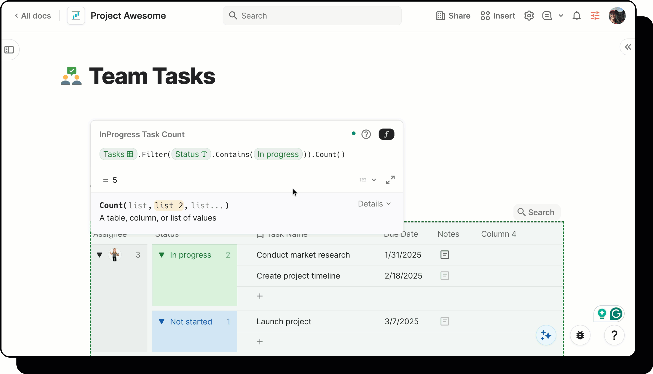

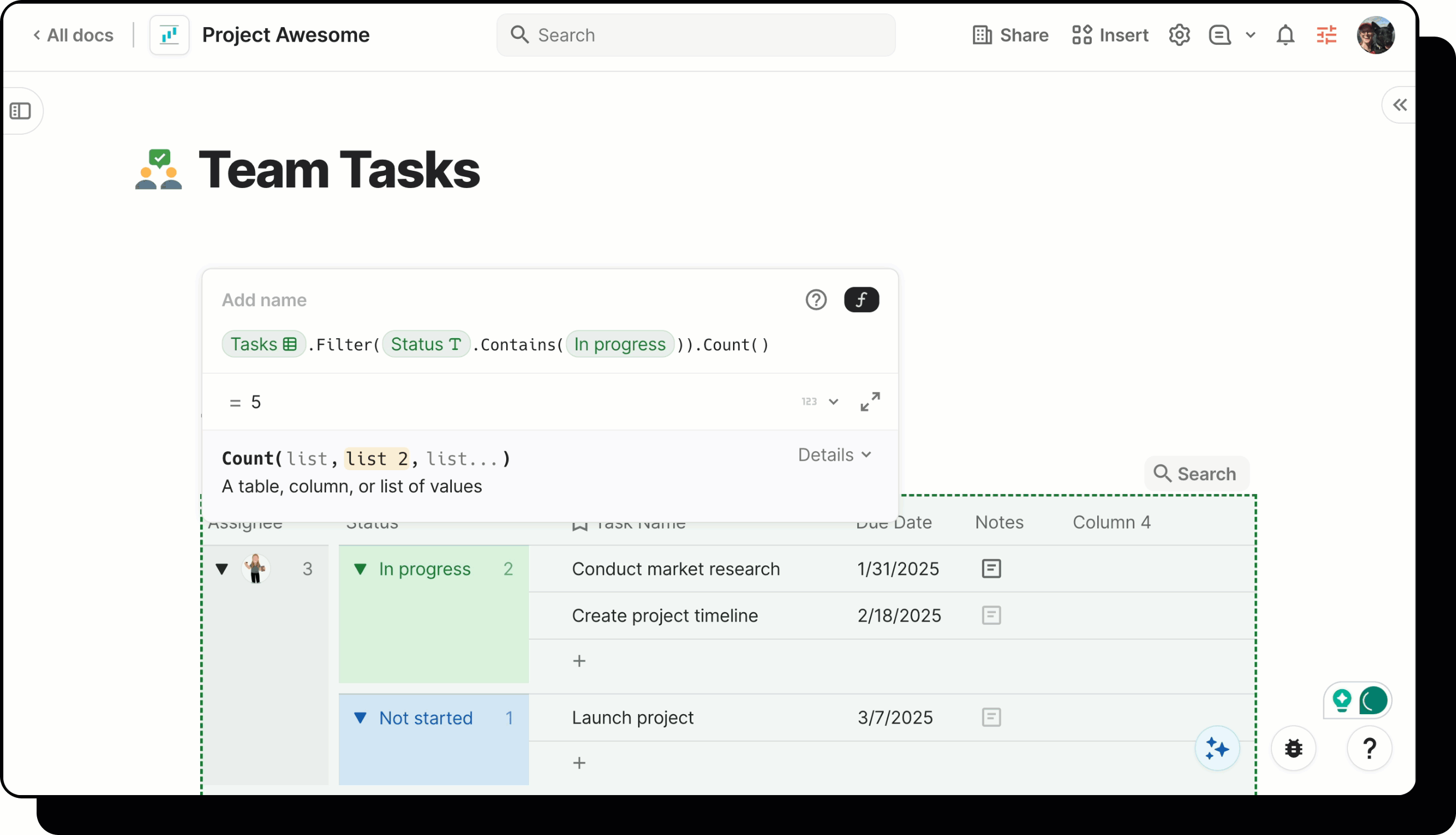

  1. On any blank line on the canvas (including within a canvas column), type = to open the formula builder
  2. Type the desired formula into the formula builder. Check out Basics of Superhuman Docs formulas for more info on creating formulas.
  3. Click into the Add name section, and type the name. You’ll later use this name to reference this formula elsewhere.
