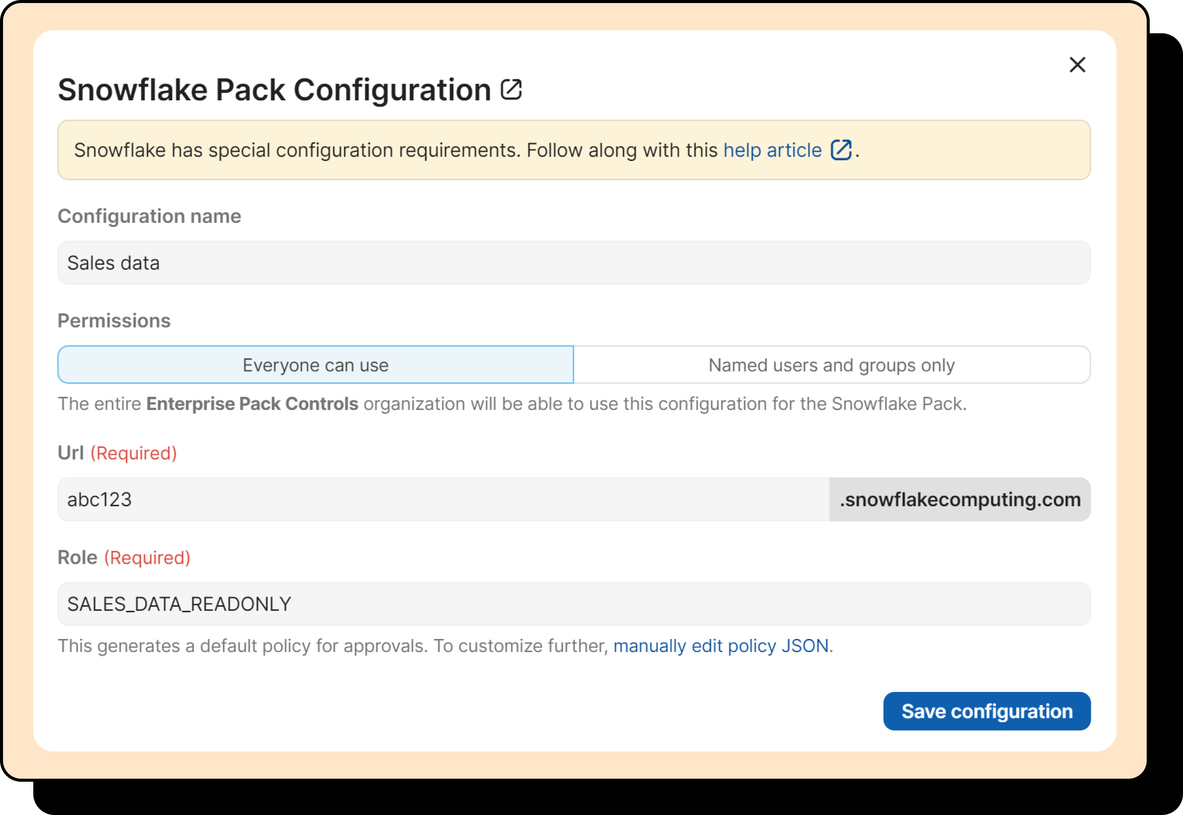

  1. From your Docs workspace, click on your account name in the lower-left corner, then select Admin settings from the list. Navigate to the Pack approvals page.
  2. Find the Snowflake Pack, expand it, and click the Add new configuration button.
  3. In the resulting dialog enter the following information:
    • Configuration name: A descriptive name for the configuration. It may be shown to the user when they are installing the Pack.
    • Permissions: Decide if the configuration can be used by everyone or only specific people. If the latter, enter the names of the users and groups that should have accces.
    • URL: The account identifier you retrieved earlier, to form the instance URL.
    • Role: The Snowflake role to connect with, as determined in the previous section.
  4. Click the Save configuration button to continue.

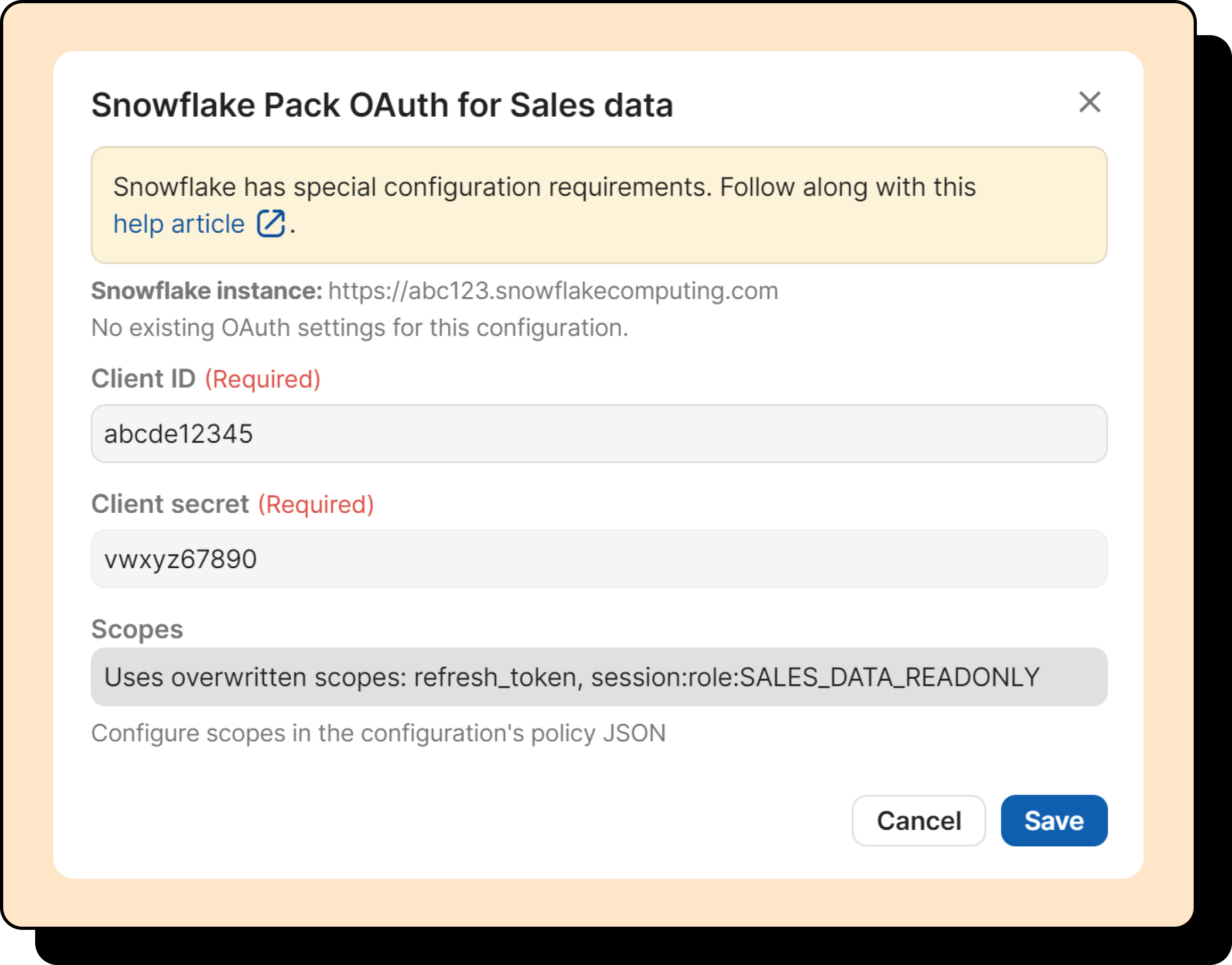

  6. In the resulting dialog enter the following information:
    • Client ID: Use the OAUTH_CLIENT_ID output from the Snowflake OAuth security integration.
    • Client secret: Use the OAUTH_CLIENT_SECRET output from the Snowflake OAuth security integration (you can ignore OAUTH_CLIENT_SECRET_2).
  7. Press the Save button.

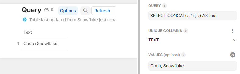

  6. At this point you can add a new Query table. Just type /query in the canvas of your doc, and select the Query table from the options.
  7. In the Query field in the right-hand panel, type in your Snowflake query. Select the columns used to uniquify the request. Then run the query, and see the results in Superhuman Docs.

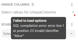

The UNIQUE COLUMNS parameter shows “No matches found” and a red error dot. How do I fix this?
This means there is an error in your query that prevents the Pack from determining the set of columns in the result.
Hover over the dropdown list to see the error message from Snowflake, and use that information to fix your query.
Once you’ve adjust your query, click into the UNIQUE COLUMNS dropdown list again. It may take a few seconds for the list of columns to appear, or for the error message to refresh.

Why do I get the a “SQL compilation error” when trying to use the SET command?
Unfortunately the Pack doesn’t support setting session variables via the SET command, as it’s not supported by the underlying integration technology.
An alternative is to use bind variables in your query, which you populate via the Values parameter.

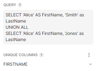

Why do rows appear to be missing in the sync table in Superhuman Docs?
This can happen if the UNIQUE COLUMNS parameter is inaccurate, and multiple rows have the same values for the selected combination of columns. Rows with the same values for those columns will “collide” and only one of them will appear in the table.
To resolve the issue the user should add additional columns to the list of unique columns. This may require that they alter the query to select more columns so that they can define a truly unique value per-row.
