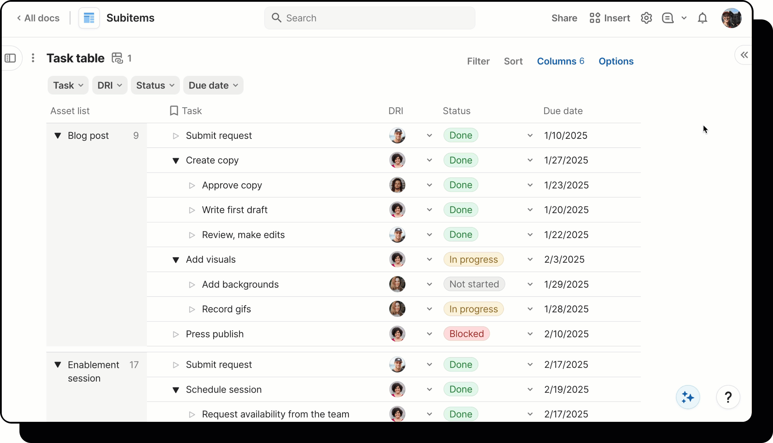

With subitems, you can nest rows within a table. This enables you to break your work into smaller sections (i.e. subtasks) and adds another level of organization to your table. For instance, you probably have a number of tasks to complete for a given project. But within each task, maybe there are sub-steps that need to be completed. Subitems allow you to better organize and visualize for such situations.

Once you’ve turned on subitems, and are showing them in a table or view, you may be wondering how to start adding subitems. There are a few different ways you can do this:

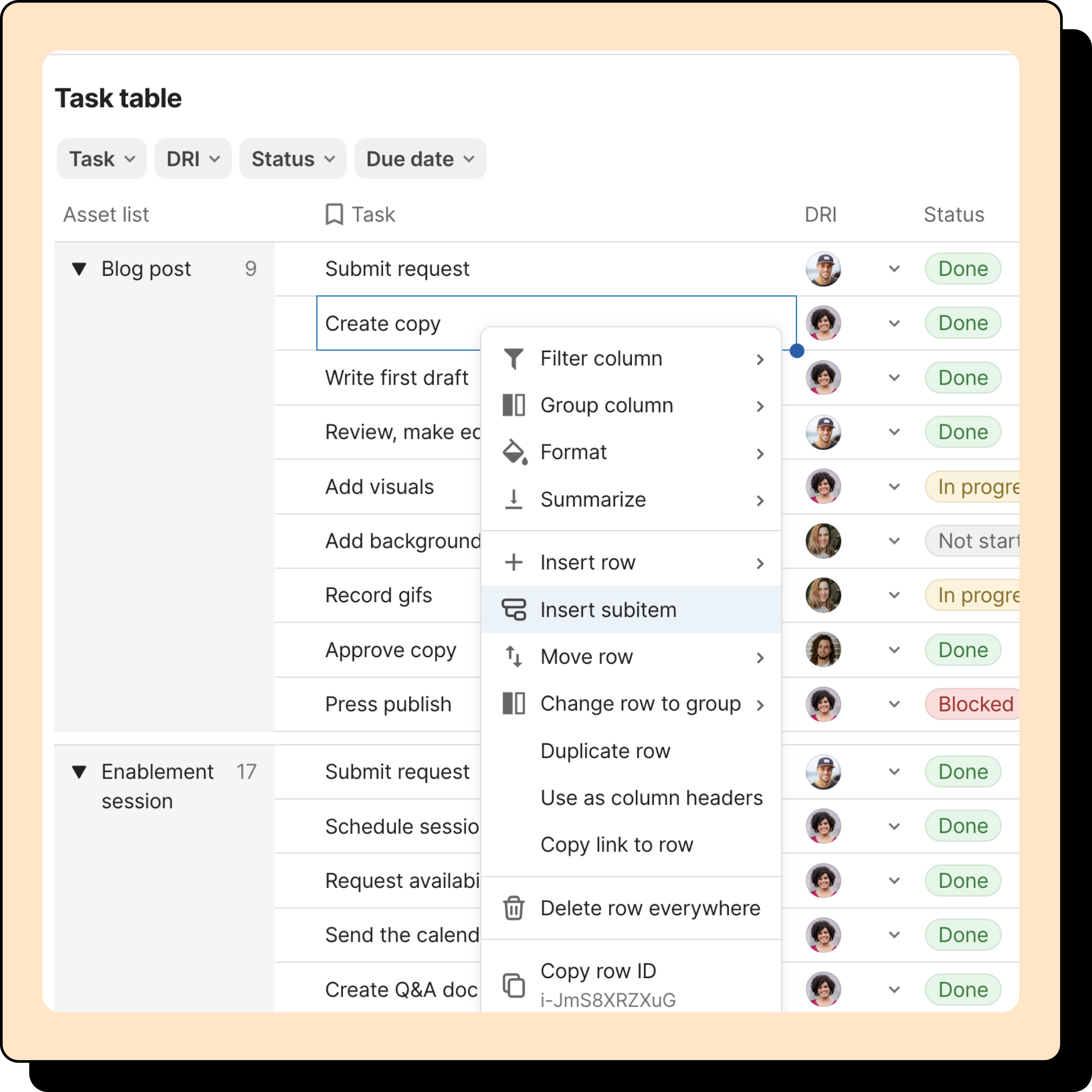

  1. Right-click on any cell or row in the table, and select Insert subitem from the menu. A subitem will be added below the selected row.

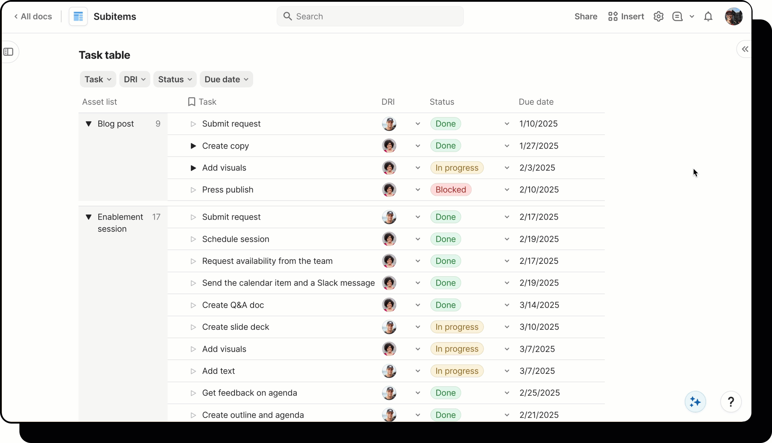

  2. Expand the row to which you want to add a subitem (by clicking on the caret of that row), then click the + New subitem button that appears.

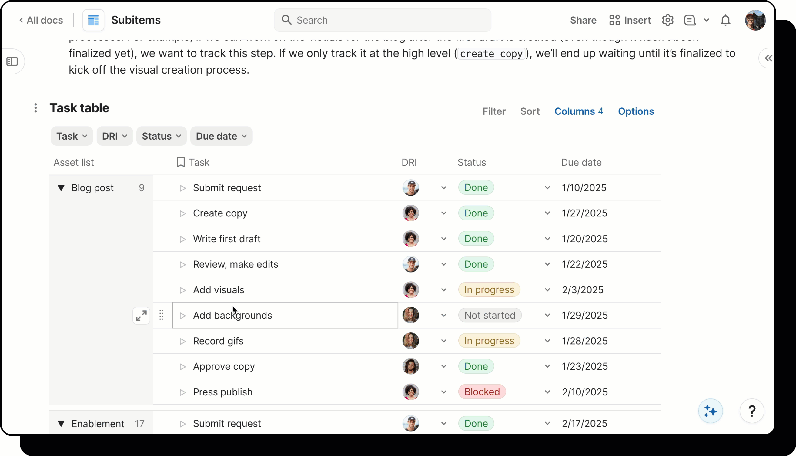

  3. Using the “handle” on the left side of a row, click and drag an existing row onto another row. This will add the dragged row as a subitem.
  4. Use the keyboard shortcut CMD + CTRL + SHIFT + =

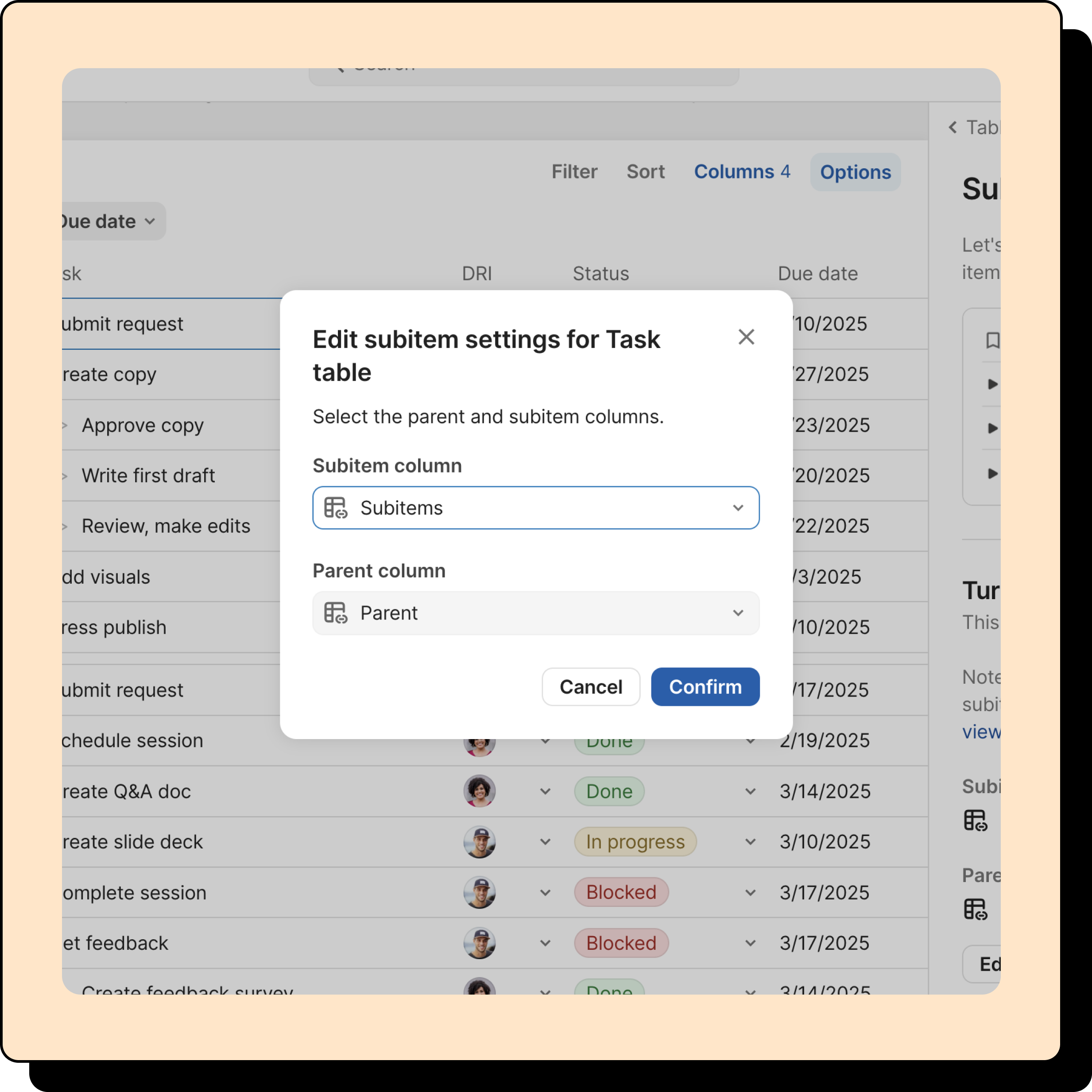

Configure subitem relation columns
You can adjust which relation columns are used for subitems at any time. To do so, hover over the table and click Options in the upper right, then select Table display from the menu. Find the Subitems section and click Settings. Then click Edit settings. Here, you can choose which column to select for the Subitem column and the Parent column.
Note that the Subitem column must be a multi-select relation column, and the Parent column must be a single-select relation column. Both relation columns must be self-relation columns, meaning they reference the current table.
Note: these columns must be the same for a table and all its views.

How can I change which columns are used as the subitem relation columns?
Subitems require two self-relation columns: a parent column and a subitem column. When you turn on subitems for a table, a parent column and a subitem column will be assigned. If you later want to change which columns are assigned, you can do so by following these steps:
  1. Hover over the table of view, and select Options in the upper right corner
  2. Select Table display from the menu
  3. In the subitems section, click on Settings
  4. Click the Edit settings button
  5. In the pop-up, you will see a Subitem column field and a Parent column field. You can click into each field to change the assigned column (including the option to create a new column).
    1. Note that only self-relations (relation columns that refer to the current table) can be utilized as the subitem column, and only linked relations (that also refer to the current table) can be utilized as the parent column.
  6. Once selected, be sure to click Confirm to save changes.

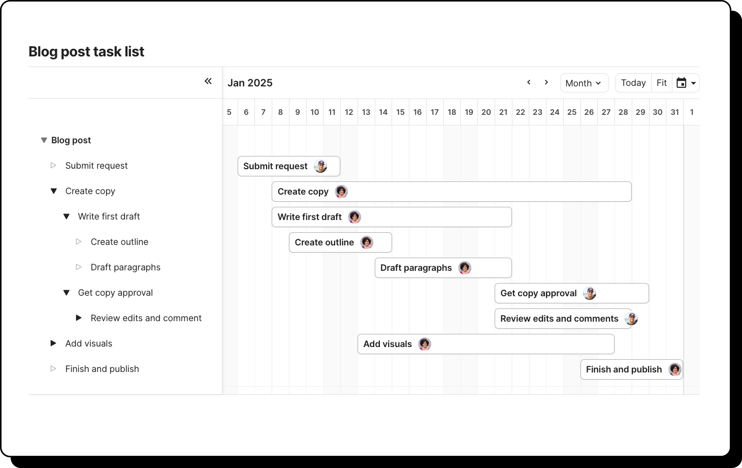

Currently, subitems are only supported for the table display type and for timeline views. They are not supported for detail views, card views, charts, etc.

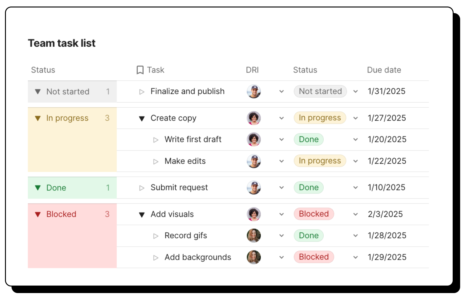

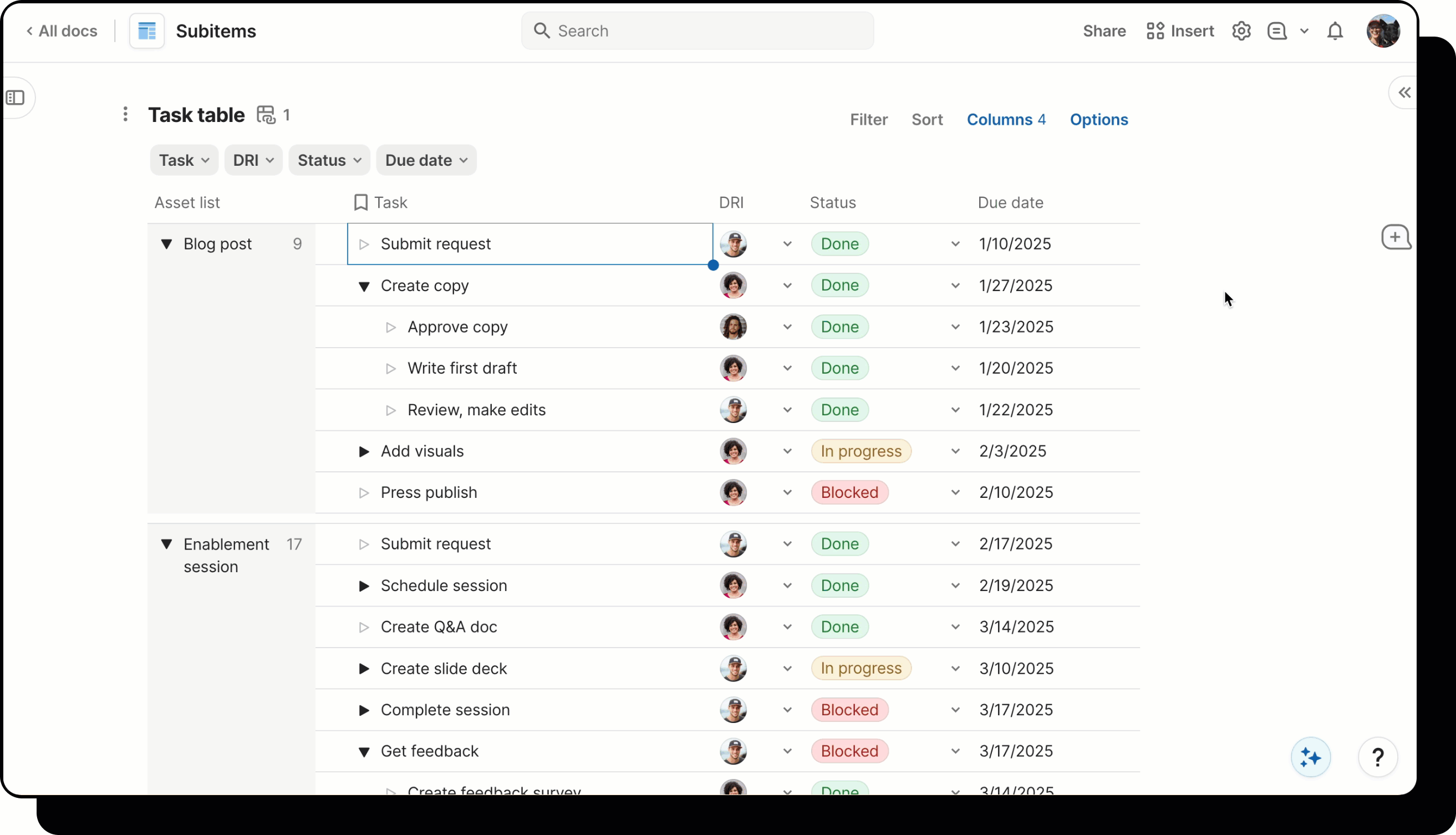

How do subitems work when your table data is grouped?
If your table or view has grouping, you might be wondering how this works with subitems. For instance, let’s say the table is grouped by the Status column, but the subitems within a single parent row all have different values in the Status column.
Subitems will be grouped based on the value of the highest parent row. So if the parent row has a status of In progress, all subitems will also appear in the In progress group, despite their individual status.
By default, new subitems will inherit the group value of their (direct) parent item.

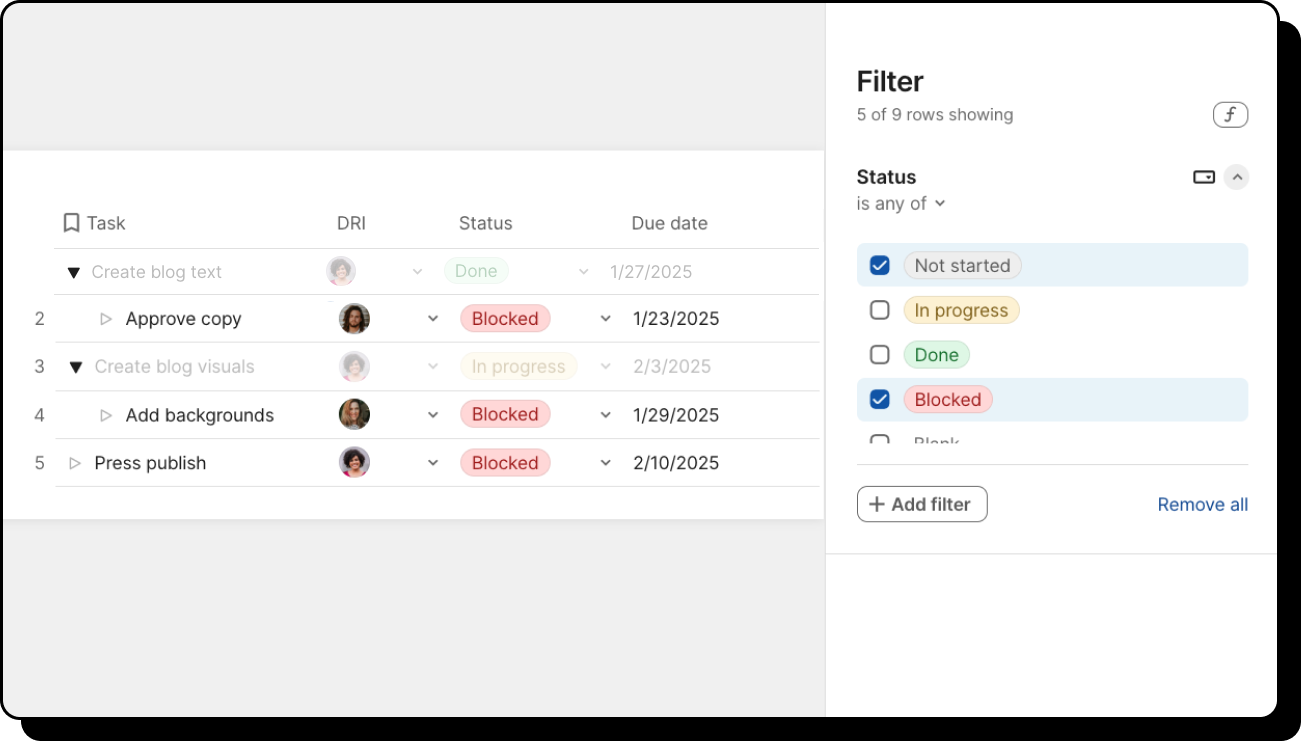

How do subitems and filters work?
If a subitem includes the value selected in the filter and has no subitems, it will filter out like normal.
If a subitem includes the value selected in the filter but the parent item does not, the table will display both the subitem and the parent item. The parent item will be slightly faded (aka a “ghost row”) to reflect that it does not contain the value selected in the filter.
