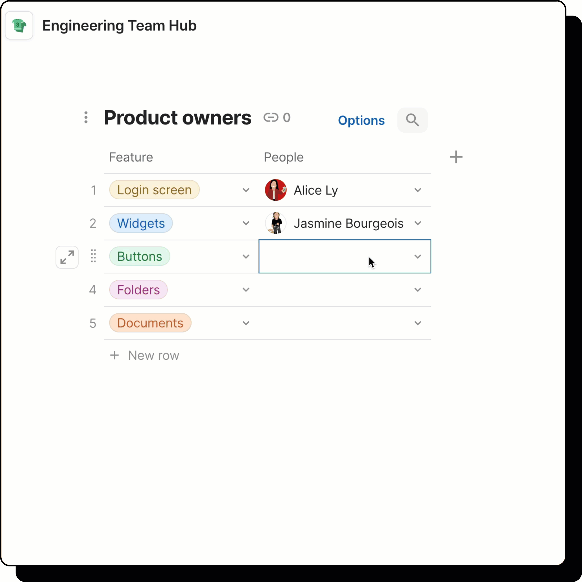

To create a people column, start by adding a new column to your table. In the upper right corner of your table, click on the + add column button. Then, set the column type to People.
If you already have a column that you want to convert to a People column, just right-click on the column header, select Change column type, then choose the People column type.
Now you can simply click into the cells of that column, and a dropdown of selectable people will appear.

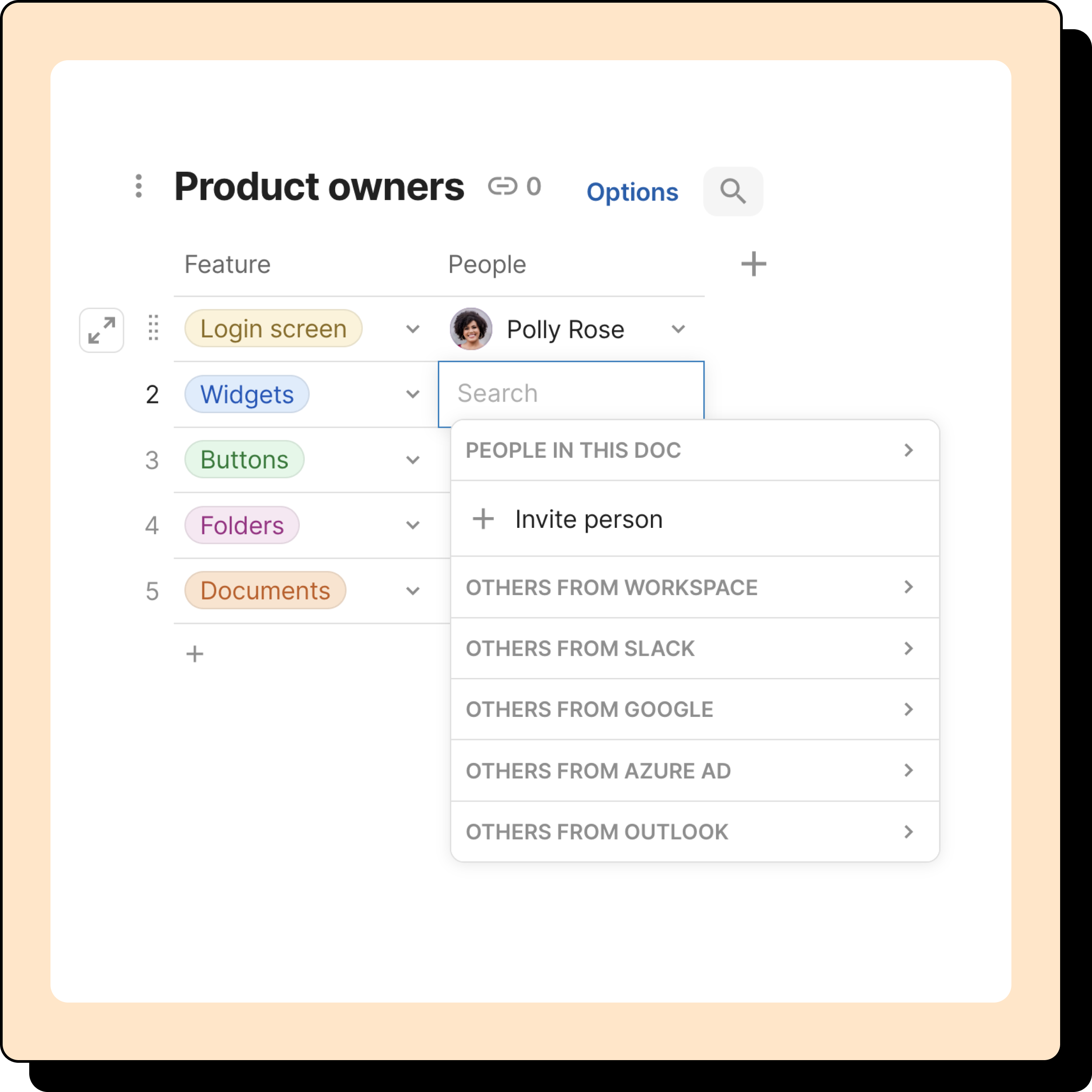

As you look at the people column dropdown, you may decide you want to add additional options to the list. To do so, click into a cell of your people column to open the dropdown. At the bottom, you’ll see an +Invite person option and a more results option.
  • Use the +Invite person option to invite someone new to the doc. The sharing dialogue will open to facilitate this (click here for a refresher on sharing docs). Once you’ve invited them, they will appear in the people list.
  • Use the Others from... sections to browse through people in your Superhuman Docs workspace and in other apps you may have connected, such as Slack, Google, or Outlook*. If you add someone from these sections, they will be added to your people dropdown, but they won’t necessarily be invited to the doc (nor will they be notified) unless you also share the doc with them.

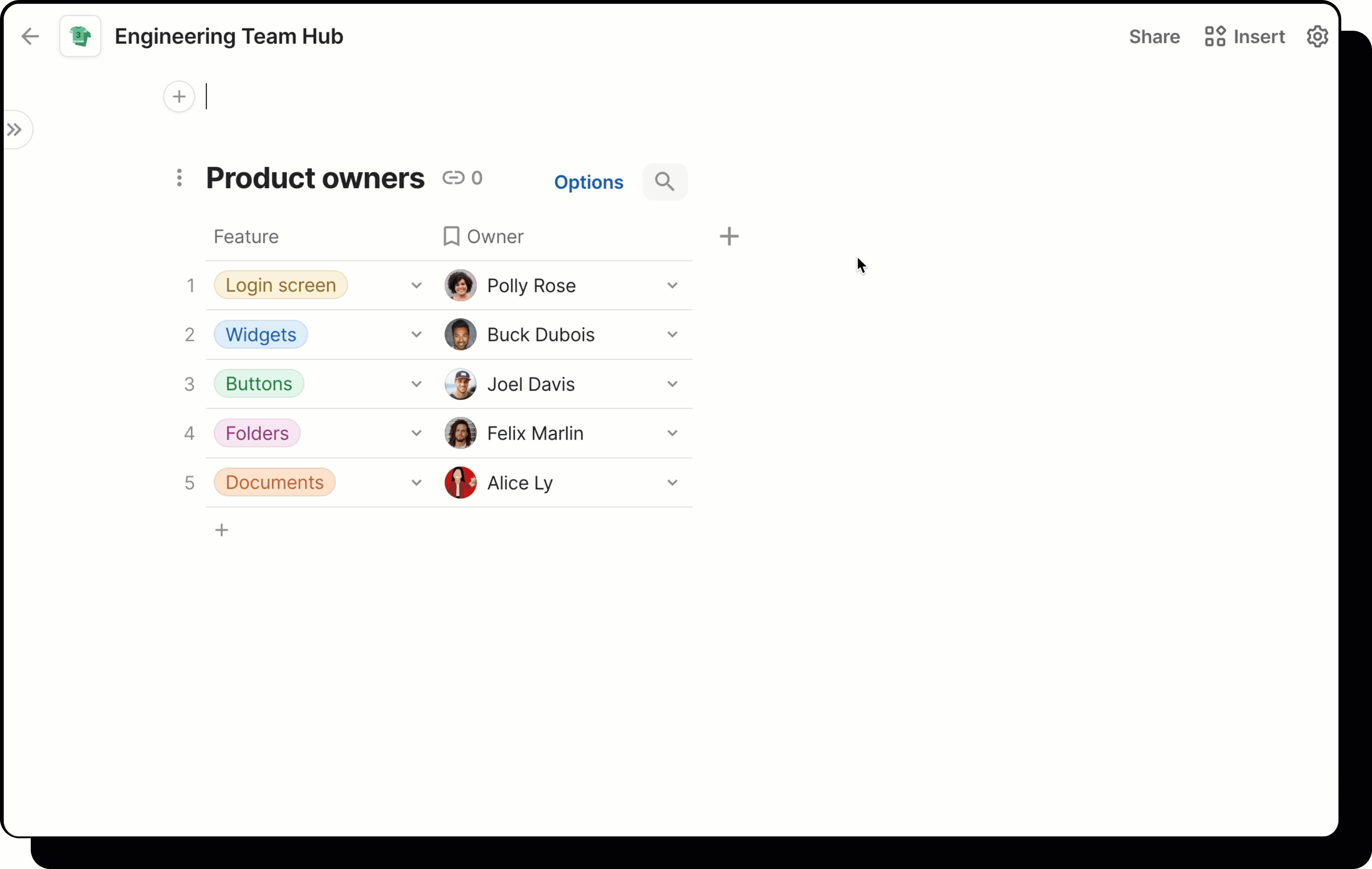

The people column format has a few options to customize your column. To open and adjust these options, right-click on the column header and select column options. You’ll see the following column settings:
  • Allow multiple selections: Toggle on if you wish to select more than one person per cell.
  • Notify when added: When this is toggled on, people will receive a notification any time you add them to the table. This is toggled off by default.
  • Subscribe to comments: This setting ensures that people will be notified for any comments made on a row that they’ve been added to. This setting is toggled on by default.
  • Display avatar only: Toggle this on to hide the person’s name and show only their avatar in the table. This is great for keeping your table clean and reducing visual noise.
  • Default value: Choose whether newly created rows should have a default value for this column. For instance, choose the Created by option if you want the column to automatically populate with the person who creates the row.
