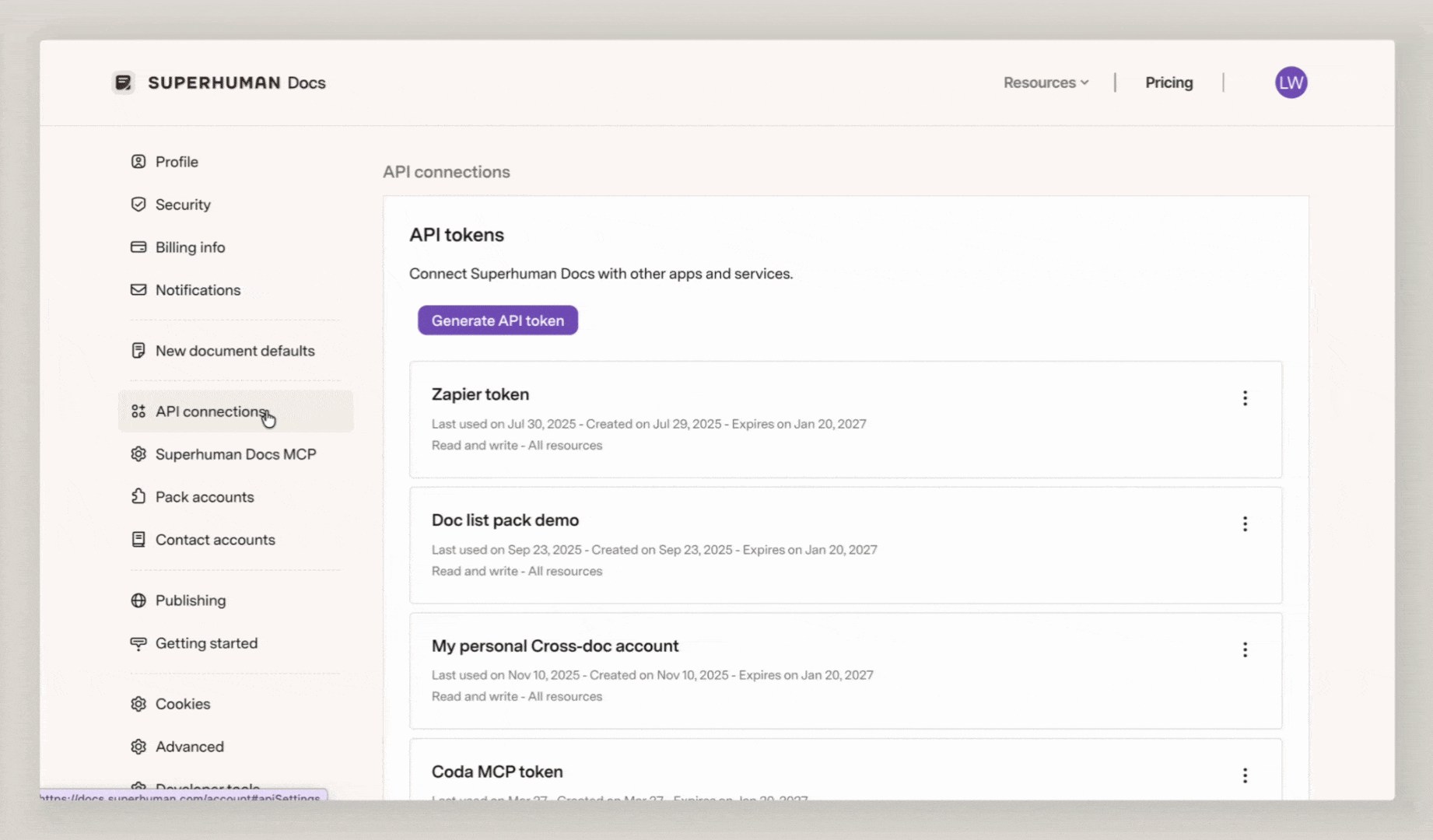

  10. If you haven't yet connected your Docs account to Zapier, click + Connect a new account.
    1. This will open a pop-up prompting you to create an API key from Superhuman Docs. To do so, go to docs.superhuman.com/account.
    2. Scroll to the API settings section, and click Generate API token.
    3. Give the API token a memorable name, then click Generate API token to confirm. Note: Do not add any restrictions to the token.
    4. You should now see the new token in the list of API tokens. Click the Copy token button to copy it to your clipboard.
    5. Return to the pop-up window from Zapier, and paste the copied token into the field. Then click Yes, Continue to Superhuman Docs.
  11. Now that your Docs account is selected, click Continue to progress with the setup.

Why do I get a 401 error when trying to connect Superhuman Docs to Zapier?
Zapier 401 error messages are usually displayed when your account credentials are incorrect, expired, or revoked.
To resolve this, we recommend you go to docs.superhuman.com/account, find the API Settings section, and check that there aren’t any restrictions on the API token for Zapier. Zapier can’t connect to Superhuman Docs with anything less than a full-access API token.
