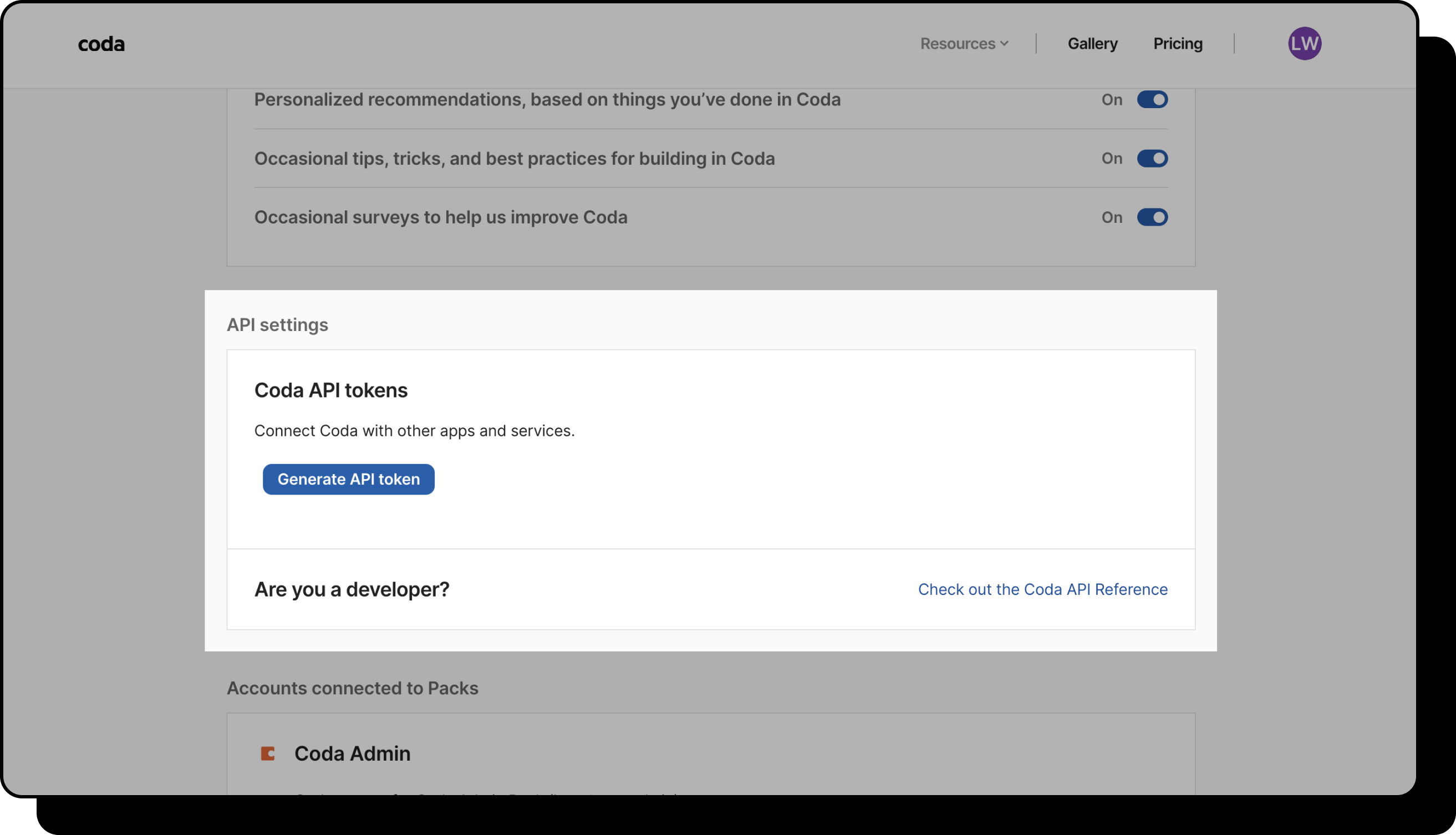

    1. This will open a pop-up prompting you to create an API key from Coda. To do so, go to coda.io/account.
    2. Scroll to the API settings section, and click Generate API token.
    3. Give the API token a memorable name, then click Generate API token to confirm. Note: Do not add any restrictions to the token.
    4. You should now see the new token in the list of Coda API tokens. Click the Copy token button to copy it to your clipboard.
    5. Return to the pop-up window from Zapier, and paste the copied token into the field. Then click Yes, Continue to Coda.

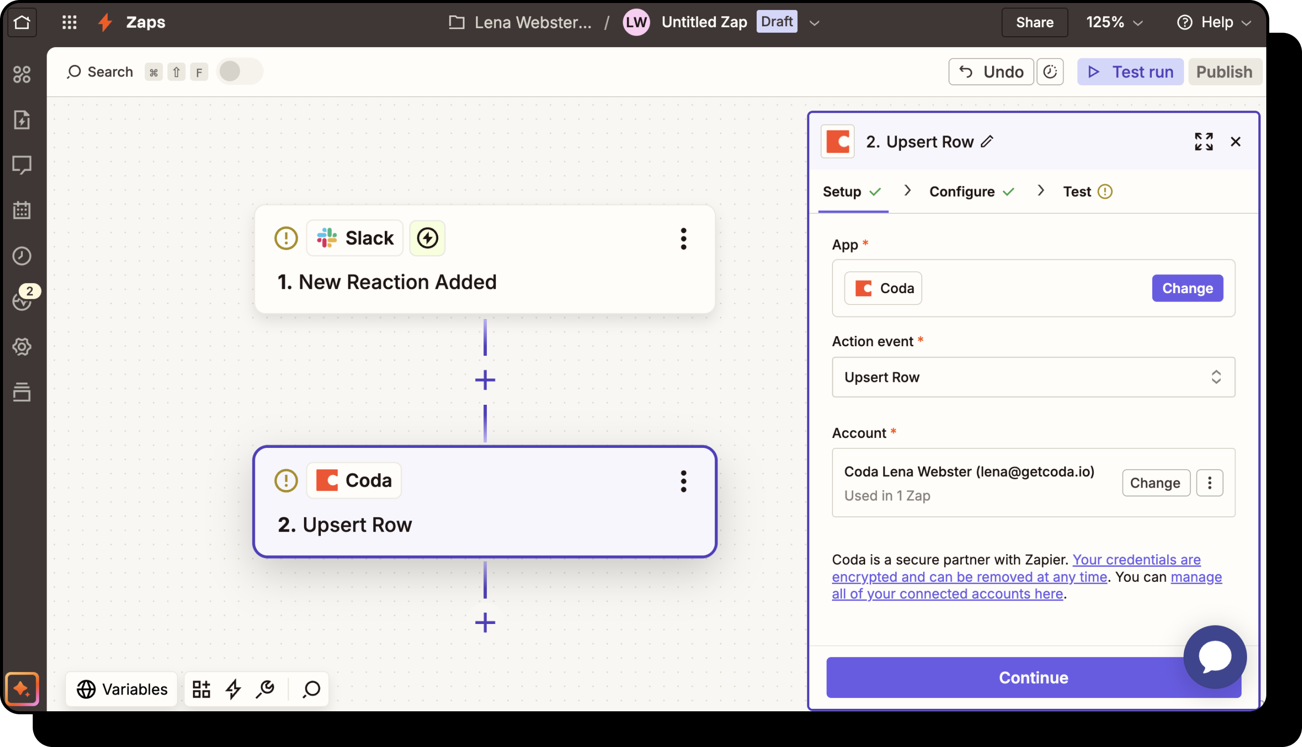

  6. Search for and select Coda.
  7. You'll then be asked to choose your action event. Choose Upsert Row.
  8. Next, in the Account field, select your Coda account. Then click Continue.
    1. If you've already connected your Coda account, it should appear in the list here. If you haven't yet connected your account, check out step #10 in the previous section for instructions.

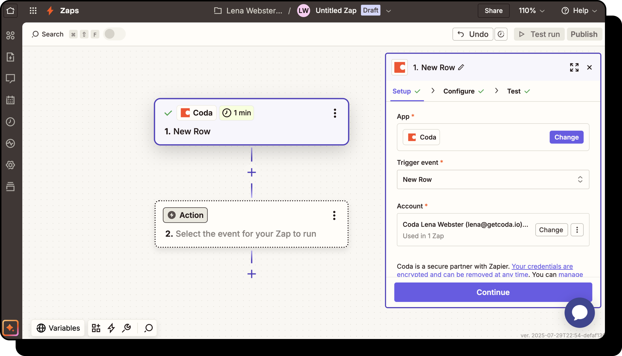

  3. Use the search bar to find and select Coda.
  4. Click into the Trigger event field, and choose whether you want this zap to be triggered by a New Row or Updated Row.
  5. In the Account field, select your Coda account, then click Continue.
  6. Use the drop-downs to select the Coda doc and table where you want the trigger to come from. Then hit Continue.
  7. Follow the prompts to test the trigger, then continue building out the Action step of your Zap as desired.
