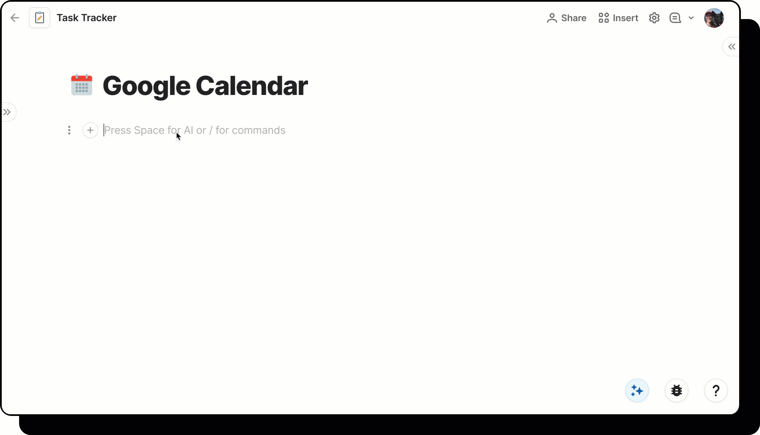

From within a doc
You can install a Pack directly from within the doc you are working in by using the Insert panel.
  1. Click the Insert & explore button in the upper right of the doc.
  2. In the side panel click on the Packs menu item.
  3. Browse or search for the Pack you want to install.
  4. Click on the Pack you want to install to open it’s listing page.
  5. Click the Add to doc button to begin the installation.
    For Paid packs you haven’t yet purchased use the Try it button instead to begin a trial.
You can now start using any building blocks from the Pack - see more about getting started here. Note that if the Pack requires authentication, you will be prompted to connect an account once you start using the Pack.
Gif showing user adding Google Calendar pack to their doc.
To start installing a Pack even more quickly use the slash menu, typing a forward slash and then the name of the Pack you want to install. For example, /slack.

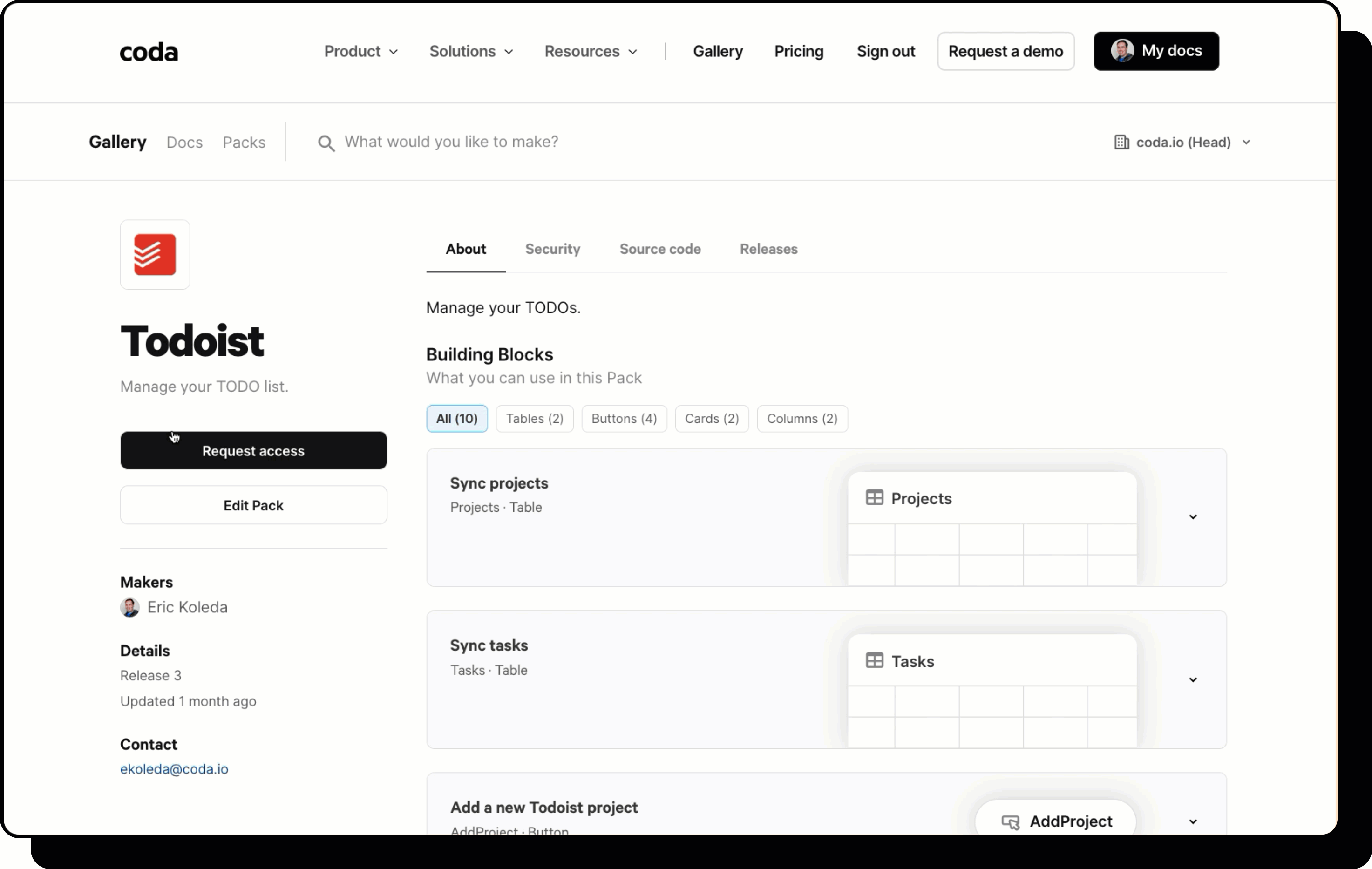

Request approval to install
If your organization’s admin has enabled Pack approvals you won’t be able to install a Pack until they first approve it. To request approval to install a Pack:
  • Click the Request access button in the Pack’s listing page.
  • In the dialog, enter a message to accompany your request.
    Include any relevant details that would help the admin make a decision.
  • Click the Send request to send the request.
    You can close the dialog.
Your organization’s admin will receive a notification, including who made the request. They may follow up with you for more information. When they make a decision, either to approve or deny, you will receive a notification with the decision. If approved, you will now be able to install the Pack as described in the previous section.

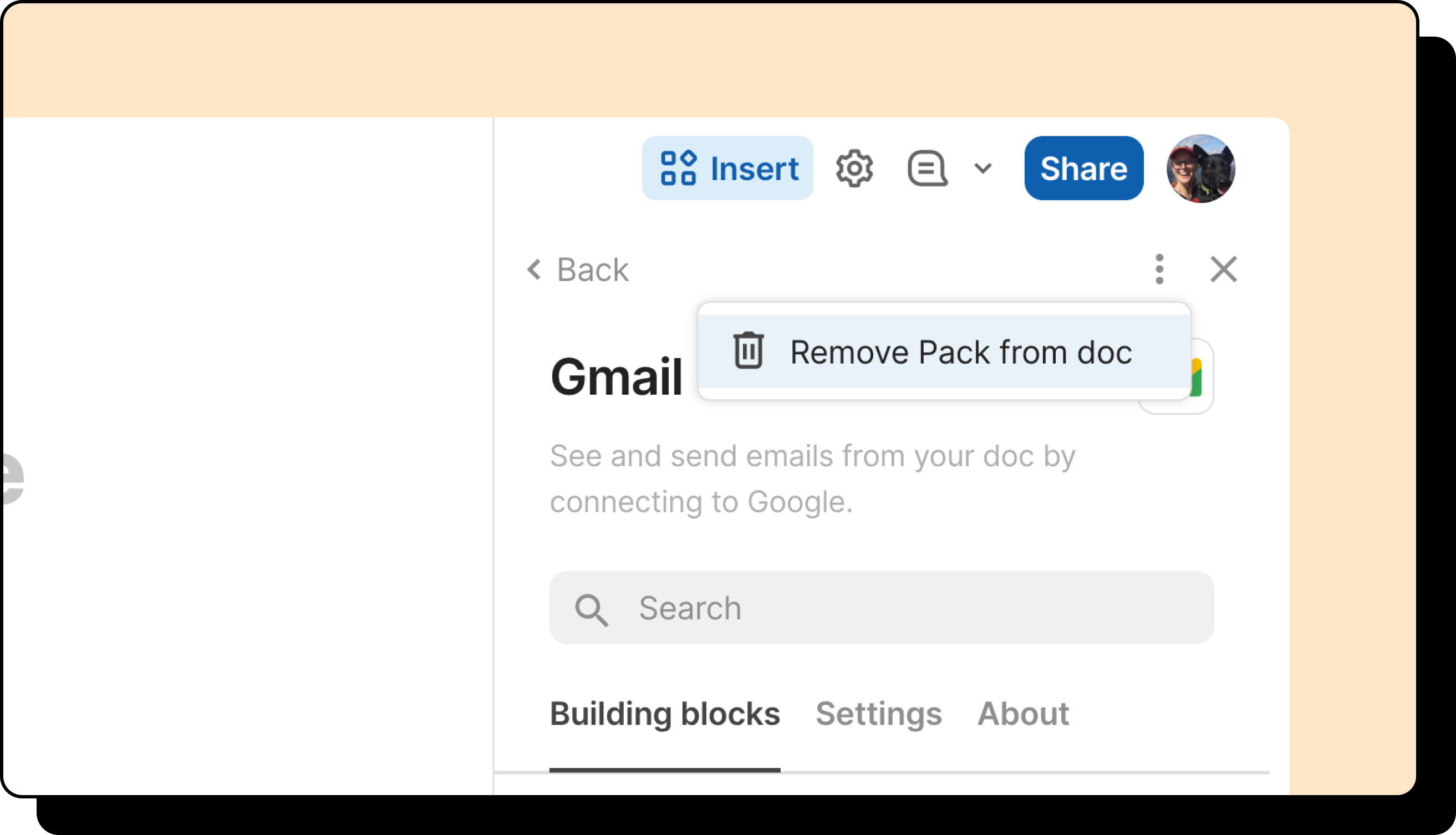

Remove a Pack
If you no longer wish to use a Pack you can remove it from your doc. Any of the Pack’s building blocks (formulas, actions, etc.) that are used within the doc will break once the Pack is removed. If you removed a Pack accidentally you can reinstall it to fix the errors.
To remove a Pack:
  3. Click on the Pack you want to remove.
  4. Click on the three-dots menu in the upper right of the Pack panel and then click on Remove Pack from doc.
  5. In the dialog click the button Remove this Pack.
