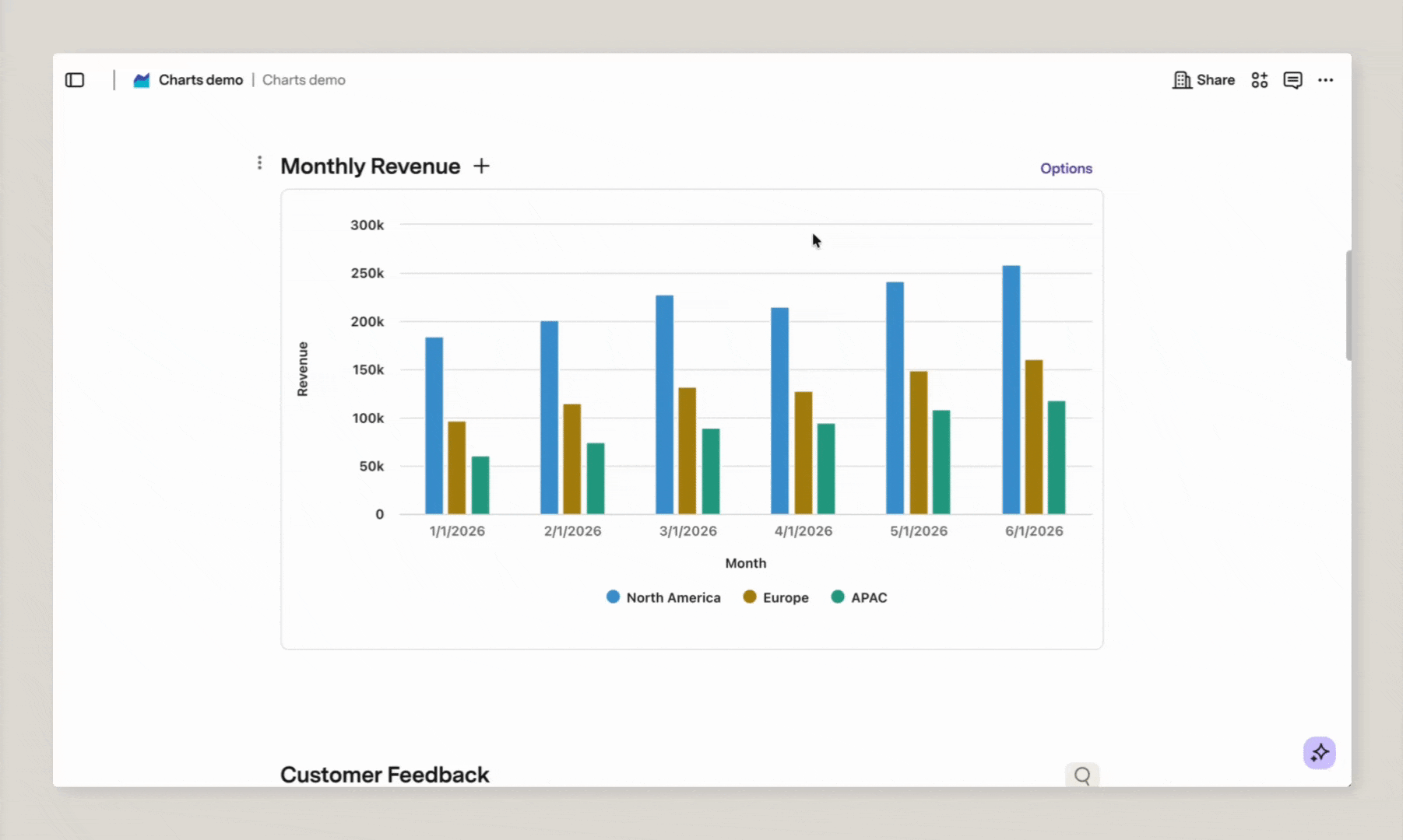

  • Bar charts: If you prefer, you can select your values to be stacked and can change the axis.

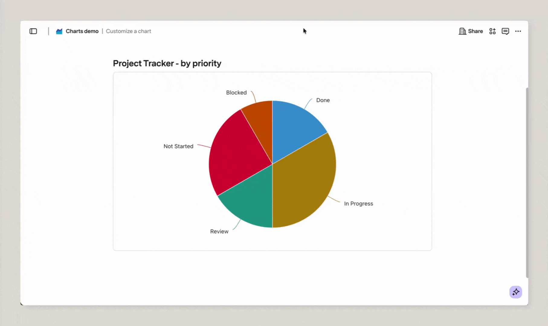

  • Pie charts: You'll select a category you want to use to create your pie slices.

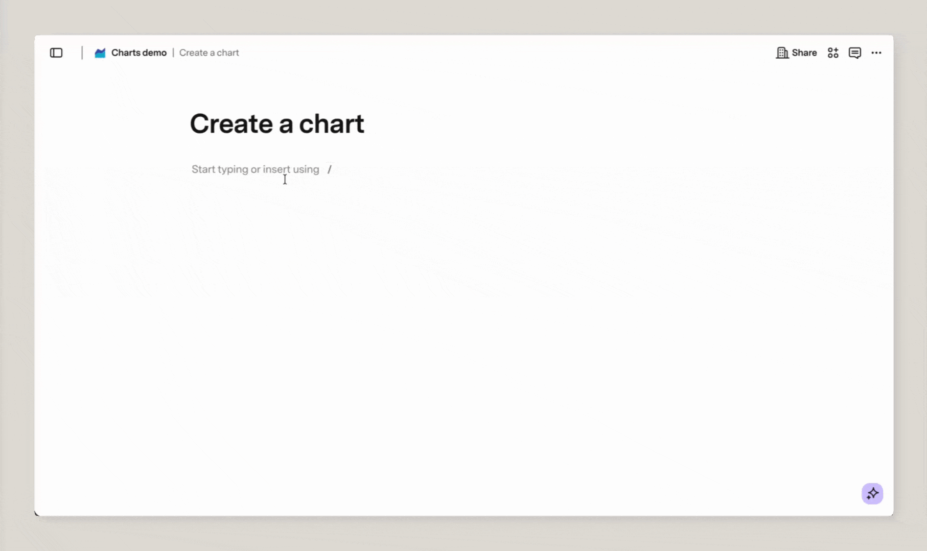

There are two ways to create charts in Docs: from the slash command, or from a table’s options menu. Let's start with the slash command.
  1. On any blank line in your doc, type /chart into the canvas
  2. Select the type of chart you would like to build
  3. From the right-hand panel, choose whether you want to Start blank, Import from CSV, or Connect existing data

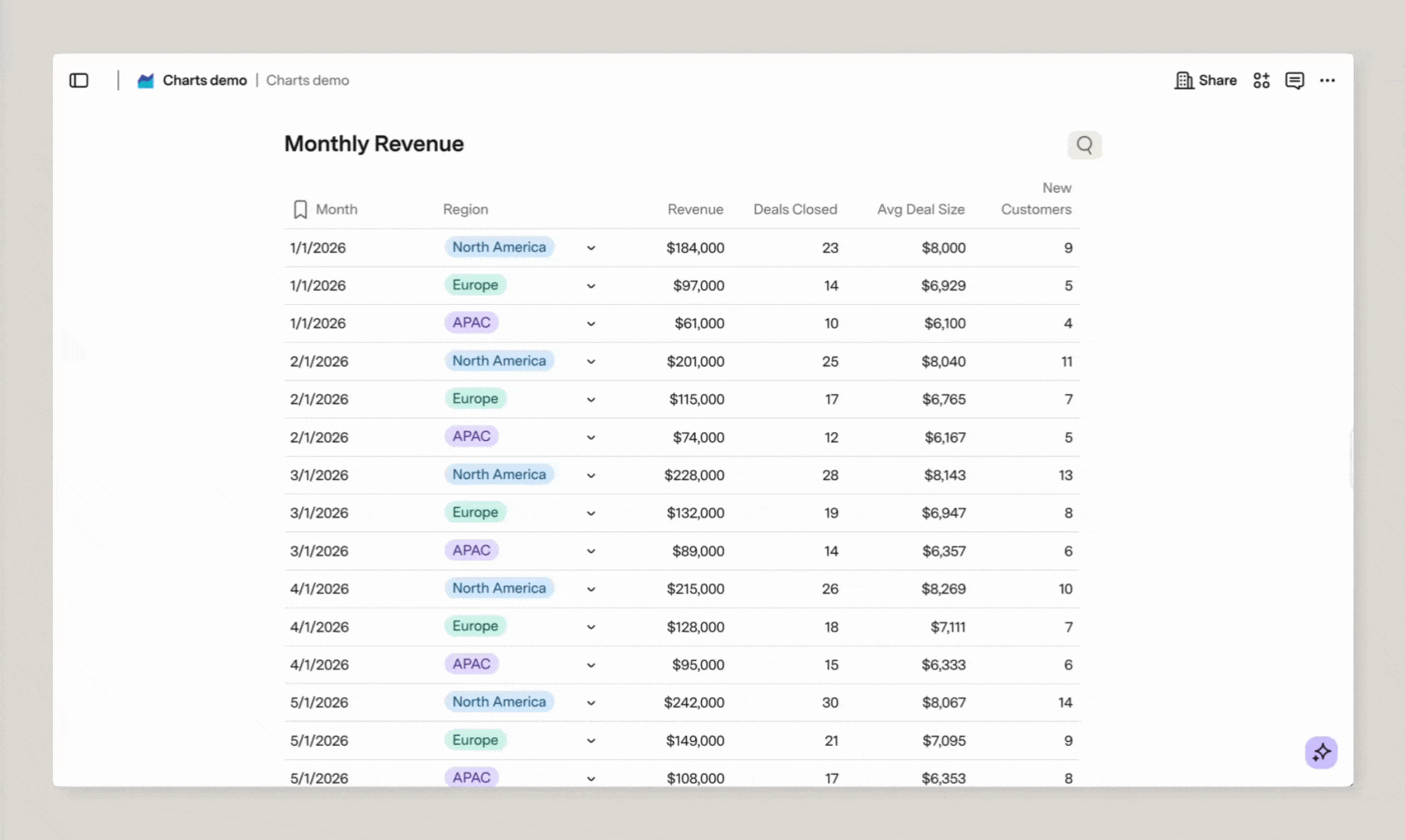

If you're already working on a table or view that you want to convert to a chart, you can do so via the table’s option menu:
  1. Hover over the table and select Options in the upper right corner, then select See all options from the menu
  2. At the top of the options menu, click on More then select Chart
    1. Note: If you want to create a timeline chart, choose Timeline from the options instead
  3. To change to a different chart type, click on Chart display. Then click into the Chart type field and choose an option from the dropdown.

Customize your chart
No matter the chart type you are working with, you'll have access to the chart customization settings when you open Chart setup menu. To access this, hover over the upper-right corner of your chart, click on Options, then select Chart setup from the menu.
Here you can adjust the following, depending on the chart type:
  1. Horizontal axis: Decide what value (column) from your table should be used as the horizontal axis.
  2. Values: Identify the information you want to explore in your chart, and decide how it should be analyzed or quantified (sum, average, median, and much more).
  3. Aggregate values: Toggle this on to combine values into a singe data point when multiple rows have the same content in column providing values for the horizontal axis.
  4. Orientation: Choose between vertical or horizontal setups.
  5. Segments: View data by type to compare and contrast. Additionally, you can choose the color for each segment.
  6. Vertical axis: Optionally set minimum or maximum values for your vertical axis. You can also choose between either linear or logarithmic scales for this axis.
  7. Stacking: You might want to see similar values in a stack - you'll set that up here. Choose between stacked and 100% stacked.
  8. X-axis and Y-axis titles: Decide whether you want the x-axis and y-axis titles displayed or hidden on the chart.
  9. Labels: Toggle this on to enable labels using values from the vertical axis.
Note that these settings may not be available on all chart types.

Can I change the colors used in a chart?
Yes! Simply hover over the upper right corner of your chart, click Options, and select Chart setup. Depending on your chart type and your settings, you’ll see some options to customize the colors used. For instance, if your bar chart utilized segments, you can choose the color for each segment. Or for your pie chart, you can choose the color for each value set.

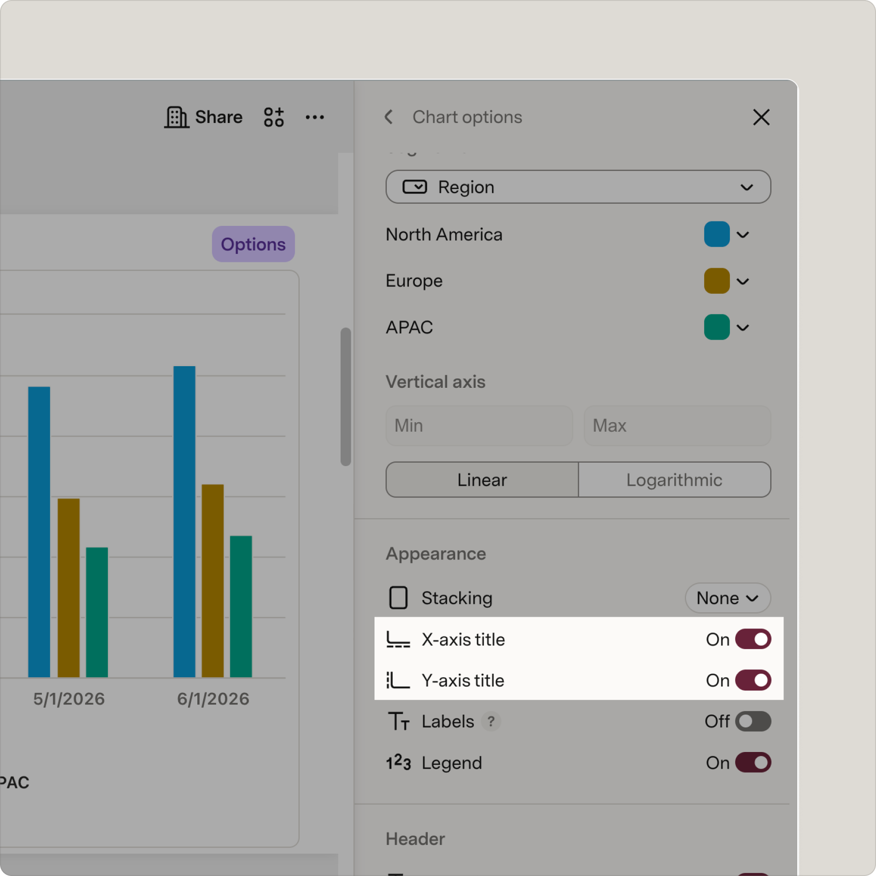

Can I display a chart without axis labels?
Yes. To hide axis labels, just hover over your chart, click Options in the upper right corner, and select Chart setup. Then search for the X-axis title and Y-axis title settings. Toggle these off to hide the axis titles from view.
