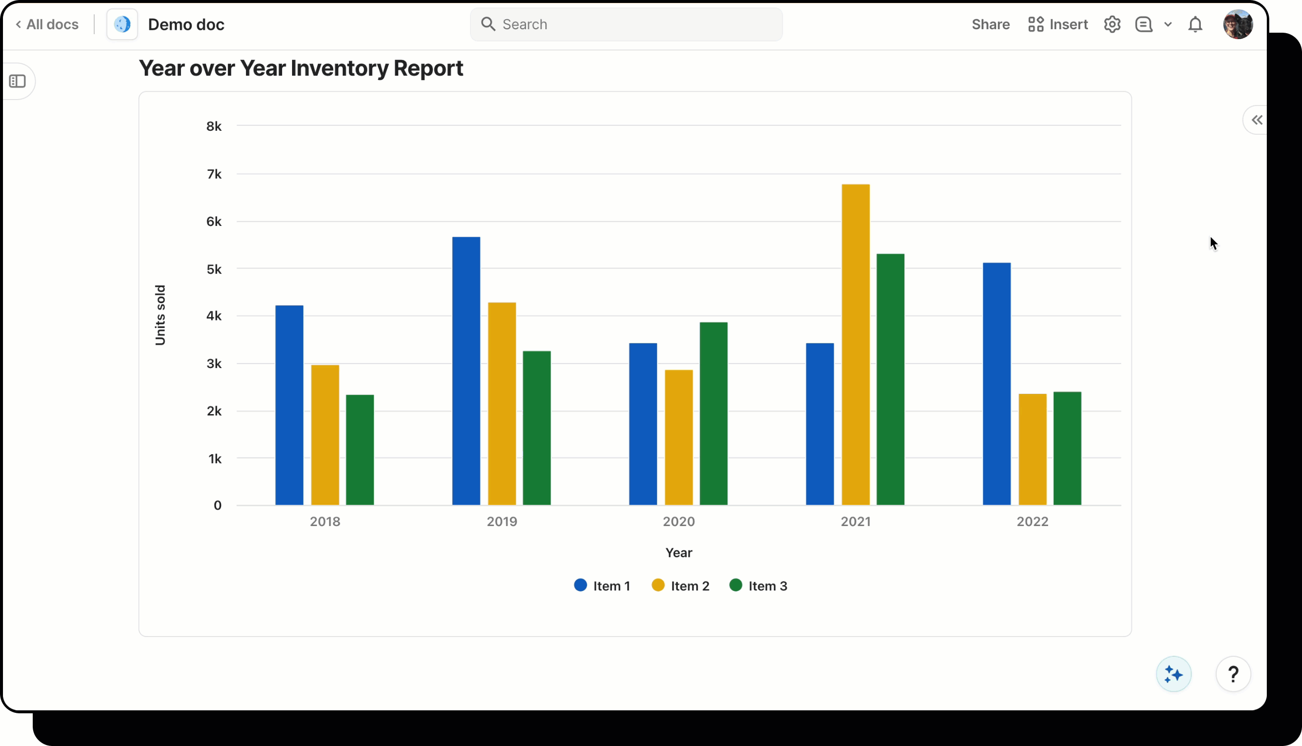

  • Bar charts: If you prefer, you can select your values to be stacked and can change the axis.

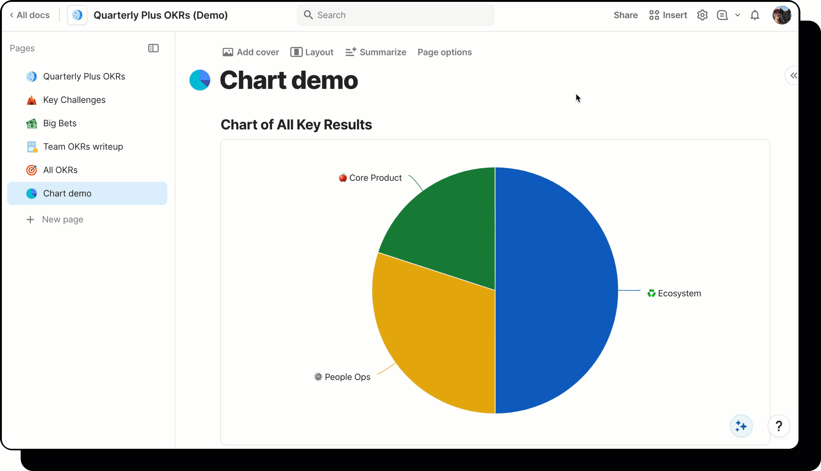

  • Pie charts: You'll select a category you want to use to create your pie slices.

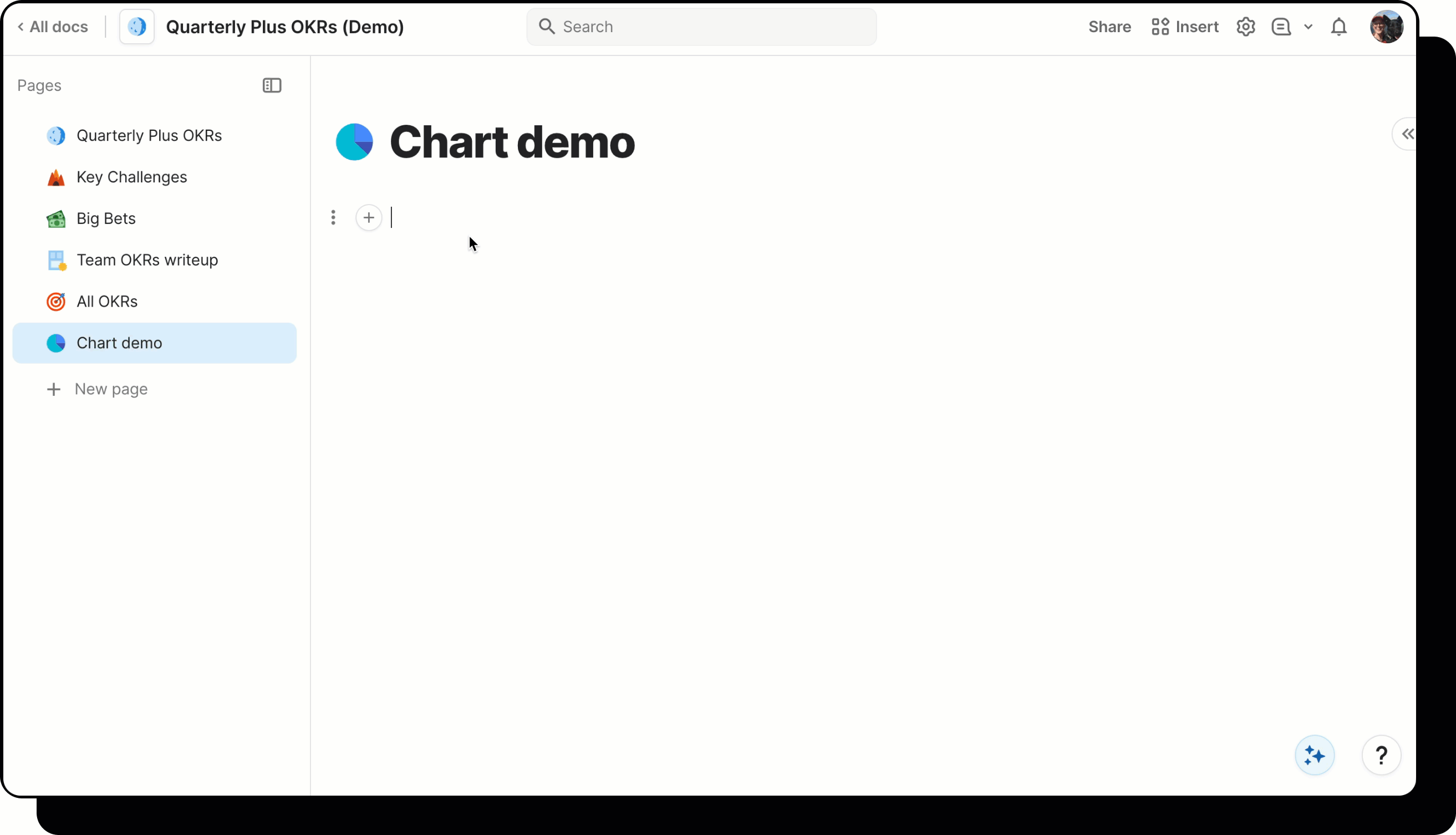

There are two ways to create charts in Coda: from the slash command, or from a table’s options menu. Let's start with the slash command.
  1. On any blank line in your doc, type /chart into the canvas
  2. Select the type of chart you would like to build
  3. Select the table or view you want Coda to use to build the chart

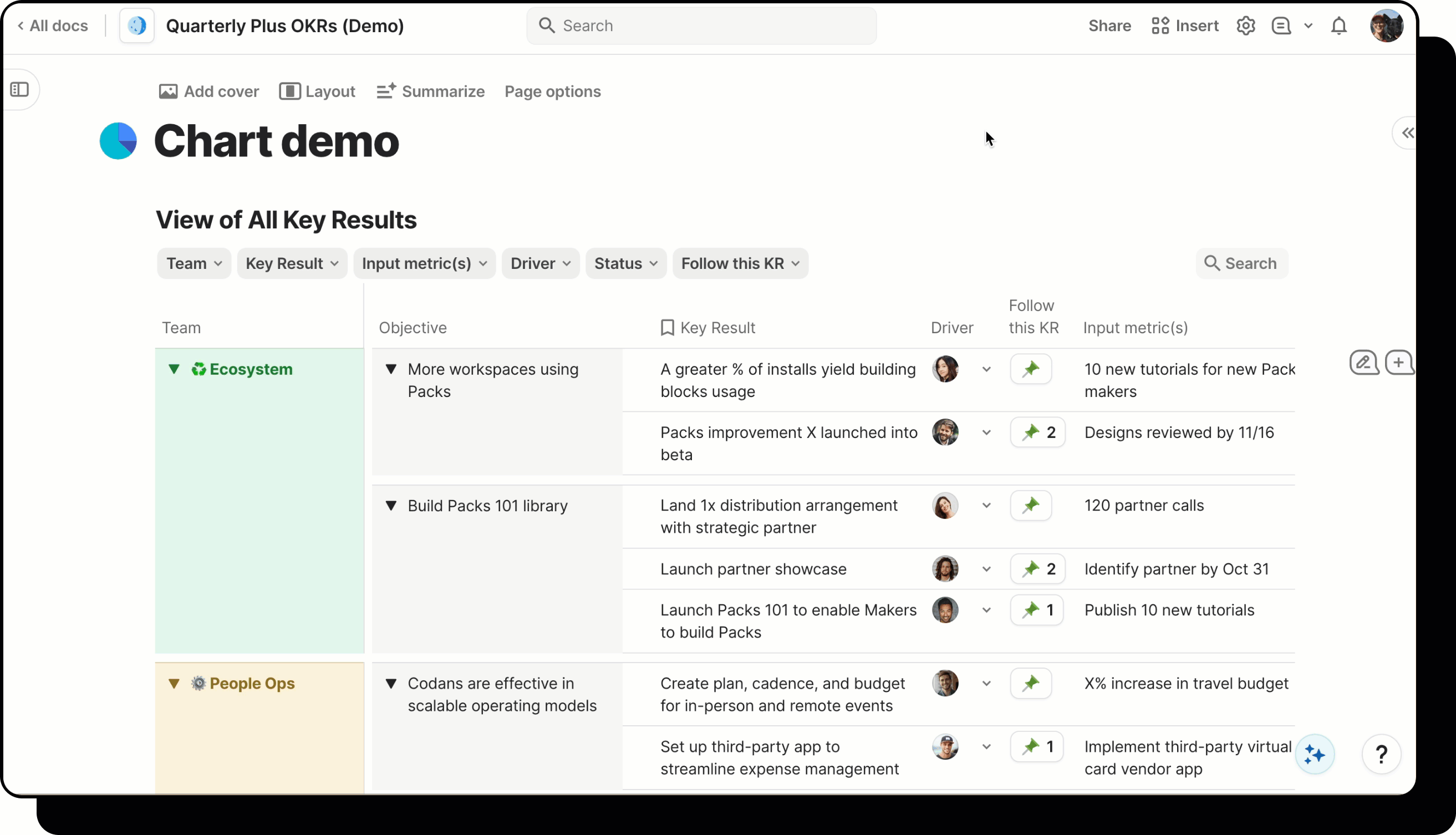

If you're already working on a table or view that you want to turn into a chart, you can do so via the table’s option menu:
  1. Hover over the table and select Options in the upper right corner, then select See all options from the menu
  2. At the top of the options menu, click on More then select Chart
    1. Note: If you want to create a timeline chart, choose Timeline from the options instead
  3. To change to a different chart type, click on Chart display. Then click into the Chart type field and choose an option from the dropdown.
Now you have your chart. Continue on to the next section to learn about customizing and utilizing your chart.

Can I change the colors used in a chart?
Yes! Simply hover over the upper right corner of your chart, click Options, and select Chart setup. Depending on your chart type and your settings, you’ll see some options to customize the colors used. For instance, if your bar chart utilized segments, you can choose the color for each segment. Or for your pie chart, you can choose the color for each value set.

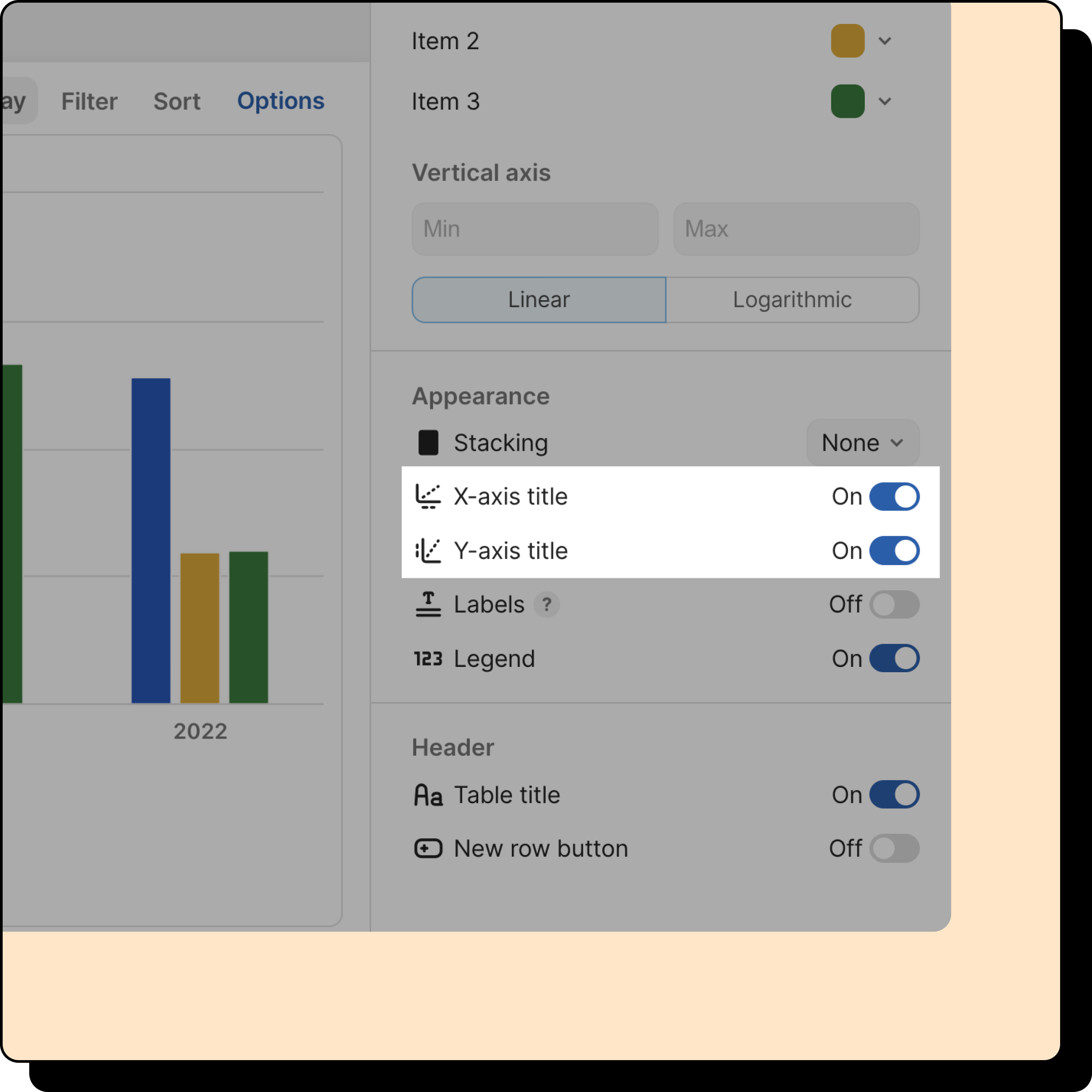

Can I display a chart without axis labels?
Yes. To hide axis labels, just hover over your chart, click Options in the upper right corner, and select Chart setup. Then search for the X-axis title and Y-axis title settings. Toggle these off to hide the axis titles from view.
