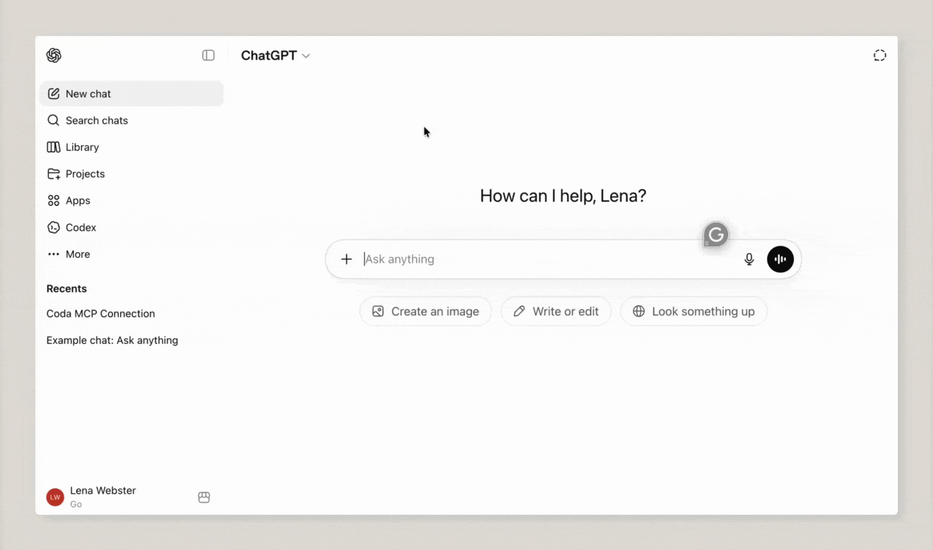

Connect ChatGPT with Docs MCP
Follow the steps below to connect ChatGPT with Docs MCP:
  1. Within ChatGPT, click into the Plugins tab of the left panel
  2. Enter "Superhuman Docs" in the search bar
  3. Select Superhuman Docs from the search results, then click Install plugin
    1. Note: If you see Disabled by admin instead of Connect, this likely indicates that the admin of your account has disabled connecting to new apps. We suggest contacting your admin and requesting they enable the Coda app for you or your org. Refer to this documentation to learn more.
  4. A new tab will open to complete the authentication process. If prompted, sign in to Superhuman Docs.
  5. Choose whether to grant this connection Full access or Limited access to your folders and workspaces. If you choose Limited access, select the workspace(s) and/or folder(s) that this connection will have access to. The connection will then only have access to the docs within those workspaces/folders. Click Save selection.
  6. Finally, click Accept to complete the authentication.
  7. Once authentication has been completed, you'll be redirected back to ChatGTP and should see a Superhuman Docs is installed confirmation.
You should now be successfully connected to the Docs MCP and can start using it to work with Superhuman Docs within your chats.

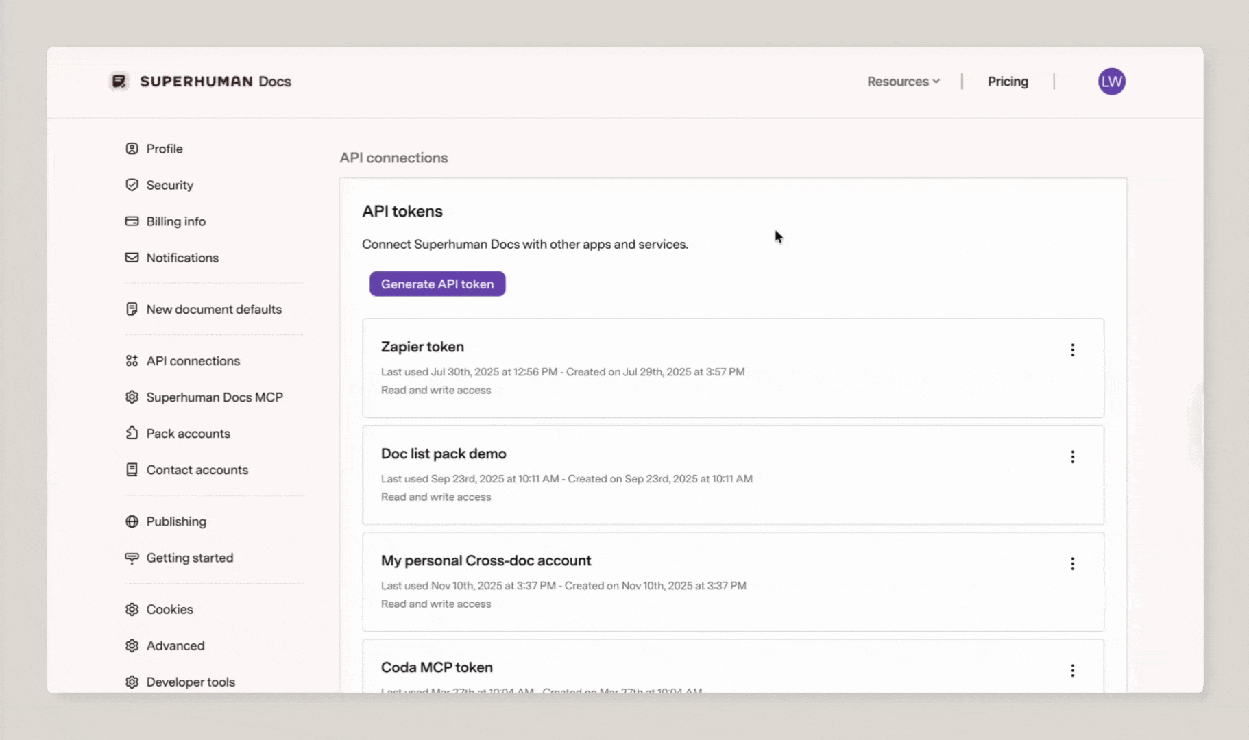

To connect Copilot Studio with the Superhuman Docs MCP, you will need to authenticate via Personal Access Tokens from your Superhuman Docs account. Follow the steps below to learn more:
  1. First, you’ll need to generate a Personal Access Token from your Superhuman Docs account page. You can click here (or scroll to the API settings section of your account page, then click Generate API token). Give your token a memorable name, choose the type of access, and ensure that the MCP option is selected. Then click the Generate API token button to create. Once created, click the Copy button to copy it to your clipboard. Learn more about creating API tokens here.

  1. First, you’ll need to generate an auth token from your Superhuman Docs account page. You can click here (or scroll to the API settings section of your account page, then click Generate API token). Give your token a memorable name, choose the type of access, and ensure that the MCP option is selected. Then click the Generate API token button to create. Once created, click the Copy button to copy it to your clipboard. Learn more about creating API tokens here.

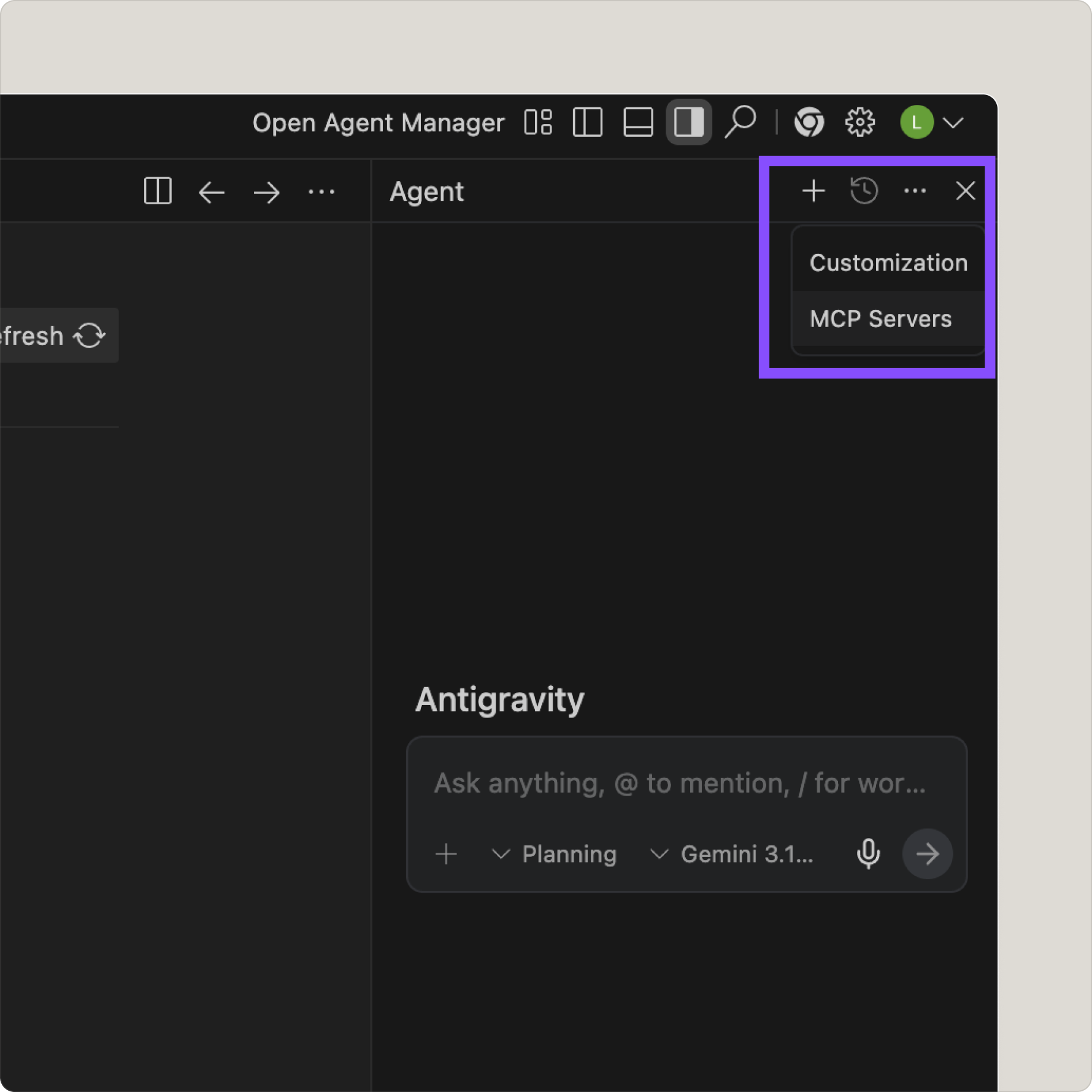

  2. Open Google Antigravity. Within the agent panel, click on the horizontal three-dot menu in the upper-right corner, and select MCP Servers. Then click Manage MCP Servers.
  3. Now click the View raw config option at the top of the page and enter the following details - making sure to replace the Your-Docs-MCP-Auth-Token section with the auth token you generated and copied in the previous step.
